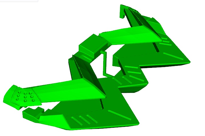

Xigfrid Posted October 5, 2015 Author Posted October 5, 2015 (edited) The biggest issue however is time! I would love to finish it faster detailling slowly Edited October 5, 2015 by Xigfrid Quote

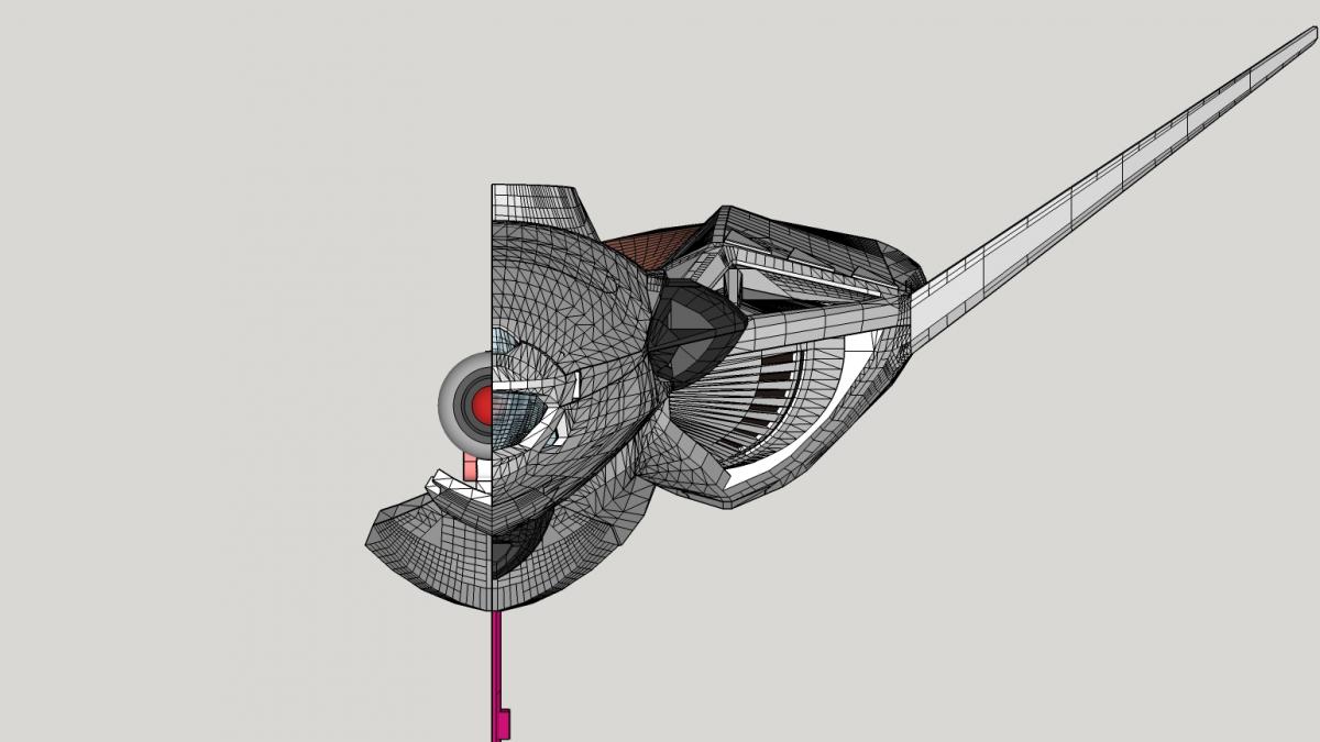

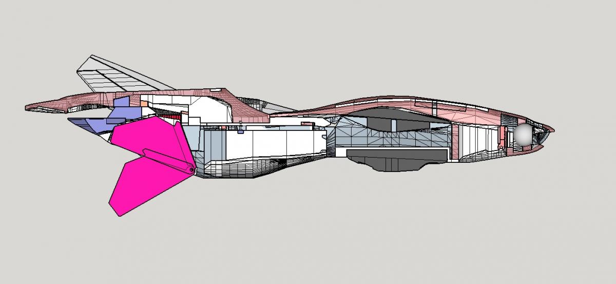

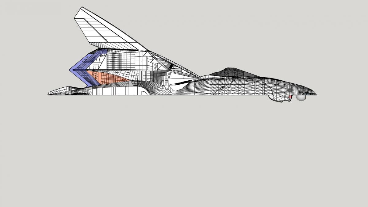

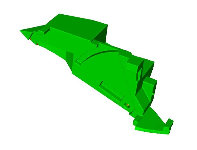

electric indigo Posted October 6, 2015 Posted October 6, 2015 Hmm, shouldn't the packs have the same footprint as the top surface of the engines at the rear end? Quote
Xigfrid Posted October 6, 2015 Author Posted October 6, 2015 Hmm, shouldn't the packs have the same footprint as the top surface of the engines at the rear end? They should, and they will almost match, but in this picture there is the lower portion of the supers that is not done / shown. Quote

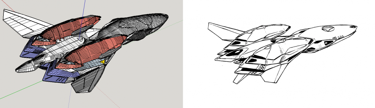

electric indigo Posted October 6, 2015 Posted October 6, 2015 The Ghost has some wicked shapes on it, I do not envy you for working it all out! Quote

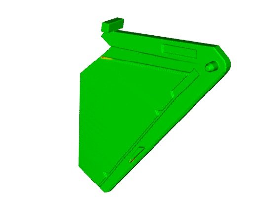

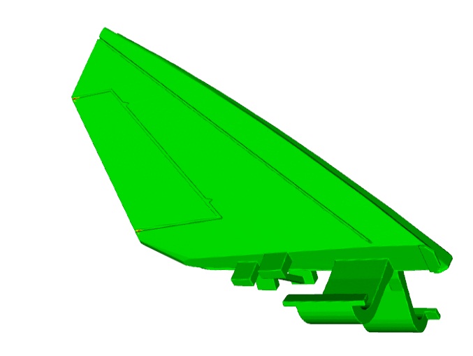

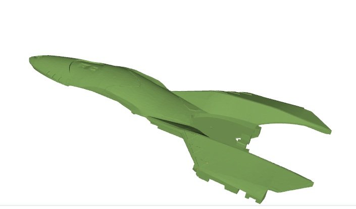

Xigfrid Posted October 14, 2015 Author Posted October 14, 2015 There has been a lot going on the model, half of it is now "printable". Not a lot of the work is visible but still for the expert eyes, here you go ! Quote

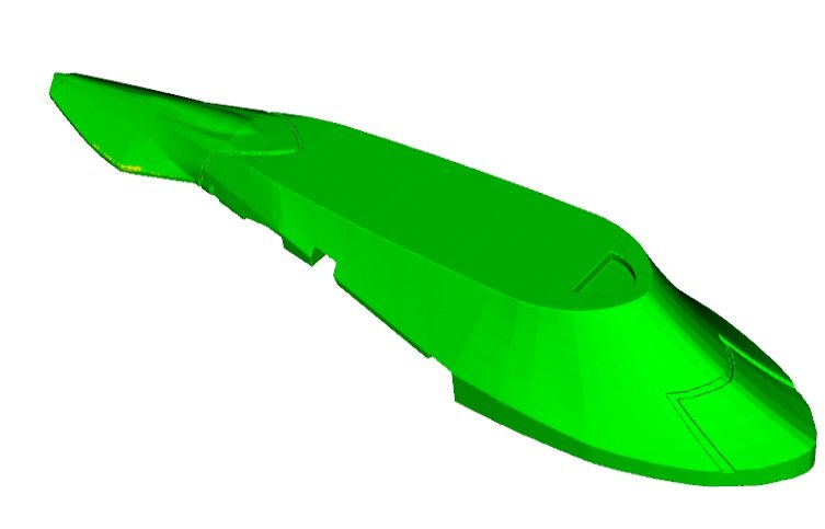

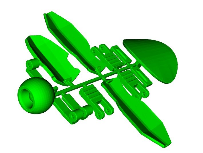

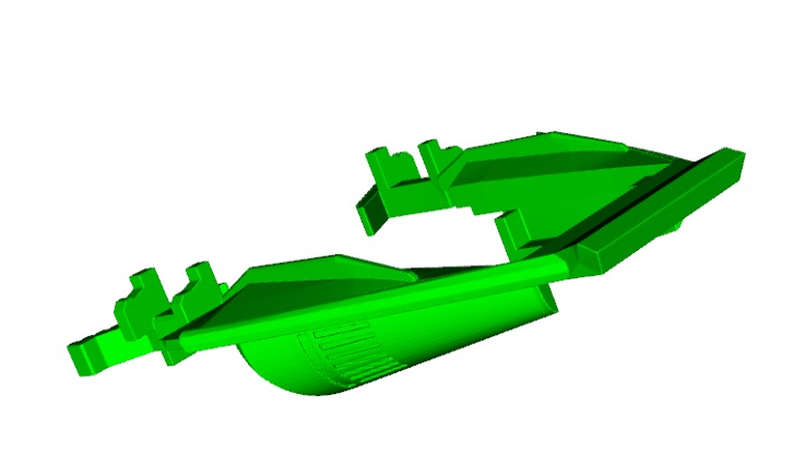

Xigfrid Posted October 26, 2015 Author Posted October 26, 2015 I had time to finish a few parts today, now working on smaller details! Quote
wmkjr Posted October 26, 2015 Posted October 26, 2015 (edited) Did you arrange those parts on the runners or is it the program that does it automatically? Edited October 26, 2015 by wmkjr Quote

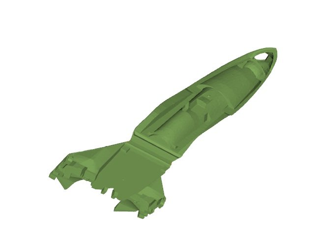

Xigfrid Posted October 26, 2015 Author Posted October 26, 2015 Thanks Lets resume all the features that have been implemented at this point: -materials, the model is planned to be casted in resin, a few moving parts would be directly printed in plastic for resistance. They will be hidden, so no painting. -metal! some use of metal rod for the landing gears trap movement (optional), and ...screws! -NO glue needed for assembly, everything is tightened by 4 screws. The screws are hidden (in the landing gears, missile compartiment and under the top/front circle cover) -retractable wings, they "clip" in deployed position -rotating eye so that it can look trough the 3 windows -But I don't know how to move if the clear canopy is installed- -the eye is large enough to receive a red tritium vial if desired (3mm diameter recommended) -clear canopy to cover the eye -retractable bottom wing so that the X-9 can realistically land. The bottom wing "clips" in deployed and retractable position -opening missile traps: they "clip" in closed and open position so more display options! Still working on: -optional retractable landing gears, should have rubber tires, but not rotating -a first in macross story if I succeed to make a directional front landing gear -missile scaffolding for mini-HMM + numerous HMMs -I will probably make another scaffolding for the standard HMMs from Arcadia YF-19 Quote

Xigfrid Posted October 27, 2015 Author Posted October 27, 2015 Did you arrange those parts on the runners or is it the program that does it automatically? Did you meant the sprues? The 3D parts are entirely designed, even the sprues Quote
