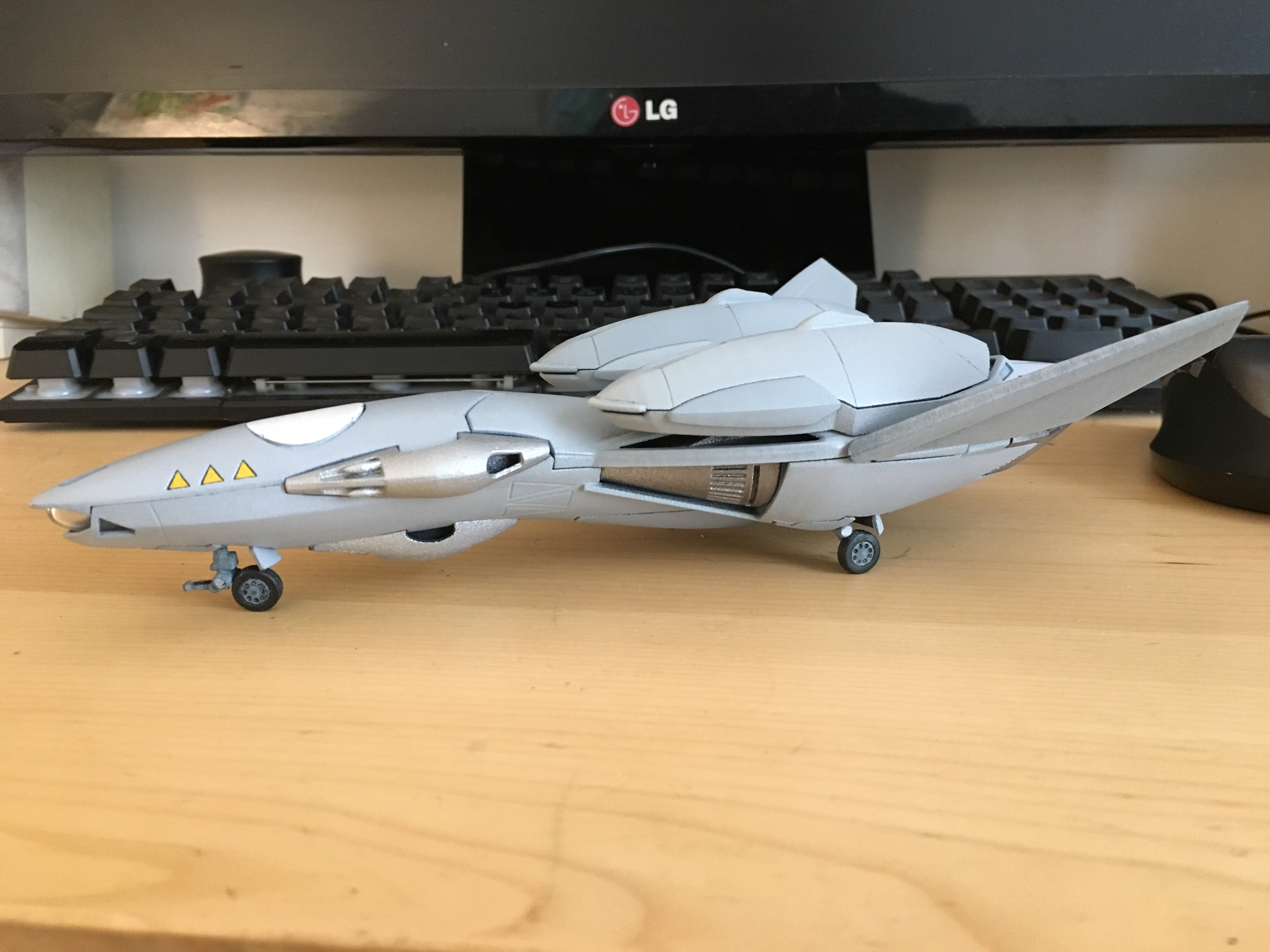

Since I invested in a air brush, I can do the painting, but preparing (sanding/primer x3 times) takes too much efforts to be enjoyable when done multiple times. If I find a professional sandblasting service, open to sanding plastic parts instead of dental apparels, that would be a different story!
If @valhary can make resin copy from a sanded/primed/clean set, then problems should be solved and the ghost could be a resin set. I am also investigating Chinese manufacturers to see if there is one which would be interested to make a toy/plastic kit out of it, and that would be the ideal solution!

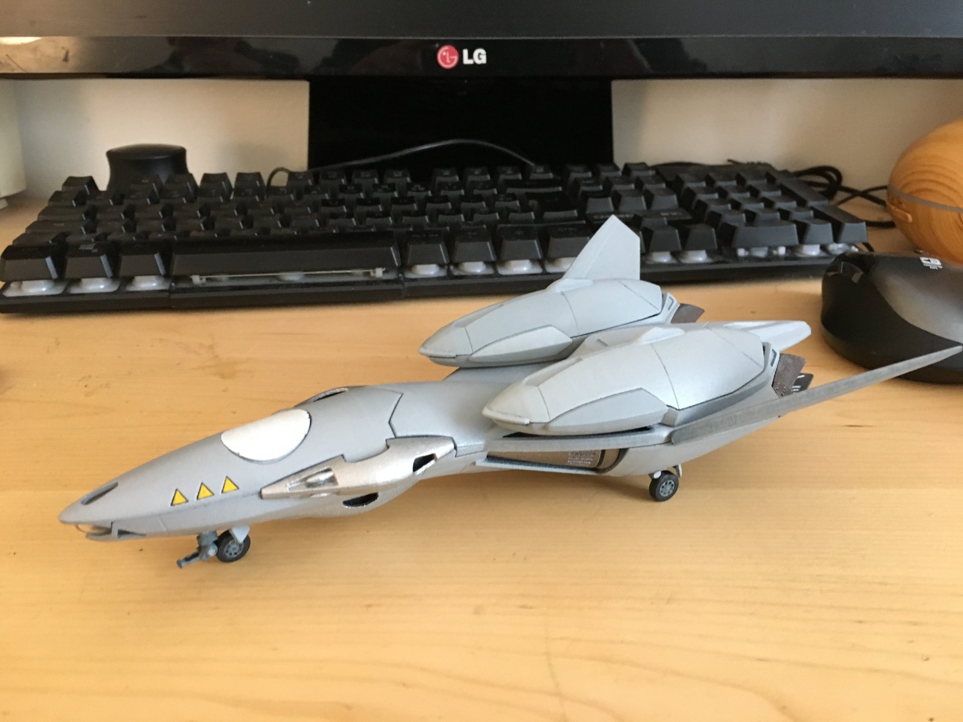

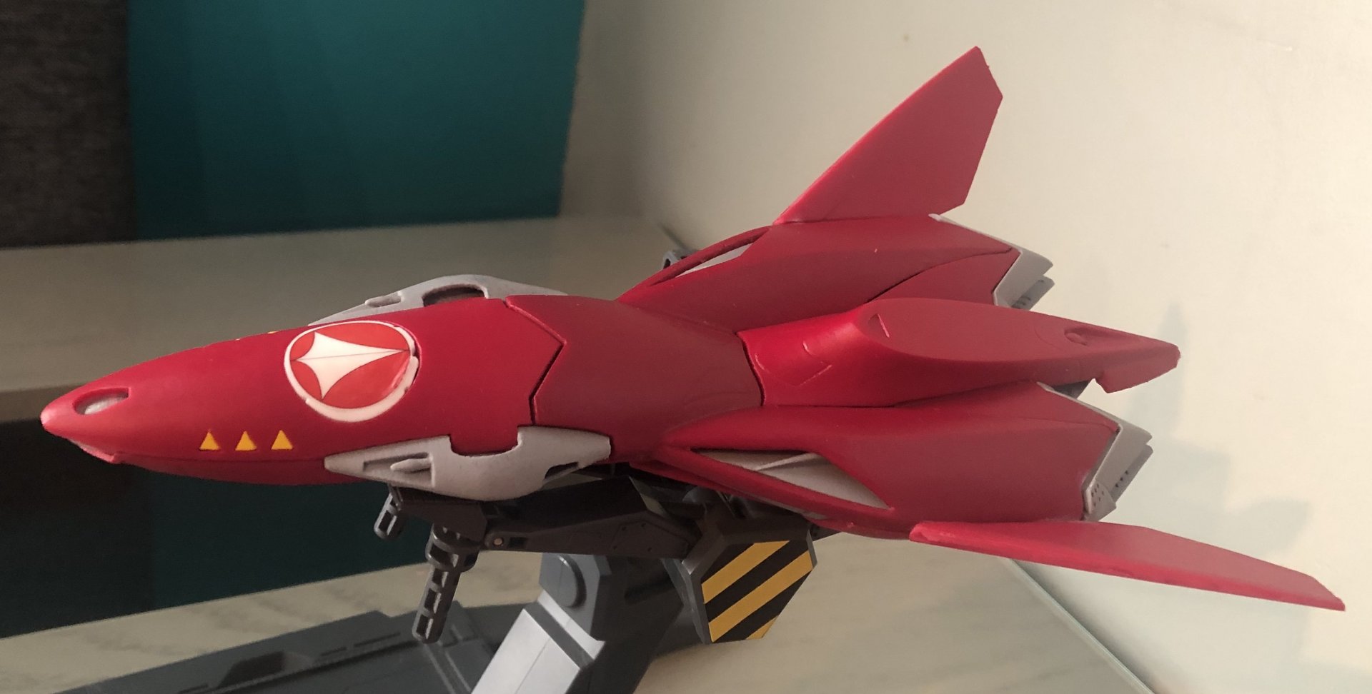

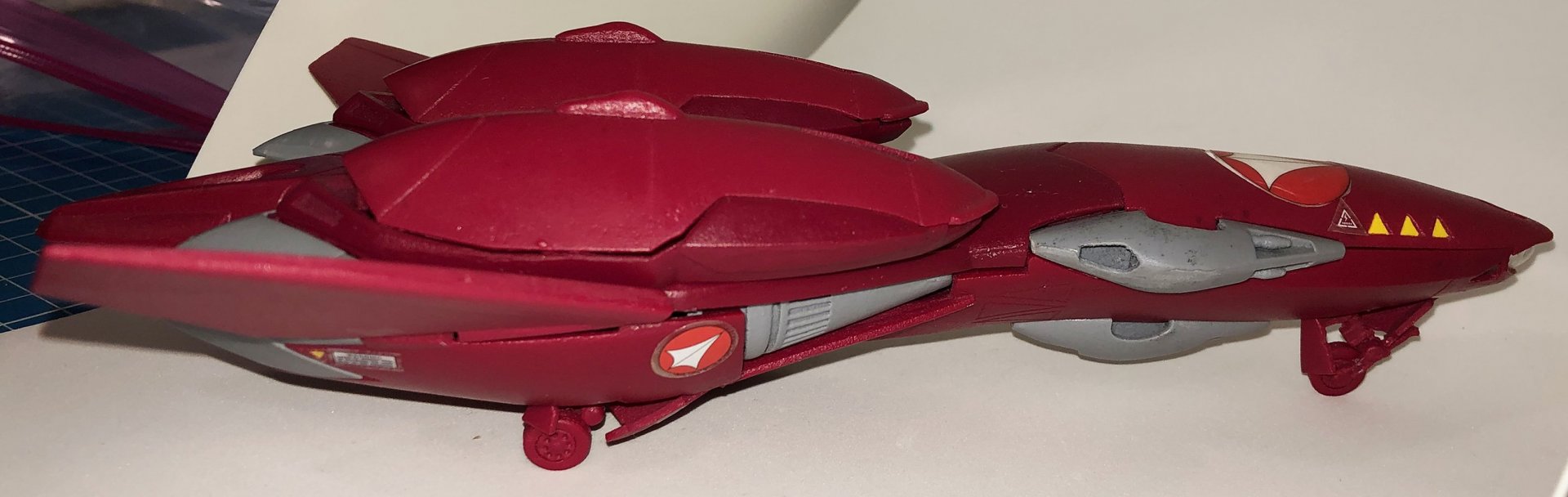

Damn, you’ve managed to top your previous effort.  Nice change to the wing folding mechanism.  I’d like to see more of the enhancements.
Thanks guys!

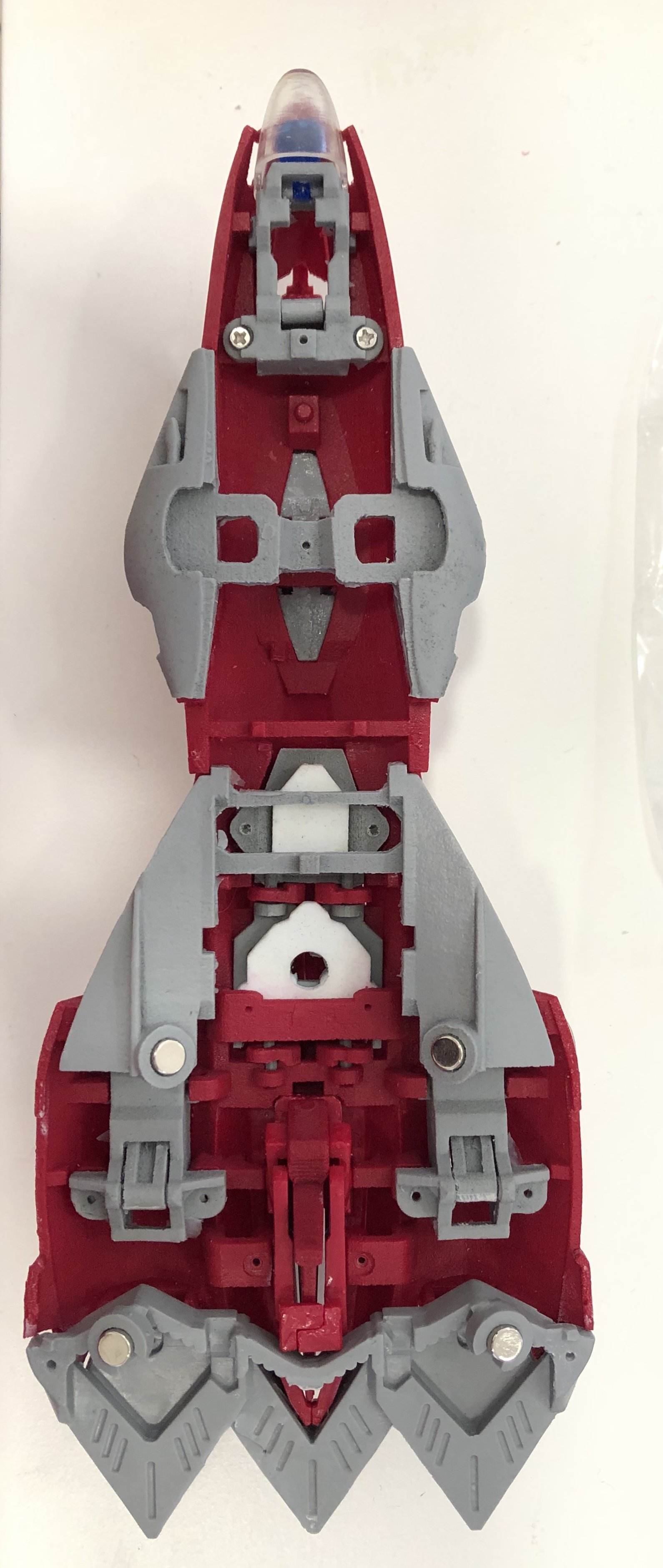

@Mommar esthetically this V2 is very similar to tte first version. The main changes are the 1) more compact/efficient landing gears mechanism, 2) front clear widow shape, 3) slight changes to global shape peculiarly on the bottom stabilizer which has been enlarged. 4) every moving mechanisms have been reviewed to be enhanced to be more solid and long lasting (bottom stab, missile traps, wings and Sharon seat). 5) super parts have been shaped more ala Tenshin illustration instead of based on the line art and use magnets now.
I plan to make a video soon too!

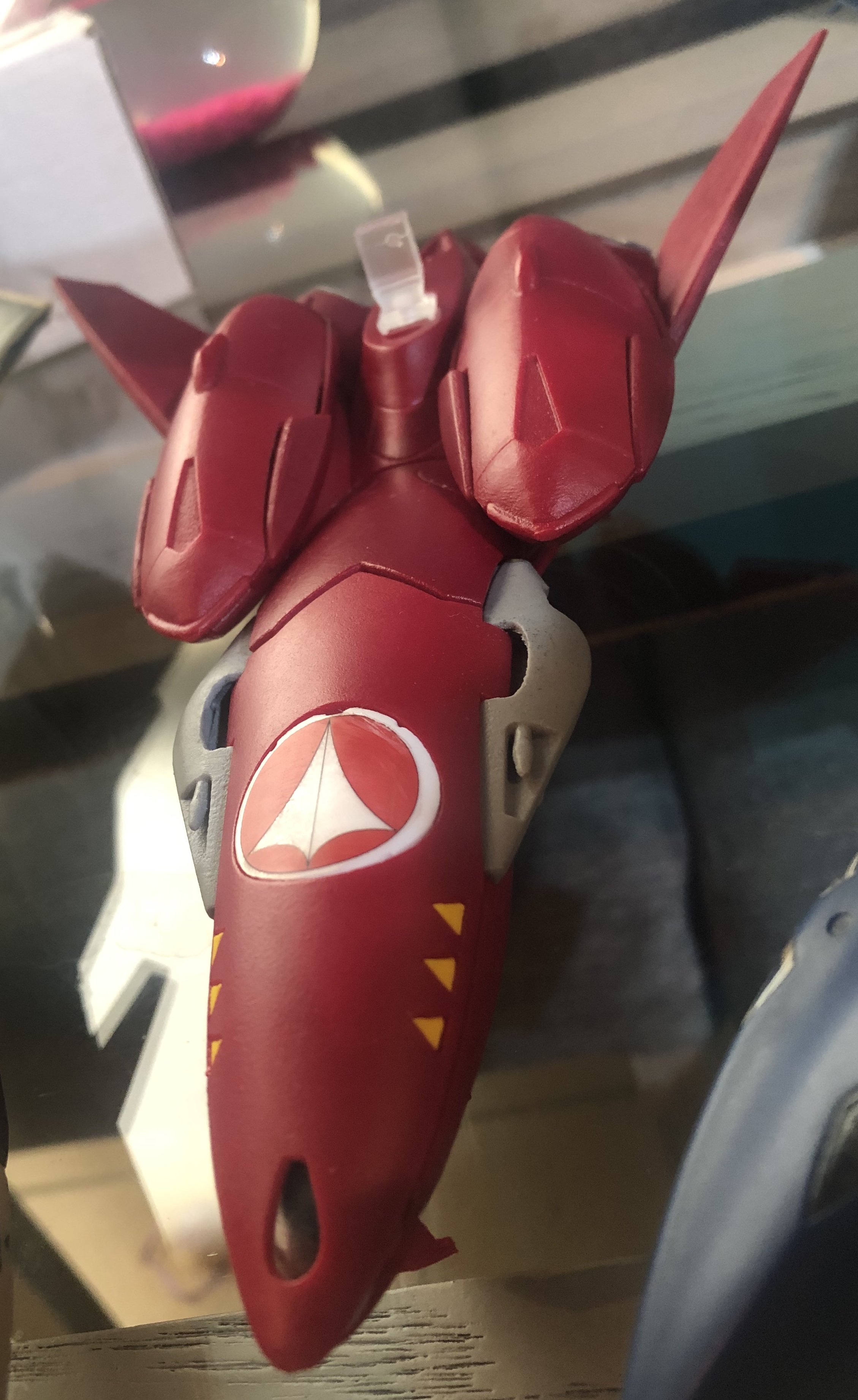

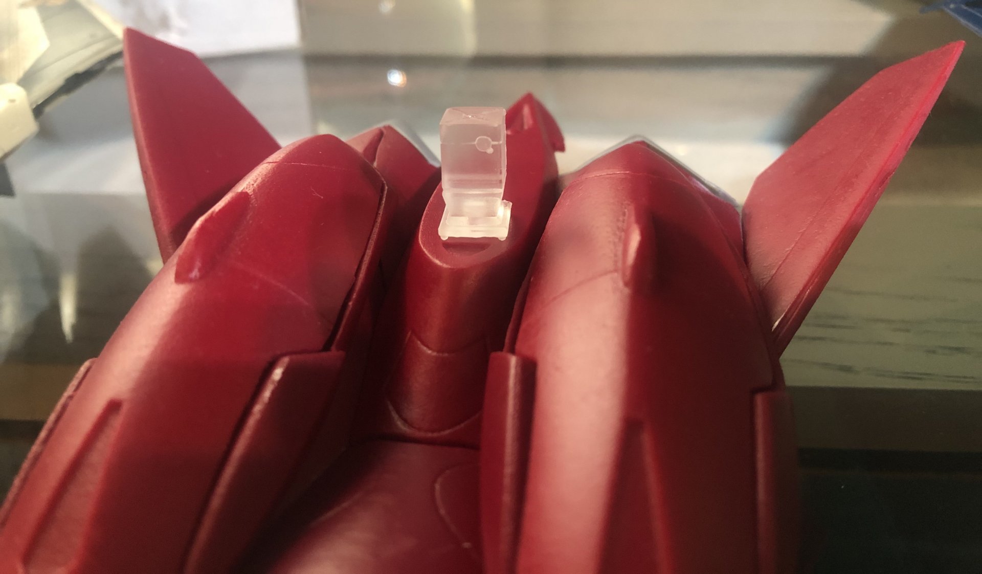

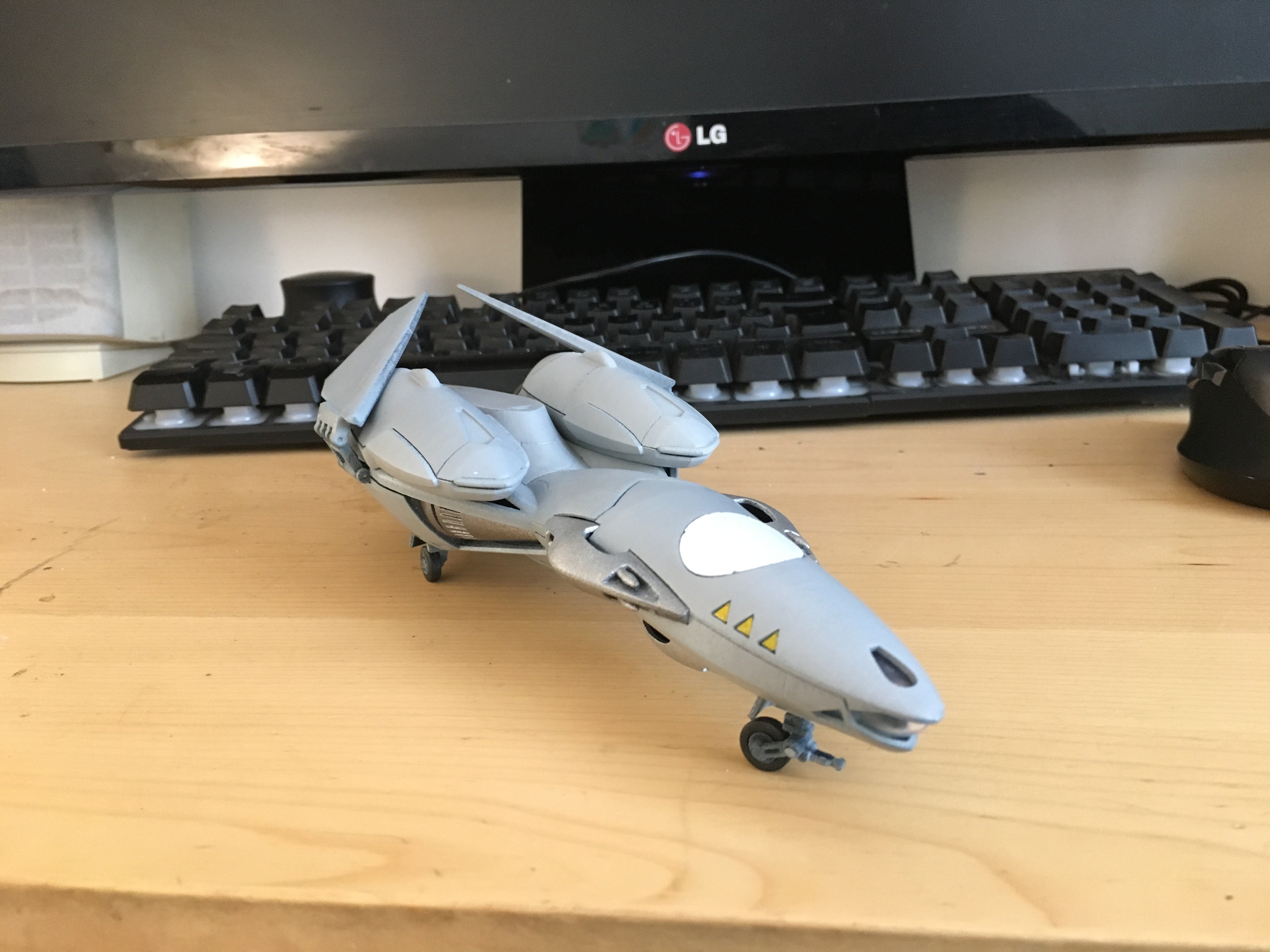

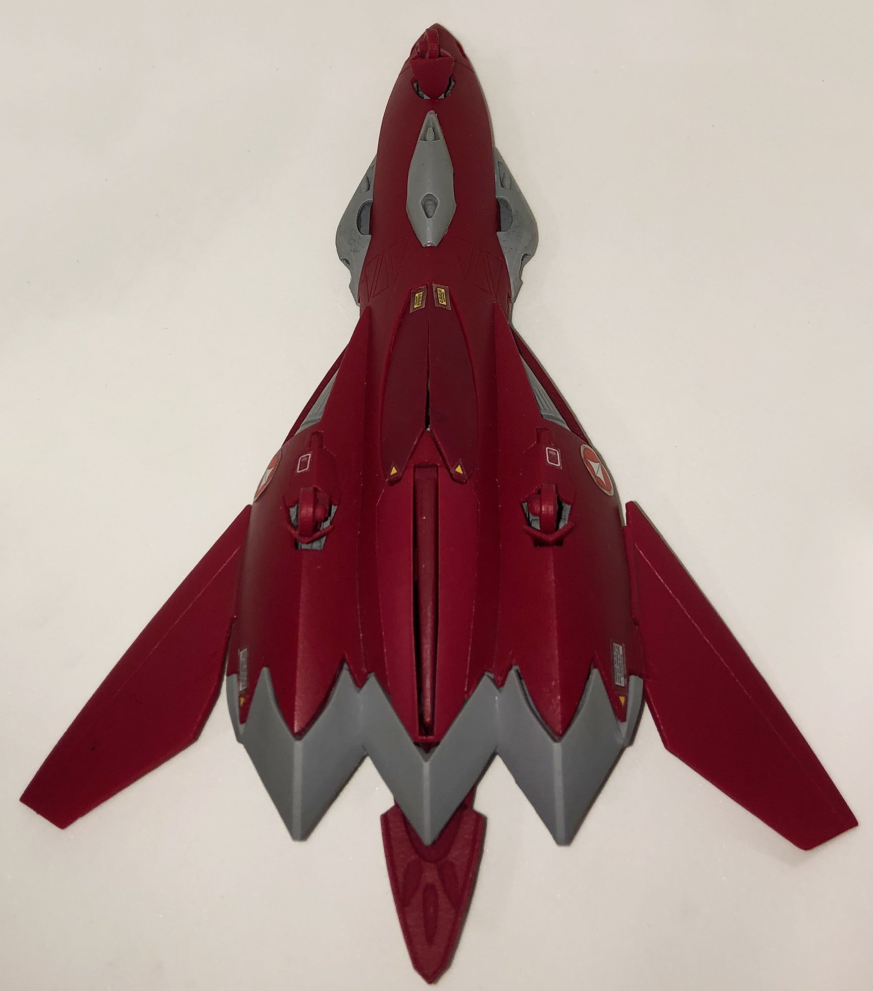

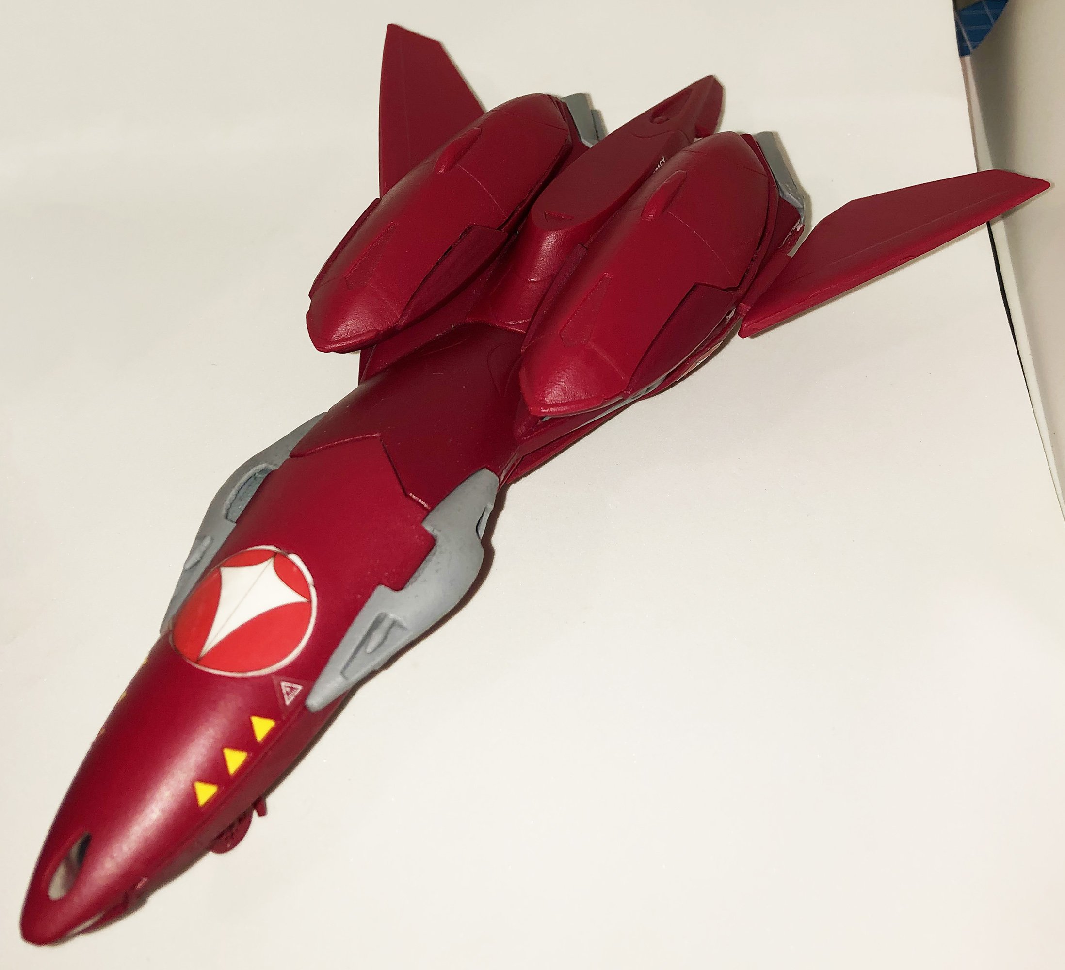

On 11/22/2019 at 4:19 AM, Xigfrid said:
Primer looks ok, next steps will be to prime in white to have a lighter red finish.
I'm really loving this.

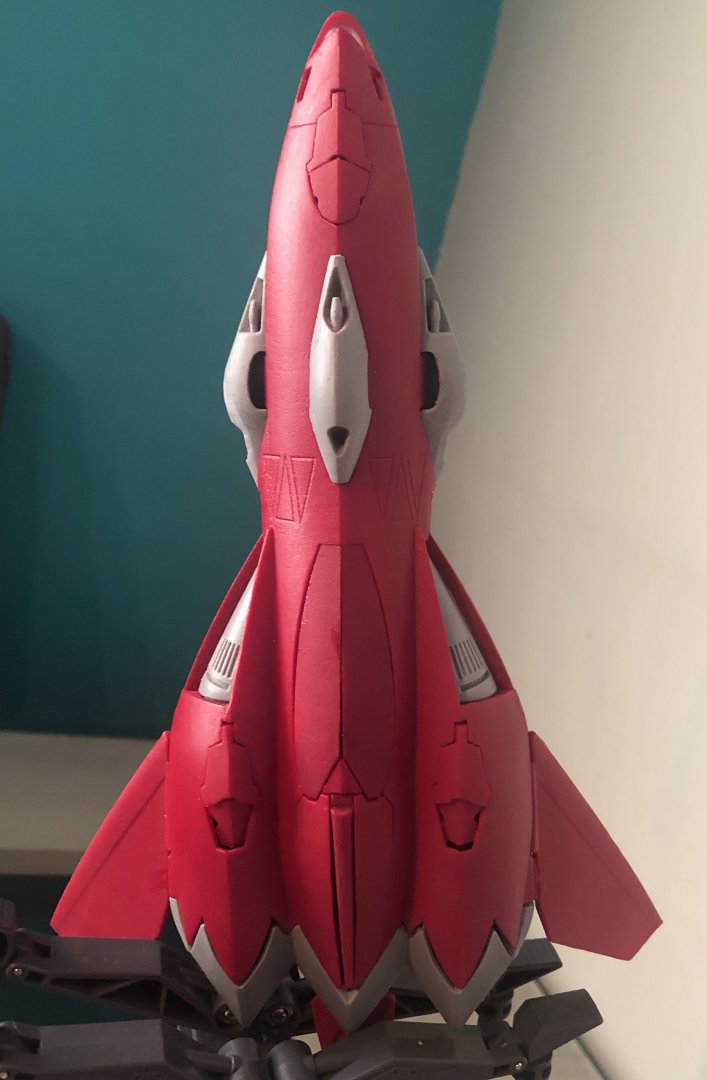

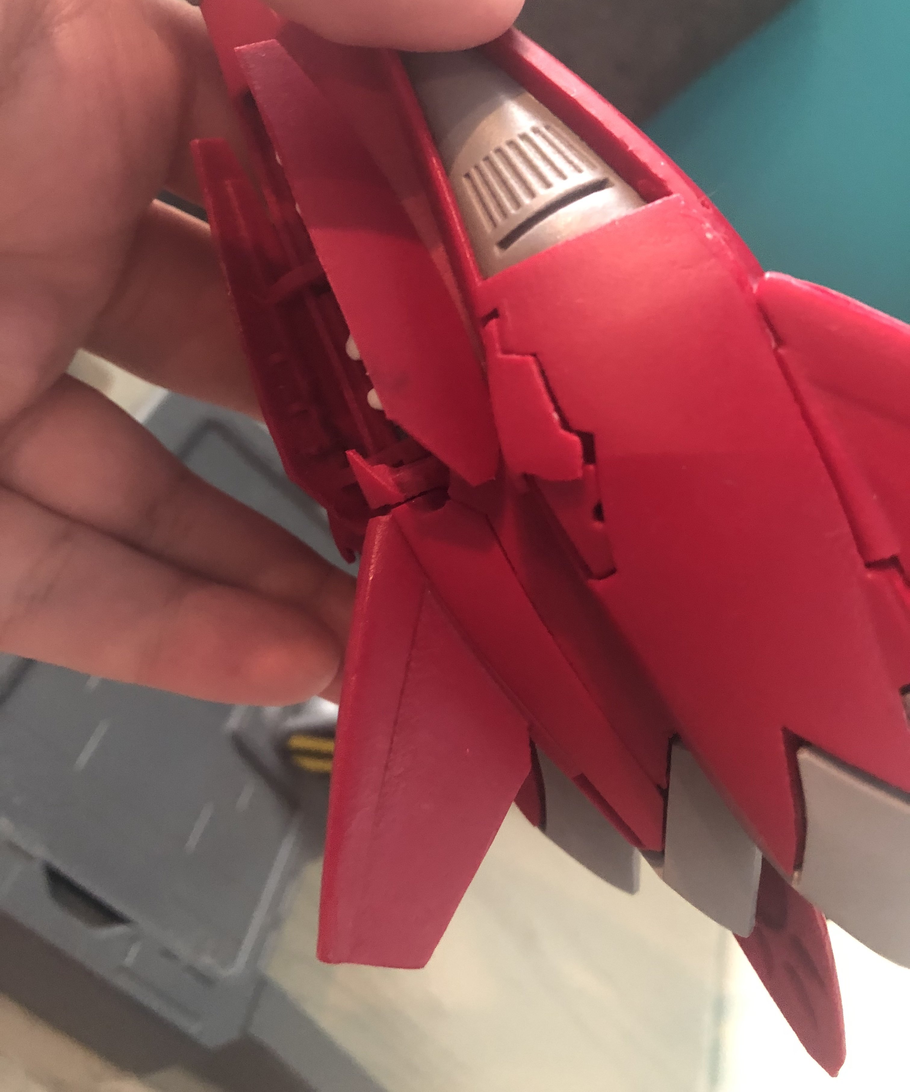

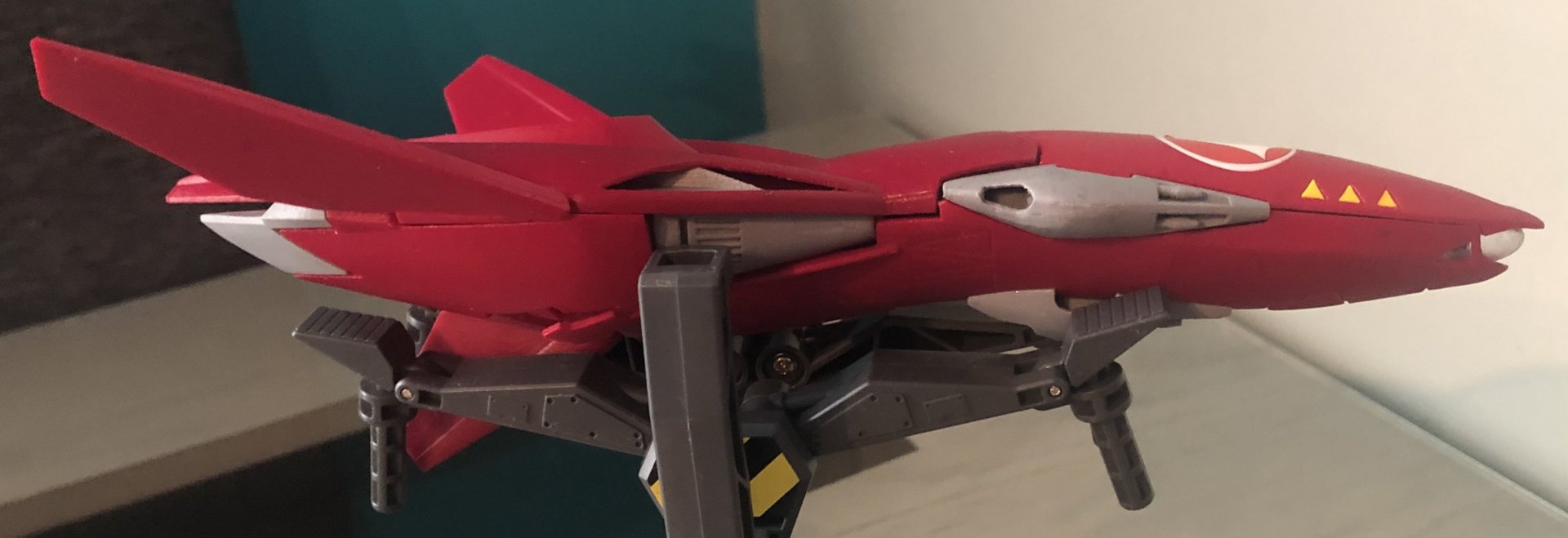

Thanks to Xigfrid for made this possible

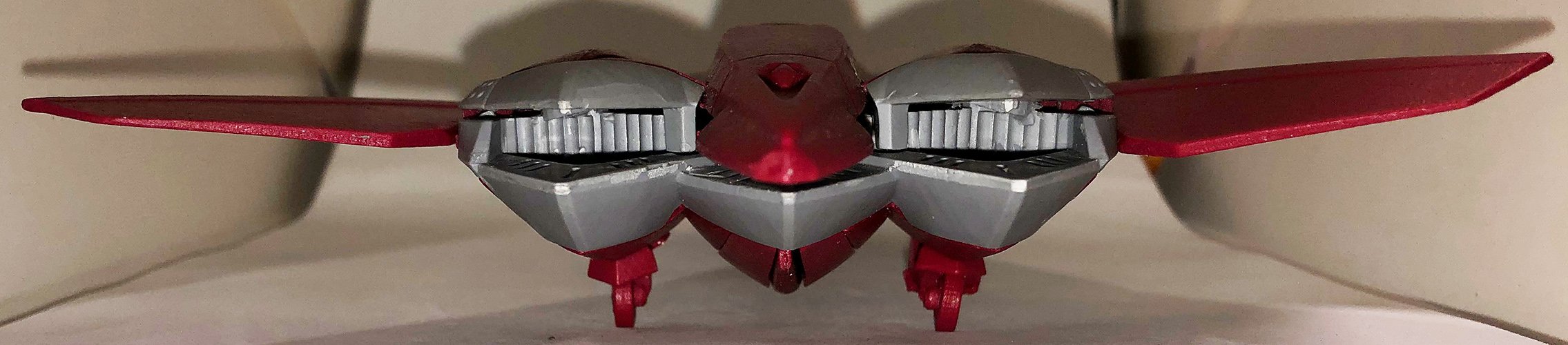

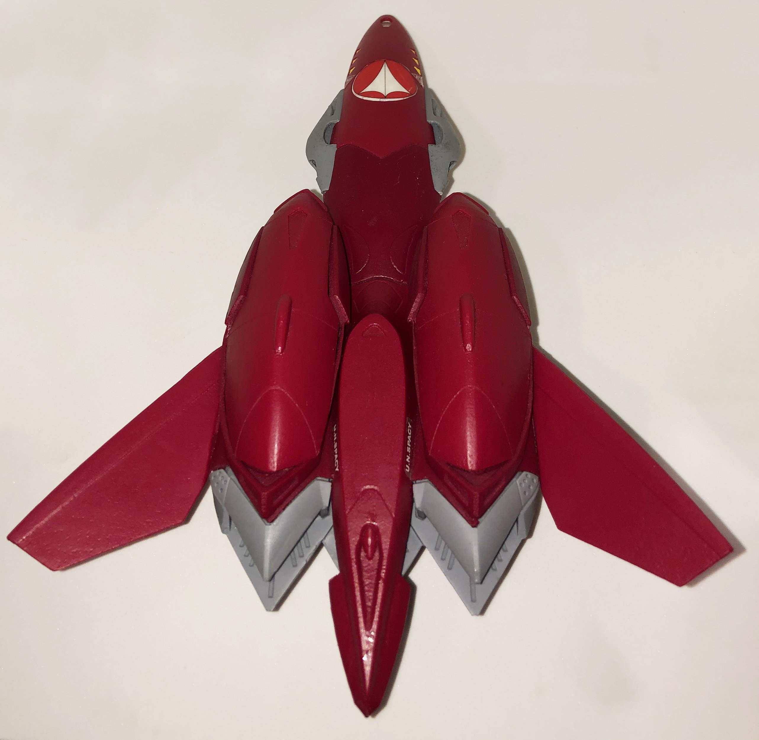

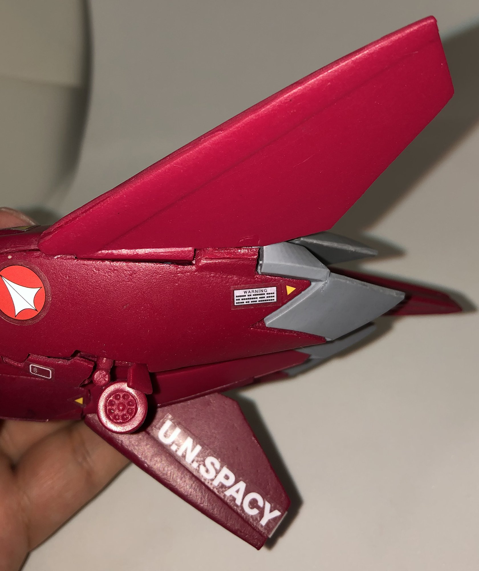

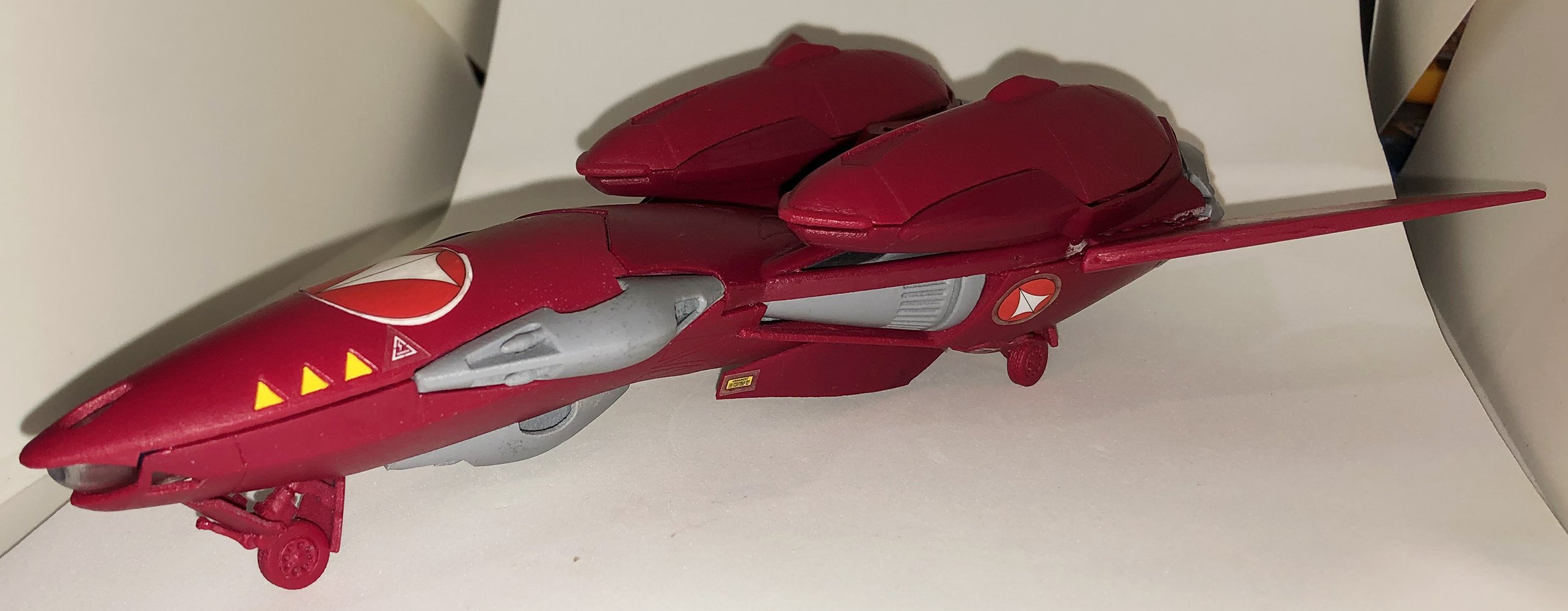

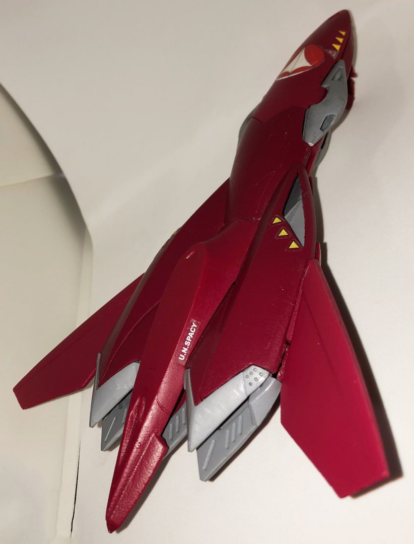

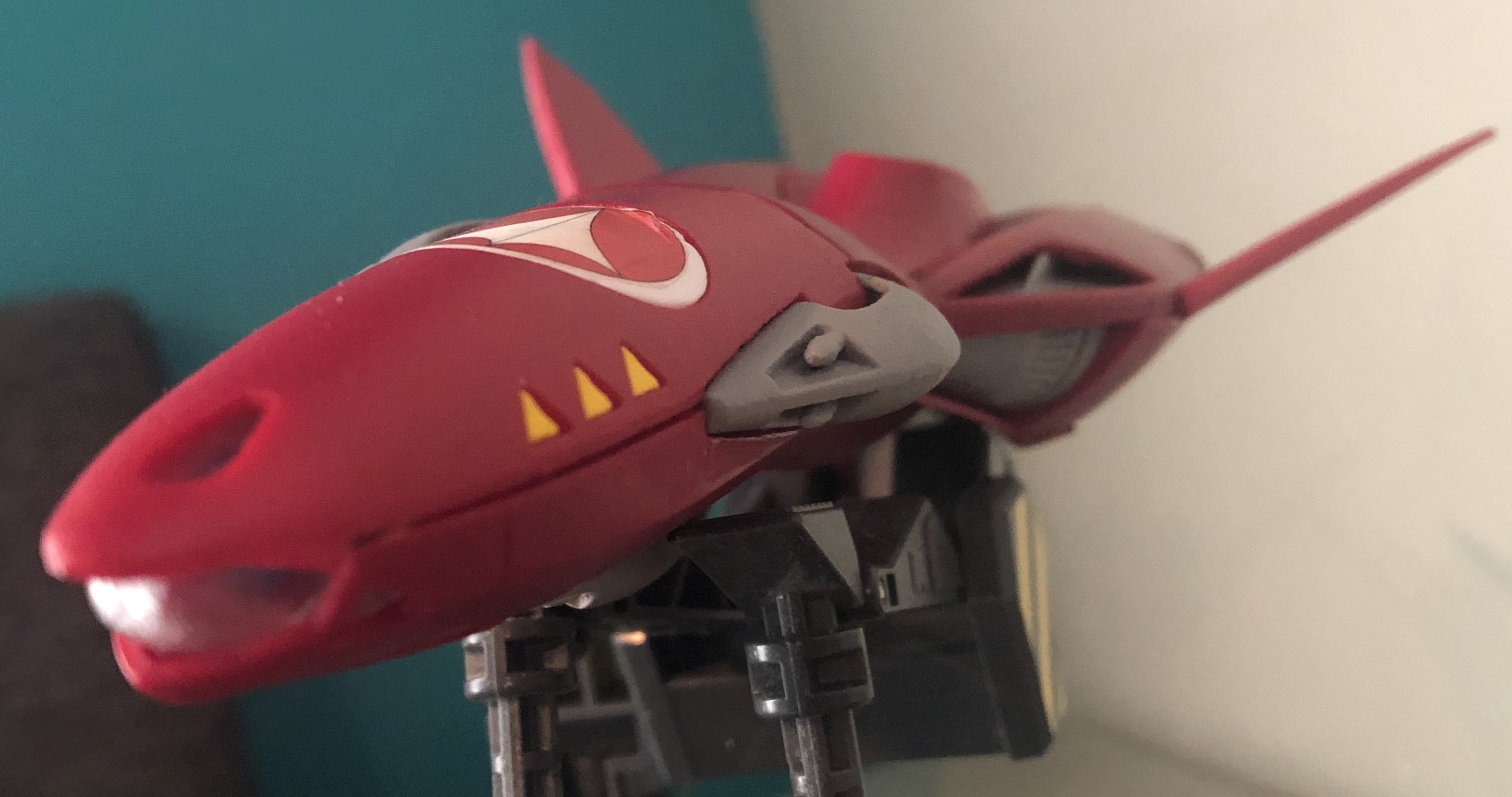

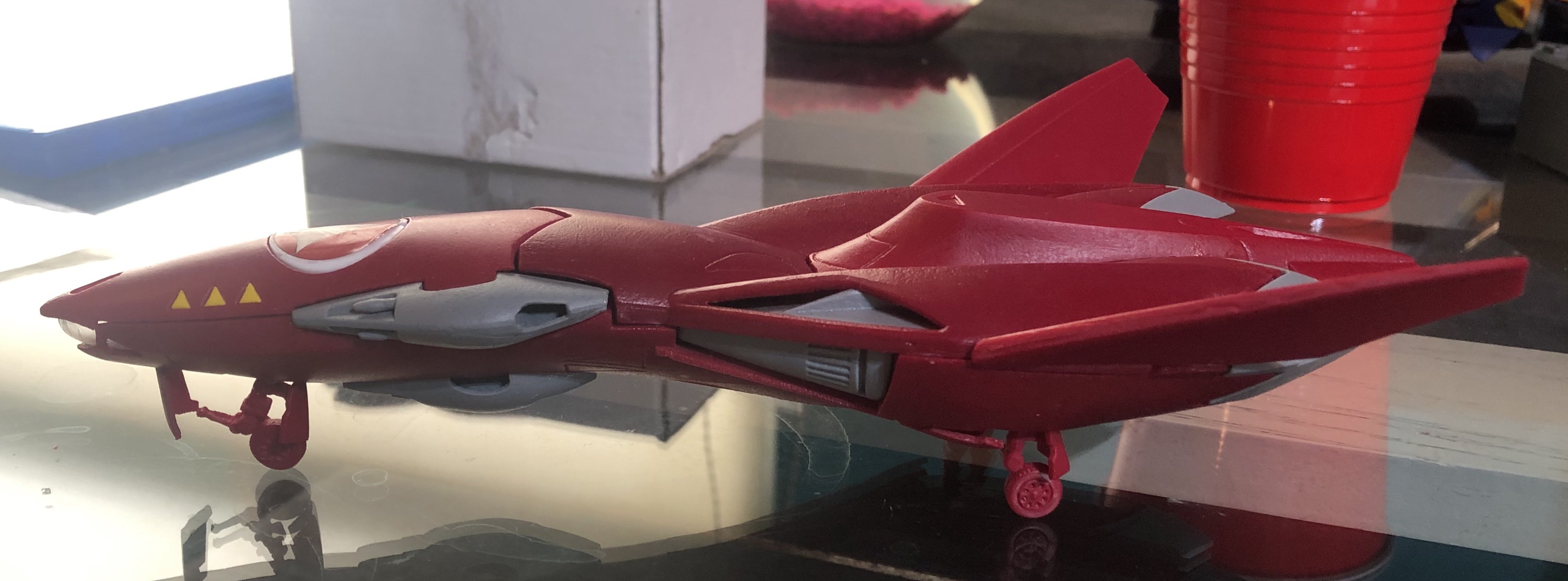

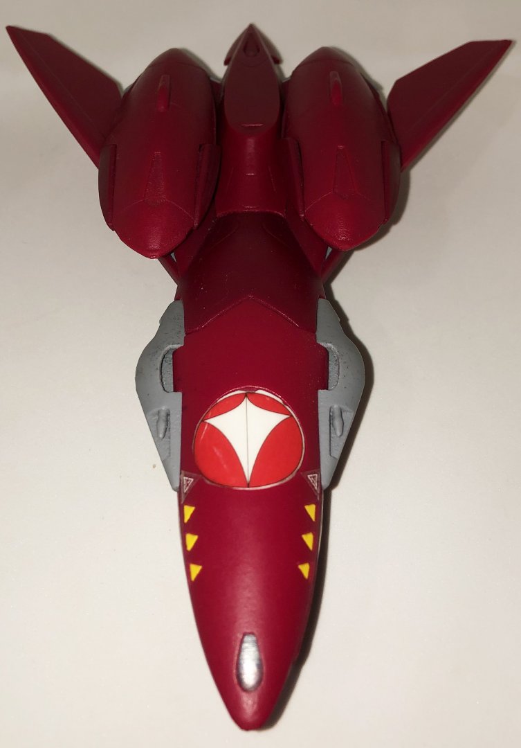

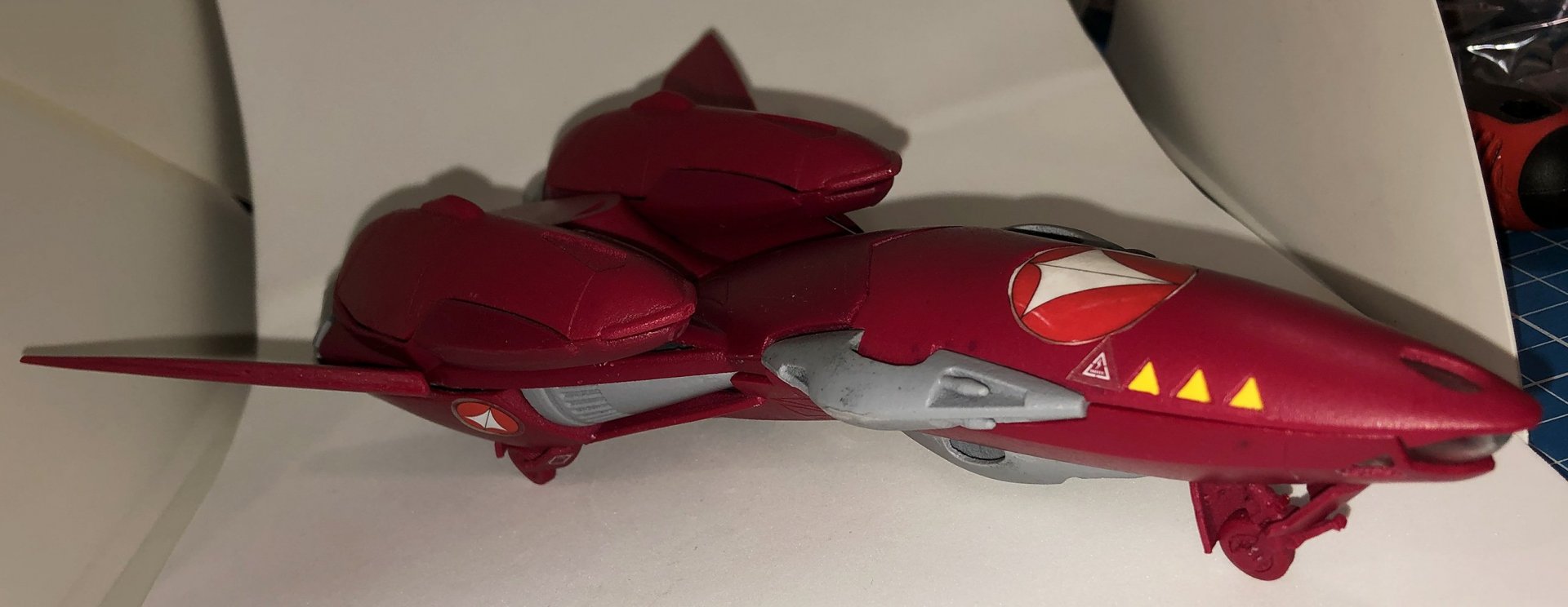

Resin Ghost X9 1/60 scale V2
Features:
- Moveable wings
- Retractable stabilizer
- Landing gear
- Superparts
- Sharon Apple pilot
This is a resin kit made starting of the Xigfrid`s 3d model in order to be complete requires:
- Drilling
- Sanding
- Cleaning
- Assembly
- Glued
- Painting
The pins, screws, magnets and stickers are not included
The price is $145 USD plus the shipping and the Paypal commissions
If you interested or have questions send me a PM
* The images are only for reference the real product may vary specific in the resin color
Once the pre orders are taken the manufacturing process will take us a pair of weeks thanks for you understanding and support

@Bolt the material is described in the assembly Manuel and for the magnets, their dims are diameter 5mm x 3mm height. I have grabbed a few on eBay. I think they were N50 grade, but N35 would also work well, don’t worry.
I am also thinking of making a few parts available on shapeways/stl version as upgrades. First thoughts for the landing gears because in resin they won’t sustain the weight of the ghost, so in plastic PA12, they will hold better for a permanent display.

I assembly the test a month ago an until now no problems with the landing gear maybe is because is integrated by many parts and not only by one but I guess only time will tell us
with regard the magnets still exists the possibility to include without increasing the sale price (yet in negotiations with a local supplier)
