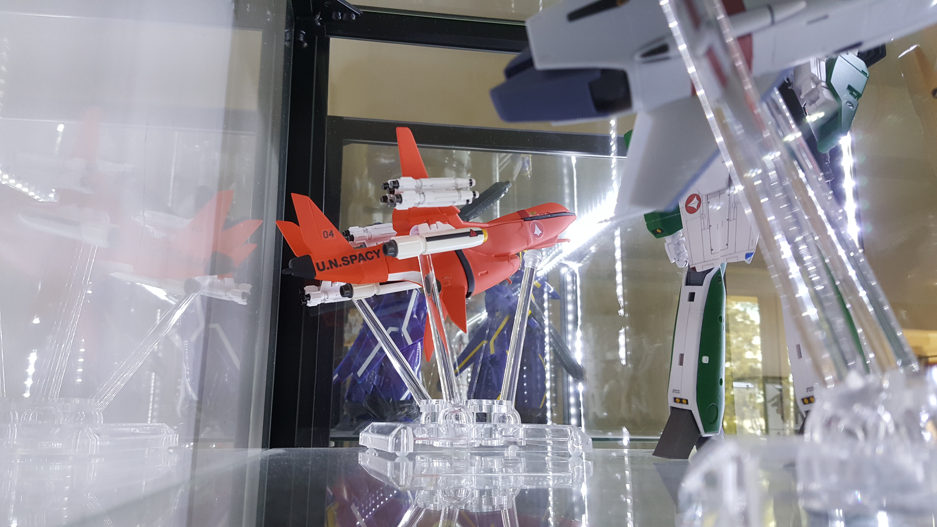

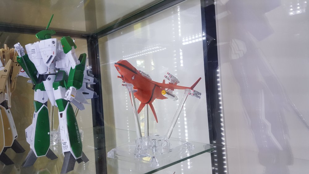

505thAirborne Posted August 25, 2017 Posted August 25, 2017 Looks great spanner, the VF-1 missiles are a nice touch! Quote
spanner Posted August 25, 2017 Posted August 25, 2017 Thanks guys! I did also try fit the missiles from the VF-171 accessory set but they just didn't look right.. and I can't find where I put the missiles from the YF-19 ffs.. But yeah I'm happy with these! I think the white missiles look better with the orange. I had to glue the bigger missiles mounts on to the wings as they just didn't want to stay on. The others all fit on quite well but I had to drill out the holes a little with a dremel. Quote

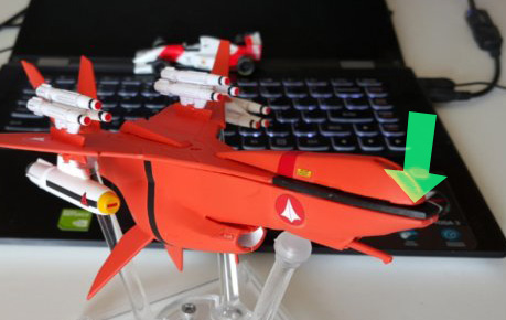

Xigfrid Posted August 25, 2017 Posted August 25, 2017 Your drone looks deadly spanner One thing about the front top part, normally it should sit just against the black aera, there is a recessed aera where it should go and make the front nose seamless. Quote
spanner Posted August 25, 2017 Posted August 25, 2017 I did notice the gaps in places but that's the best I could get it to join all together unfortunately.. Quote
Xigfrid Posted August 25, 2017 Posted August 25, 2017 Probably with a hair dryer you can gently heat the top part only and once it's hot, you put it back in its place and it would get back to its good original shape. Quote
spanner Posted August 26, 2017 Posted August 26, 2017 10 hours ago, Xigfrid said: Probably with a hair dryer you can gently heat the top part only and once it's hot, you put it back in its place and it would get back to its good original shape. ahh! I didn't think of that.. bit late now as its all super glued together! LOL! Though I'm still quite happy how it went together! Looks great on display! Quote
Mommar Posted August 27, 2017 Posted August 27, 2017 On 8/25/2017 at 3:30 AM, Xigfrid said: Your drone looks deadly spanner One thing about the front top part, normally it should sit just against the black aera, there is a recessed aera where it should go and make the front nose seamless. I can't get that part to stay down either. Quote
Xigfrid Posted August 28, 2017 Posted August 28, 2017 I don't have my copies yet, Jasonc perhaps there is a bit of resin blocking the top part to completely push inside the black part? What do you think? Quote
Jasonc Posted August 29, 2017 Posted August 29, 2017 On 8/27/2017 at 4:31 PM, Mommar said: I can't get that part to stay down either. There might be a small plastic piece stuck in the rectangular connector of the housing. There were some in a few of the recasts that I removed, so I may have forgot that one, but I did test fit parts. If I forgot to remove it, it comes out quite easy with an exacto knife. If it still sits a little high, but is snug and staying on, cover up everything except the housing section, and warm it up with a hair dryer. It'll help it settle. you can use your fingers to manipulate it a bit, but don't do it to forcibly. You don't want to over bend it. Quote

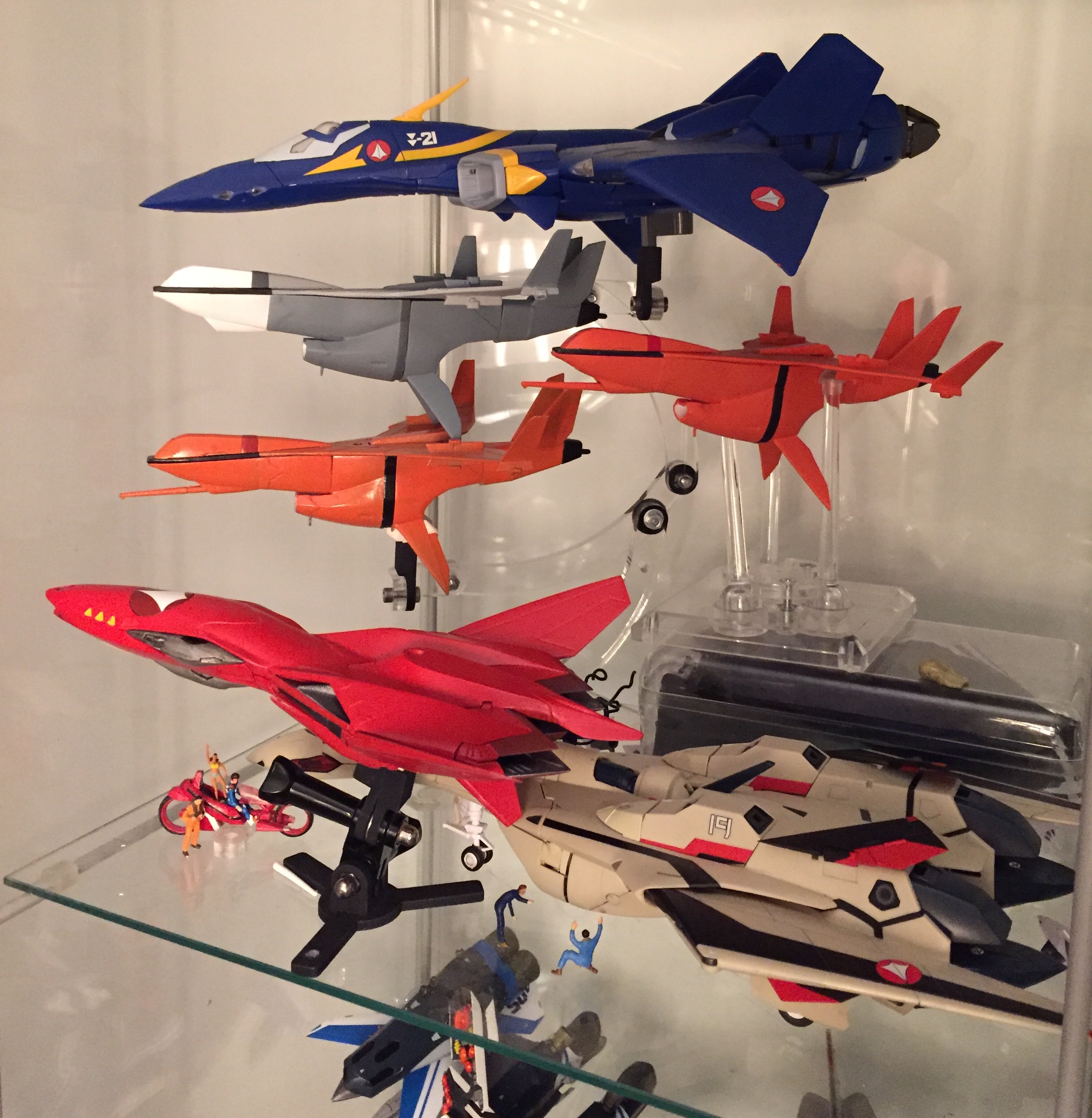

Xigfrid Posted January 25, 2018 Posted January 25, 2018 I too had the gun broken this week-end, since it broke just at the root of the sliding rail, there is no way I can drill and glue it back. I have a WSF replacement part for it so I don't really worry about that but in order to replace the part, I have to open the model and release the black part... that I just glued! Well I will wait until it really bugs me without the gun to repair it Quote
wmkjr Posted January 25, 2018 Posted January 25, 2018 I gotta say that you've got one if the most unique collections. Quote
Jasonc Posted January 25, 2018 Posted January 25, 2018 Looks great, Xigfrid. I'm sure this has been asked already, but where did you get the mini figures at? Quote
Xigfrid Posted January 25, 2018 Posted January 25, 2018 The Mini figures are from an European manufacturer: Preiser, they are from a pack of 6 in 1:72 scale but they are of the same size of Isamu and the real painting job is much better than their picture. https://www.1001modelkits.com/small-scale-soldiers/77161-preiser-pr72409-pilots-and-ground-staff-germ--4041032724096.html I am waiting for the ground crew from TSM, they look even greater Quote
