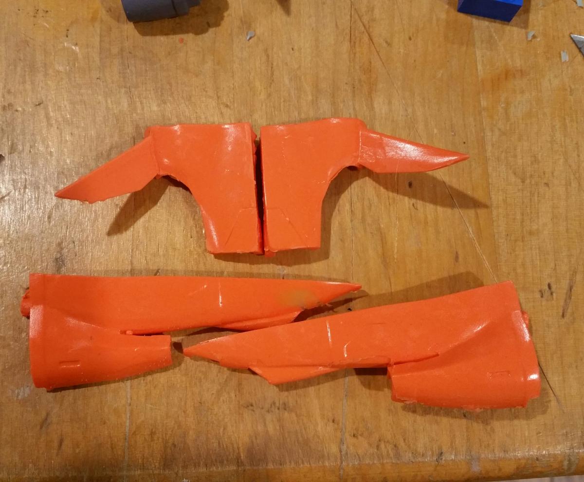

Jasonc Posted October 9, 2015 Posted October 9, 2015 OK. As you can see in this picture, there are places where the parts aren't getting enough resin. These are going to be fixed via pin holes in the mold cover, which will push the air out by the heavier resin.the color in this picture is a little lighter than they really are. Quote
spanner Posted October 9, 2015 Posted October 9, 2015 Yeah you can see the spots where the resin didn't completely fill. Still the parts do look very good! Thanks for the update! Quote

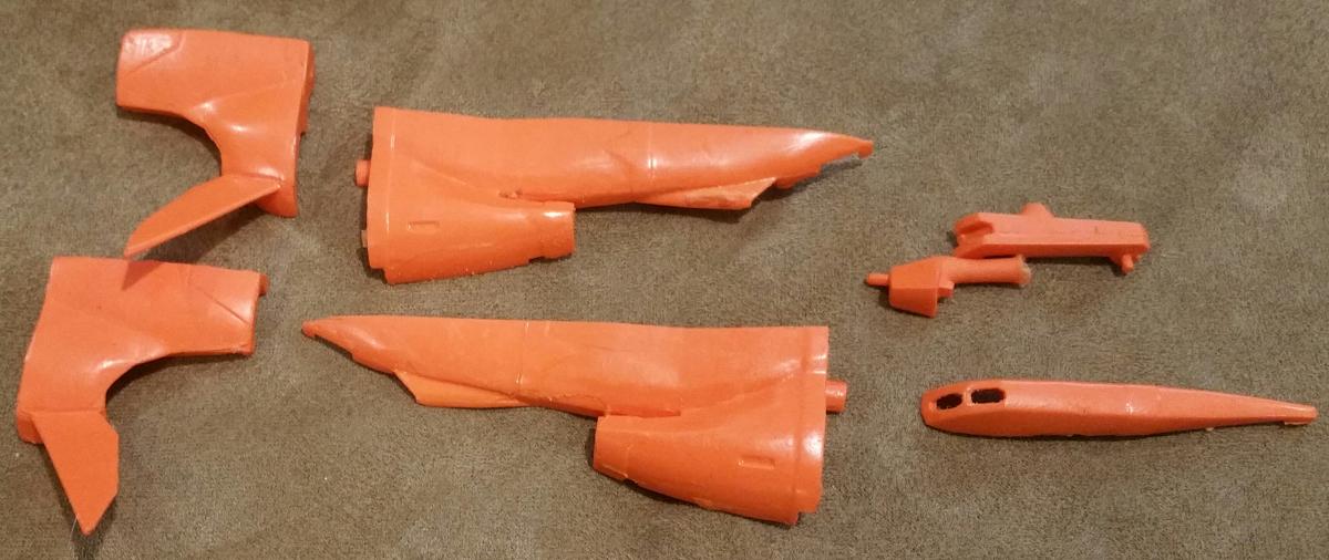

Jasonc Posted October 13, 2015 Posted October 13, 2015 (edited) oh I see.. well then we don't want any mold damage I guess eh! Definitely not, LOL Here are a few shots of good recasts. They're Pretty good for the complexity in them, but like any kit, they're gonna need work by the builder. Good thing is, the resin is quite solid. I'm happy about that. testing out some other parts now. I'll need to do th 1:72 wing AGAIN!!! Going to do to that what I did with the 1/60, as that seemed to work. In the meantime, I'm moving onto tweaking the 1:60 molds and checking for places where air bubbles will get trapped. Edited October 13, 2015 by Jasonc Quote

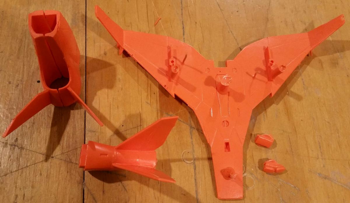

Jasonc Posted October 21, 2015 Posted October 21, 2015 Ok, here's some of the 1/60 scale. The parts are looking great, but the wing is going to need a bit of cleanup. At least it's mostly relegated to the sides of the wing.hope it looks alright for you all. Quote
Xigfrid Posted October 21, 2015 Posted October 21, 2015 (edited) They look nice! The wing is really nice and smooth but there are a few bits of resin missing on this wing though Edited October 21, 2015 by Xigfrid Quote
spanner Posted October 21, 2015 Posted October 21, 2015 Could those areas missing some resin be filled with putty yeah? Quote
Xigfrid Posted October 21, 2015 Posted October 21, 2015 (edited) Could those areas missing some resin be filled with putty yeah? I think so or the original resin could also be used so it would end seamless. Anyway I am satisfied with what I see, looking back at how difficult this wing is to be casted. Ultimately, the lesson is now learnt, for the X-9 I am going with more parts, more complex designs in order to obtain a straight forward recasting process. Edited October 21, 2015 by Xigfrid Quote
spanner Posted October 21, 2015 Posted October 21, 2015 I think so or the original resin could also be used so it would end seamless. Anyway I am satisfied with what I see, looking back at how difficult this wing is to be casted. Ultimately, the lesson is now learnt, for the X-9 I am going with more parts, more complex designs in order to obtain a straight forward recasting process. all good, no complaints. casts look great! looking forward to the next stage! Quote
Jasonc Posted October 22, 2015 Posted October 22, 2015 They look nice! The wing is really nice and smooth but there are a few bits of resin missing on this wing though Yes, there are a couple small bubble areas. It's going to happen in some pieces in some parts. Especially the large area parts like this. If I get them again in the same place, I'm gonna put another hole in the top of the resin to relieve, but I don't think it'd help. They've been a bit random on where they pop up. I'm trying to roll the resin to coat all the mold. I made another one, but there was one hole in that one. As I said, they're going to pop up. Could those areas missing some resin be filled with putty yeah? Exactly. I the early days of recasting, I used to get many kits that I'd buy, and they'd be full of parts with bubbles and would need filling. It can be filled with putty. I'm not going to stop trying to perfect them, but these are pretty easy fixes. The wing I did today has a better look, so I'm happy with that one. Quote
spanner Posted October 22, 2015 Posted October 22, 2015 Yes, there are a couple small bubble areas. It's going to happen in some pieces in some parts. Especially the large area parts like this. If I get them again in the same place, I'm gonna put another hole in the top of the resin to relieve, but I don't think it'd help. They've been a bit random on where they pop up. I'm trying to roll the resin to coat all the mold. I made another one, but there was one hole in that one. As I said, they're going to pop up. Exactly. I the early days of recasting, I used to get many kits that I'd buy, and they'd be full of parts with bubbles and would need filling. It can be filled with putty. I'm not going to stop trying to perfect them, but these are pretty easy fixes. The wing I did today has a better look, so I'm happy with that one. We all trust you and your abilities! Oh can you tell me what the total length of the drone will be? Quote

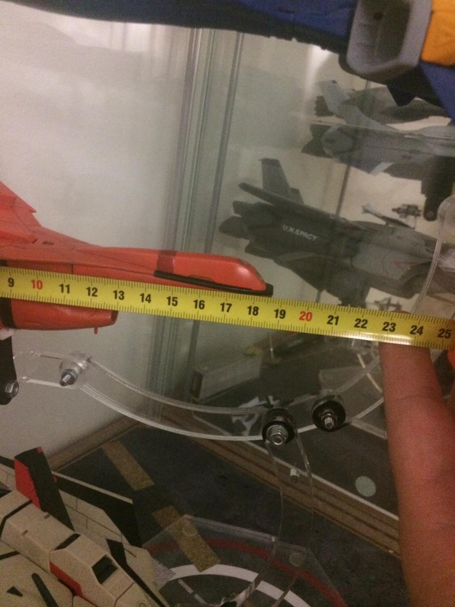

Xigfrid Posted October 22, 2015 Posted October 22, 2015 (edited) Oh can you tell me what the total length of the drone will be? I measured it from tip to nose: 18,50 cm. As this measure is actually a diagonal, the drone is a little shorter. Edited October 22, 2015 by Xigfrid Quote
spanner Posted October 22, 2015 Posted October 22, 2015 I measured it from tip to nose: 18,50 cm. As this measure is actually a diagonal, the drone is a little shorter. that's excellent thanks Xigfrid! Its quite a large thing isn't it! This thing is gonna look mega on display! Just wanted a rough idea of its size so I can plan some space.. Quote
