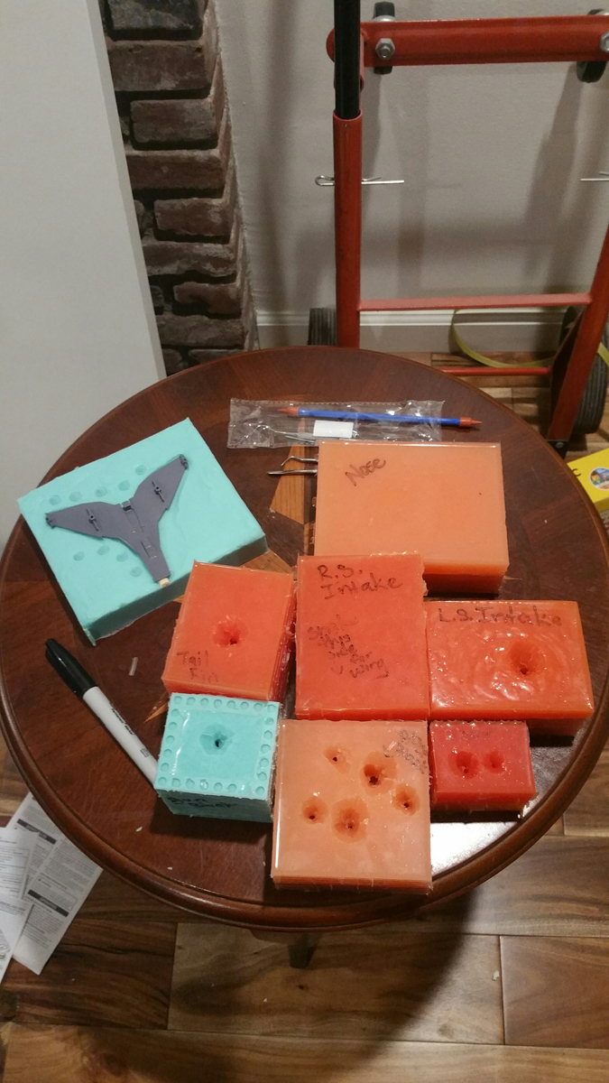

Jasonc Posted September 25, 2015 Posted September 25, 2015 Here's what's going on with the molds. These aren't all of them, just the few that are readily available (not in the garage). I have two that are half way done (3 including the 1/72 wing shown, and so I'm about done with them all. Sorry for the bad picture. In other news regarding this, for those that ordered the 1/72 scale, what do you all think about getting the parts in the orange color? The reason I ask, is that at this point, there are two pieces I have little resin for to cast in a black/dark grey, and while I have plenty of resin, I'm not really wanting to split up the resin and try to figure out how much to separate for each scale. If the majority of you absolutely need it in white, I'll make the arrangements, but it'd make it much easier for me. In any case, let me know here. Thanks. Quote
