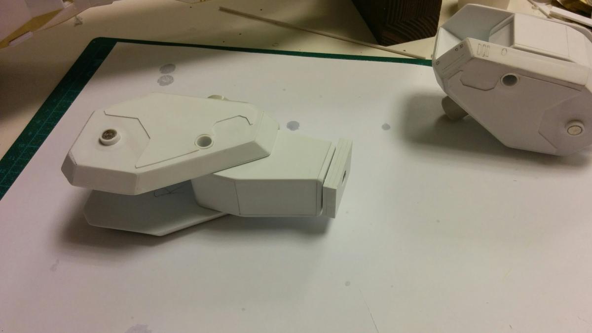

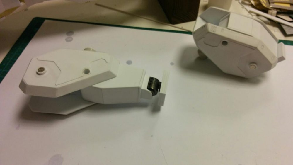

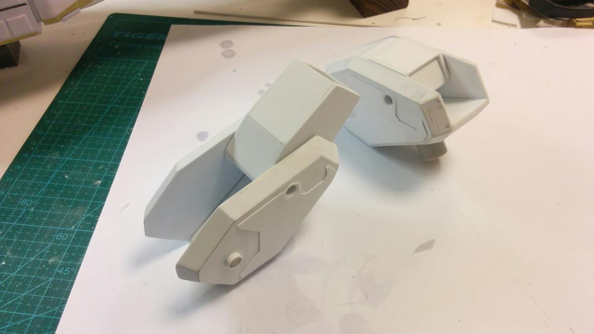

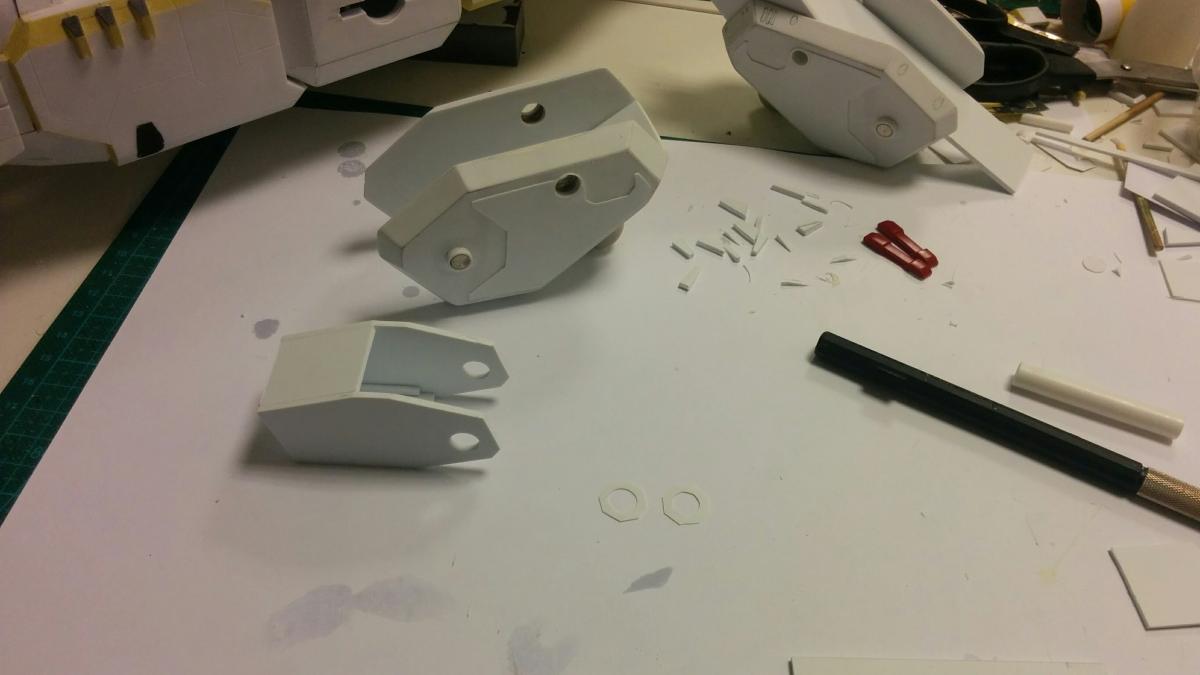

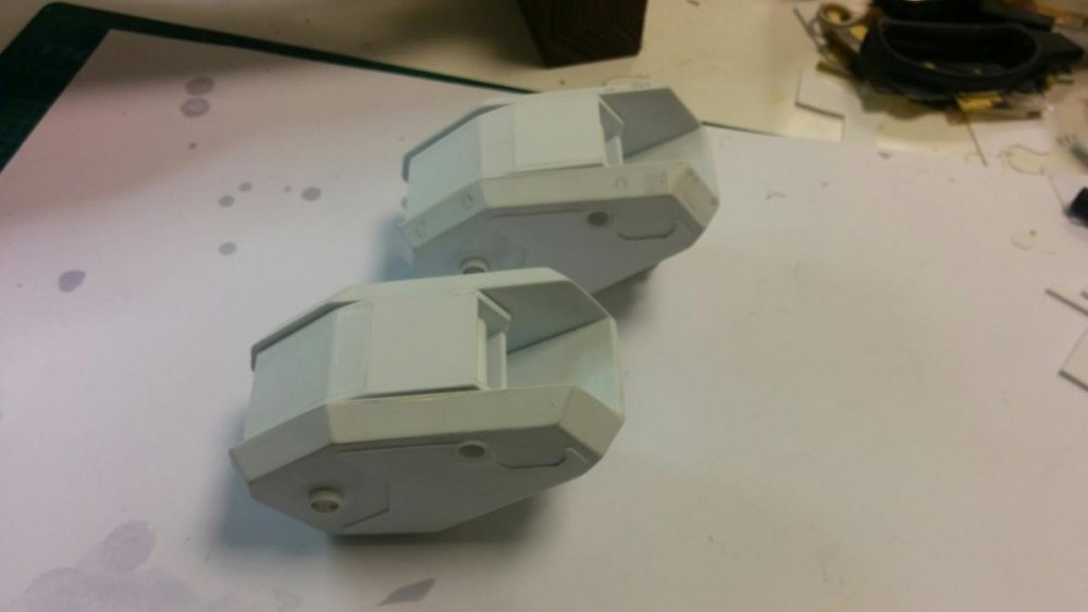

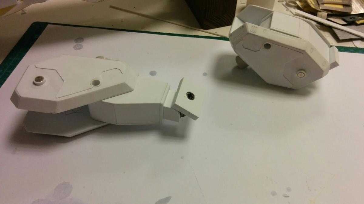

Mostly done with the actuator part of the "arms"
need to still make the connectors "docks" for the ships
and put in a hangar in those also. :p
post-14728-0-91279800-1453929301_thumb.jpg post-14728-0-87244200-1453929303_thumb.jpg
post-14728-0-04956400-1453929305_thumb.jpg post-14728-0-33758700-1453929306_thumb.jpg
post-14728-0-55913000-1453929307_thumb.jpg post-14728-0-77431100-1453929308_thumb.jpg

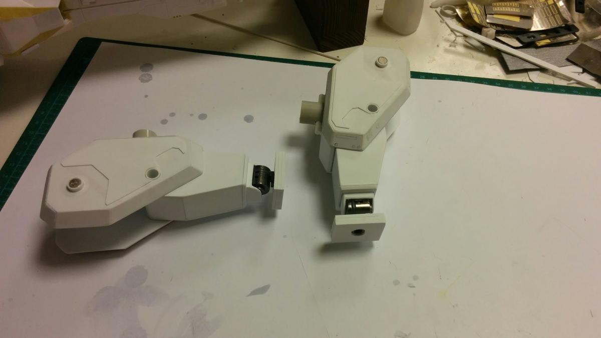

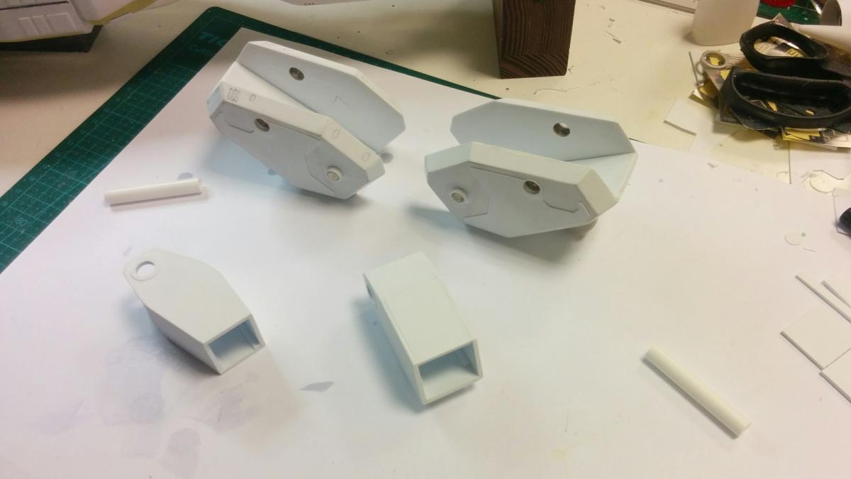

the actuator is pretty much finished...
found some some strong click joints online from a broken DX Chogokin Macross Quarter..
need them to be able to hold the weight of the two ships Daedalus and Prometheus.
also made the actuators slide-able so that the joints can be hidden
in cruiser mode....

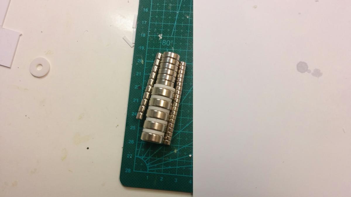

i received the magnets im planning to use for this build ^_^
already used some of them ;)
some heavy duty ones and some close to the last ones i ordered...
16 mm x 6 mm 49 newtons
13 mm x 4 mm 26 newtons
06 mm x 3 mm 09 newtons
03 mm x 6 mm 04 newtons
Strength: 10 Newtons ~ 1 kg

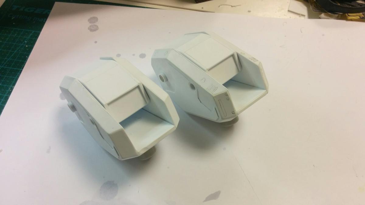

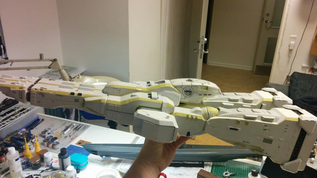

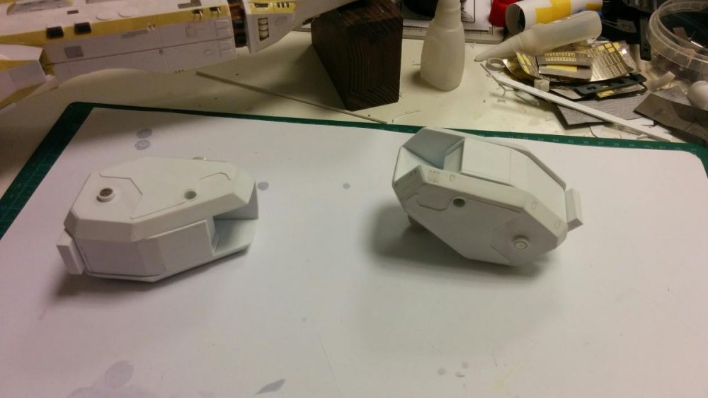

so finally the Main Cannon is attached.. :D
used 13 mm x 4 mm magnets to keep the two sides together.
and 16 mm x 6 mm to connect the cannon to main body
post-14728-0-97130300-1454710489_thumb.jpg post-14728-0-24227300-1454710492_thumb.jpg
its getting kinda heavy :blink::rolleyes:

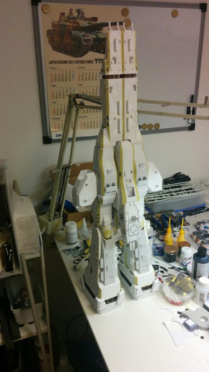

That thing is HUGE!!! The earlier pictures make it look large,. but not like almost a meter! Looking great so far! Are you gonna vacuform the bridge? - MT
had a friend help me hold the ship while i took a picture B))
and she wants to stay anonymous :p
Nice scale reference, that thing is coming together nicely.

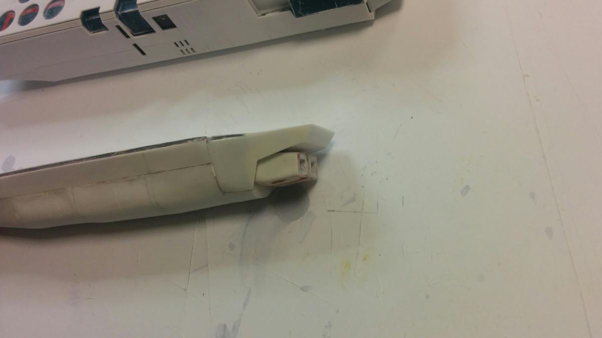

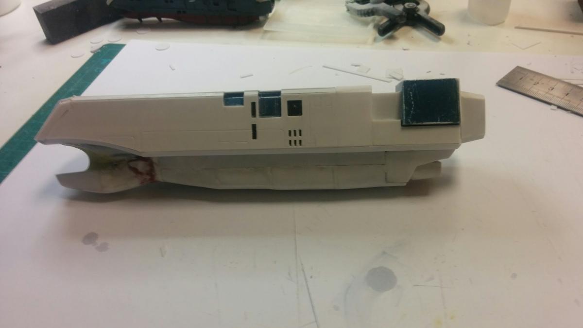

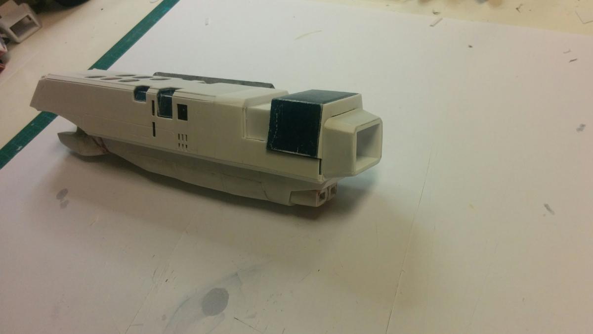

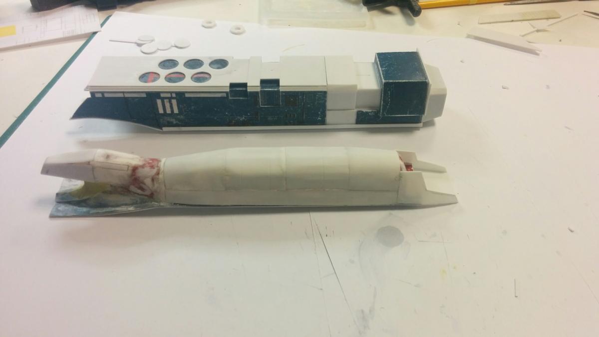

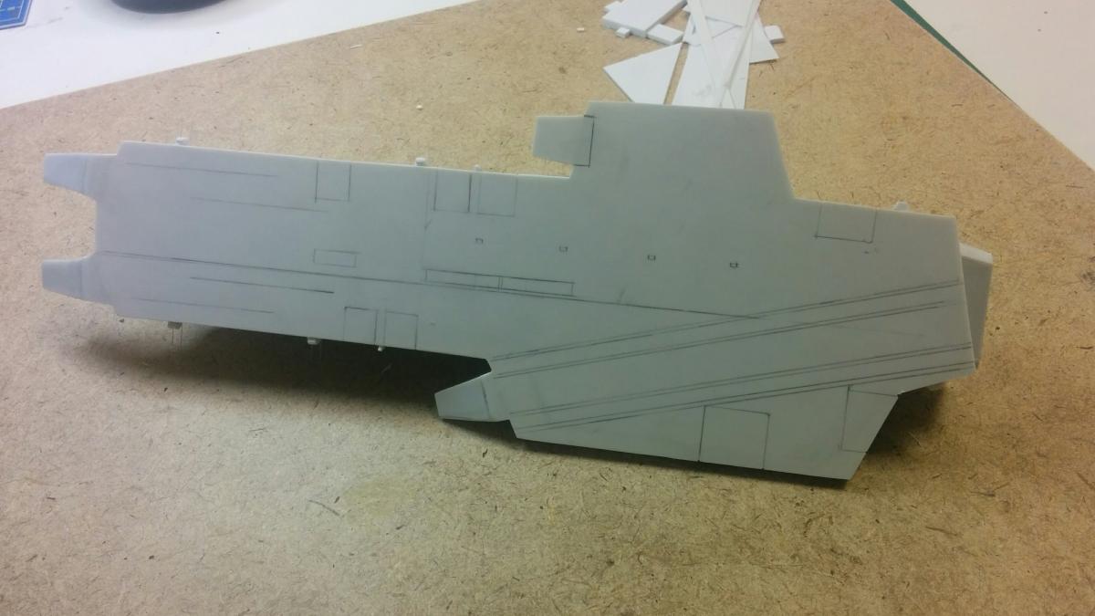

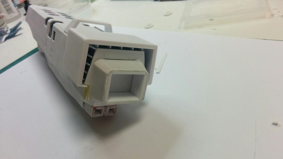

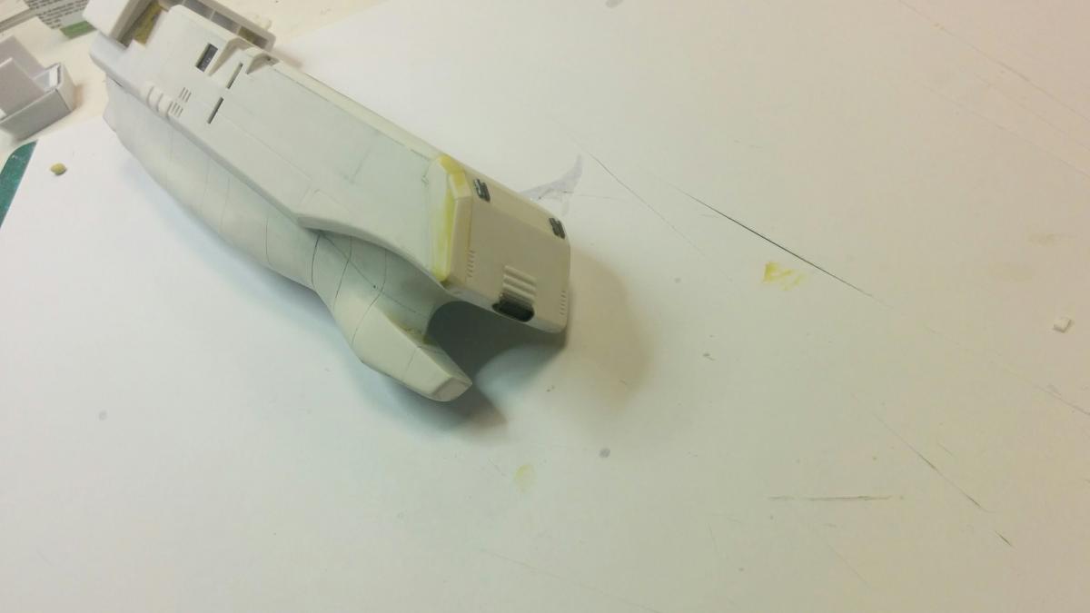

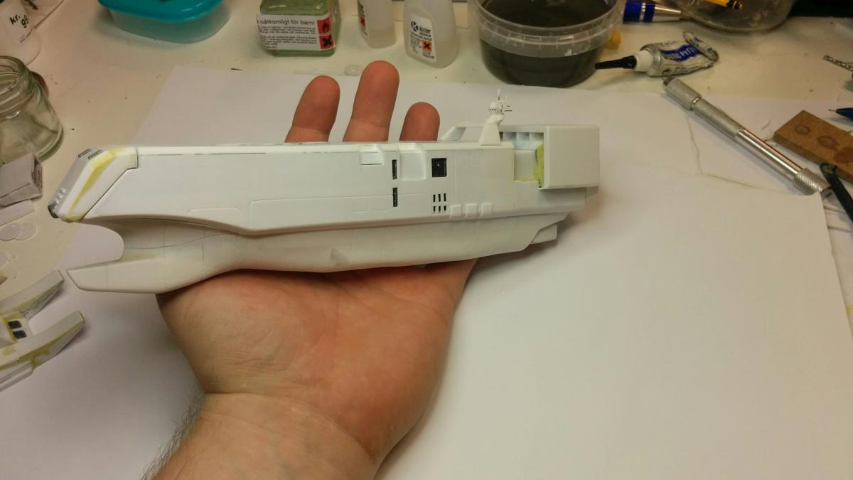

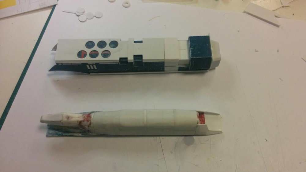

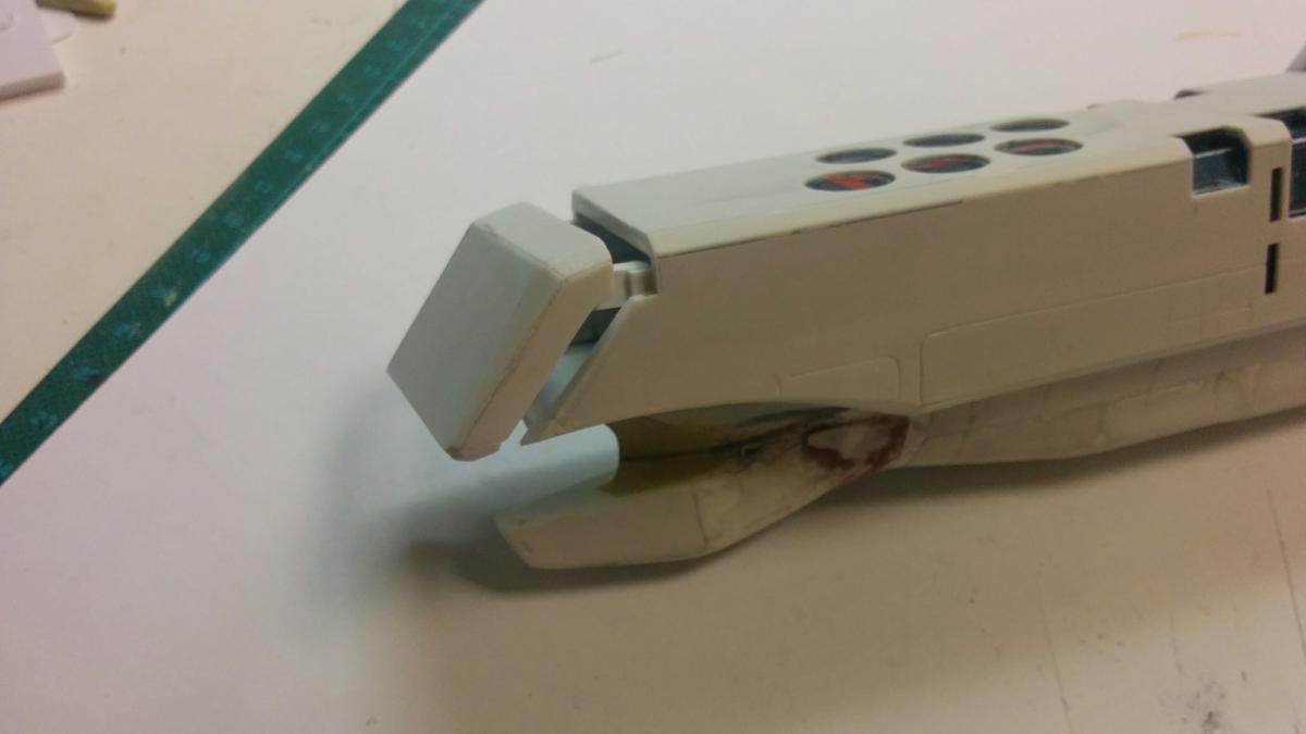

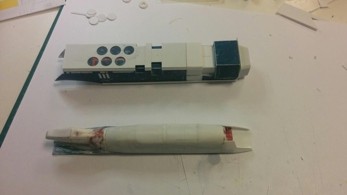

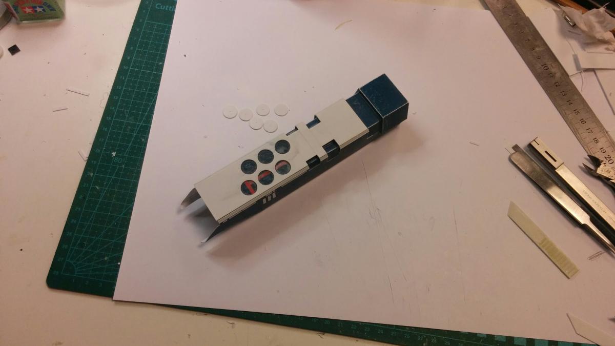

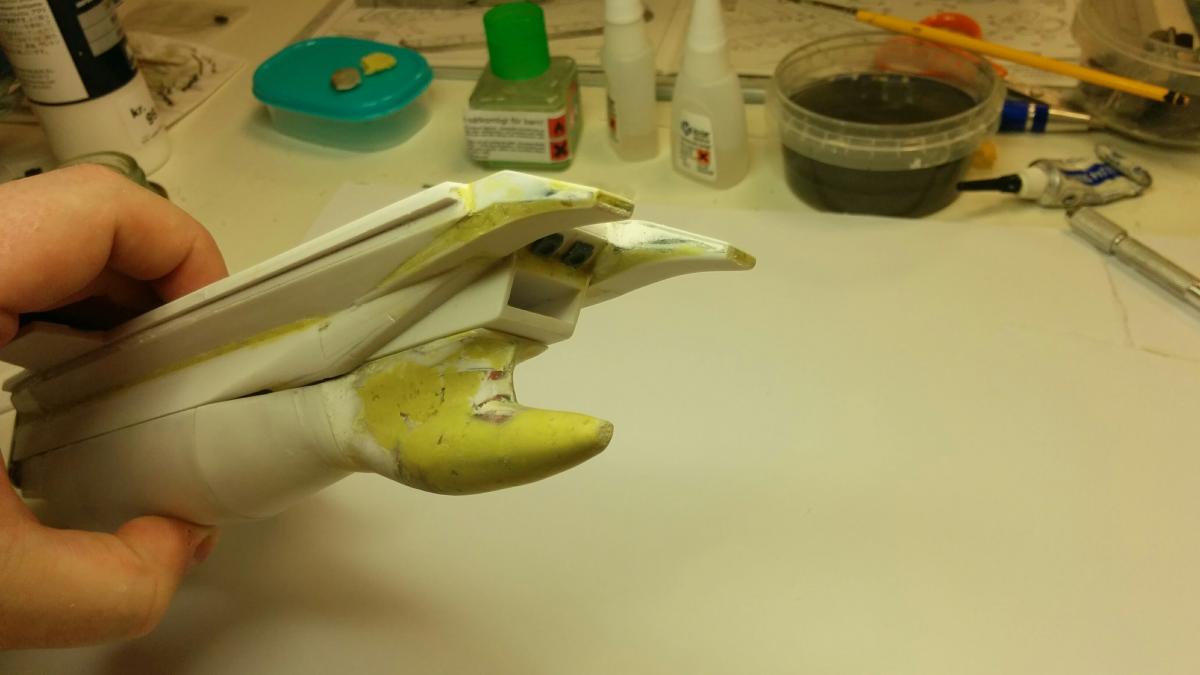

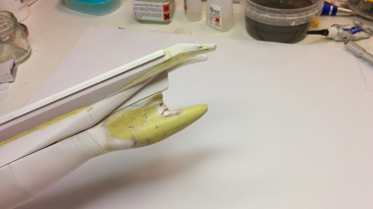

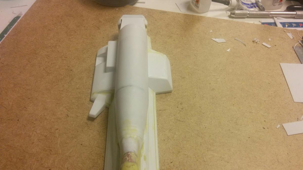

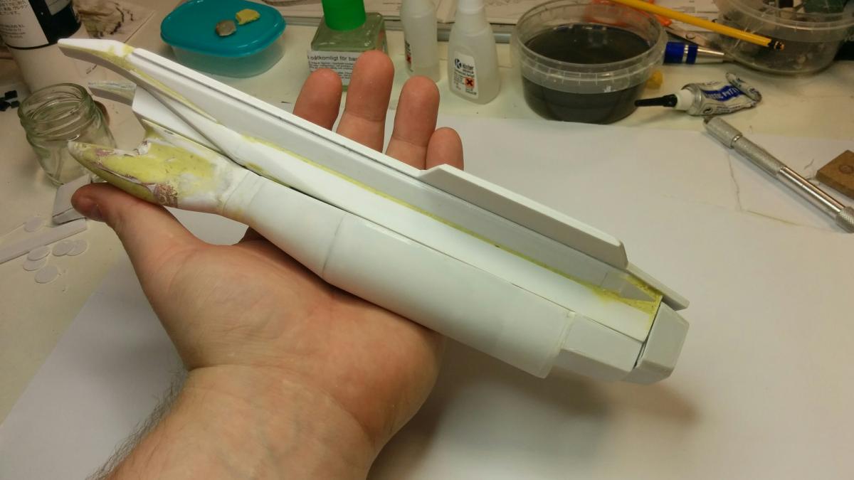

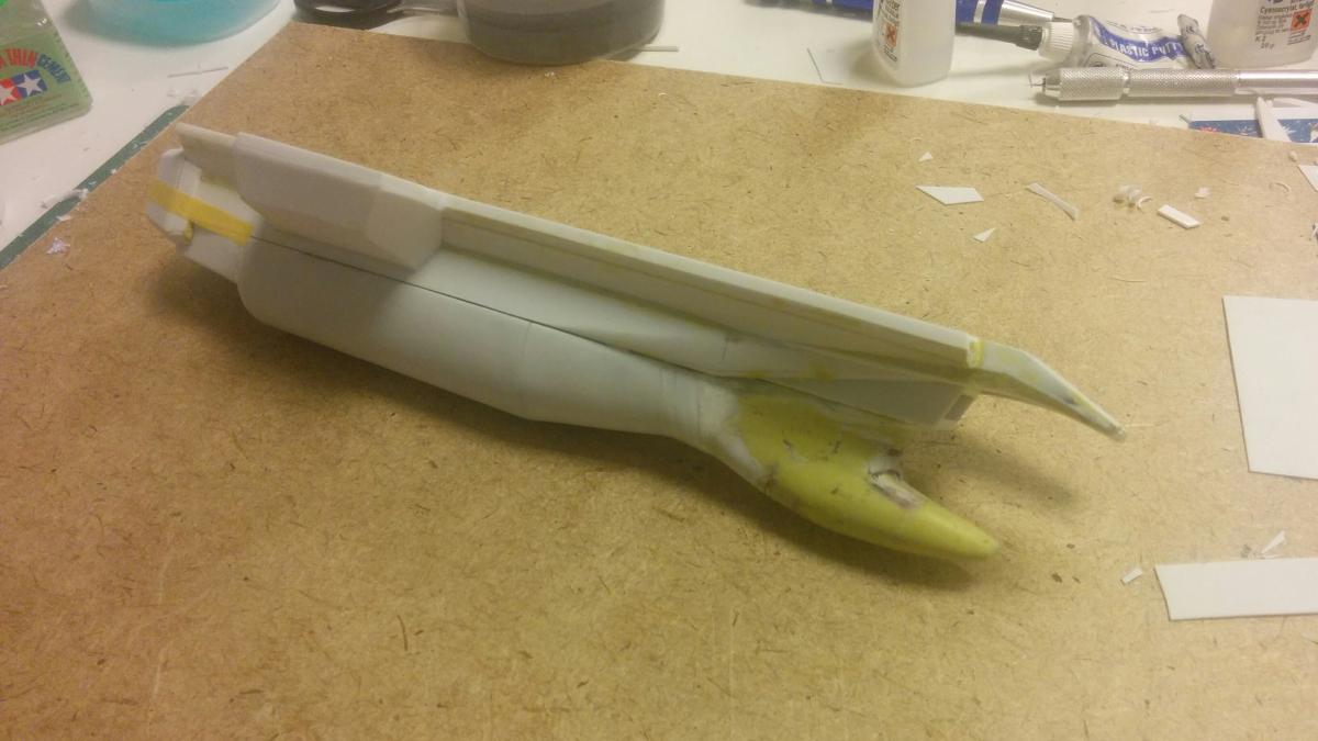

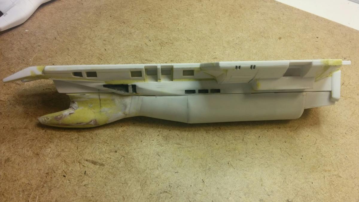

made some more progress on the Daedalus..
had to lengthen it a bit, and i added 2 cm :o
also changed the design of the back end of the keel to accommodate for the extra lenght
and also it looks alot better imo. ;)
post-14728-0-61988500-1455052528_thumb.jpg post-14728-0-66604600-1455052530_thumb.jpg
post-14728-0-96149600-1455052531_thumb.jpg post-14728-0-16478600-1455052533_thumb.jpg
post-14728-0-40462600-1455052534_thumb.jpg post-14728-0-56405300-1455052535_thumb.jpg
not quite finished but its getting there...
I may be biased, but it looks good! - MT
Forgot to take pictures today, but i have been sanding all day it looks a helluva lot better now..
also built a slide and open for the front Hatch. ^_^

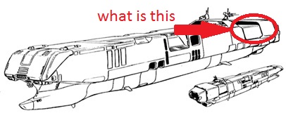

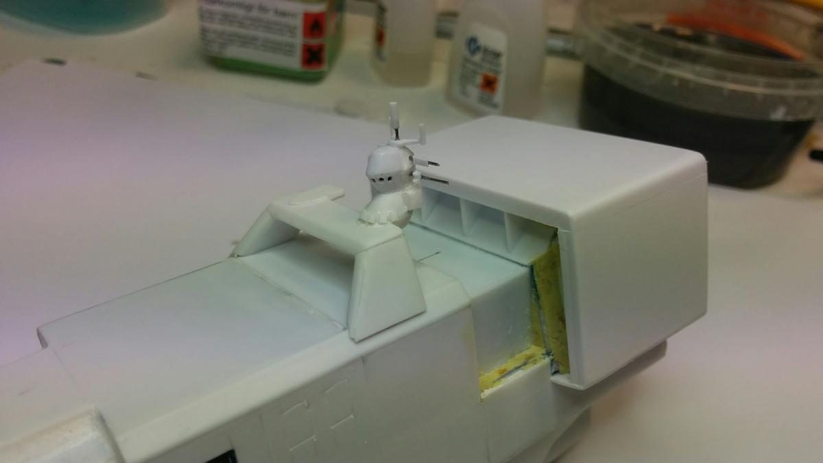

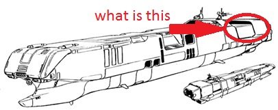

Btw. anyone knows what this is, or what function it serves:

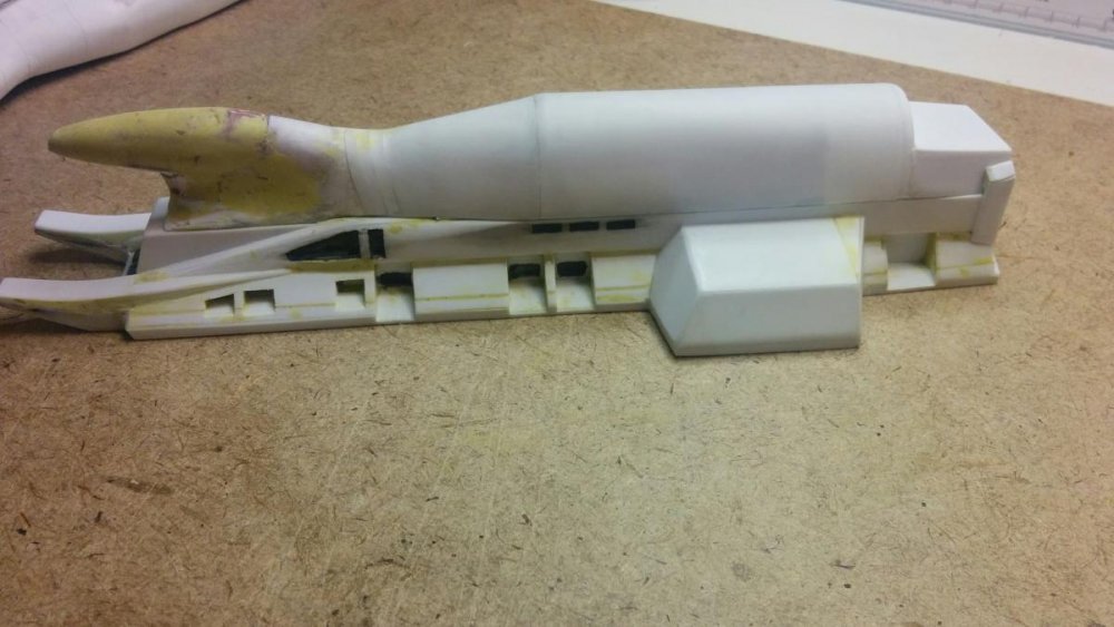

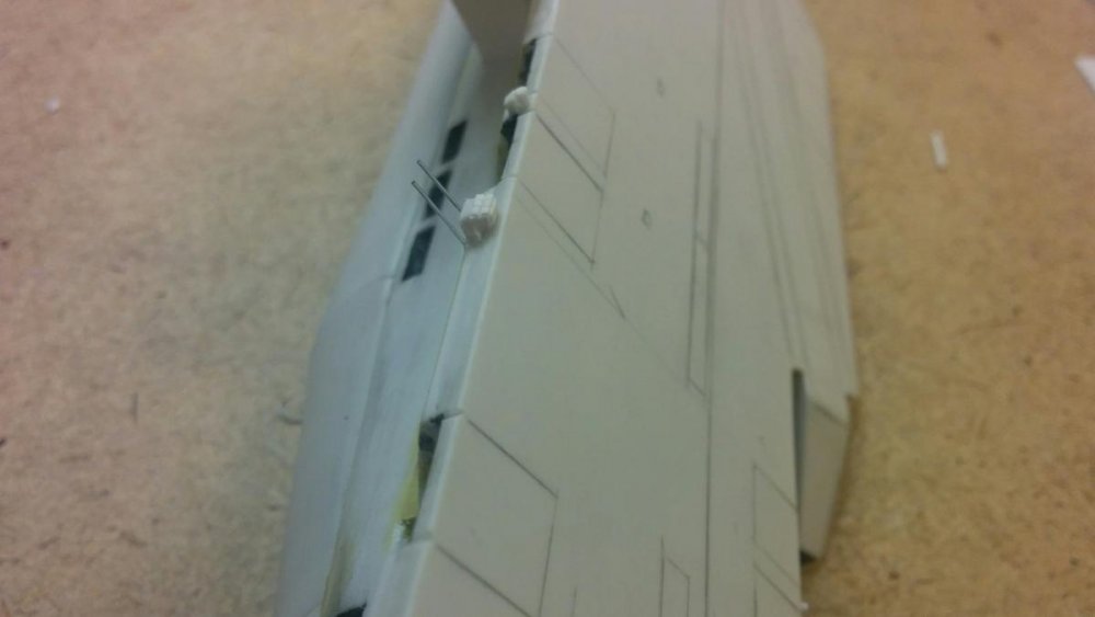

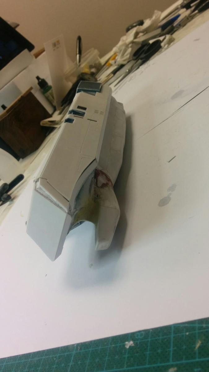

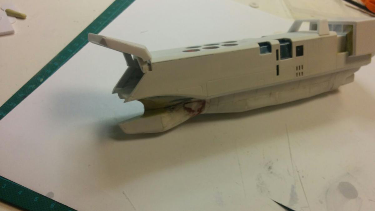

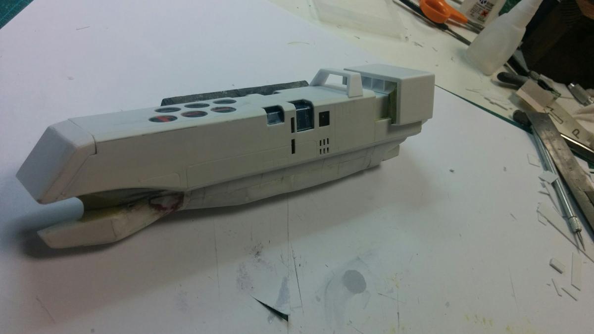

a bit more done...
added the back shell, whatever it is! :huh:
also made the bridge boom/spoiler,
and as mentioned in a previous post front hatch hinges. B))
post-14728-0-80997000-1455310745_thumb.jpg post-14728-0-35345500-1455310748_thumb.jpg
post-14728-0-68020900-1455310749_thumb.jpg post-14728-0-94387500-1455310750_thumb.jpg

Second me in! Even that "little" Daedalus is huge! That area circled is where a crane is supposed to come out of. I got all the translations back a few years ago. The bridge has a crane with cable spools under it, there is supposed to be cargo doors on the side that open, and then a crane supposedly slide out of the side, but it is never seen in the anime or drawn in books. - MT
ahh makes sense... always looked like it could slide and open up, but never could find any info on it.
thanks MT ^_^

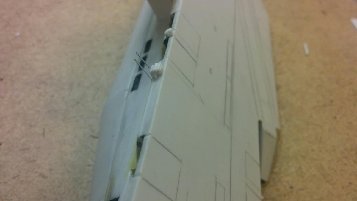

a small update. ^_^
added some details to the front hatch of the daedalus
and also panel lines, and a prime layer of paint on the keel
to se if it looked alright :p

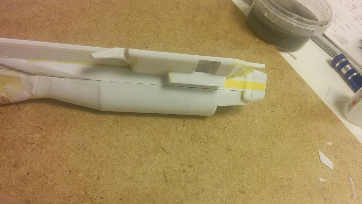

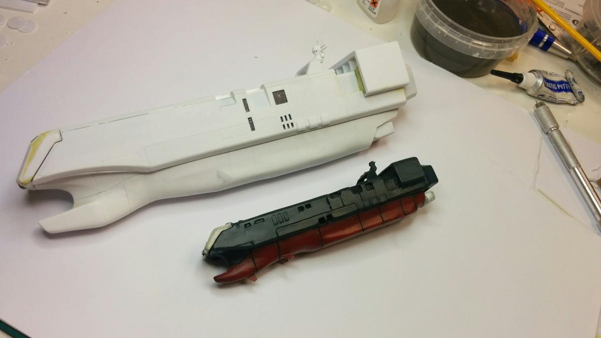

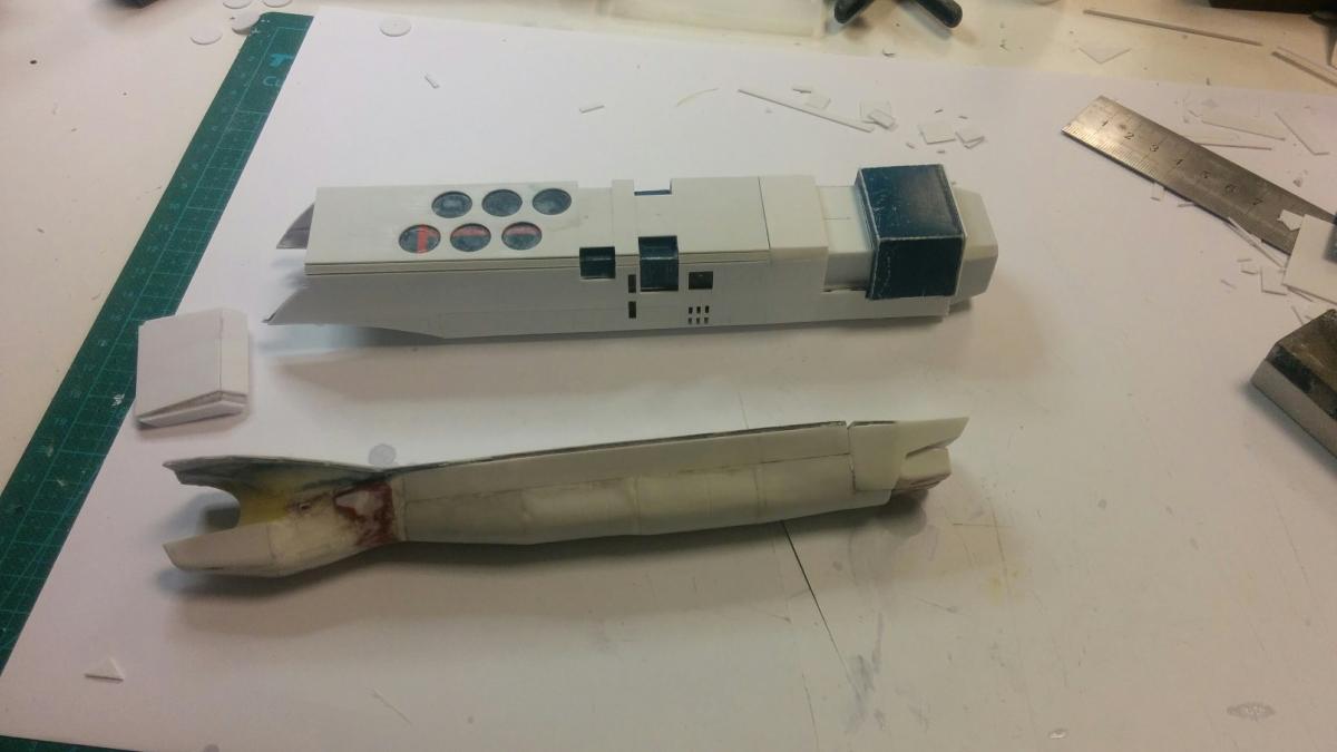

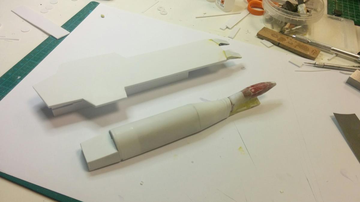

started on prometheus :rolleyes:
pretty much scrapped everything except the keel..
added lenght to the ship and made the top deck slightly slimmer B))

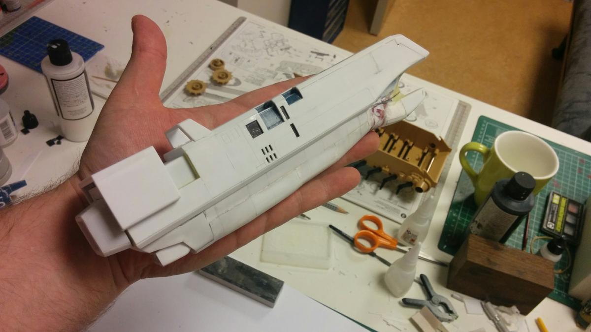

Catching up after being away for a while… I had to check back in the history of this thread because I wasn't sure this was still a paper model project!
It's really amazing, and I'd never think it was made of paper after looking at the photos.
I'm curious to know how it holds its weight and whether or not it is very fragile? I'd imagine it would be easy to accidentally buckle the shape if you held it in the wrong place. Is there a lot of internal bracing necessary?
How much does the model weigh right now? How much did the paper craft book weigh before you started the model? It would be interesting to know the ratio of paper to other materials.
Thanks for sharing the details of this build! It's really great.
its definitely not fragile B))
the large pieces are reinforced on the inside, some parts are made with 3mm thick styrene sheets
the parts that needs to hold weight are heavily reinforced...
it sounds like resin when you knock on the parts ^_^
all surfaces have styrene layer/layers, cyano acrylate (super glue) adds ton of strength to both paper and styrene
it weighs roughly 2 kg / 4,4 pounds
maybe 300 grams/10.5 ounces of that is paper/cardboard
some parts have been made entirely out of styrene....

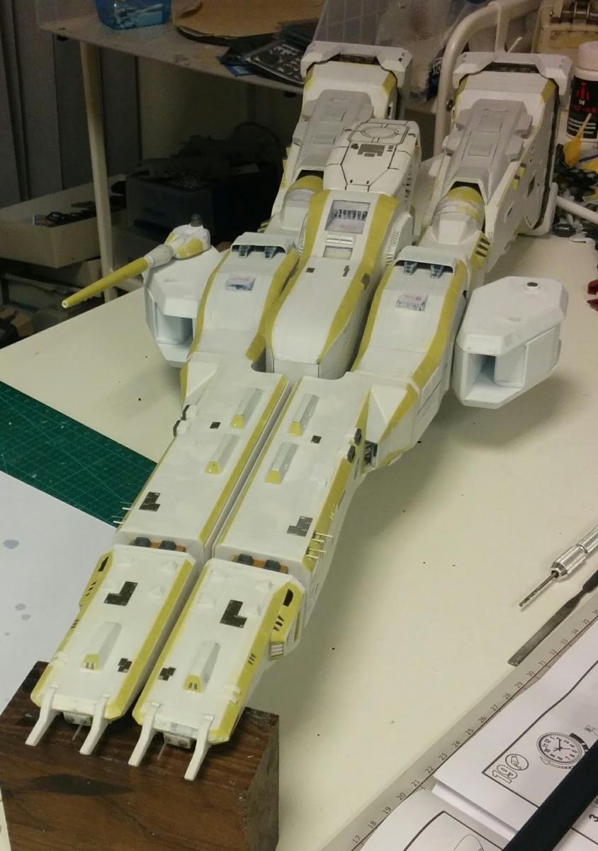

a little progress!
got some more done on Prometheus ^_^

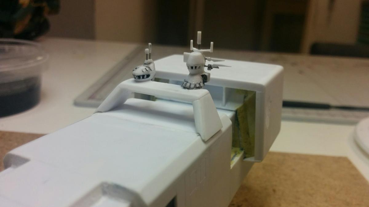

a litte update!

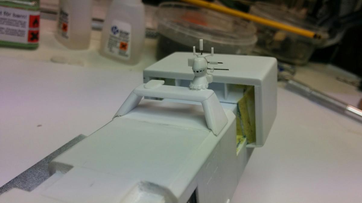

made antennas, small missile launcher and anti air emplacements on Prometheus, still need a bit more..
also next id probably make the bridge...
also drew roughly what the "deck" will look like, not final! ;)
