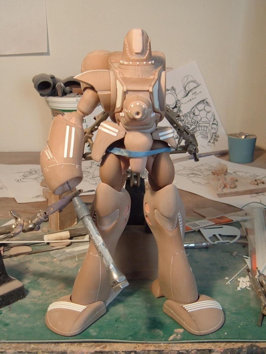

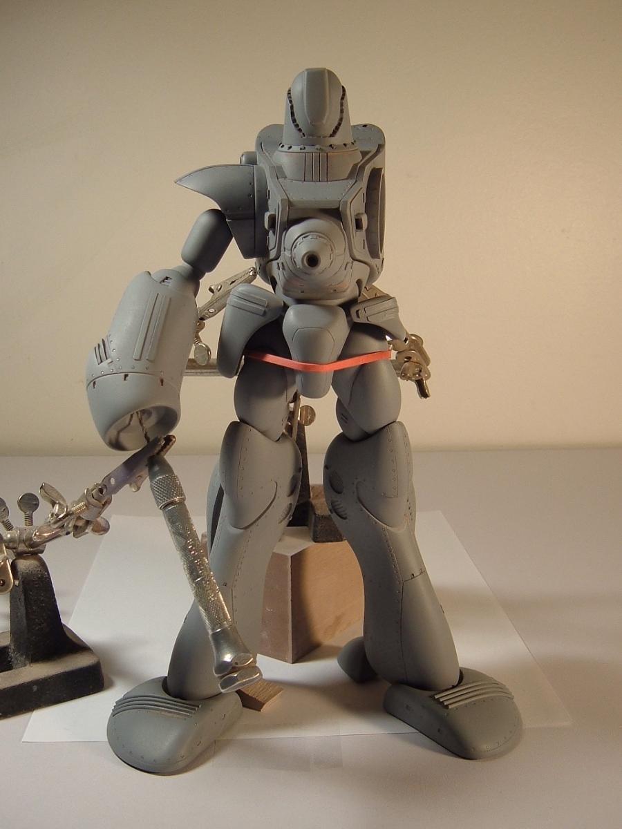

I was gonna clown about the pinvise stuck in the hand of the model, but real pain- OWEEEEEeeee! Heal up! - MT
It really isn't all that serious guys, I've mangled myself waaay worse in the past and lived to tell the tale. I was already back to work yesterday and will have an update for you all on Friday. :D
Phil: never hurt myself with a pin-vise, but this one time I did have a little incident with a box-cutter... :unsure:
He he, I was talking about the model photo with the pin vise in it, but oweee again. I tore my thumb open disconnecting my shop vac for cleaning when the screwdriver slipped out of the connecting tab. Two weeks later it's finally healed!
Glad your back at the bench!-MT

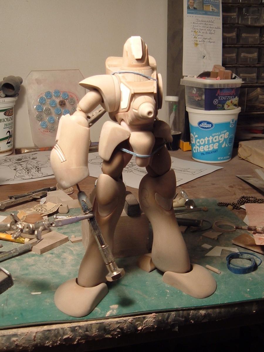

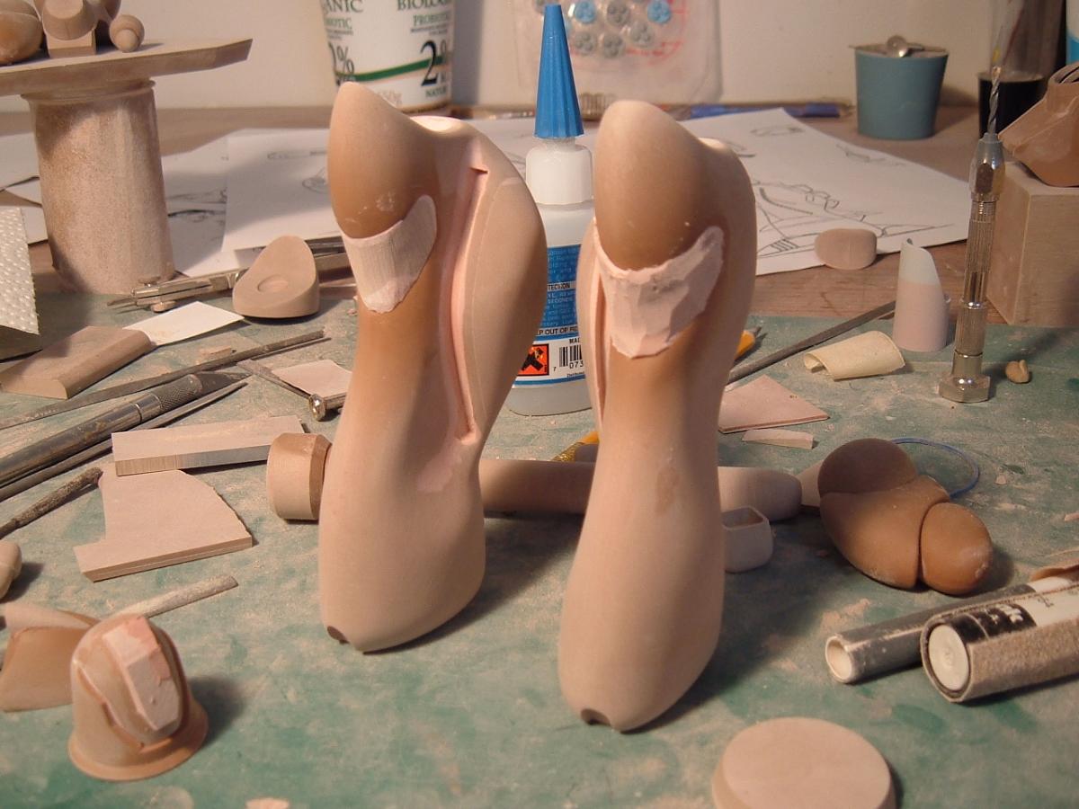

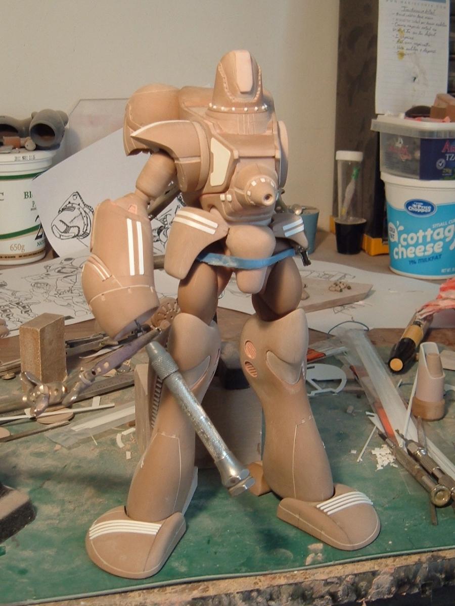

DSCF5317: a little bit of putty work on the lower legs is the opening attraction for this update. The piece on the left having been sanded-down while the leg on the right is still hardening. One useful trait with polyester putty is that it goes through a rubbery pre-hardening stage whereby you can carve excess putty with a sharp knife to minimize sanding and grinding once it's fully hardened.

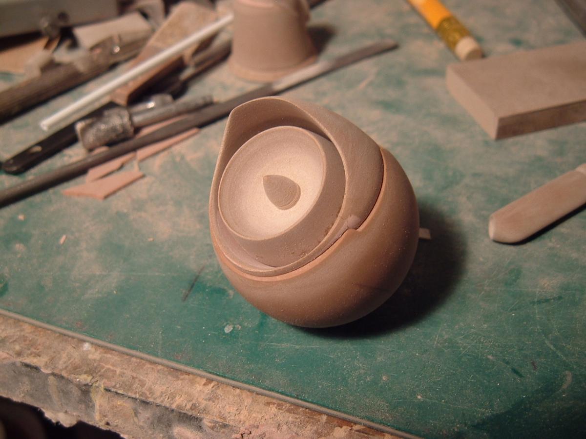

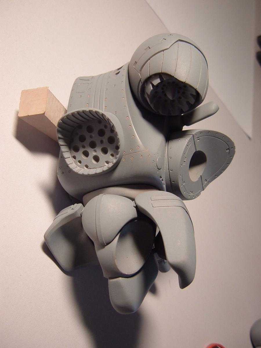

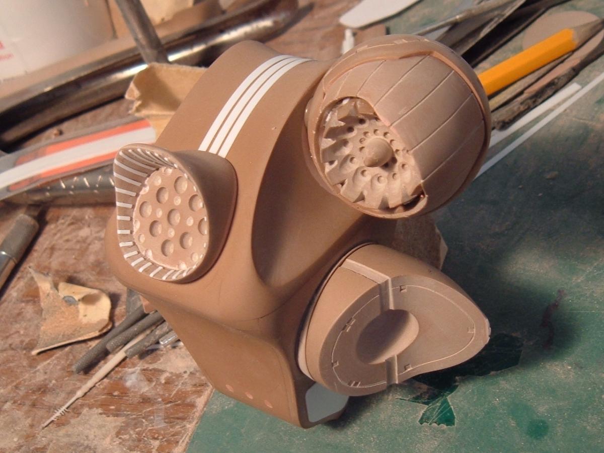

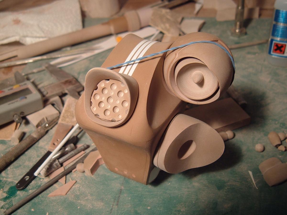

DSCF5318: one of the thruster balls which is now almost completely shaped and awaiting details.

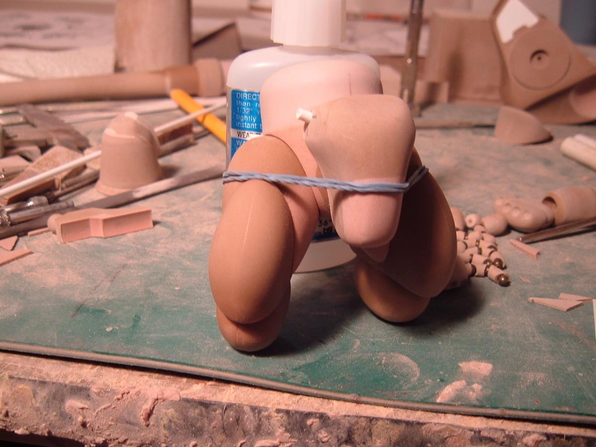

DSCF5319: the hip/thigh/crotch-guard. I took care to try to keep the attachment system for the hip pockets as close to the line-art as possible.

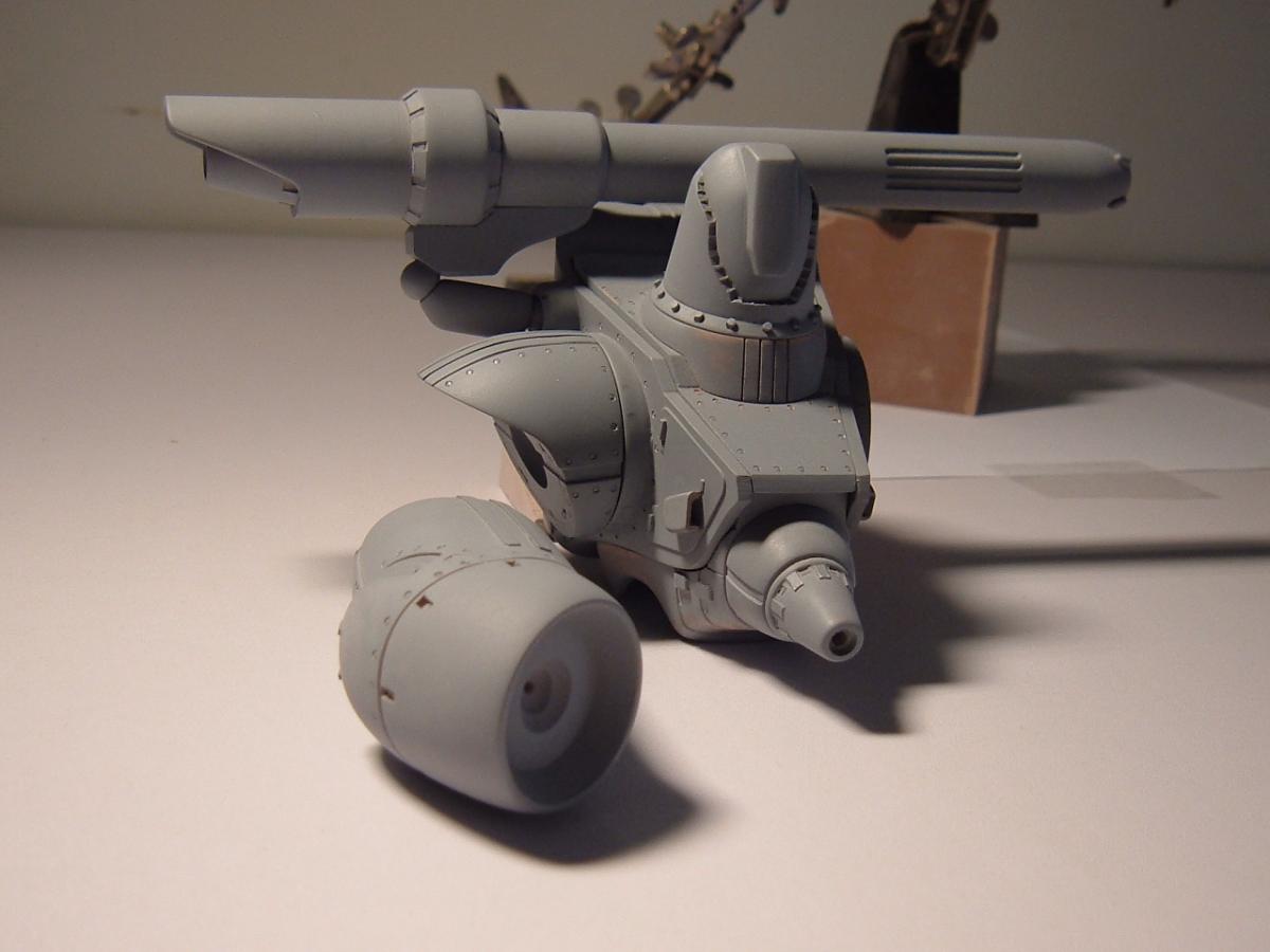

DSCF5320: the back-pack with the thruster units temporarily affixed. More detailing and slight changes yet to come.

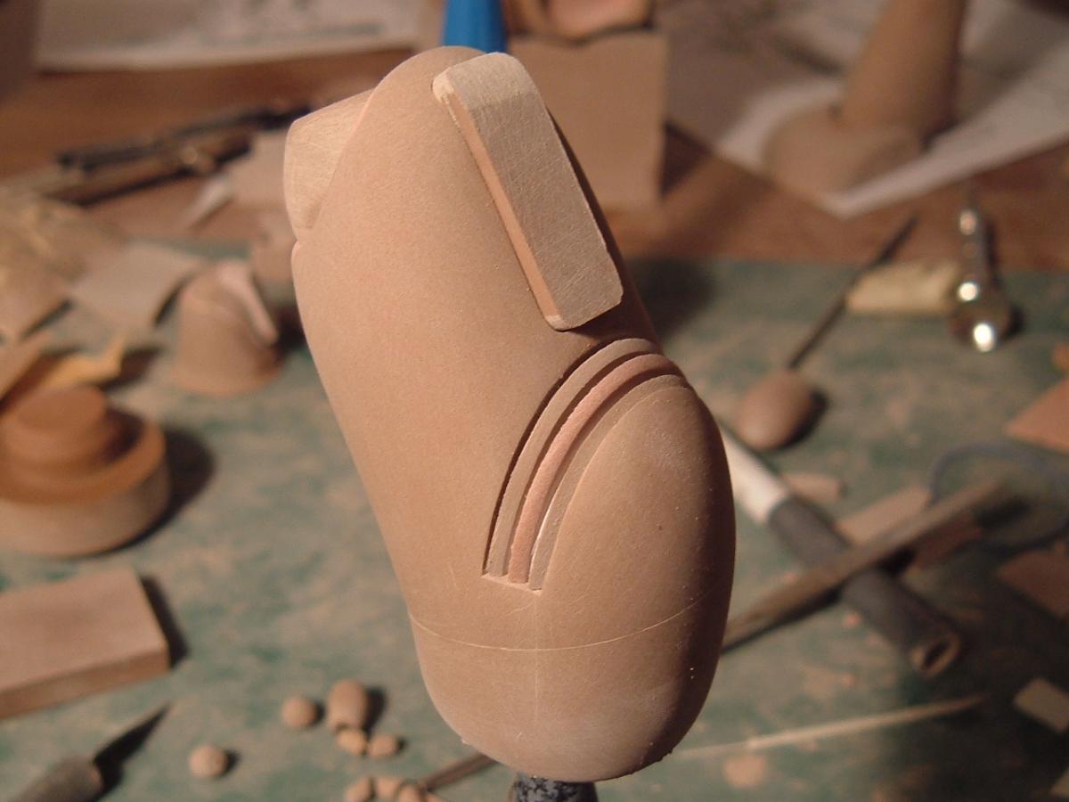

DSCF5321: the forearm unit showing the "bands" that run across the outer portion. I decided to make these vents and spent an inordinate amount of time carefully crafting these to the shape of the arm. I probably could have just scribed them but I felt that the extra touch was worth the effort.

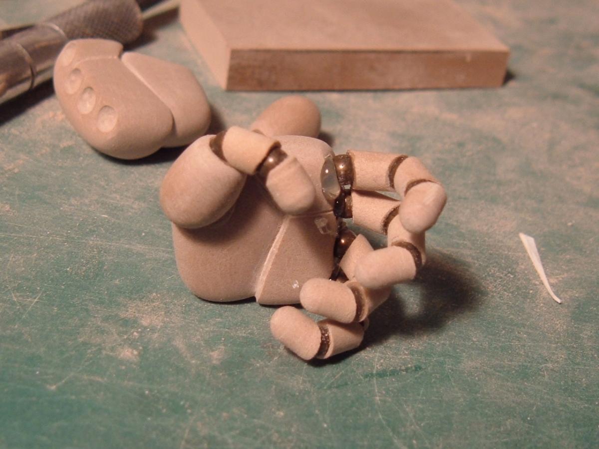

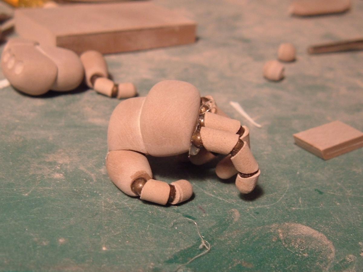

DSCF5322-DSCF5323: the hands are another area where I spent significant time and attention. The line-art shows some sort of big knuckle-guard but doesn't elaborate on whether the unit is gloved or not, only that the shapes are rounded. I used the little metal balls that make-up a lamp switch for the knuckles, as I felt that this was a practical knuckle design and they just look cool! Like the 1/32 Legioss, the fingers will be separate.

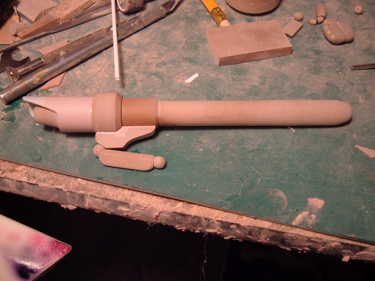

DSCF5324: the main cannon along with the mounting arm. I may shorten the lower arm just a tad to make sure that the cannon sits well centered on the back, but you will have the option to build it with the gun facing forward in attack mode as well.

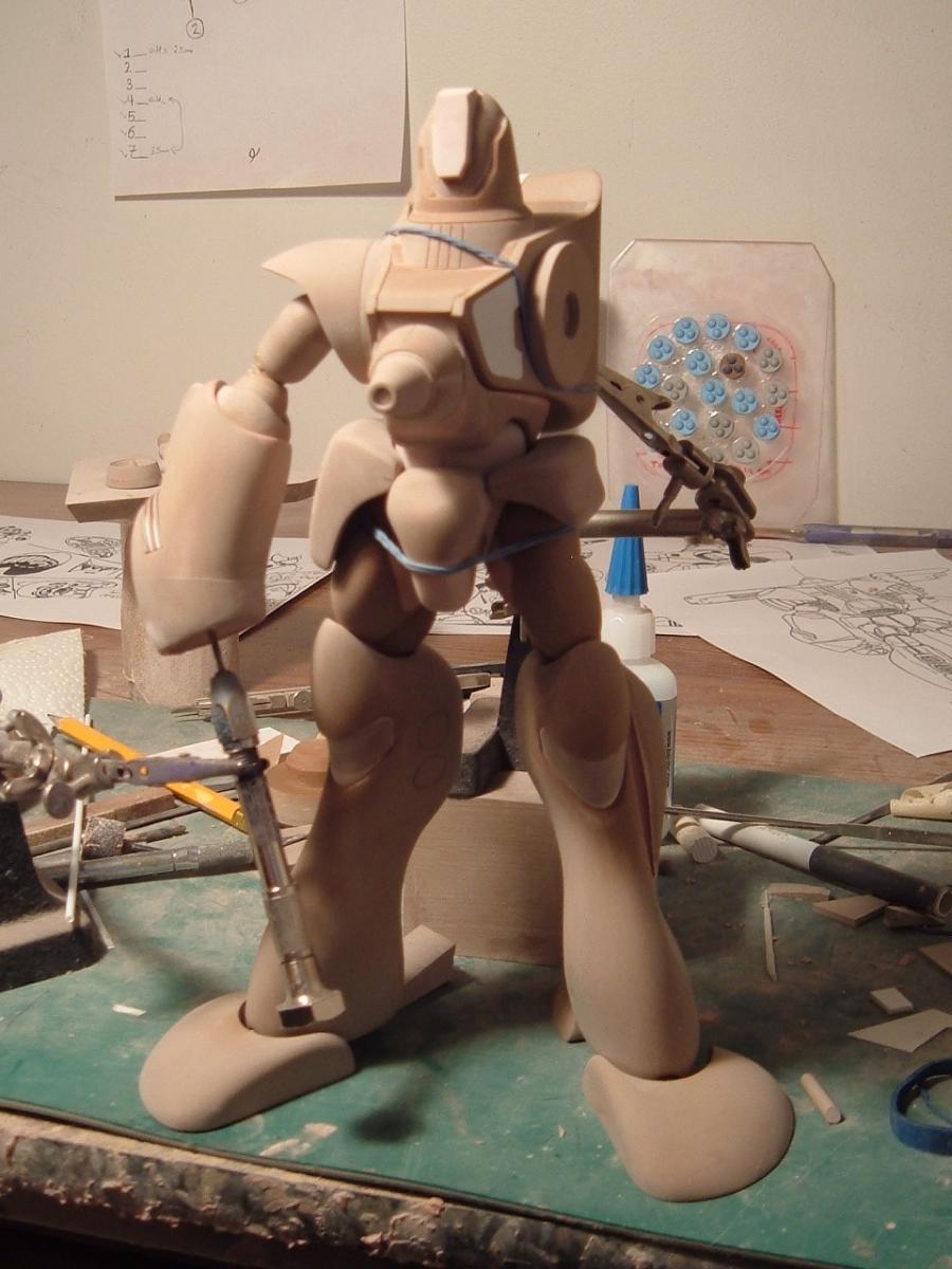

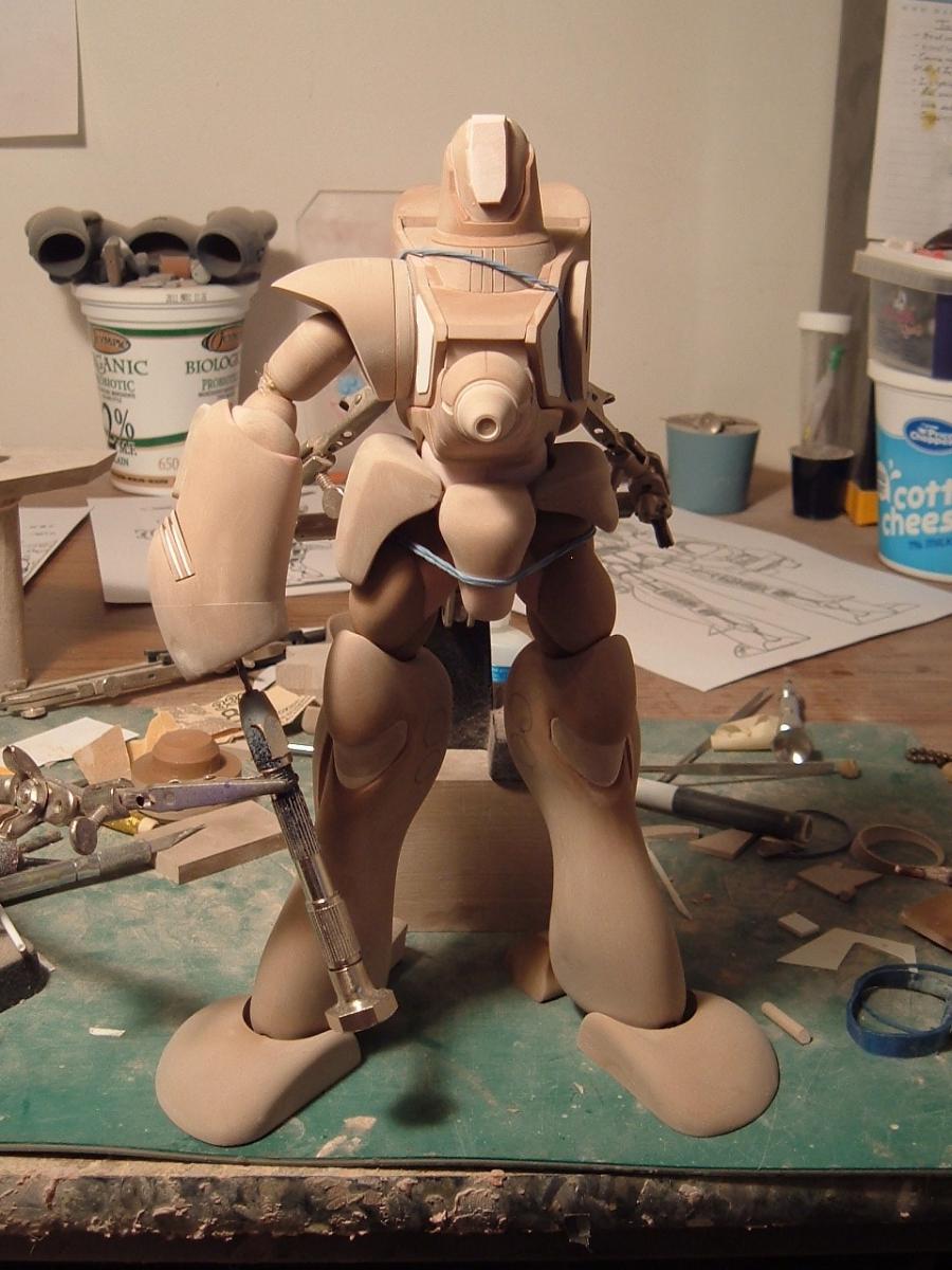

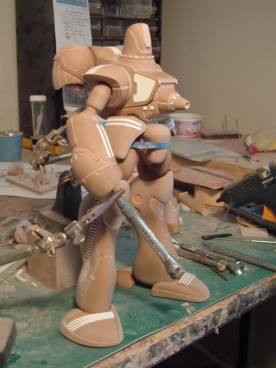

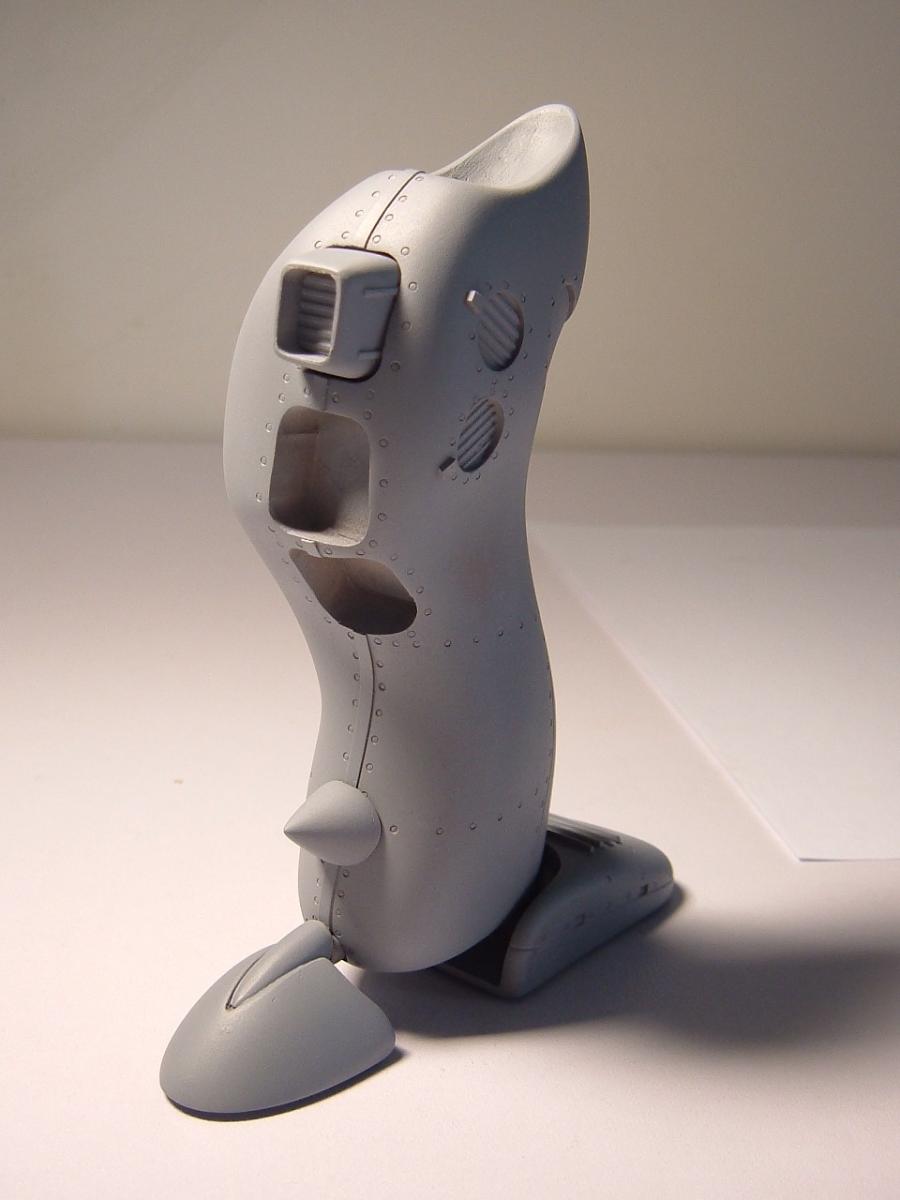

DSCF5325-DSCF5328: this is what it looks like with most pieces hastily-assembled. Most of the big shapes are done and I'm starting to work more on details and the cockpit. I did take a few liverties with the overall dimensions of the body parts. Nothing major, just a little tweek here and there to make it more elegant and less clown-like.
I've always felt that this particular mecha was under-appreciated and had loads of potential. I also wanted to achieve a balance of faithfulness to the line-art and the super-elegant, curvy version that I made 22 years ago. So far I think that I've surpassed my own expectations and I hope that you will approve as well. That's it for this week, so until next time… Play safe!! :D

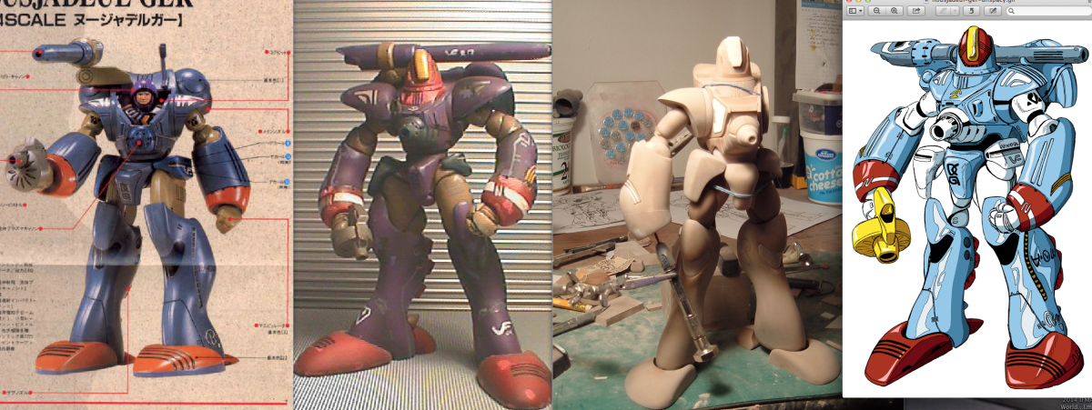

Side-by-side comparison from left to right: the Imai 1/100 (1/144), my customized Imai 1/100, my 1/72 scratchbuild and the line-art.
That's lookin' awesome! Love the hand design and use of the pull chain!- MT

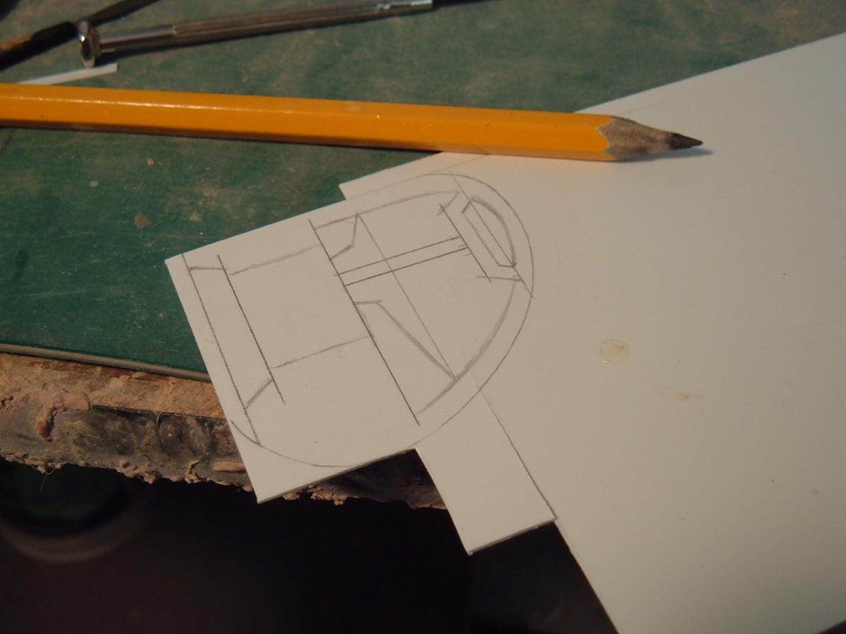

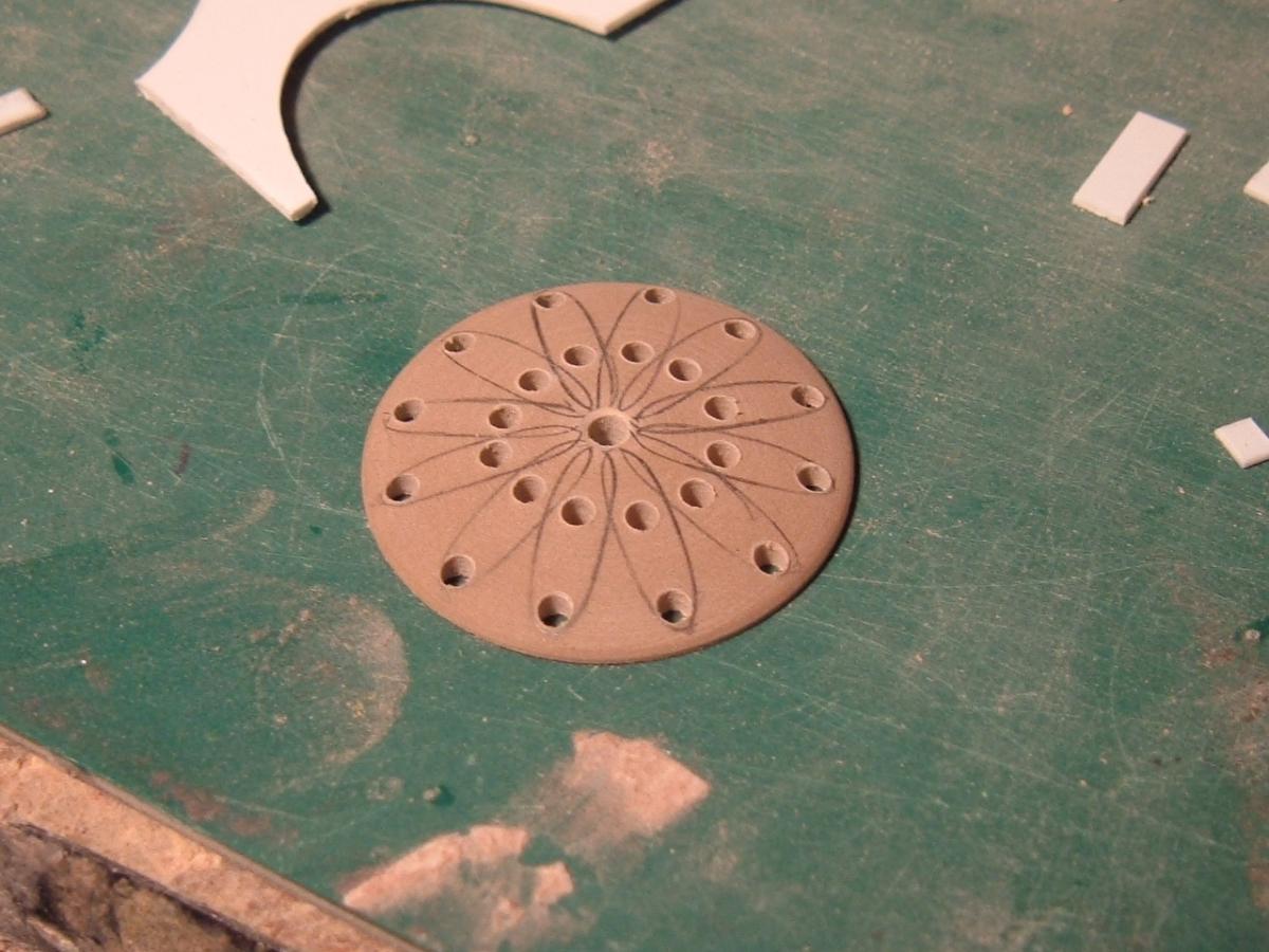

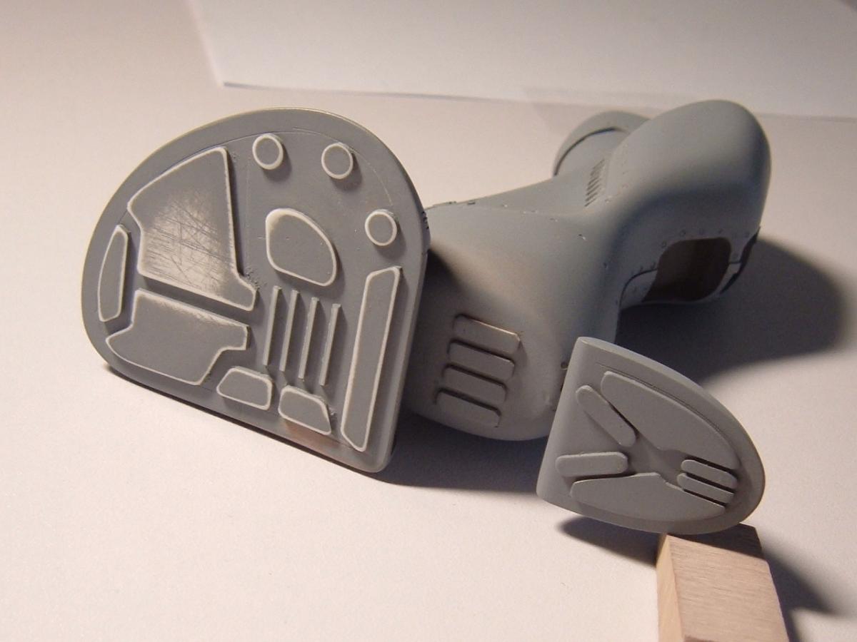

DSCF5341: underside foot detailing in its initial stages of plotting. I don't need to draft both sides since I can just cookie-cut once one side is done.

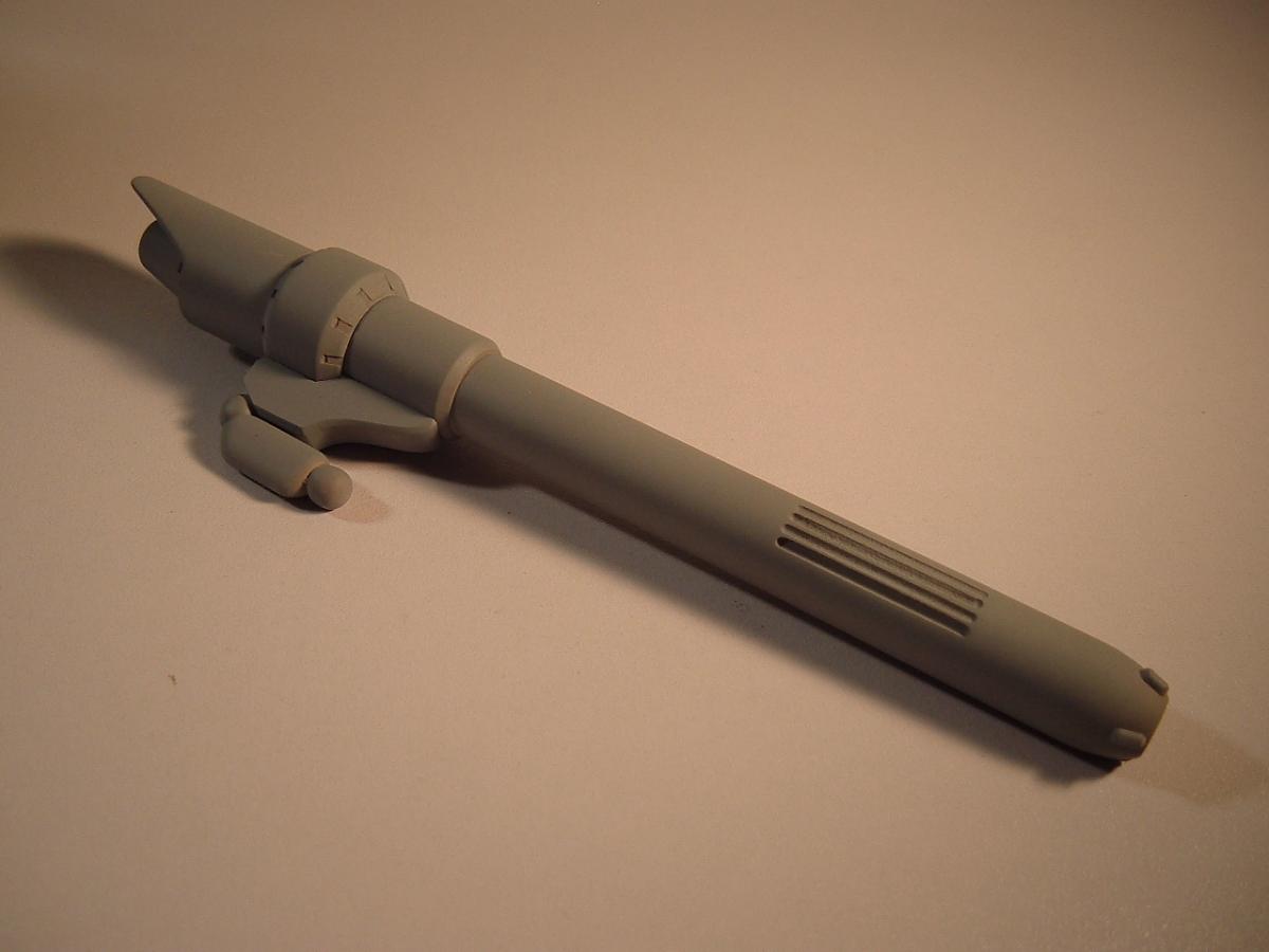

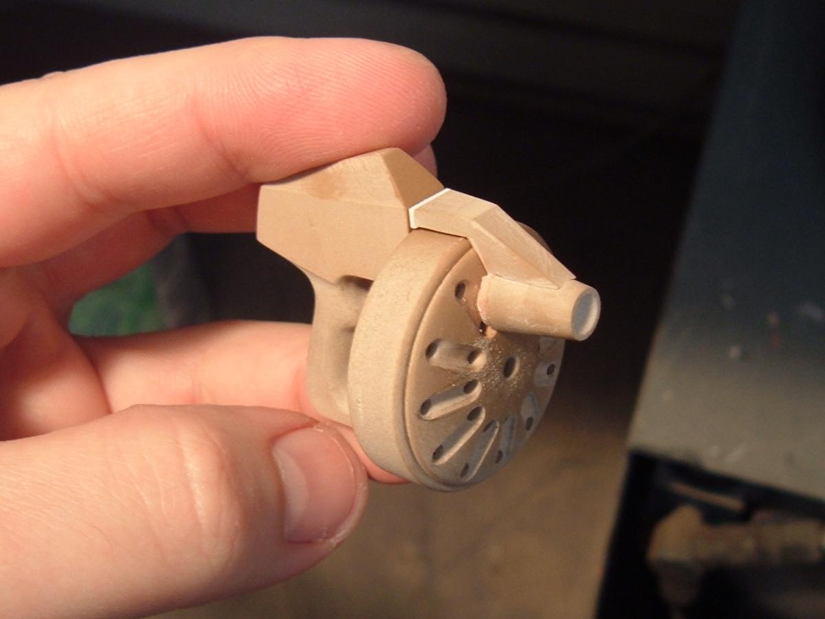

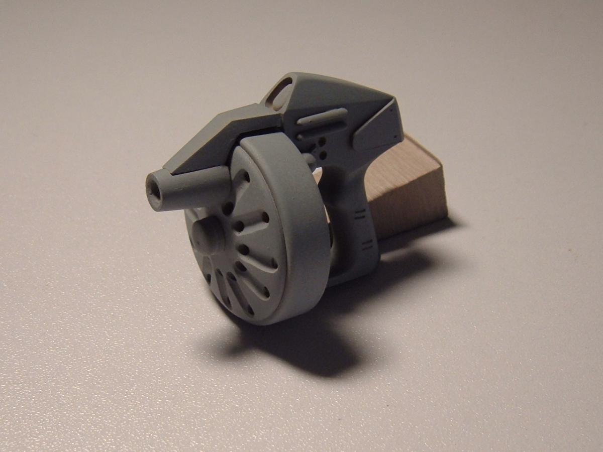

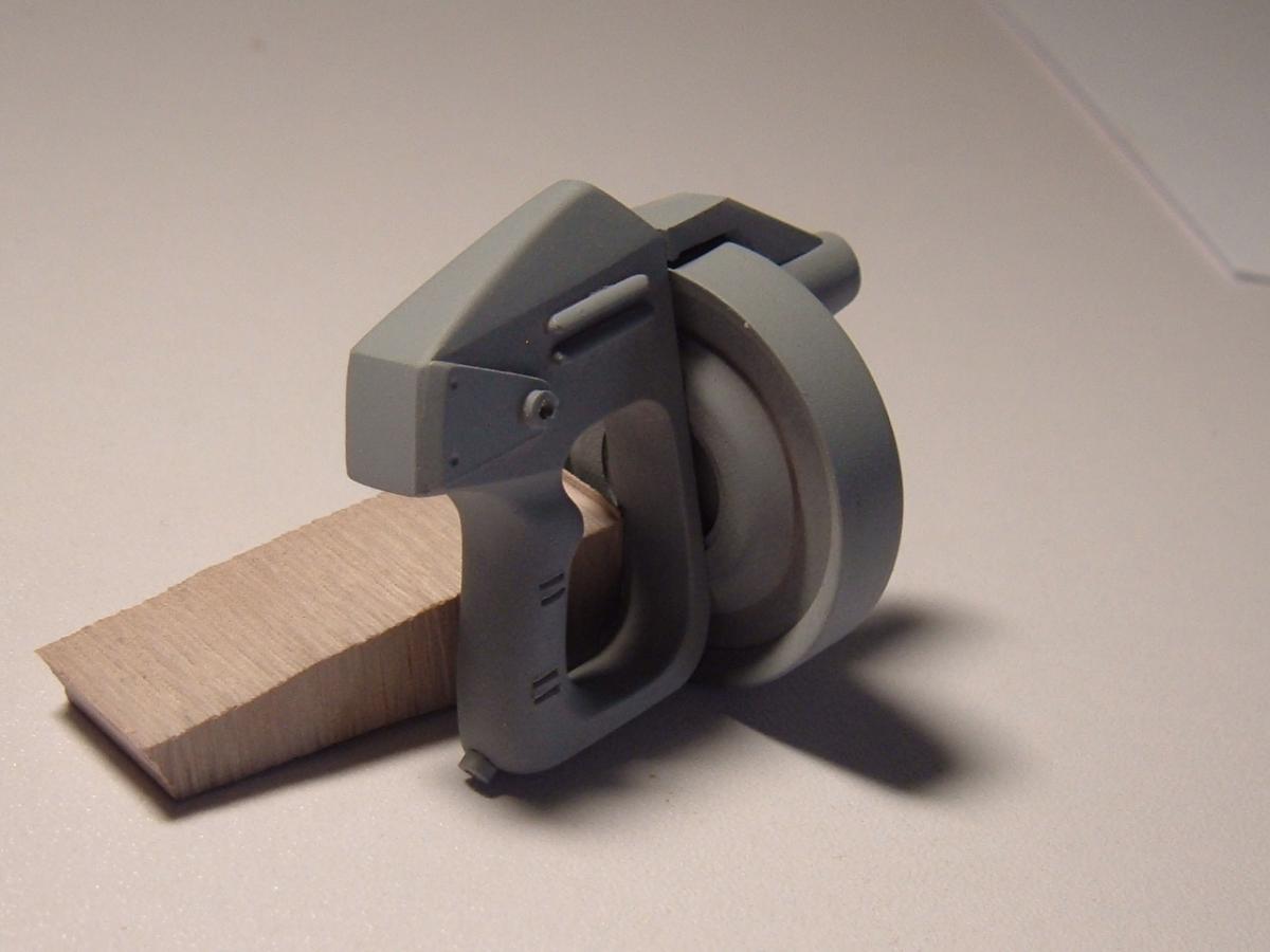

DSCF5342: the barrel for the glorified flare gun that is the sidearm of the Ger.
DSCF5349: more flare gun action. While this thing is NOT practical from a functional standpoint, I do find it rather nifty.

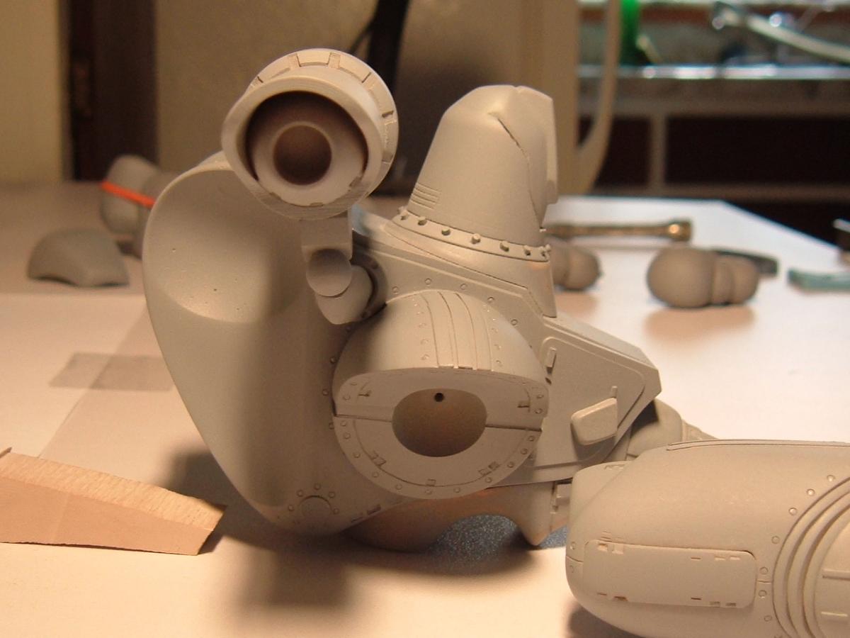

DSCF5348: thrusters now have detail, just a few other nick-knacks to add to the backpack unit for it to be complete.

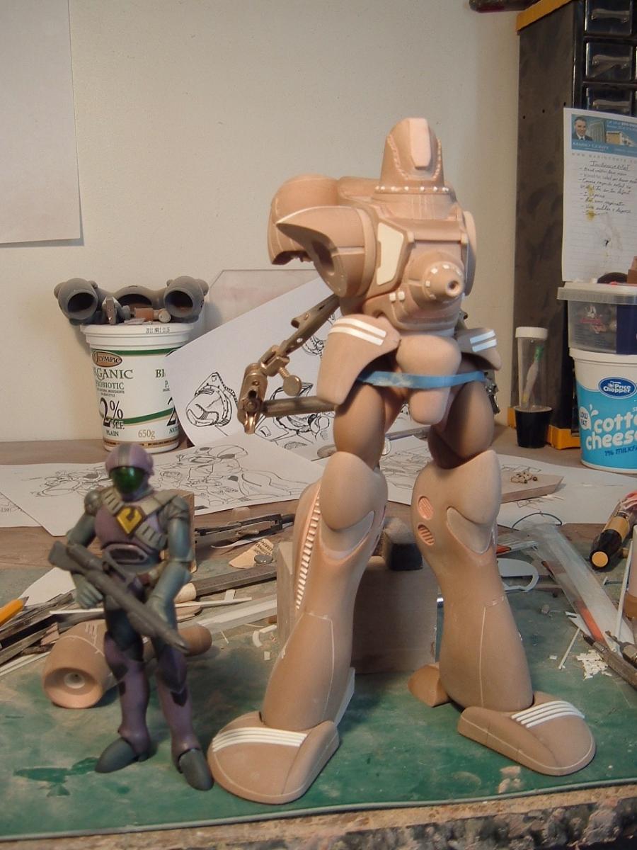

DSCF5350: comparison of the Ger unit with a soldier to give you a better idea of the size.

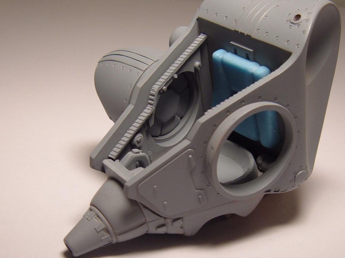

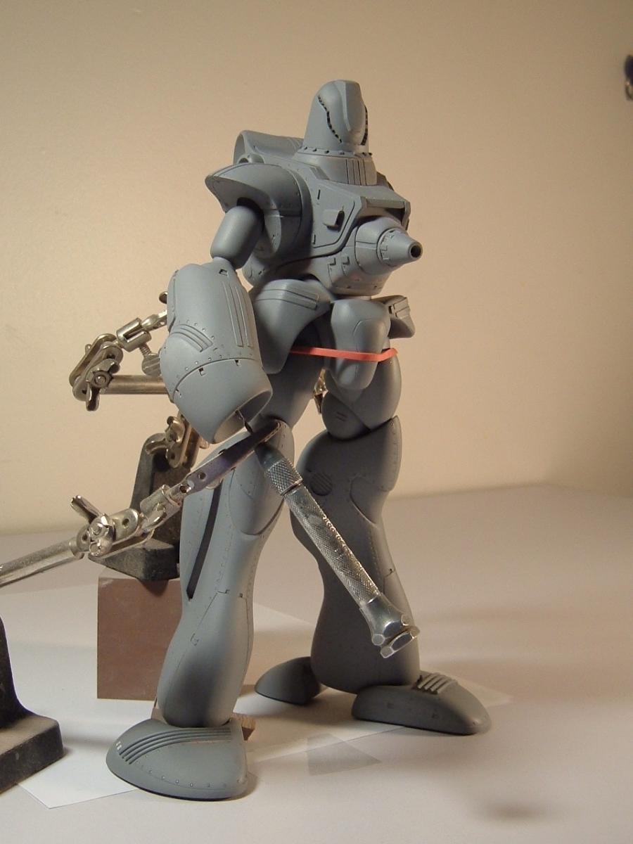

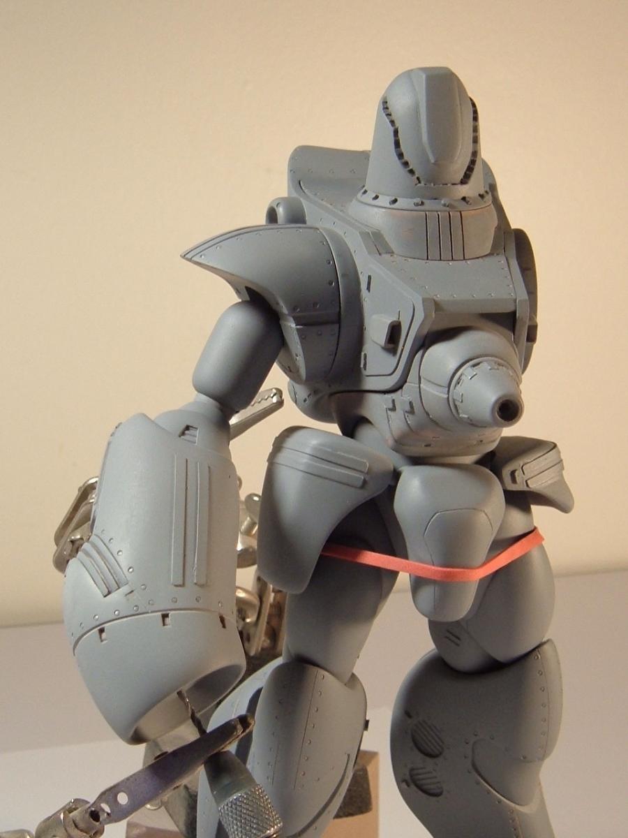

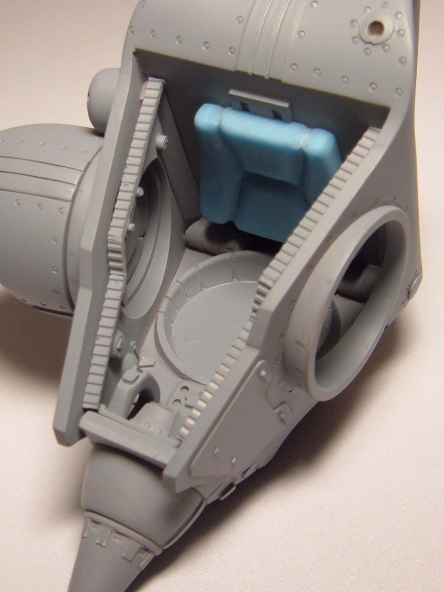

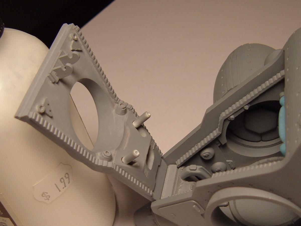

A little preview of the completed masters. I completely redesigned the shoulder joint at the last minute to give the pilot a bit more room at the shoulders/arms. I did cheat and carry-over ONE part from the Regult: the back cushion with a few small tweaks. ^_^

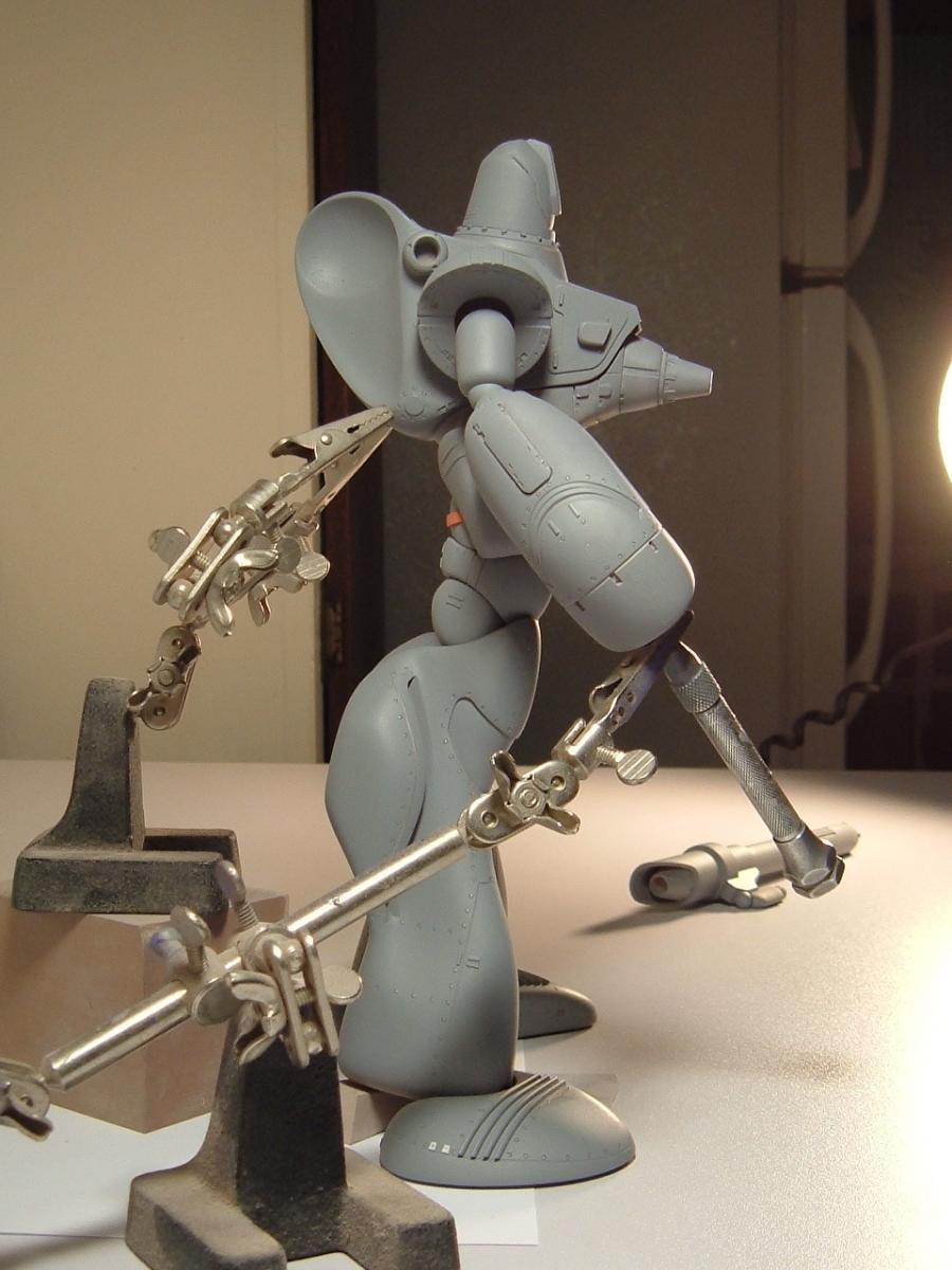

Tomorrow has arrived! I didn't get too crazy with the pose to avoid damaging the masters, but it's all there. Little details being added at the last second in my usual, spontaneous fashion, hope you enjoy! Will have a pic or two of the back and the pistol later tomorrow, er... Today.
Will begin mold-prep on Monday and the usual updates will follow :)

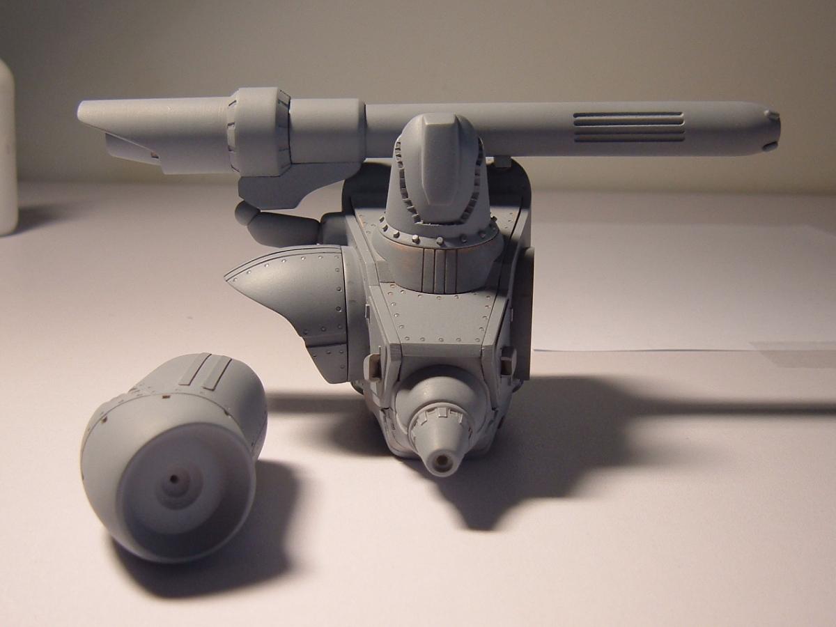

Thanks for the kind words, I really just build my models the way I think that they would look IRL, which hopefully coincides with the expectations of my patrons. That said, a few more pics of the masters: mostly ancillary details that otherwise are taken for granted. I tweaked the main cannon mount so as to allow not only unobstructed egress/ingress of the pilot, but you can also point it forward in attack mode if you wish.
