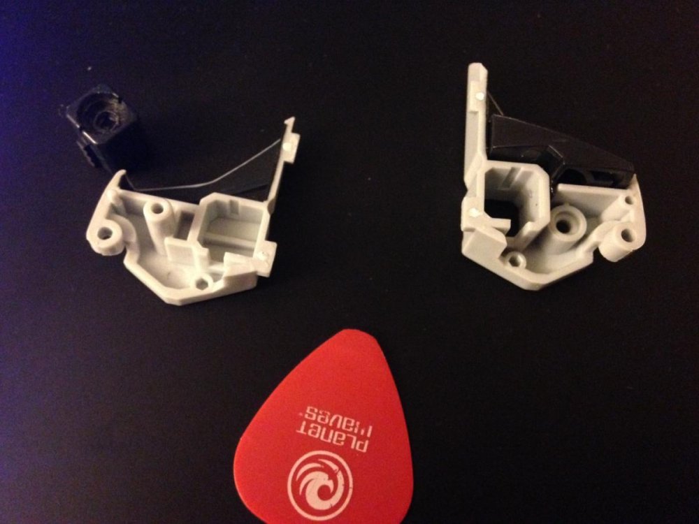

I've transformed and posed mine a number of times with no problems over the last few months, but I've never utilized the extending hip joints. Tonight I tried extending them and one of them wont pull out at all. Is that a sign that I've got an impending hip explosion? Would it be advisable to just take the hip apart and see what's going on in there?
Thanks. I guess I'll just have to open it up and see why it's stuck. I know there are screws holding the hip parts together, but are they glued as well? Sorry if this has been answered in the past, it's a big thread and I didn't see the info after skimming.

Found your tutorial CY, I'll use that as a guide.

hey eriku, since you built a vf-1 kit, you'll be familier with taking apart the hip joint. just follow yeti's video but it's pretty much the same as a vf-1.
from the photo below, the only part that is glued is the length sides that are facing each other in center of this photo right above the guitar pick (side where the intakes tab into the body in fighter), so you have to be careful splitting them open. i used a guitar pick to avoid scratching the black paint inside the intakes
