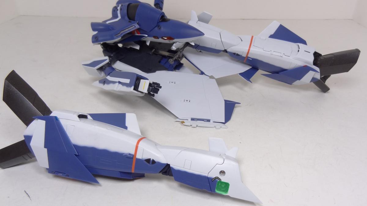

Boroboy Posted November 18, 2015 Posted November 18, 2015 Well, thought I dodged this bullet, but my 0d just lost the left leg during transformation. It was always tight, but this time it looks like it just sheared the plastic half of the ball joint right off. At least I know the fix for it - thanks for the video, Yeti! Quote

ChaoticYeti Posted November 18, 2015 Posted November 18, 2015 I'm not sure why glue is even necessary for this cap piece. It has to be just to keep it in place while the parts are assembled. It is in no way required for the ball and socket connection to work. If the socket is closed all the way, it completely encloses even the metal half of the ball. I agree. I did not use glue when repairing mine. Quote

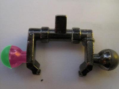

jenius Posted November 18, 2015 Posted November 18, 2015 (edited) The problem: Any more broken leg pics? EDIT: I guess you could argue that's "the symptom". The problem is that there is a ball (half metal, half plastic) that fits inside a housing and the tolerances must be perfect for the housing to prevent the leg from falling off. It seems like sometimes the plastic ball is just a little bit too big, or a little bit of glue gets on the plastic part of the ball, and so the housing doesn't latch down strong enough to hold the ball together and the metal part just comes right out. I would think that an imperfection in the cast of the plastic half the ball would also cause the issue as that would cause the housing to separate a bit also. Edited November 18, 2015 by jenius Quote

Scyla Posted November 18, 2015 Posted November 18, 2015 (edited) Maybe I can give some insight on why according to my observations this is a problem on the VF-0 toys and not on the VF-25 Renewal ones that have a similar design. On the VF-25 the plastic part is not glued onto the metal hip joint: (I'm still looking for a replacement part btw: http://www.macrossworld.com/mwf/index.php?showtopic=39340&hl= ) The reason why this is not a problem on the Messiahs is the way the intake parts are assembled. As you see here on an image from http://anymoon.com the two parts sandwich together in a different manner: I marked the line where the parts split with green color. This design was even present on the V1 toys as shown in the picture. With this design the hip joint as a far more secure grasp of the ball since the hole for the hip rod is smaller than the ball of the joint. So there is no way that the hip joint and the leg will separate. With the way Arcadias intakes come together this is impossible to achieve since you need to assemble the toy somehow. On the Arcadia version the hole for the hip rod is exactly as wide as the ball of the hip joint. Again a picture from jenius' blog: As you can see once the two halves separate (through what reason whatsoever) the leg will fall off the toy because there is nothing that holds it into the ball socket. What Arcadia should to is to redesign the two halves of the ball socket so that the enclose the ball much further. Of course this would mean that you have probably less articulation on the legs and you can't extend the hip joint. Sorry for the long post. Edited November 18, 2015 by Scyla Quote
