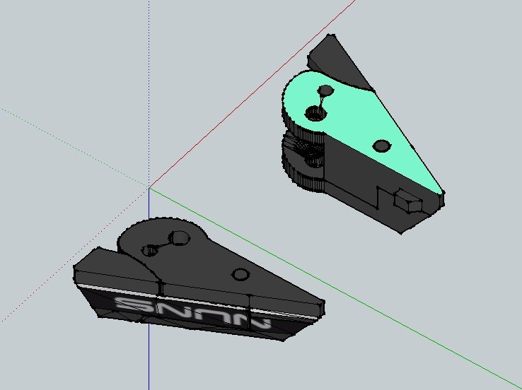

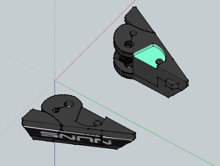

Xigfrid Posted January 14, 2015 Author Posted January 14, 2015 (edited) Big update for colored version! I finally was able to put all the textures correctly and after dozen of dozen emails with Shapeways services, I got 4 versions ready for "FULL COLOR PLASTIC" material. You can have a look at the models here: http://www.shapeways.com/shops/xigfrid3dshop?section=VF-171+NUNS+textured There are the VF-171 CF version triangle with or without the lower triangle fit and the ALTO (red and black) versions. The good news is that it is cheaper than what I expected! 15 USD for a set of left and right triangles. Unfortunately, this material is available only to the designer for the moment, let's hope it would be made public soon. That means that if you want one now, you would have to send me a PM. Edited January 14, 2015 by Xigfrid Quote

Xigfrid Posted January 14, 2015 Author Posted January 14, 2015 What do you mean with or without the lower triangle fit? There are 2 triangles that fold one into the other. They both are prone to breakage. The larger one, the upper one, is the more visible and it folds into the shoulder when transforming. The lower one, folds and hide itself into the part that becomes the batroid chest. It has small impact on the fighter esthetic and I can't do a replacement part for it, mainly because the part is too slim. If your lower triangle is not broken, then you should take the version with the "lower triangle fit". This version has a cavity where the lower triangle comes and fit into the NUNS triangle. If your lower triangle is broken, you better order a Upper triangle wihtout this hole for the "lower triangle". Quote

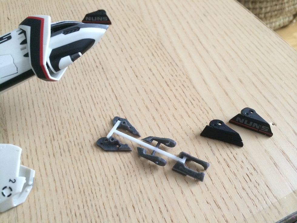

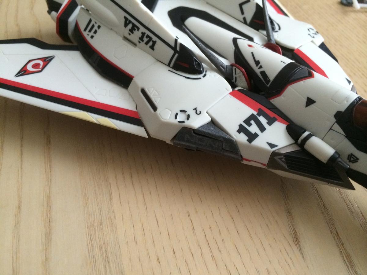

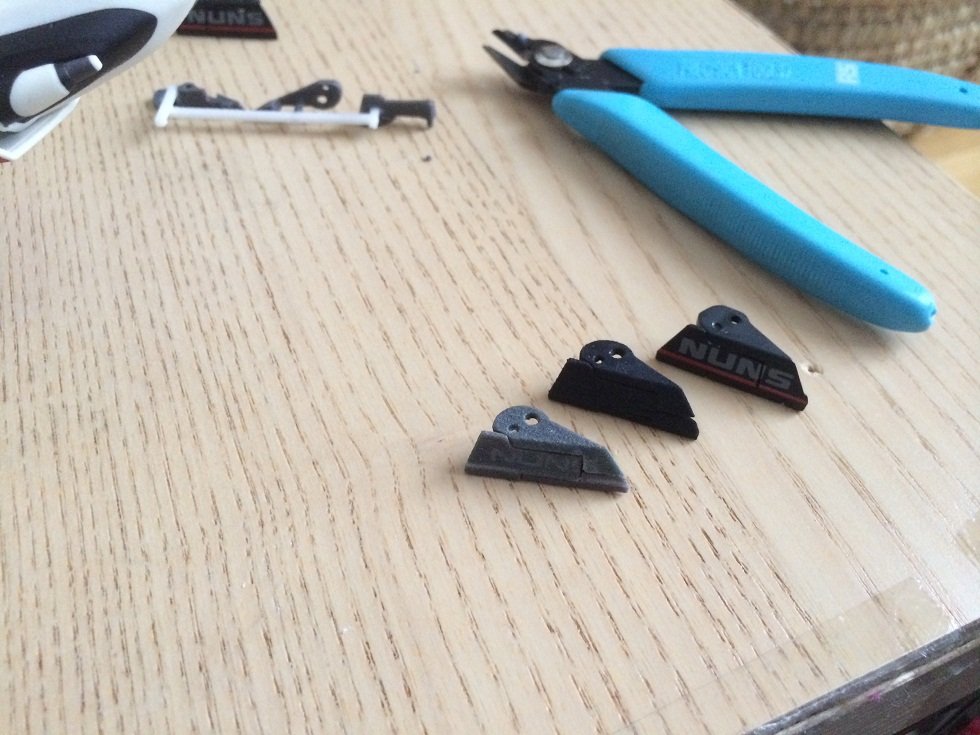

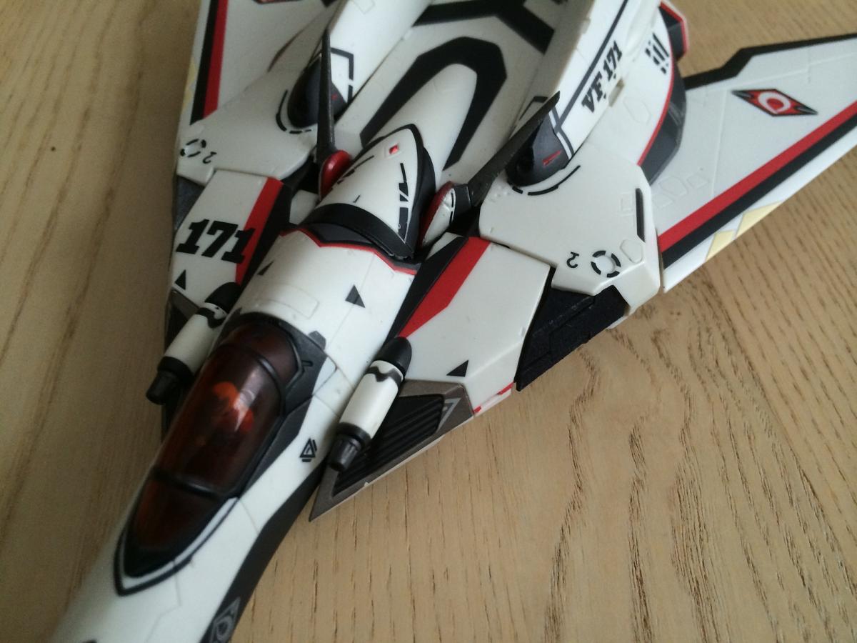

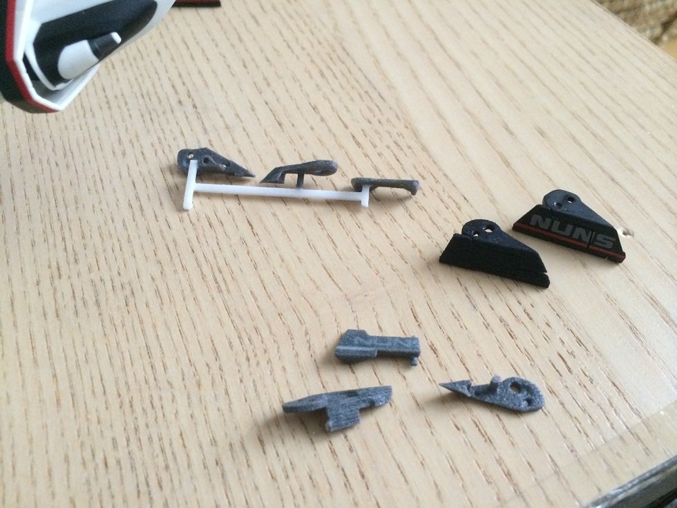

Xigfrid Posted February 15, 2015 Author Posted February 15, 2015 I tested the "Full Color Plastic" and it works. However, the colors are a bit faded in particular the black. I much prefer the "Black Strong and Flexbile" material because the black is good and the plastic is more rigid and solid. ASSEMBLY: Assembly and color comparison from left to right: the Full Color Plastic, Black Strong and Flexible, original triangle. Quote
