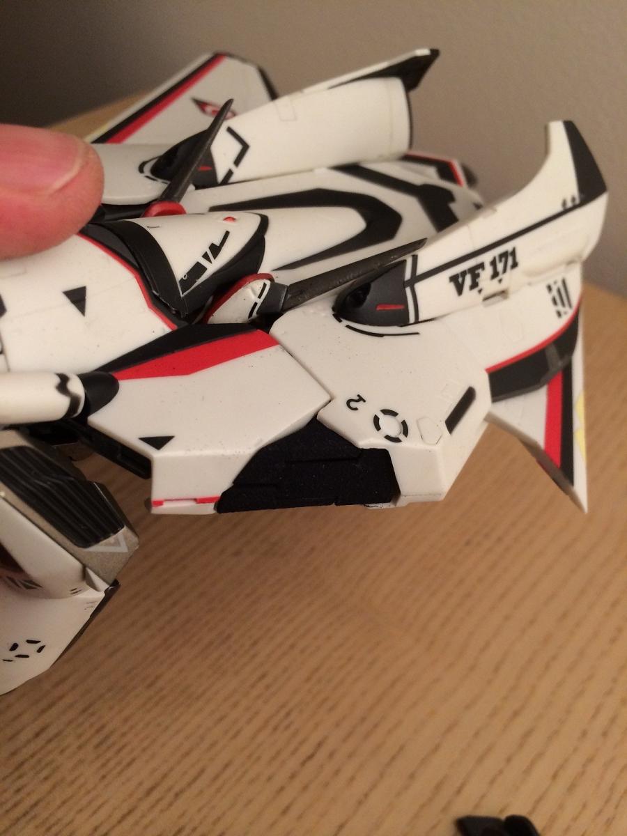

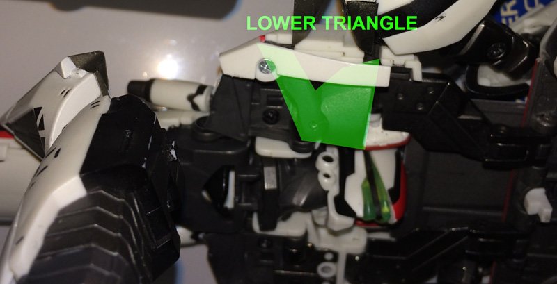

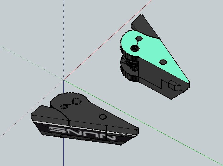

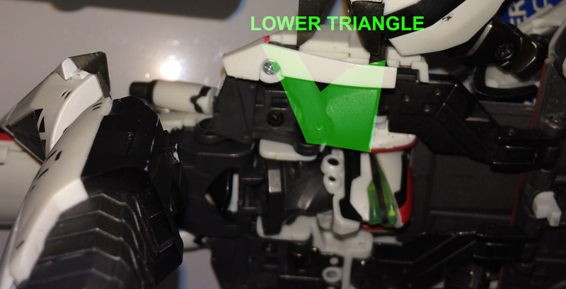

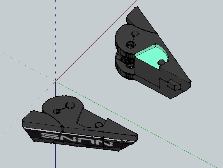

Xigfrid Posted December 9, 2014 Posted December 9, 2014 (edited) Hello, I made a replacement parts that once assembled (preferably using glue) will replace the original triangles of the VF-171. Additionally, I wanted to make a replacement of the "lower" triangle which is supposed to brake also, but couldn't figure which material could do the job. If you have ideas, let me know. I made on Shapeways a few models: no texture: http://www.shapeways.com/shops/xigfrid3dshop?section=VF-171+NUNS+no+texture&s=0 #1 Optimized for Strong and Flexible materials, this model has a cavity to fit the lower triangle available here: http://www.shapeways.com/model/2965873/vf-171-nuns-triangles-with-lower-triangle-fit.html #2 Optimized for Strong and Flexible materials, this model has no cavity for the lower triangle. This design is stronger than the one with a cavity and is sleeker for any VF-171 that would have both upper and lower triangle broken: http://www.shapeways.com/model/2939051/vf-171-nuns-triangles-wbk-sf-version.html #3 Optimized for Forst Ultra Detail material, without the cavity. You will have more details and smoother surface from this material: http://www.shapeways.com/model/2921408/vf-171-nuns-triangles-fud-version.html I ordered and received the model #2 Detailled ASSEMBLY Instructions here: http://www.macrossworld.com/mwf/index.php?showtopic=42000#entry1171040 NUNS Triangle without Lower triangle fit: I forgot to put a cavity on the model #2 so I had to modify it with a cavity to fit the lower triangle. I have updated Shapeways with a new file with these modifications to fit the lower triangle. NUNS Triangle with Lower triangle fit: Additionnaly, there are fully colored models available here: https://www.shapeways.com/shops/xigfrid3dshop?section=VF-171+NUNS+textured Because the material used for Full Color Plastic is, for the moment, available only to Shapeways designers, you should PM me if you want one of these models now. I have put a few pictures of the Colored triangles with lower fit here: http://www.macrossworld.com/mwf/index.php?showtopic=42000&page=2#entry1180759 Edited February 16, 2015 by Xigfrid Quote

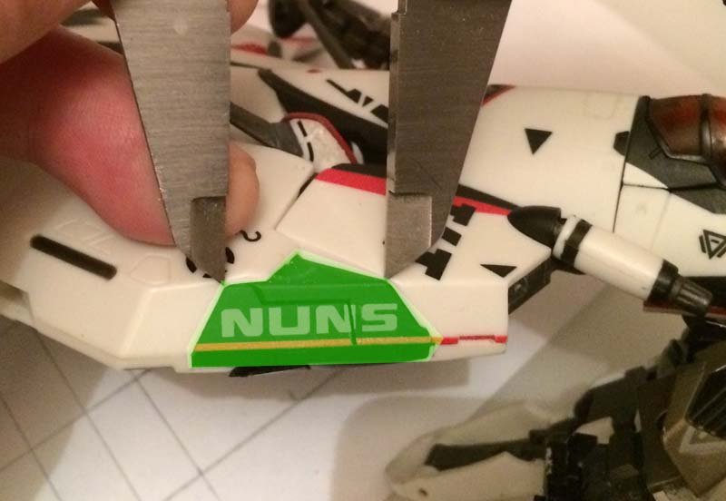

Xigfrid Posted December 16, 2014 Author Posted December 16, 2014 I think people may be willing to spend $15 for a set if they have the NUNS logos already on there. I mean, I would spend $15 to repair a toy that is $100+. I just checked the textured models and tried to order them, the price tag of 15$ was a mistake, it was the price for the standard white plastic. It turned out to be more around 30$ for the complete set in Full Color (excluding shipping costs!) This is mostly due to the minimum of 3$ handling commission per part. I think I will first review the design I ordered and if dims are good, I will try to review the Colored Plastic to reduce price by combining several parts in one. Quote

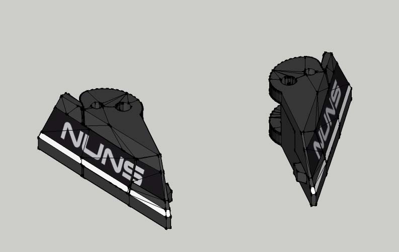

Xigfrid Posted December 17, 2014 Author Posted December 17, 2014 So they do have the NUNS markings though right? I am still not clear on that part. I got three versions available on Shapeways, only the textured version would have the "NUNS" logo marking. Quote

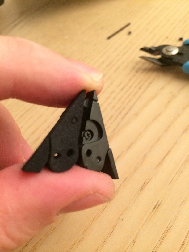

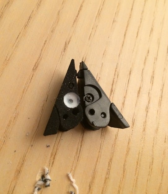

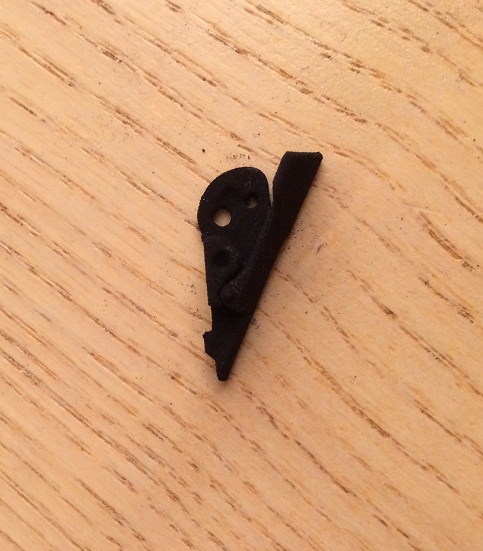

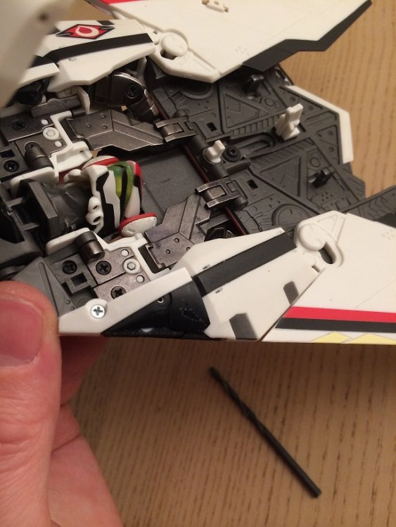

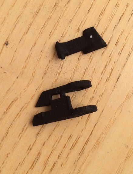

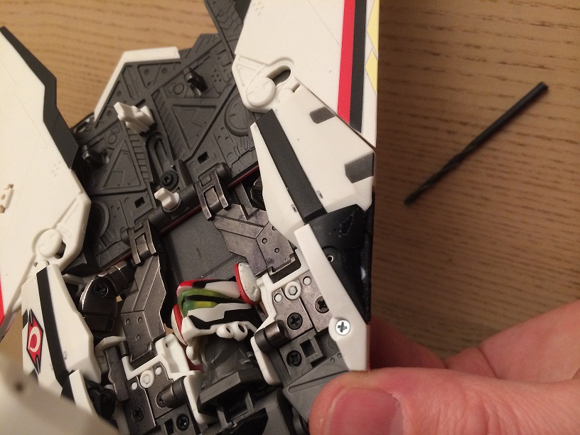

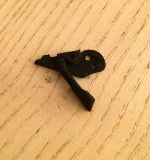

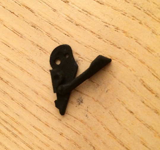

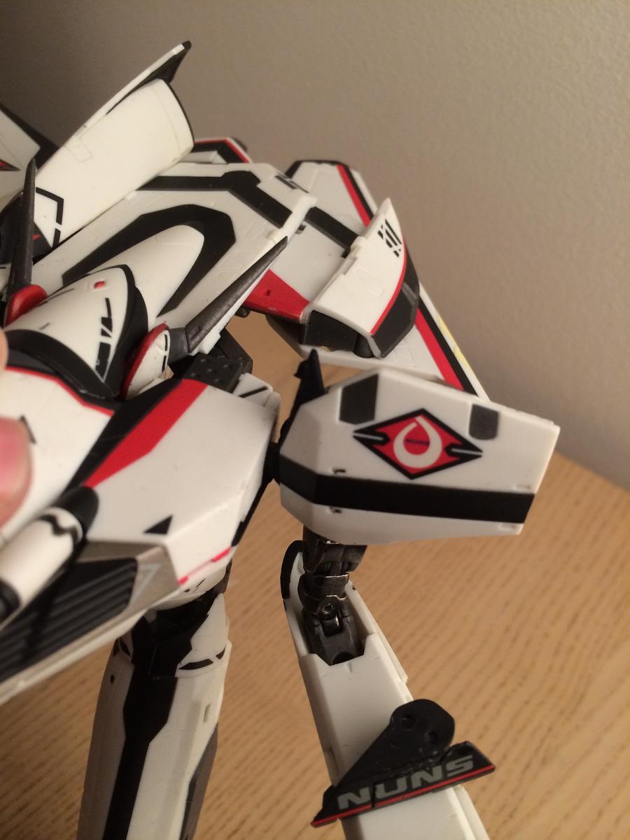

Xigfrid Posted December 18, 2014 Author Posted December 18, 2014 Just received the test triangles from shapeways (among other stuff) ! They fit nicely. The actual version didn't fit the "lower" triangle, so I had to drill the triangle so that the lower triangle could get in. Don't panic, I made a newer version for that so you only have to choose between: TRIANGLE with LOWER TRIANGLE FIT, if your VF-171 has only the upper triangle broken or SIMPLE TRIANGLE, if your vF-171 has both upper and lower triangles broken The main reason I made the SIMPLE TRIANGLE available is because it is a stronger design and it would be sleeker for a VF-171 that has a broken lower triangle. Quote

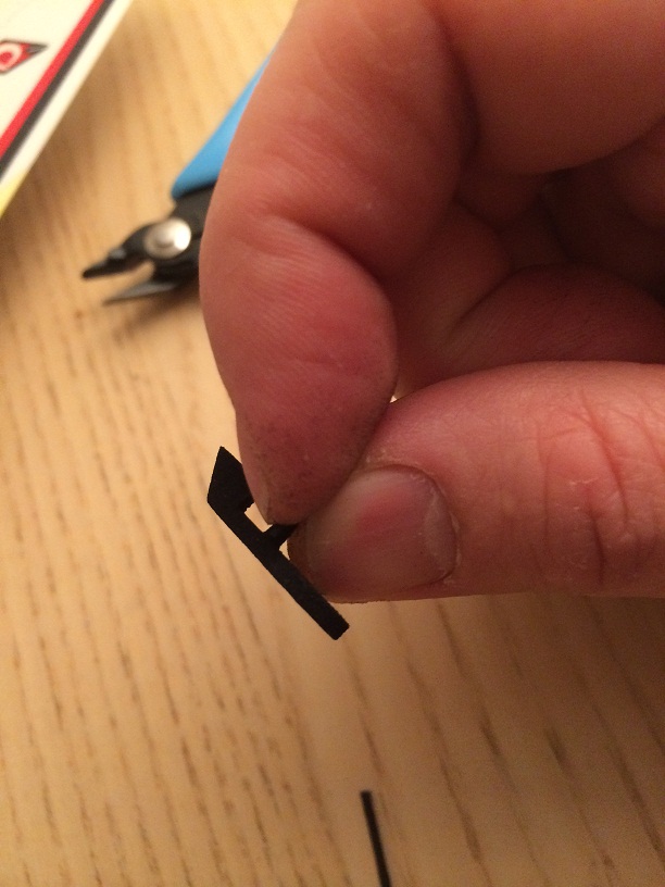

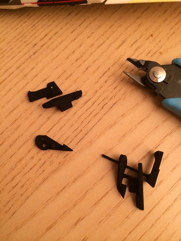

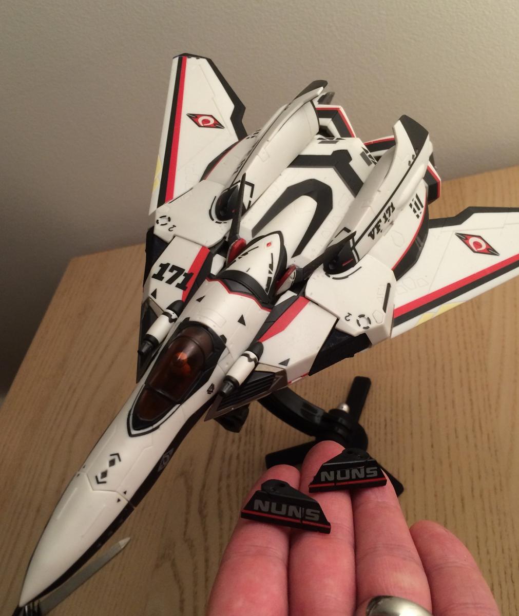

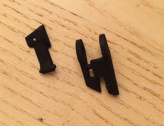

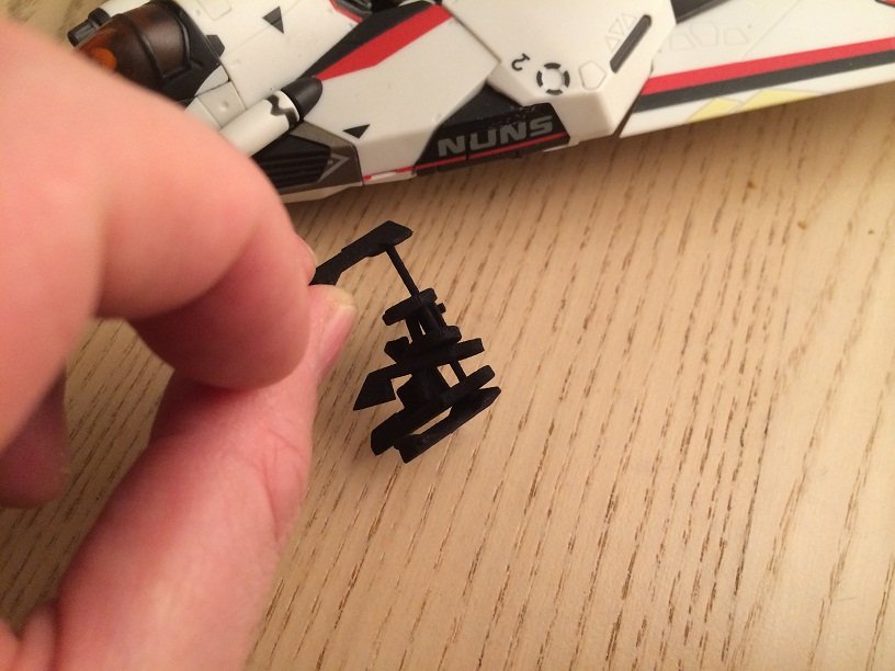

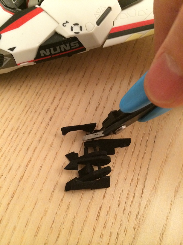

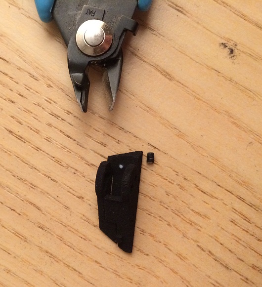

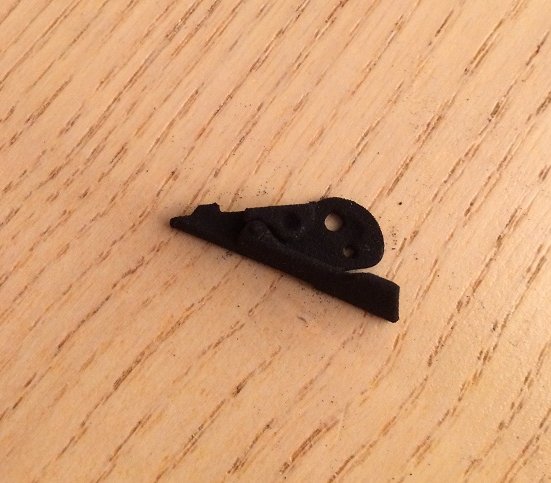

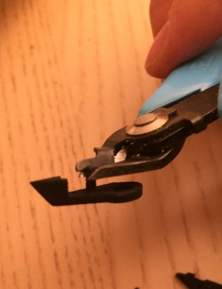

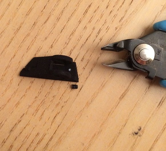

Xigfrid Posted December 18, 2014 Author Posted December 18, 2014 (edited) Updated first post with new design and photos Here is how to assemble: step #1 Cut the assembly to free the 6 parts step #2 Test the fit of the lower part and middle part. Rotate the middle part. Do not glue the lower and middle parts ! step #3 Take the upper part. Scratch with your nail the fixing rod to eliminate any remains of printing dust. step #4 Test the fit of the upper and lower parts. In my case, the rod was too long by 2mm, so I cut the rod by this amount, do the same if needed. and Voila Fitting test in fighter mode: Fitting test for Battroid mode: Edited December 18, 2014 by Xigfrid Quote
