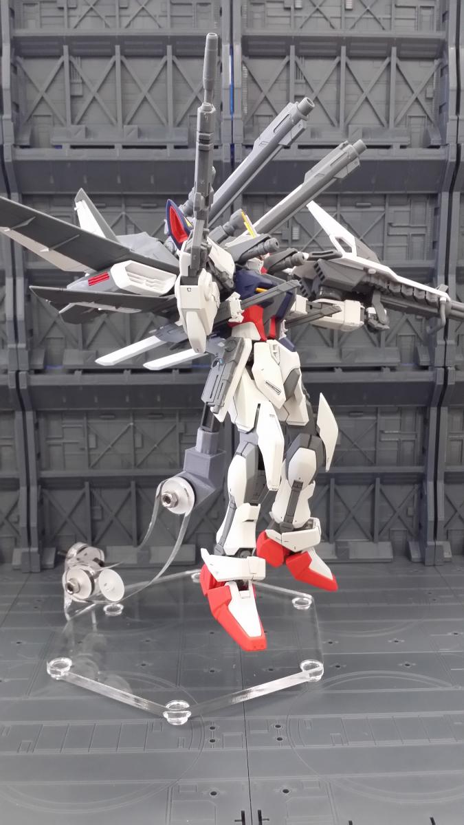

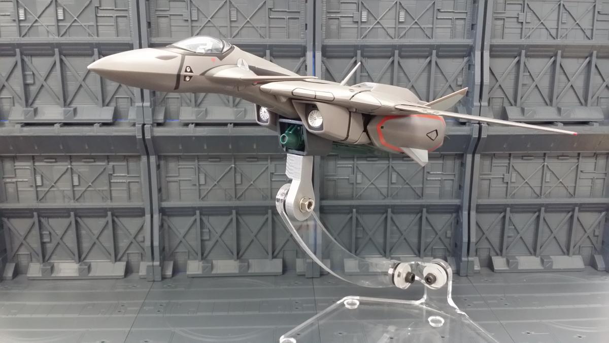

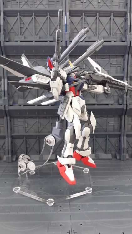

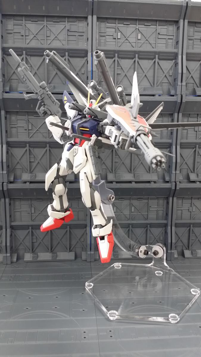

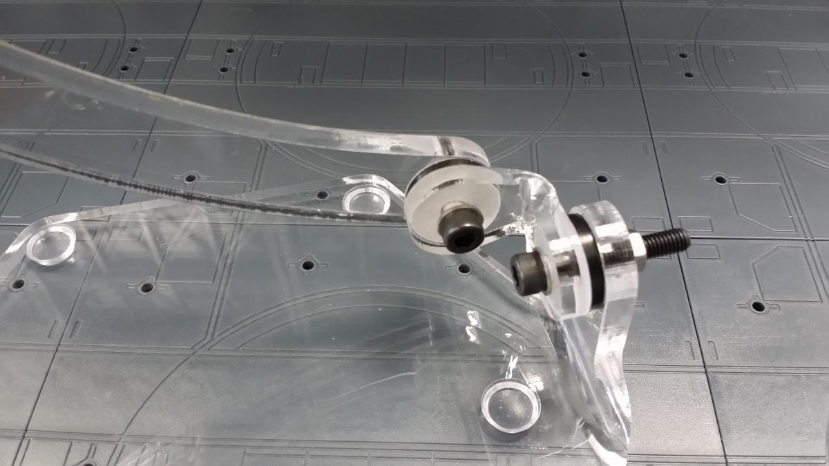

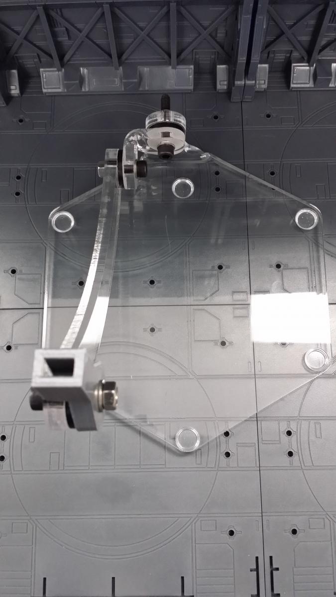

cmal Posted March 4, 2016 Posted March 4, 2016 Finally got a chance to try loading up my Beta during lunch today. Just putting the stand together, I could already see where there might be issues. The bend is really the weak point and its compounded by the fact that you need an elbow to get your arm on straight. That's two points of potential failure, as well as areas of instability. As a sidebar, you have to get creative with how you mount your arms to get them centered on the stand. The first thing I put on was a naked VF-11B, which I think is my lightest Valk. The stand holds it just fine, but movement caused flexing of the bends. You might have seen a long screw in a previous photo; I was planning to try to get an elbow and knuckle on there at the same time for four arms, but abandoned that idea after this. Here's some gunpla. Also holds well. Tried with the XL arm and a Dual (a single regular was too short and linking two was too much work). The lower price point is nice if you're using it for lighter collectibles (some Transformers, plastic models). The Alpha is a Cadillac -- like Yeti said, its robust and flexible enough to load up with everything plus the kitchen sink. The Beta is more affordable, but limited in what you can put on there. There's also the customization factor once Yeti can do laser etching in-house. I could see using Betas for one or two special display pieces, but not a whole flight wing, or if your collection is more modest. I'd definitely consider using these for my plastic models (or a similar, lighter and cheaper iteration), since Alphas are overkill. Quote
ChaoticYeti Posted March 4, 2016 Author Posted March 4, 2016 (edited) If you put the arm on the inside of the elbow, it should be centered much better. Also, have the elbow extend out the other side. I'll say it again, even though you reiterated it, the beta is not a replacement for the alpha. Customization in the base surface and a cleaner look overall. Alpha is still the beast when your want to put more than one figure together on a stand. Thanks for your input. Much appreciated. Edited March 4, 2016 by ChaoticYeti Quote
cmal Posted March 6, 2016 Posted March 6, 2016 I assembled it following the logic that for a "standard" setup, the rubber washer goes on the side that's been photoetched. Its not supposed to make any difference, but it might matter to some people. Hence my "creative planning" comment, since you've also got to consider which direction you put the screws in so they can be tightened. Having the bend of the elbow on the right instead of the left was unexpected. I guess it does make sense since the tab on the base is offset to the left ever so slightly. Its not apparent at first glance, but after reading your comment, I remembered that from when I put the rubber feet on. As far as changes, the only things that I can think of are making it more apparent that you put the elbow on the right and shortening the tab. Is there any way you can get the screw hole closer to the base and still have enough clearance for arm attachments? The longer it is, the more leverage you get on it, so it has the potential to bend and flex more. It could also alleviate some concerns about the acrylic being thinner, and since you basically require an elbow, the elbow could also add some support against too much (or catastrophic) flexing of the bend. Other than that, I must say the Beta is a fine addition to the YetiStand family. Options are always good. PS: You might not be able to tell, but my jury-rigged Gundam adapter is starting to fail LOL. If you can find some time in the next few months to whip up a few prototypes, I'd be more than happy to cover shipping and test some out for you. Quote
ChaoticYeti Posted March 6, 2016 Author Posted March 6, 2016 (edited) I assembled it following the logic that for a "standard" setup, the rubber washer goes on the side that's been photoetched. Its not supposed to make any difference, but it might matter to some people. Hence my "creative planning" comment, since you've also got to consider which direction you put the screws in so they can be tightened. Having the bend of the elbow on the right instead of the left was unexpected. I guess it does make sense since the tab on the base is offset to the left ever so slightly. Its not apparent at first glance, but after reading your comment, I remembered that from when I put the rubber feet on. As far as changes, the only things that I can think of are making it more apparent that you put the elbow on the right and shortening the tab. Is there any way you can get the screw hole closer to the base and still have enough clearance for arm attachments? The longer it is, the more leverage you get on it, so it has the potential to bend and flex more. It could also alleviate some concerns about the acrylic being thinner, and since you basically require an elbow, the elbow could also add some support against too much (or catastrophic) flexing of the bend. Other than that, I must say the Beta is a fine addition to the YetiStand family. Options are always good. PS: You might not be able to tell, but my jury-rigged Gundam adapter is starting to fail LOL. If you can find some time in the next few months to whip up a few prototypes, I'd be more than happy to cover shipping and test some out for you. Part of the reason the section with the joint is so long is so I can bend it. I am working on some revisions that may alleviate your concerns about fragility.The confusion about the elbow is understandable. I can only have one side of the acrylic laser etched from my current vendor. I will hopefully be able to laser etch both sides of the elbows when I have my own laser. As to your ps, contract work has picked up in a good way recently. I can get to those adapters this week, most likely. Edited March 6, 2016 by ChaoticYeti Quote
cmal Posted March 7, 2016 Posted March 7, 2016 Cool. Just send me a PM whenever they're ready. Because it was worth a shot, today I went ahead and put the knuckle on to see if I could get four arms. In the end, between the elbow and the knuckle, I couldn't get the screw on tight enough and the knuckle would slip and rotate. If I could get that secure, I probably could put 4 Valks on a Beta; whether that's a good idea is another matter. But yeah, 2 side-by-side or front-to-back should be no problem. With front-to-back, you just have to tweak your positioning to balance the weight depending on where you put the foot on the corner with the bend (mine was a little farther in, so it had a tendency to tip backwards more than necessary). Quote
