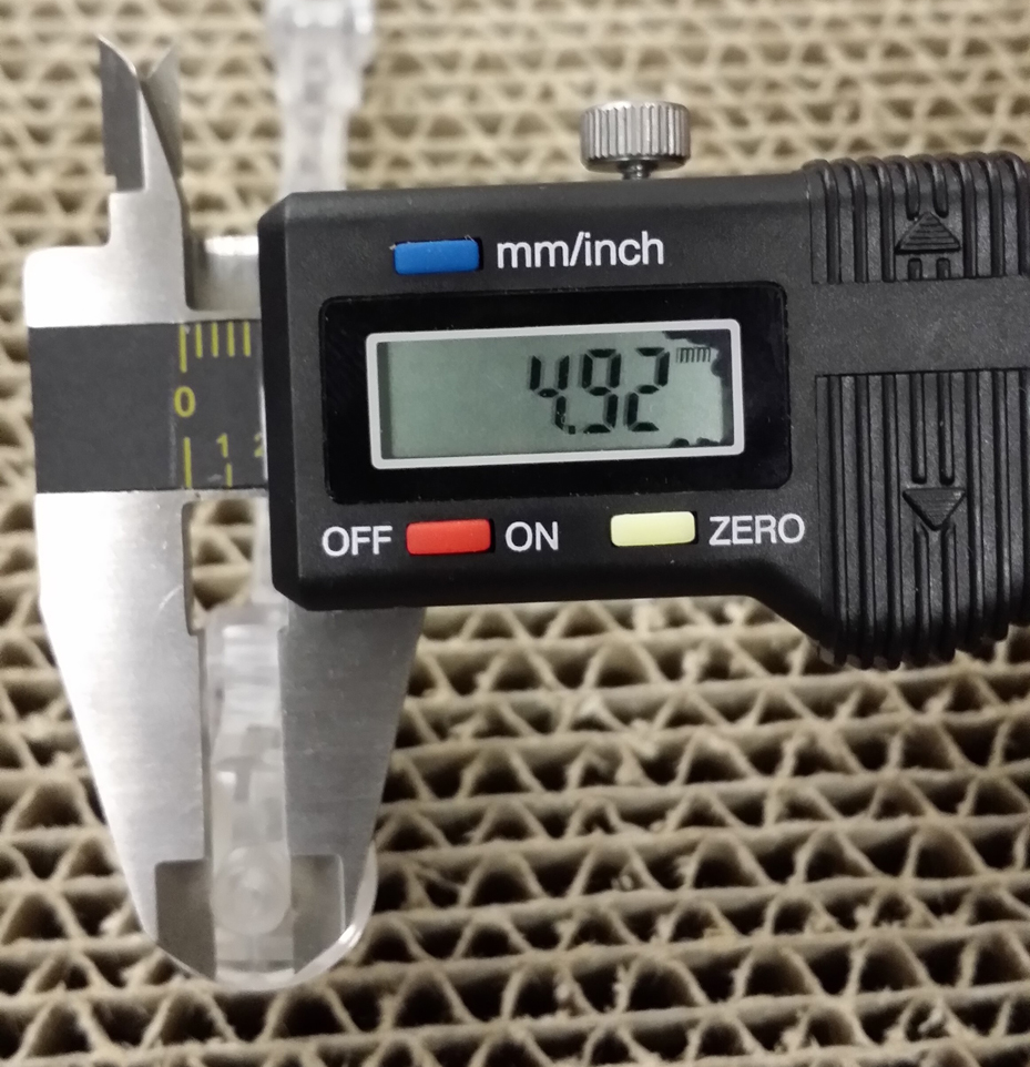

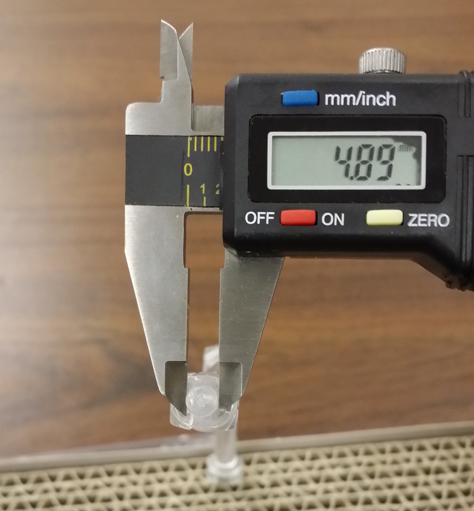

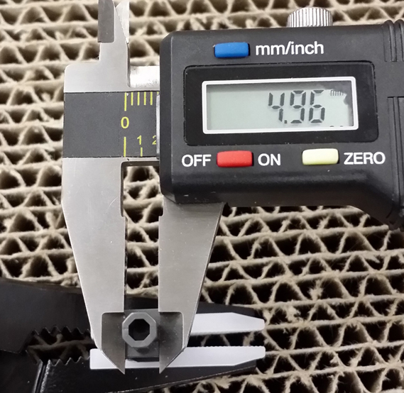

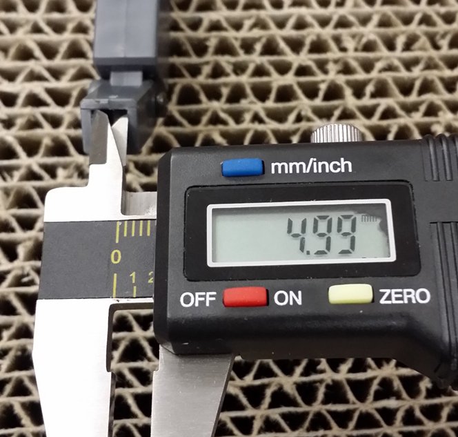

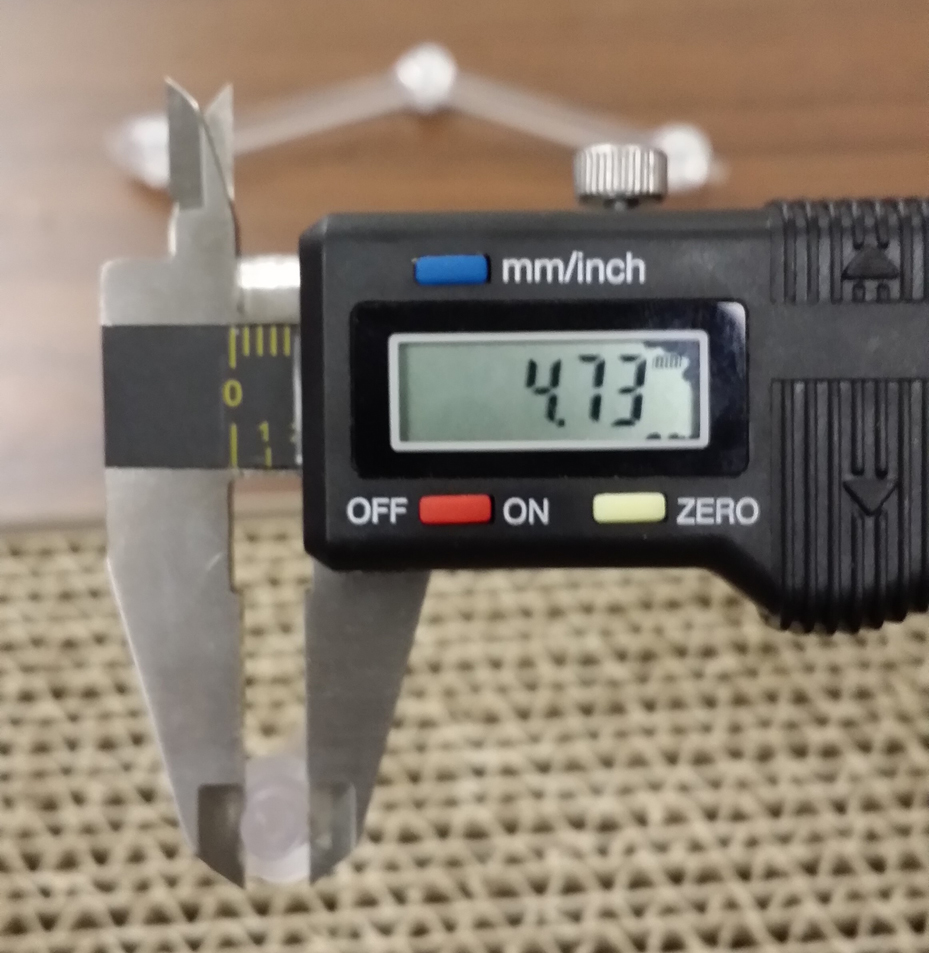

cmal Posted December 29, 2015 Posted December 29, 2015 Here are the measurements of the base pegs of the Act 4 and 5 Tamashii Stages. The holes averaged ~4.5mm, so just a smidge off. Could you design an adapter for the Bandai Action Base 1s? That'd cover a significant portion of their model line; the pre-AB kits use the little cradles and all the newer stuff usually have an adapter included on the sprues. The socket on the arm is a 5mm square with octagonal pegs on the adapter pieces -- I can get photos and measurements if you haven't got one on hand. And the printed adapters are ABS, right? Have you got any recommendations on sanding some of the rougher outer surfaces down for a smoother finish? Quote

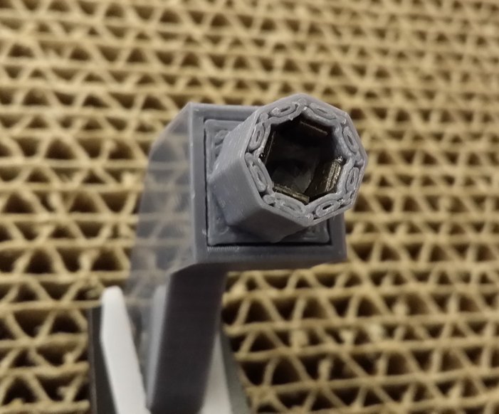

ChaoticYeti Posted December 29, 2015 Author Posted December 29, 2015 Here are the measurements of the base pegs of the Act 4 and 5 Tamashii Stages. 20151229_070349.jpg20151229_070607.jpg20151229_070649.jpg The holes averaged ~4.5mm, so just a smidge off. Could you design an adapter for the Bandai Action Base 1s? That'd cover a significant portion of their model line; the pre-AB kits use the little cradles and all the newer stuff usually have an adapter included on the sprues. The socket on the arm is a 5mm square with octagonal pegs on the adapter pieces -- I can get photos and measurements if you haven't got one on hand. And the printed adapters are ABS, right? Have you got any recommendations on sanding some of the rougher outer surfaces down for a smoother finish? Pictures and measurements would be great. You can sand them down to a fairly smooth finish, but the surface will dull unless you paint it. There are some Smooth-On products for 3d prints that lessen the effect of the surface ridges. Both processes alter the surface dimensions of the prints, and may effect how they fit. Quote

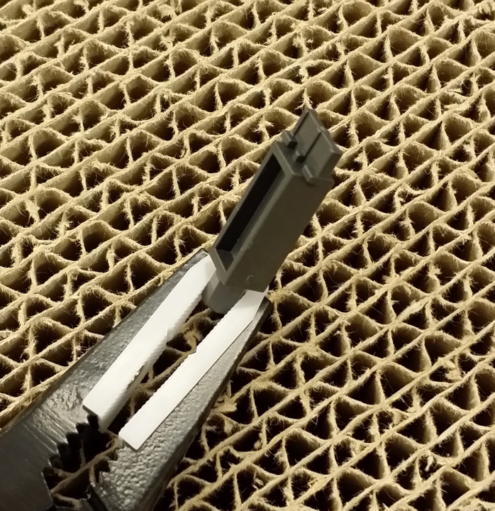

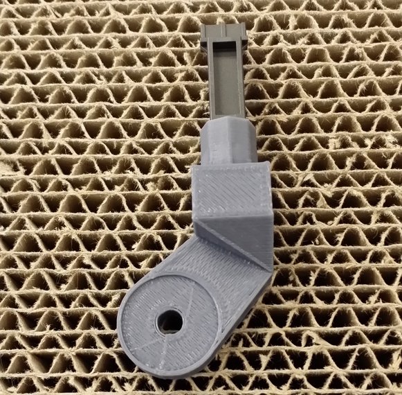

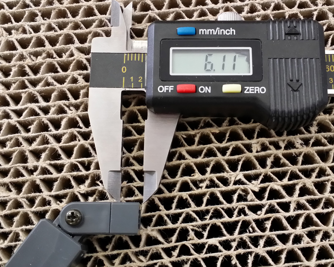

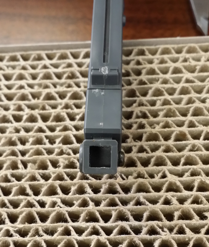

cmal Posted December 29, 2015 Posted December 29, 2015 Pictures and measurements would be great. This is the adapter that came with the Hi-Nu and goes in a slot under the crotch. This is the slot on the stand arm. I measured the depth using the blade on the end; I just took the photo that way to show what that dimension was. Let me know if you need anything else. I have a bunch of extra cradle adapters I don't use, so I don't mind mailing a few of them to you, as well. You can sand them down to a fairly smooth finish, but the surface will dull unless you paint it. There are some Smooth-On products for 3d prints that lessen the effect of the surface ridges. Both processes alter the surface dimensions of the prints, and may effect how they fit. I don't plan on doing anything to any surfaces that interact with other components, just minor cosmetic stuff. I'll experiment a little and see what works. Quote

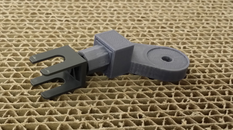

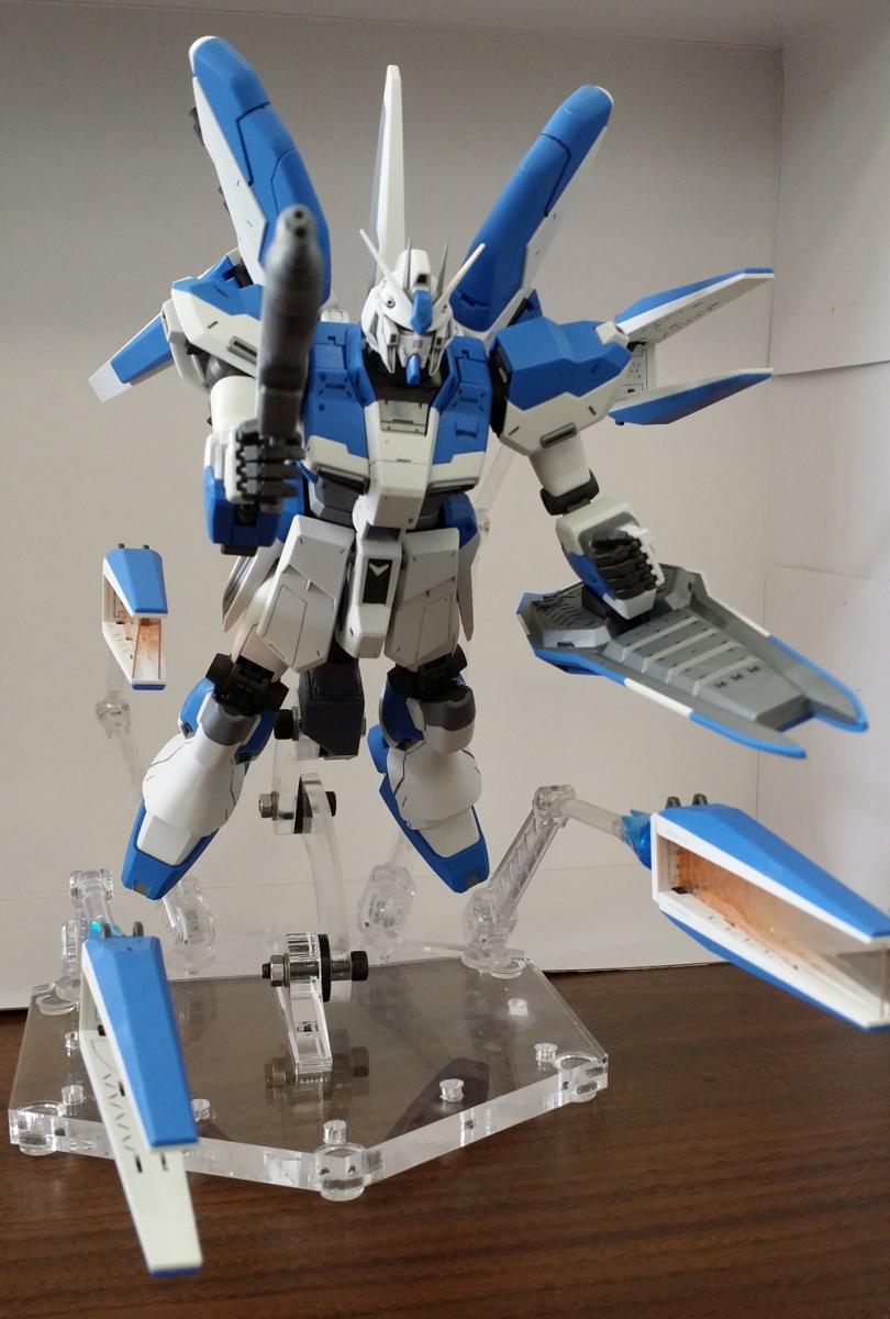

cmal Posted January 14, 2016 Posted January 14, 2016 So until Yeti whips up an Action Base adapter, I decided to modify a Metal Build hex adapter by gluing in some scrap plastic. The alignment of the Metal Build's hex isn't square, so I stuck the peg in with an offset, but it fits just fine. Its not ideal for long long term use without permanently fixing the parts together, but should hold together for a good while. Finished reposing my Hi-Nu with its included stand adapter and the YS Metal Build adapter with funnels out the way I had it with the stock stand. Looks pretty good. Except for multiple 1/100 kits or the larger and heavier ones (like MG Sazabi, that fatass), a YetiStand is probably too expensive at this point (will the price go down once you can cut your own acrylic?) to use for plastic models. Its definitely better than the Action Base or any of the stands Banda includes in the box. I've pretty much written off trying it with my SoCs -- the ones in my collection have way too much die-cast and combining/transformation gimmicks to be stable. I'll probably try an HMM Zoid next. Quote
ChaoticYeti Posted January 15, 2016 Author Posted January 15, 2016 cmal, that looks pretty cool with the funnels. I have printed prototypes of a lot of different things that I will start to show off once I get my laser cutter. Different designs, different sizes, different price points, customization options, etc. I remember you making suggestions about the model kit adapters. I will probably PM you later this month for some measurements and such. Still a really busy time of year for my job. Clients want to spend their budget at the end of the year, and want to start new projects at the beginning of the next. Good to be busy, but time is fleeting. Quote
