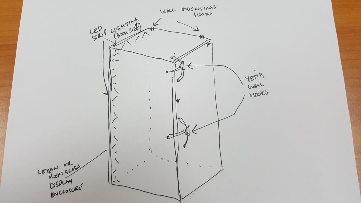

spanner Posted November 5, 2015 Posted November 5, 2015 you could easily make up a Lexan or plexiglass box which could hook up over a few sets of wall mounted Valks! sorry diagram is a bit rough but you get the idea! Quote
mickyg Posted November 5, 2015 Posted November 5, 2015 That would look very, very nice!Yeah, I wouldn't want to vouch for something using adhesive either, but that's because it's so variable and totally out of your ability to control. There's wall surface detail to deal with, paint application, cleanliness, to name but a few. And then there's also the fact that the weight is located quite far away from the point of contact with the wall, with the resulting lever action acting on the mount in a much different way to what a traditional weight on a mounting hook would entail. Yeah, without a doubt, anchoring to a stud is much safer. But I'm still tempted to try something with a safety mechanism to catch anything that might fall... Quote

ChaoticYeti Posted November 5, 2015 Author Posted November 5, 2015 sorry diagram is a bit rough 20151106_083407.jpg Rough, he says. Quote
spanner Posted November 5, 2015 Posted November 5, 2015 Rough, he says. are you making fun of my crappy diagram!? Quote
ChaoticYeti Posted November 5, 2015 Author Posted November 5, 2015 are you making fun of my crappy diagram!? This a funny forum. If that counts as rough, I am with kin. It was a jab at your modesty. Quote

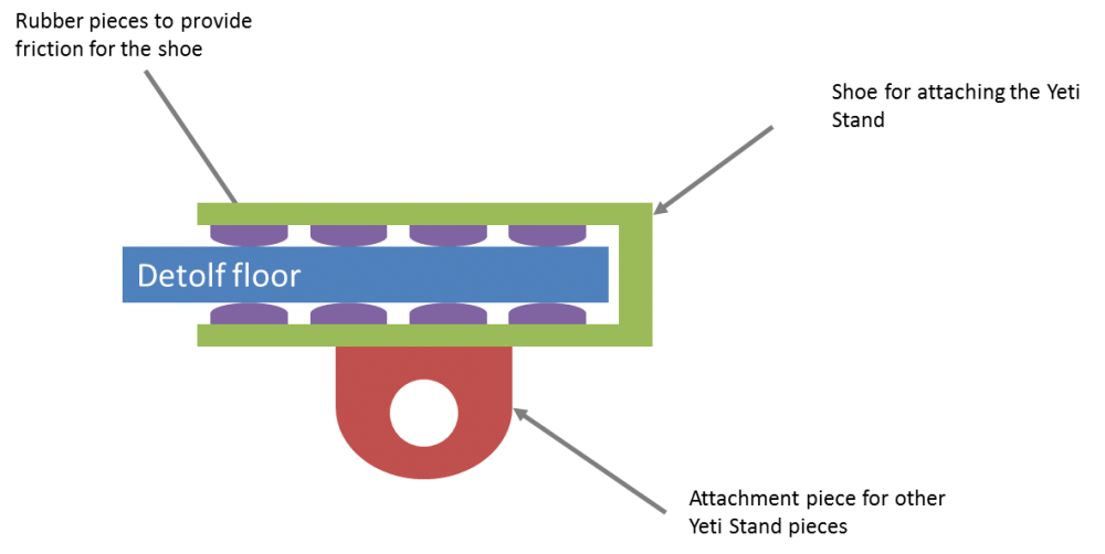

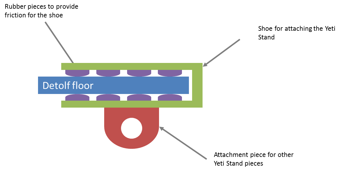

Scyla Posted November 6, 2015 Posted November 6, 2015 (edited) Have you thought about gluing the wall mount piece to the inside of Detolf cabinet? There the fall height wouldn't be as high as on walls of a room. You could even create a mount that attaches to the glass floors of the cabinet. Basically like a glove that wraps around the glass floors maybe with some rubber inlets so it is secured firmly to the floor.Something like that: So you could use the space for the walls and ceilings a bit better.[edit:] the attachment for the arms should be either on the top or the bottom to work properly. [edit2:] Since pixel art doesn't suffice my artistic needs I added a picture of the idea. Edited November 9, 2015 by Scyla Quote

ChaoticYeti Posted November 12, 2015 Author Posted November 12, 2015 Have you thought about gluing the wall mount piece to the inside of Detolf cabinet? There the fall height wouldn't be as high as on walls of a room. You could even create a mount that attaches to the glass floors of the cabinet. Basically like a glove that wraps around the glass floors maybe with some rubber inlets so it is secured firmly to the floor. Something like that: test_attachment.png So you could use the space for the walls and ceilings a bit better. [edit:] the attachment for the arms should be either on the top or the bottom to work properly. [edit2:] Since pixel art doesn't suffice my artistic needs I added a picture of the idea. This is very doable. I don't have any detolfs. What is thickness of the shelf? Yeti, let me know when these are ready for primetime so I can put my order in. Thanks. I have been swamped with work. I'll take another pass at the model this weekend, and post progress. Quote

mickyg Posted November 12, 2015 Posted November 12, 2015 The shelves are very close to 4mm (3.88) and sides are 4.75mm. For my example, at least. Quote
Saburo Posted November 13, 2015 Posted November 13, 2015 The shelves are very close to 4mm (3.88) and sides are 4.75mm. For my example, at least. I got the same measurement. Quote

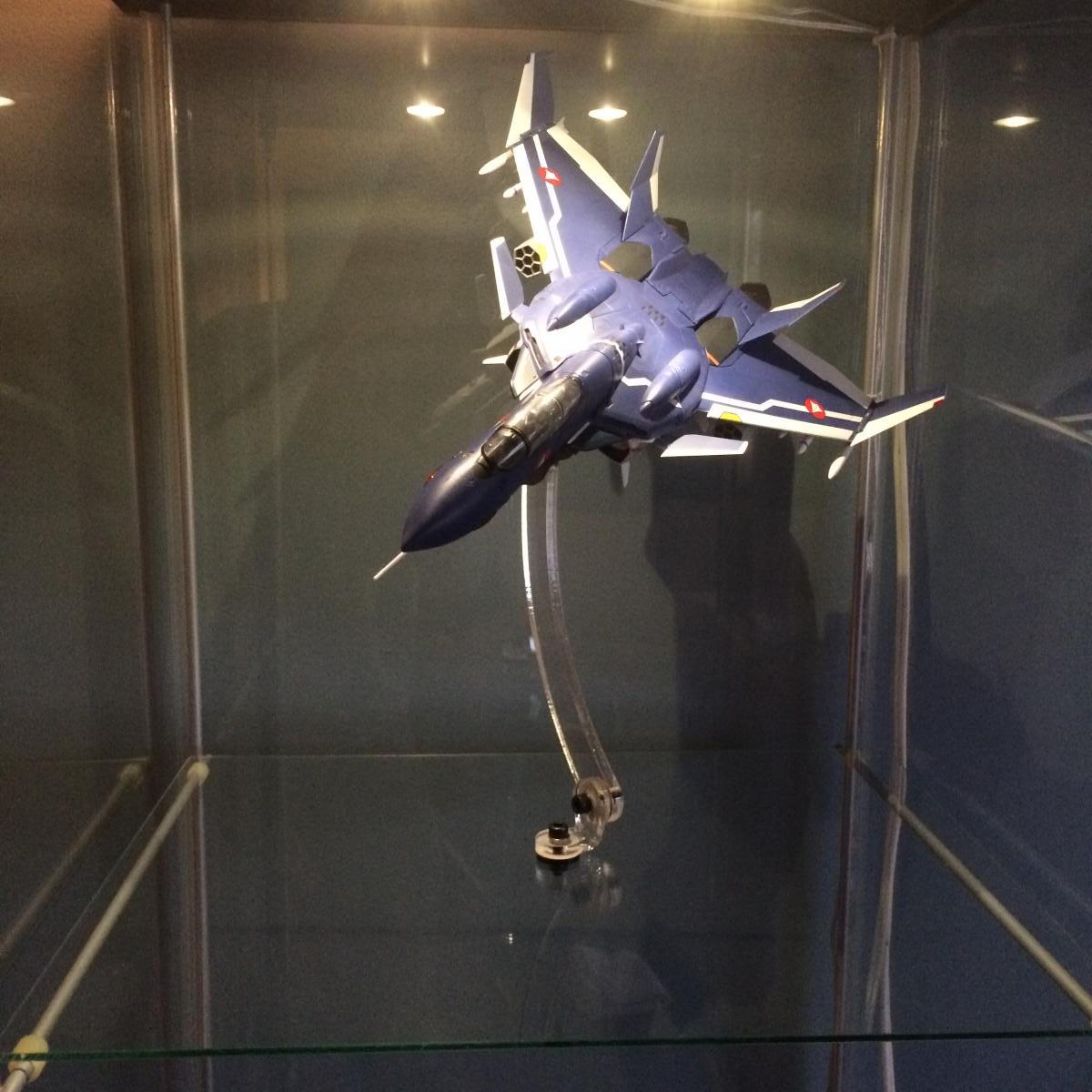

hal9000 Posted November 27, 2015 Posted November 27, 2015 (edited) I certainly wasn't going shopping today so what better time to get an idea out of my head:)FYI don't try and drill the IKEA glass it's tempered. Edit, I fixed the orientation. Edited November 28, 2015 by hal9000 Quote
ChaoticYeti Posted November 28, 2015 Author Posted November 28, 2015 (edited) Oh, wow. Is your picture sideways? Either way, that's pretty cool. There are special drill bits for glass, tempered it otherwise. Be very careful. Looks great, though! Thanks for sharing. Edited November 28, 2015 by ChaoticYeti Quote
Saburo Posted November 28, 2015 Posted November 28, 2015 I certainly wasn't going shopping today so what better time to get an idea out of my head:) FYI don't try and drill the IKEA glass it's tempered. That is cool! Quote
