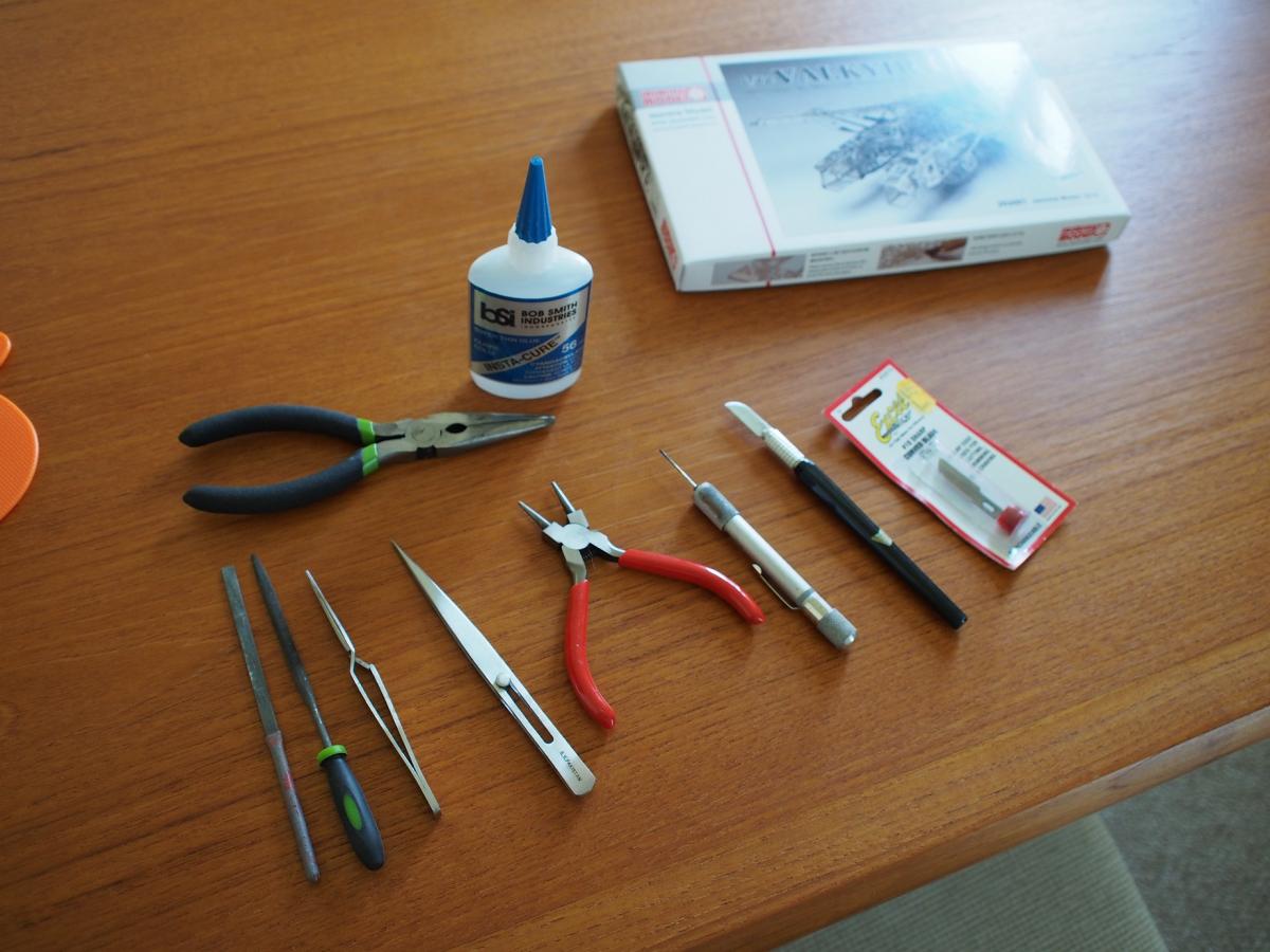

VF-19 Posted July 18, 2014 Author Posted July 18, 2014 From Left to right: Files, tweezers (clamping and slide locking), some sort of weird type of needle nose pliers (you can use the rounded tips to put curves into parts), a home made super- precise superglue applicator, knife and extra blades. The superglue applicator is something that was passed on to me from the local hobby shop. Basically, you take a needle, and chuck it into your pin vise. Using a wire snip or a piece of sand paper, you cut the top off of the needle eye. This gives you two prongs to draw up a tiny amount of superglue to put where you need it. To clean the tip, just stick it into an open flame to burn off the superglue. I probably won't be using the larger needle nose pliers that is pictured above the row of tools, but you never know... Quote

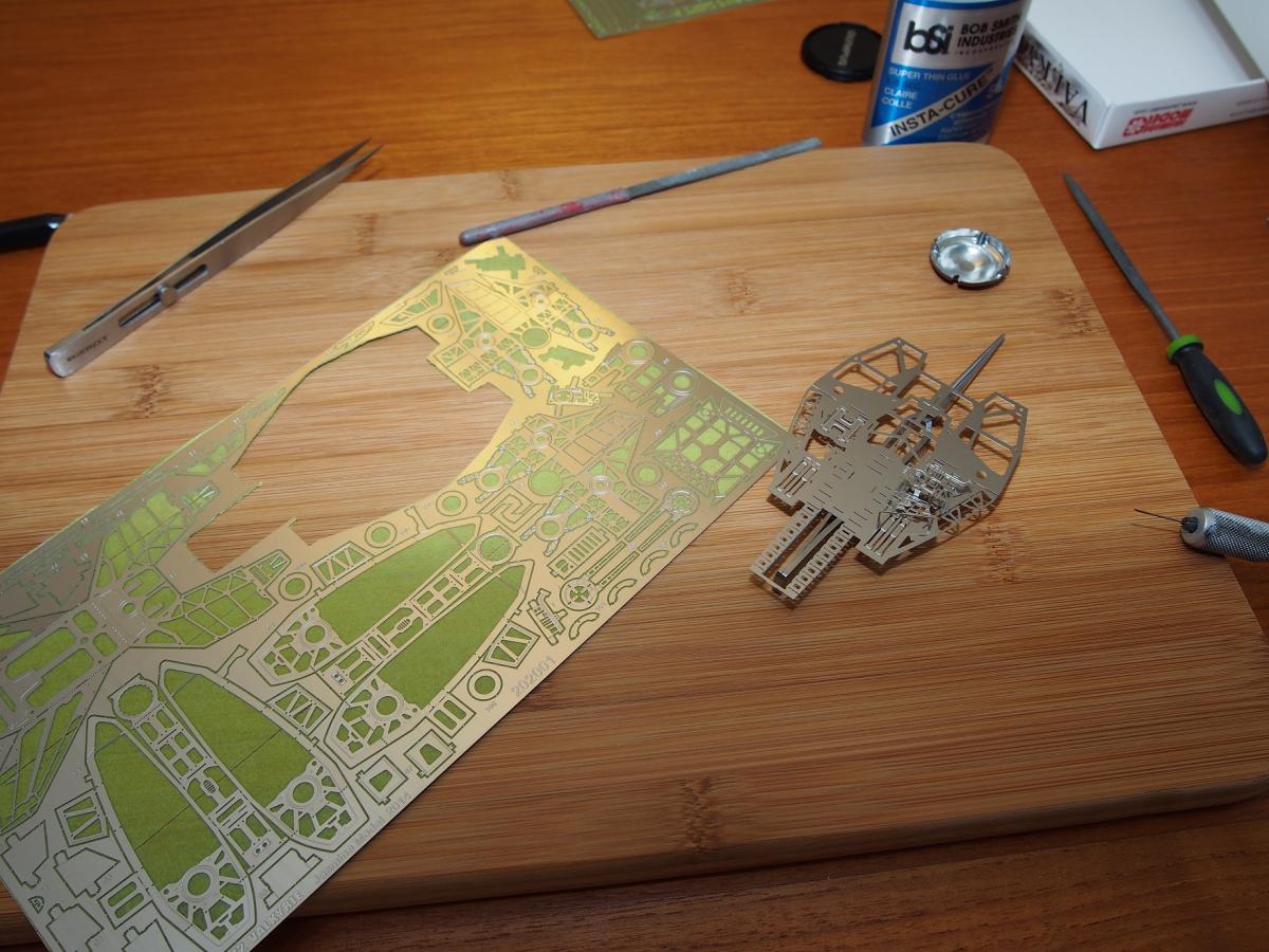

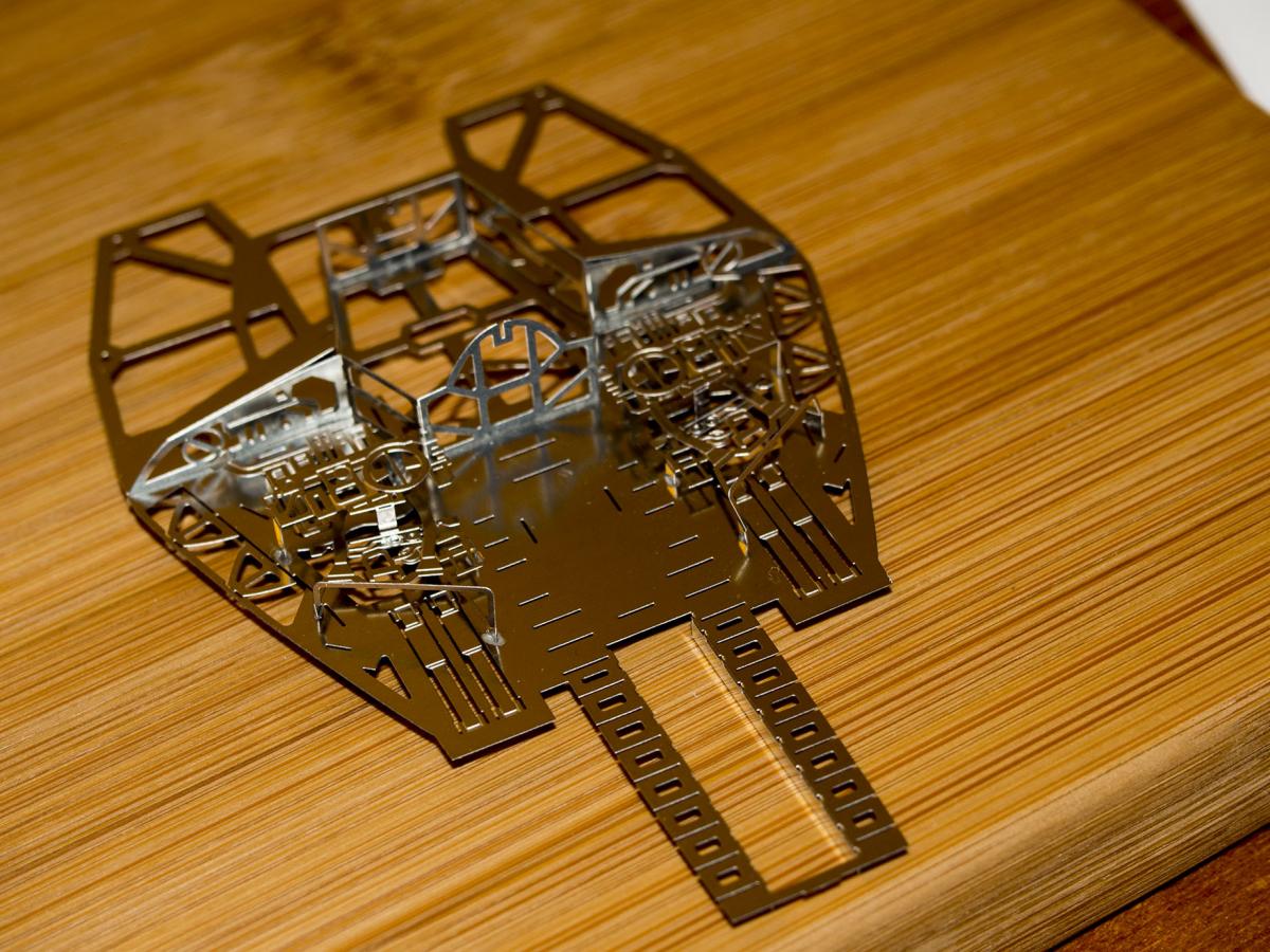

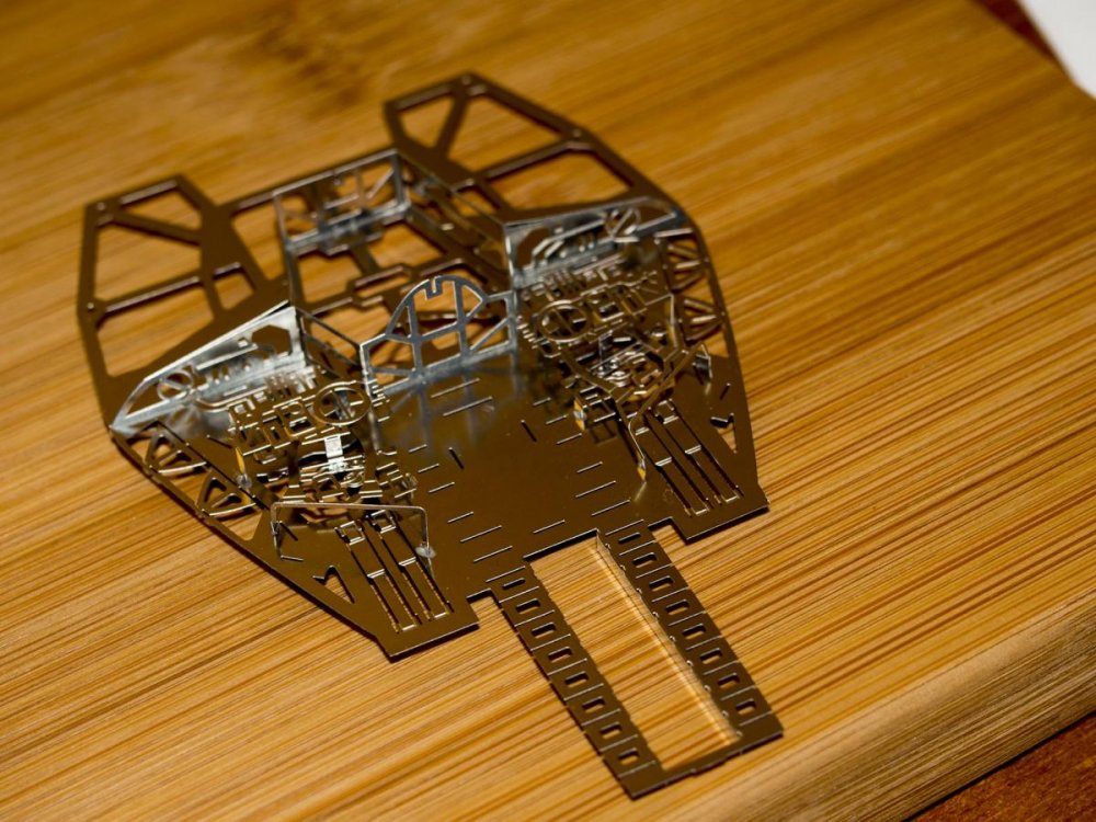

VF-19 Posted July 19, 2014 Author Posted July 19, 2014 (edited) Thanks WM! I've followed your previous threads with jealousy and envy back in the day! Today's progress: Nothing too much to report, but some observations: Bending the small tabs must be done with precision. You've only got a little bit of leeway before metal fatigue begins to want to crack the small bend joints. These bends can be achieved by hand or with a small set of tweezers. I've tried both, and the tweezers are a little easier. You can see in the first shot the tape I've applied to the rear side of the fret, and after cutting the part out, I just peel the tape off a bit to pull the part away. I do wish that the pieces fit together with a bit more tightness, so that they don't move around while I'm gluing them, however. EDIT: I realized I probably should mention that it's best to install the three pieces in the order of front-to-back, although putting the first, and third, and then the middle piece will work out too. Naturally, since this is all metal, a mistake can be fixed with a little bit of debonder and a re-try. Edited July 19, 2014 by VF-19 Quote

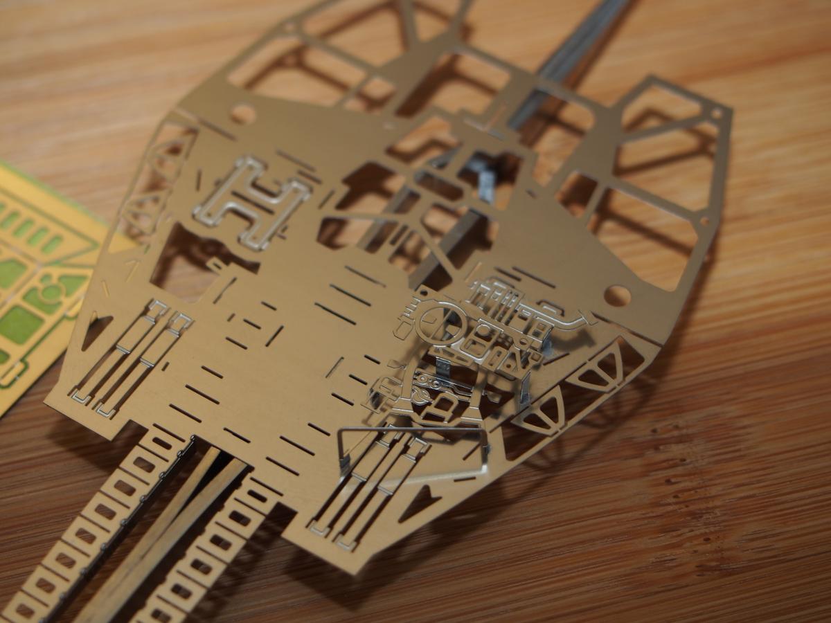

VF-19 Posted August 4, 2014 Author Posted August 4, 2014 OK. Back at it for a bit. Not too hard, but the instructions could use a mention as to which side should be facing you when you start to do multiple folds, in particular the two pieces that begin to form the fuselage top. The next step involves the multiple pieces that form the nose. YIKES! Not too happy with a couple of the glue joints. I may zap it with some de-bonder and try again. Quote

strike_kf Posted August 30, 2015 Posted August 30, 2015 Thanks a great tip on how to apply the crazy glue. I have a set for the vf 25 and been wondering the best way to apply. Any tip in how to delay the setting time so one has time to adjust? Quote
MechTech Posted August 30, 2015 Posted August 30, 2015 Hey Strike_kf. Superglues pretty much have to be bought slower curing. You can't dilute them or anything. Look up Zap CA brands. Also mentioned above is taking a needle and cutting the top portion of the eye off. I made one years ago and use it a lot. When the glue dries between the prongs, just break it off to clean it.-MT Quote
