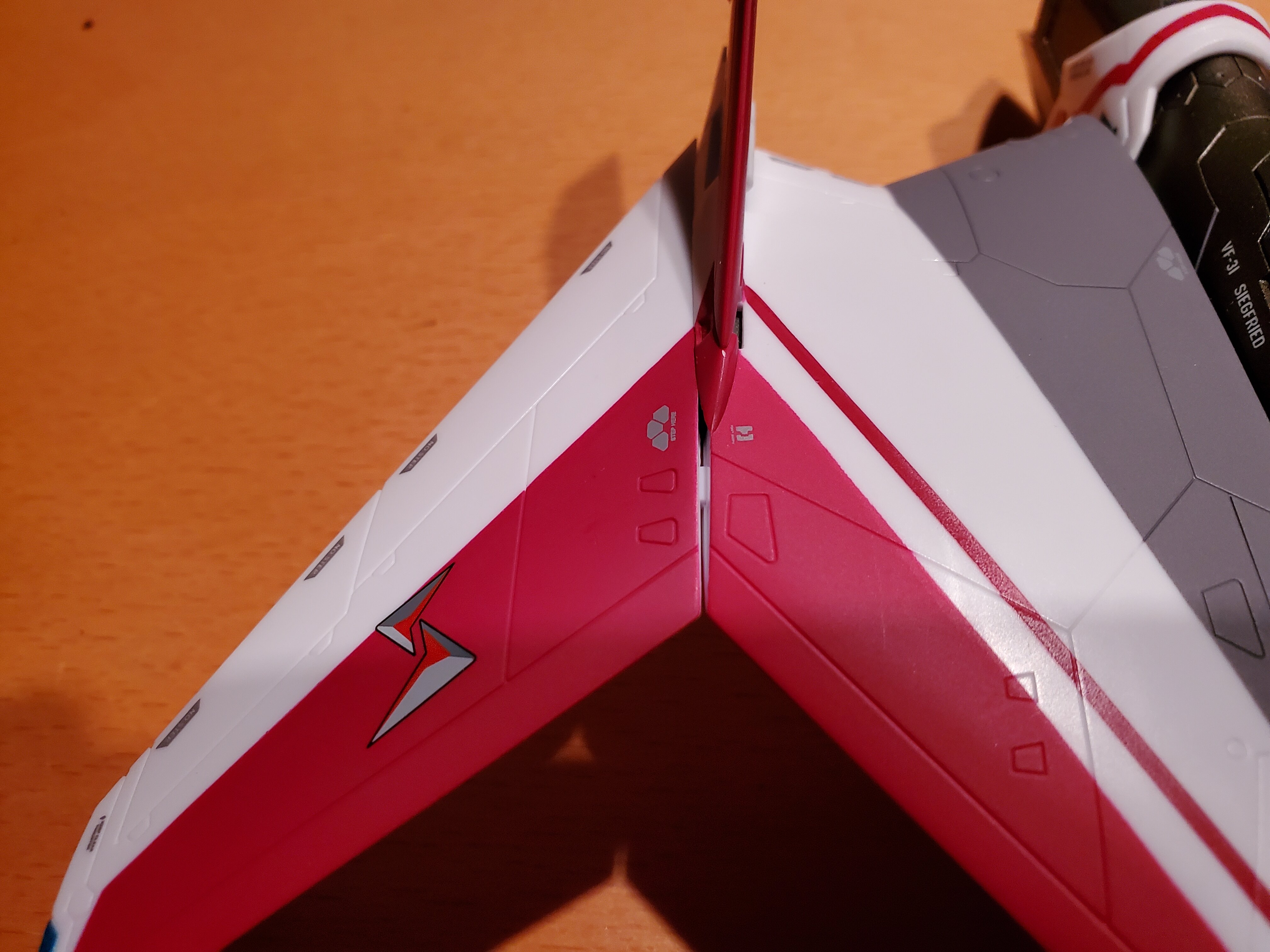

jenius Posted July 9, 2023 Posted July 9, 2023 2 hours ago, Zeliard said: Hi guys. I obtain a unit of Mirage VF-31C used, still in excellent condition. But I notice the tail fins are not at the usual upright position, but rather found underneath tucked away at the wrist. Is this normal? Or a defect? I've checked reviews, and unboxing. Certainly I don't see this. How is this possible? Maybe they're easy to pop off? Quote
Zeliard Posted July 9, 2023 Posted July 9, 2023 25 minutes ago, jenius said: How is this possible? Maybe they're easy to pop off? Nvm. Solved. Is actually a peg, the original owner wrongly attached it underneath Quote

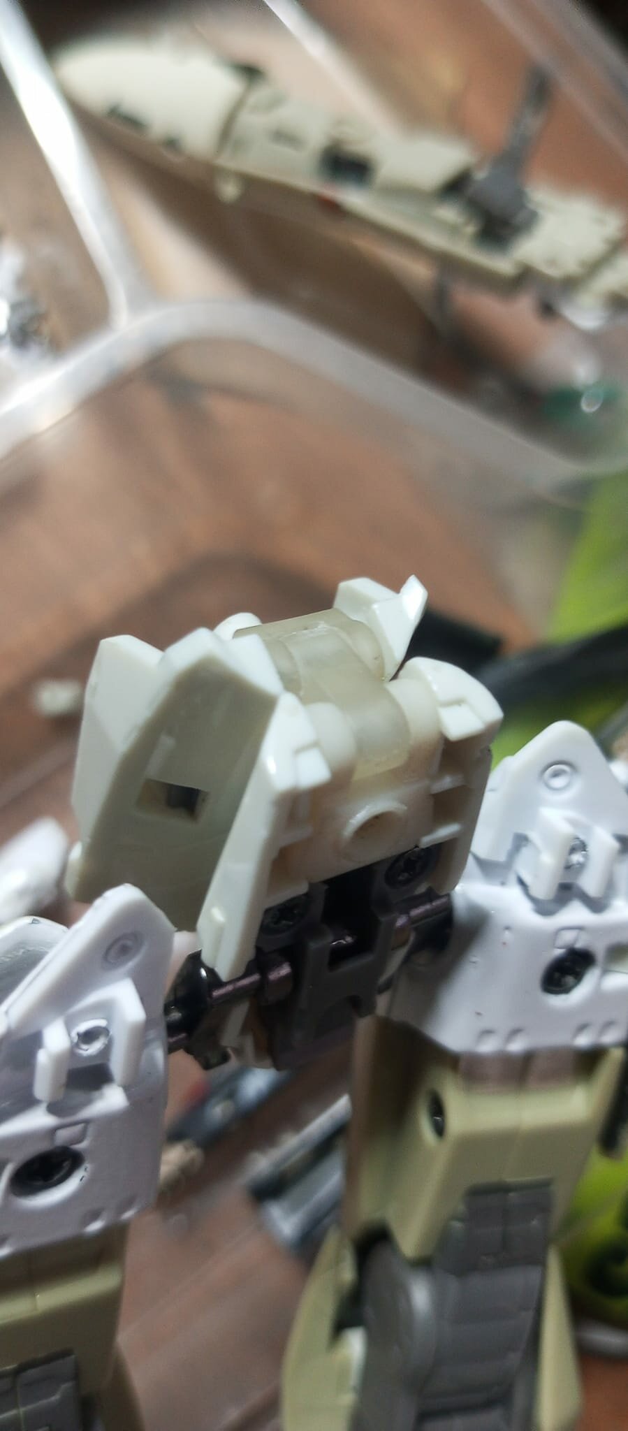

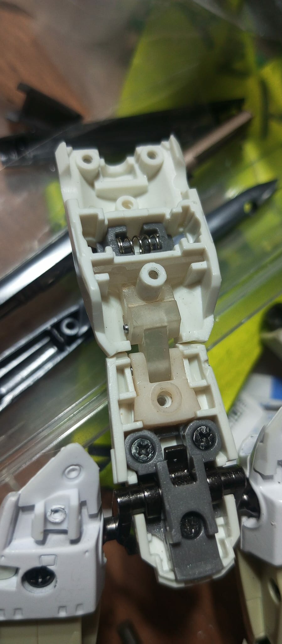

Tannerbot2k Posted September 18, 2023 Posted September 18, 2023 Good day folks. Forgive me if this has been asked, I couldn't find it. My reissue VF-25f has a very loose shoulder joint. Tightening the screw on its own didn't do anything, so I think I'll need to take apart the shoulder (pic included). How would I do this? It looks like it has at least one pin, so I am afraid of aplying force before I know what I'm doing. Thank you. Quote
no3Ljm Posted September 29, 2023 Posted September 29, 2023 On 9/18/2023 at 5:12 AM, Tannerbot2k said: Good day folks. Forgive me if this has been asked, I couldn't find it. My reissue VF-25f has a very loose shoulder joint. Tightening the screw on its own didn't do anything, so I think I'll need to take apart the shoulder (pic included). How would I do this? It looks like it has at least one pin, so I am afraid of aplying force before I know what I'm doing. Thank you. Which joint you're pertaining to? The one attached to the arm or the one to the chest? In case you missed it, I explained how I fixed mine on Page 1. Hope that helps. Quote
Tannerbot2k Posted October 7, 2023 Posted October 7, 2023 On 9/29/2023 at 12:23 PM, no3Ljm said: Which joint you're pertaining to? The one attached to the arm or the one to the chest? In case you missed it, I explained how I fixed mine on Page 1. Hope that helps. The ball joint inside that housing. I was trying to disassemble it, but it was very stubborn. I needed disassembly instructions. I do have some kiki joint repair on the way, but if I can take apart the joint first, that would be ideal. Quote
David Hingtgen Posted October 22, 2023 Posted October 22, 2023 VF-25: Since the shoulder armor is so hard to remove, I just left the joint assembled, and poured nail polish inside as best I could. Several times, with the arm in different positions so it'd flow to different areas. Though if I were to do it again, I'd use Future. (nail polish is "hot" enough that it reacts with the plastic part of the ball-joint socket, and it dissolved a small amount of material at the edge). Quote
Tannerbot2k Posted October 22, 2023 Posted October 22, 2023 10 hours ago, David Hingtgen said: VF-25: Since the shoulder armor is so hard to remove, I just left the joint assembled, and poured nail polish inside as best I could. Several times, with the arm in different positions so it'd flow to different areas. Though if I were to do it again, I'd use Future. (nail polish is "hot" enough that it reacts with the plastic part of the ball-joint socket, and it dissolved a small amount of material at the edge). I'm using kiki joint fixative. I'll see how it goes. Quote

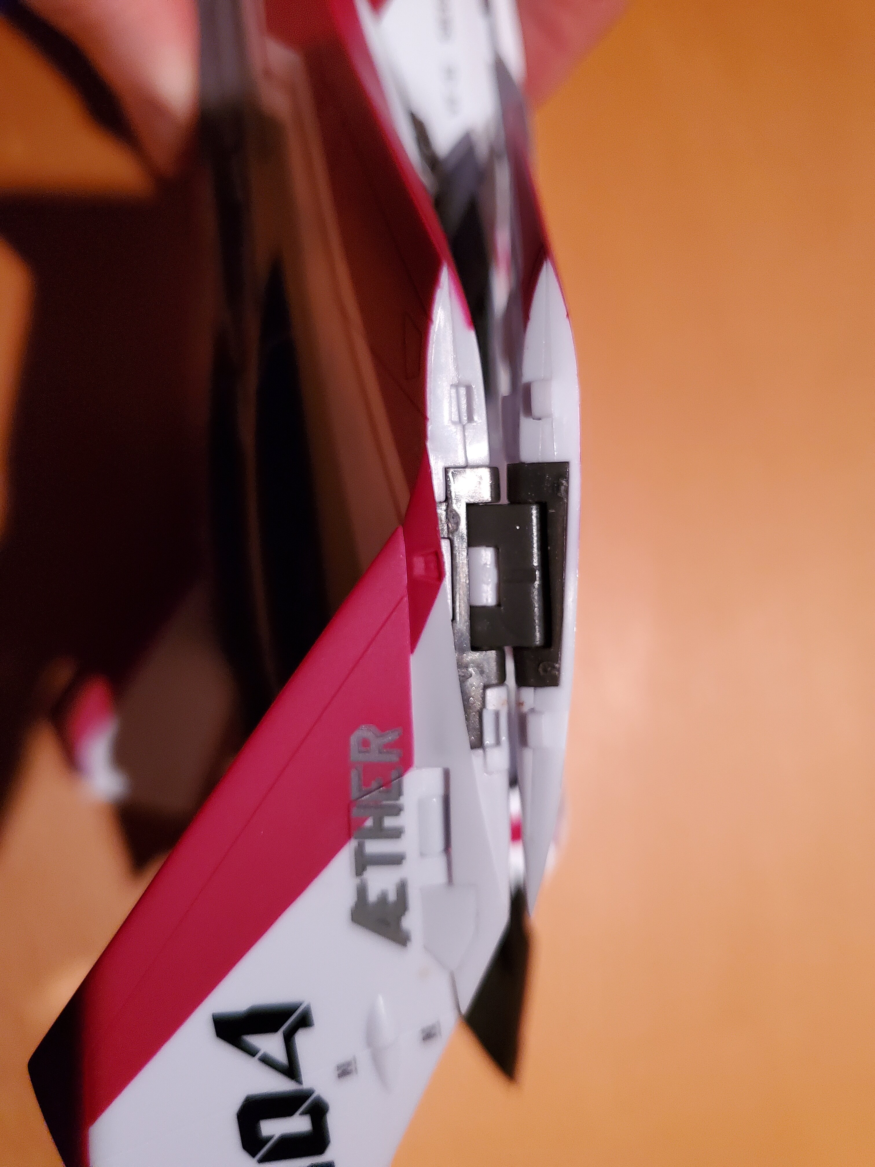

guyxxed Posted December 11, 2023 Posted December 11, 2023 Hello, I'm relatively new to collecting and just bought my first DX valkyries this year (a pair of 25s and a pair of 31s). Both of the VF-31s (they are a 31C and a 31J) have an issue with the right hand wing where the folding end part does not snap into the "fully up" position and leaves a gap. I read through this thread and much of the 31 DX thread and saw a few mentions of this issue, but no definitive solutions. It's clearly interference from something "bottoming out" and not letting the wing snap home, but I've not been able to localize it so far (and not seen any sign of extra glue or sprue burs that are causing the problem). I'm not averse to shaving and sanding, but want to make sure I go after the root cause and am not just trial-and-erroring it. Since it's come up a few times here (and on both my items), it seems like there might be a common cause and it was worth asking about before I got out the knives and files. Any input anyone has would be appreciated. Quote

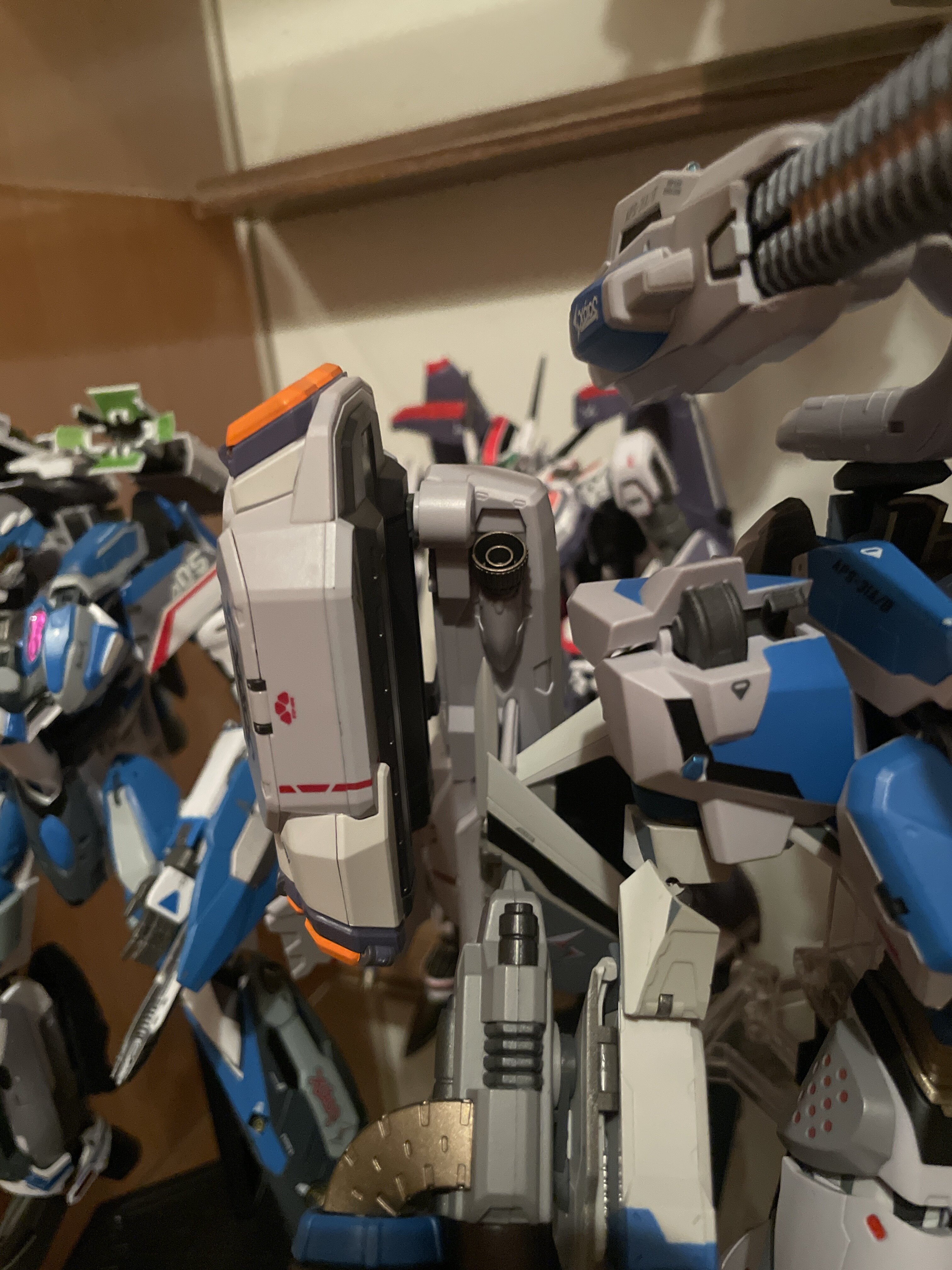

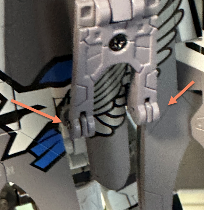

Sandman Posted April 17, 2024 Posted April 17, 2024 I'm having trouble with my VF-31J kai. In battroid mode the backpack with the gun and pod won't stay up. it keeps falling back. The problem seems to be where I marked on the pic. There doesn't seem to be anywhere I can tighten up. Anyone know a way it stop if from flopping back? Quote
no3Ljm Posted April 18, 2024 Posted April 18, 2024 18 hours ago, Sandman said: I'm having trouble with my VF-31J kai. In battroid mode the backpack with the gun and pod won't stay up. it keeps falling back. The problem seems to be where I marked on the pic. There doesn't seem to be anywhere I can tighten up. Anyone know a way it stop if from flopping back? So I assumed overtime, those pins gets loose? Aside from the paper suggestion above, maybe you can try using clear nail polish in-between to tighten it up? Quote

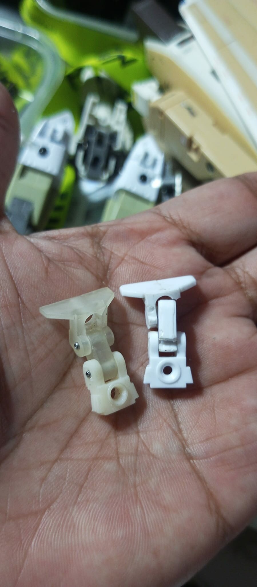

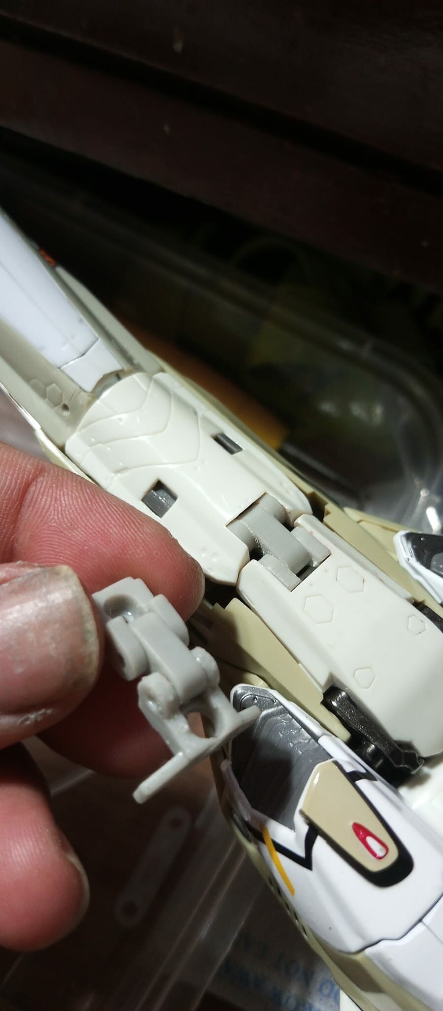

Wewyllenium Posted July 1, 2024 Posted July 1, 2024 Replaced DX-vf 25 cracked hip joint assembly. Quote

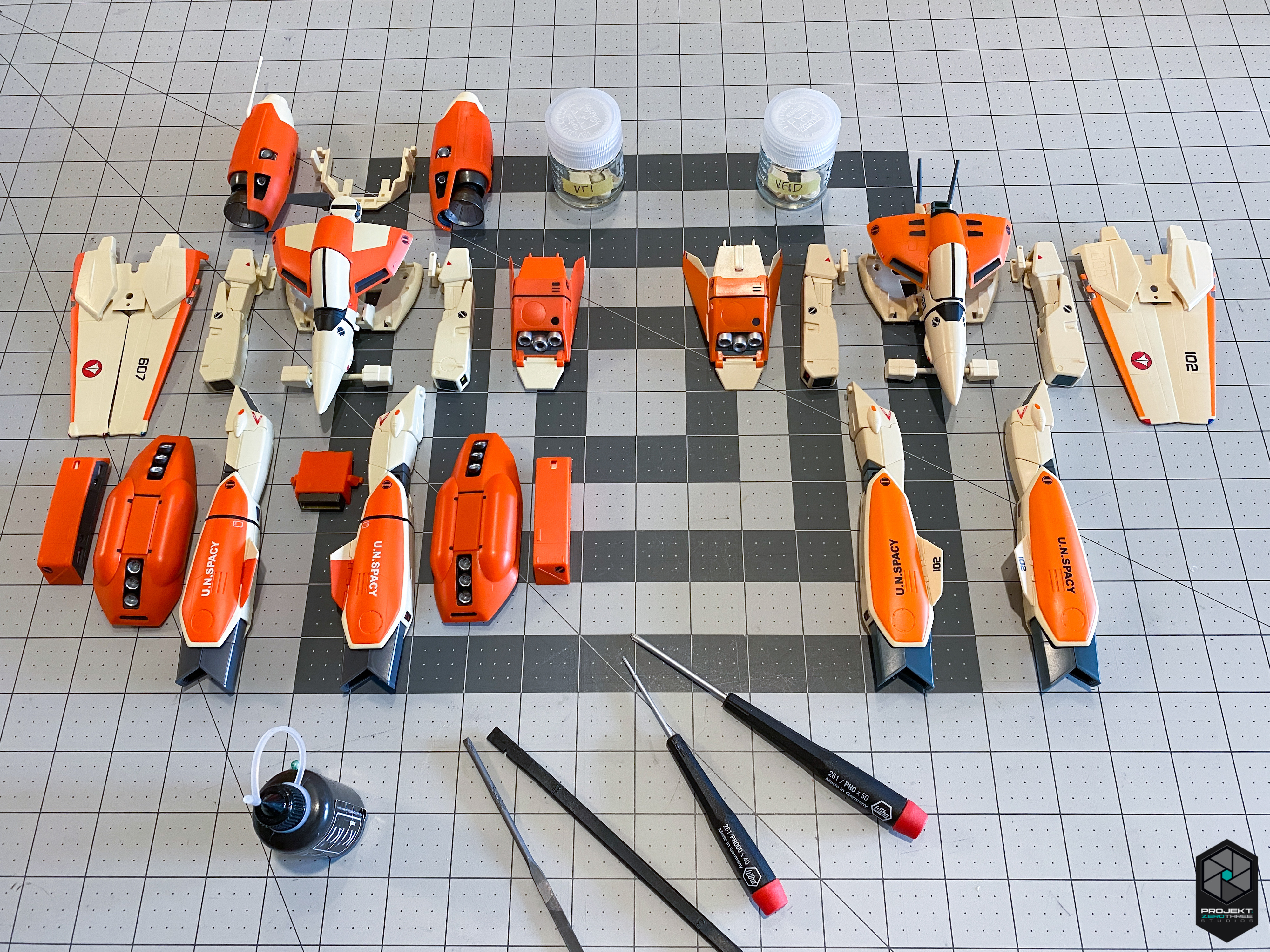

recon Posted July 2, 2024 Posted July 2, 2024 On 5/12/2021 at 12:11 AM, Saburo said: Prep for maintenance. The VT-1 and VF-1D that I had purchased from @no3Ljm were in excellent shape and well taken care of. I am still going to do some maintenance on them, these were are well known for the knurled pin cracked shoulder hinge. I'll working on fixing sanding down the knurled end of the pin to smooth it out and fixing the crack plastic hinge. I'll post pics when everything is complete. @Saburo may i check what glue you used for gluing plastic parts? Quote

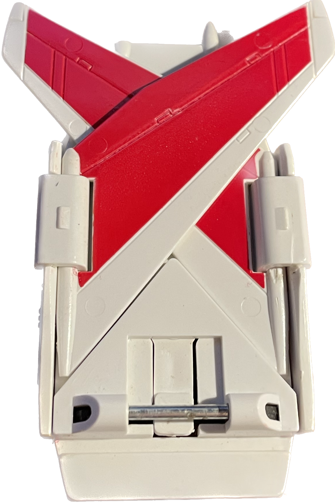

Wewyllenium Posted July 5, 2024 Posted July 5, 2024 Hi all. Here's the video showing off the VF-25 hinge fix installation and in action. Quote

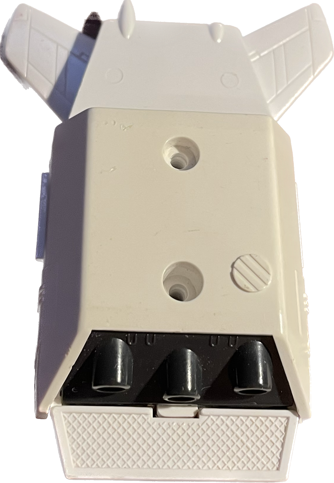

eyesonme78 Posted August 18, 2024 Posted August 18, 2024 Hi, i need some help, can anyone tell me where can i get a 3d printing drawing for this part circled in red? Quote
Wewyllenium Posted November 16, 2024 Posted November 16, 2024 On 8/18/2024 at 6:36 PM, eyesonme78 said: Hi, i need some help, can anyone tell me where can i get a 3d printing drawing for this part circled in red? I would like to make one when I get the chance. I'm still focused on VF-25 to 29 parts. Maybe next month. Quote
Wewyllenium Posted Saturday at 10:04 AM Posted Saturday at 10:04 AM On 11/16/2024 at 10:59 AM, Wewyllenium said: I would like to make one when I get the chance. I'm still focused on VF-25 to 29 parts. Maybe next month. Got the CAD. Will prototype for fitting this weekend. Quote
Wewyllenium Posted Saturday at 08:41 PM Posted Saturday at 08:41 PM On 11/16/2024 at 10:59 AM, Wewyllenium said: I would like to make one when I get the chance. I'm still focused on VF-25 to 29 parts. Maybe next month. Not sure about the fit yet. I'm having trouble pushing the spring dowel pin out off my copy to test. Will update if I manage to. TEsting on ABS like resin and Nylon resin. Quote
Wewyllenium Posted Saturday at 08:50 PM Posted Saturday at 08:50 PM On 4/18/2024 at 5:55 AM, Sandman said: I'm having trouble with my VF-31J kai. In battroid mode the backpack with the gun and pod won't stay up. it keeps falling back. The problem seems to be where I marked on the pic. There doesn't seem to be anywhere I can tighten up. Anyone know a way it stop if from flopping back? Got some tiny screws that have a flushed head that manage to fit the diameter of the spring dowel pin on mine. Screwing them in made mine tight I think they're the screws meant for eyewear repair. Quote
