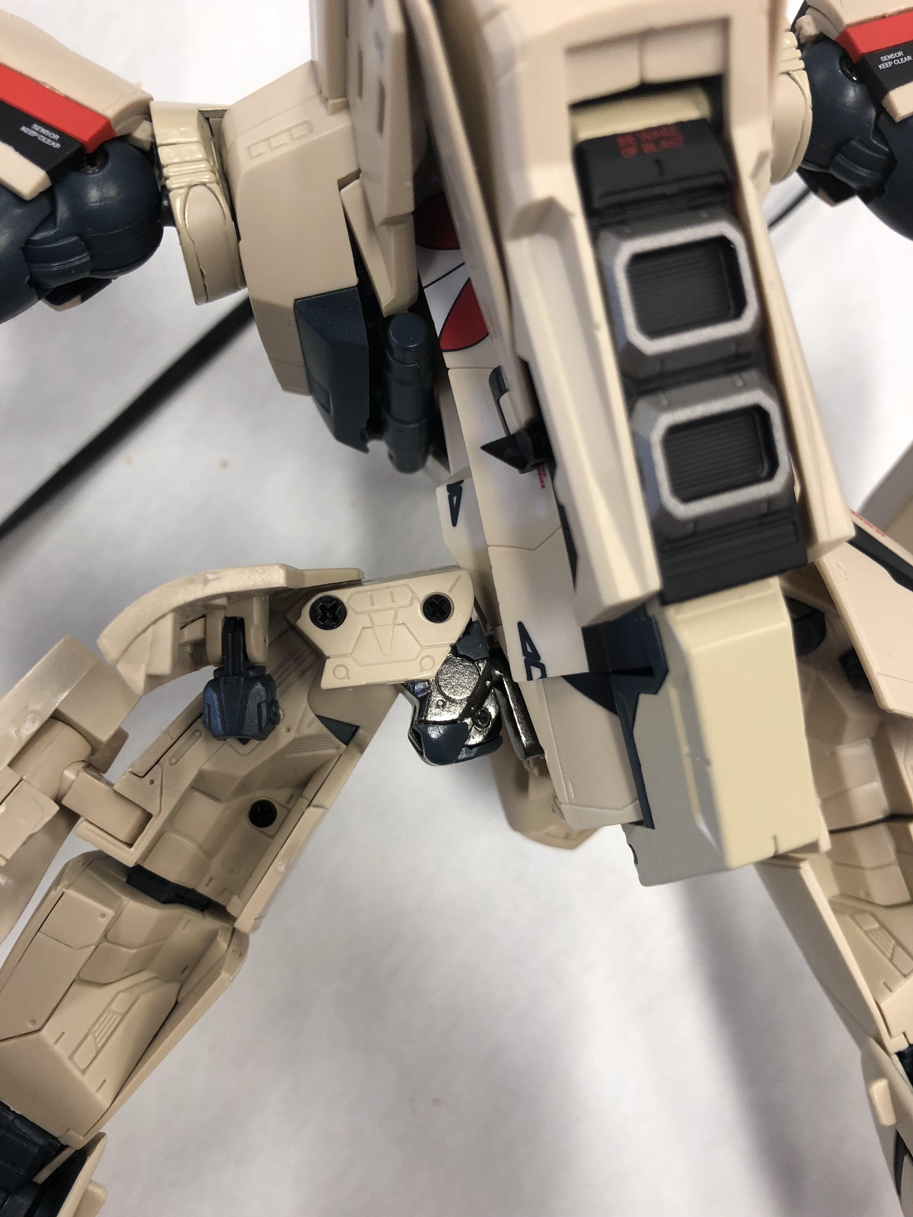

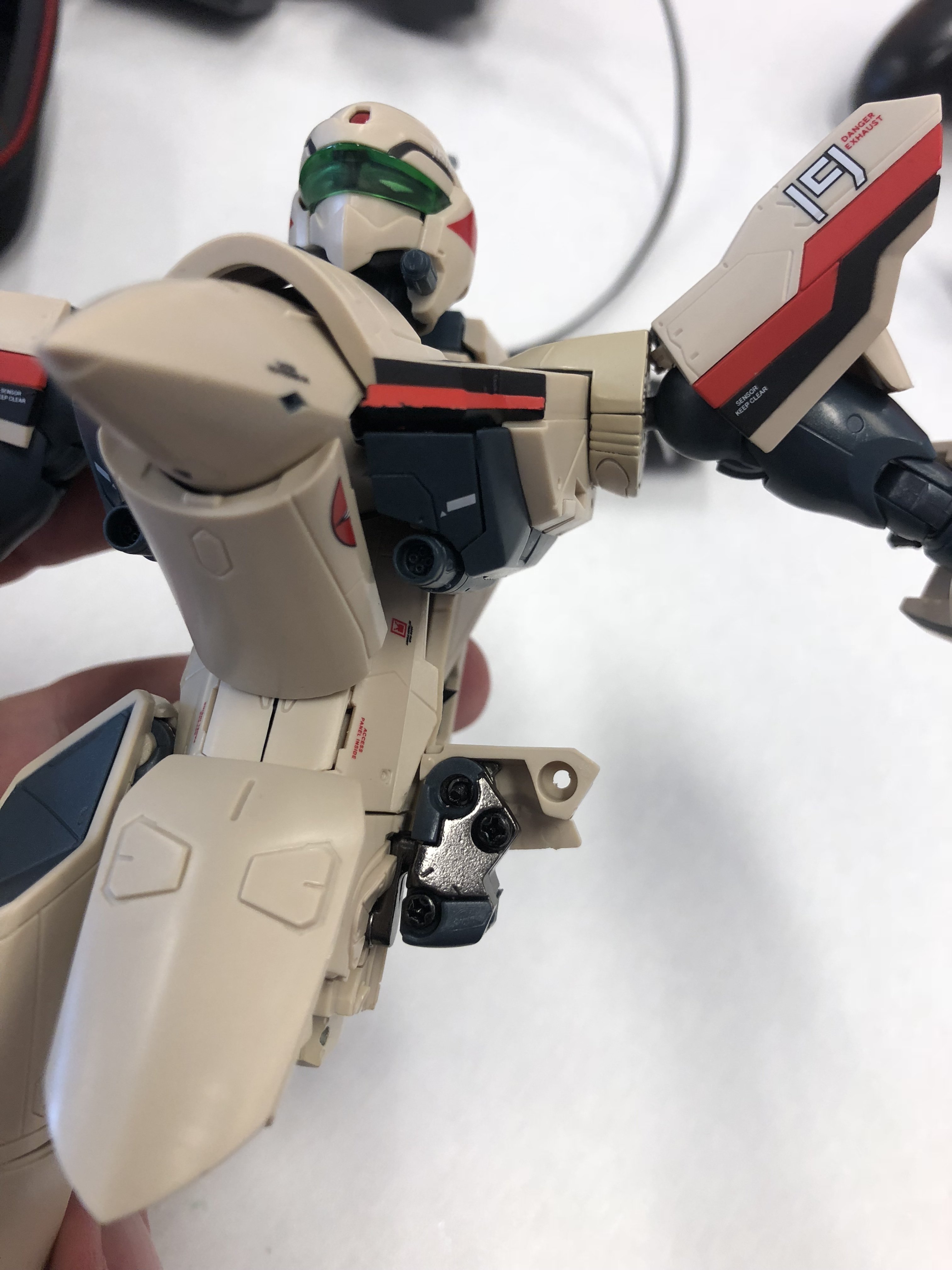

Also I think I got a new one for you guys. I don't recall seeing this crack before. It's the hinge for the radome/nose on the DX VF-25G Renewal. This part might be ABS(I didn't look close). Crazy thing is the crotch hinges look like POM to me yet they're cracked on mine! I saw those cracks a while back. For the radome cracks I think I could fix it by seeping some Krazy glue or epoxy and moving the nose gear back and forth while drying. I was able to save some cracked V2 1/60 VF-1 shoulder hinges doing that back in the day.

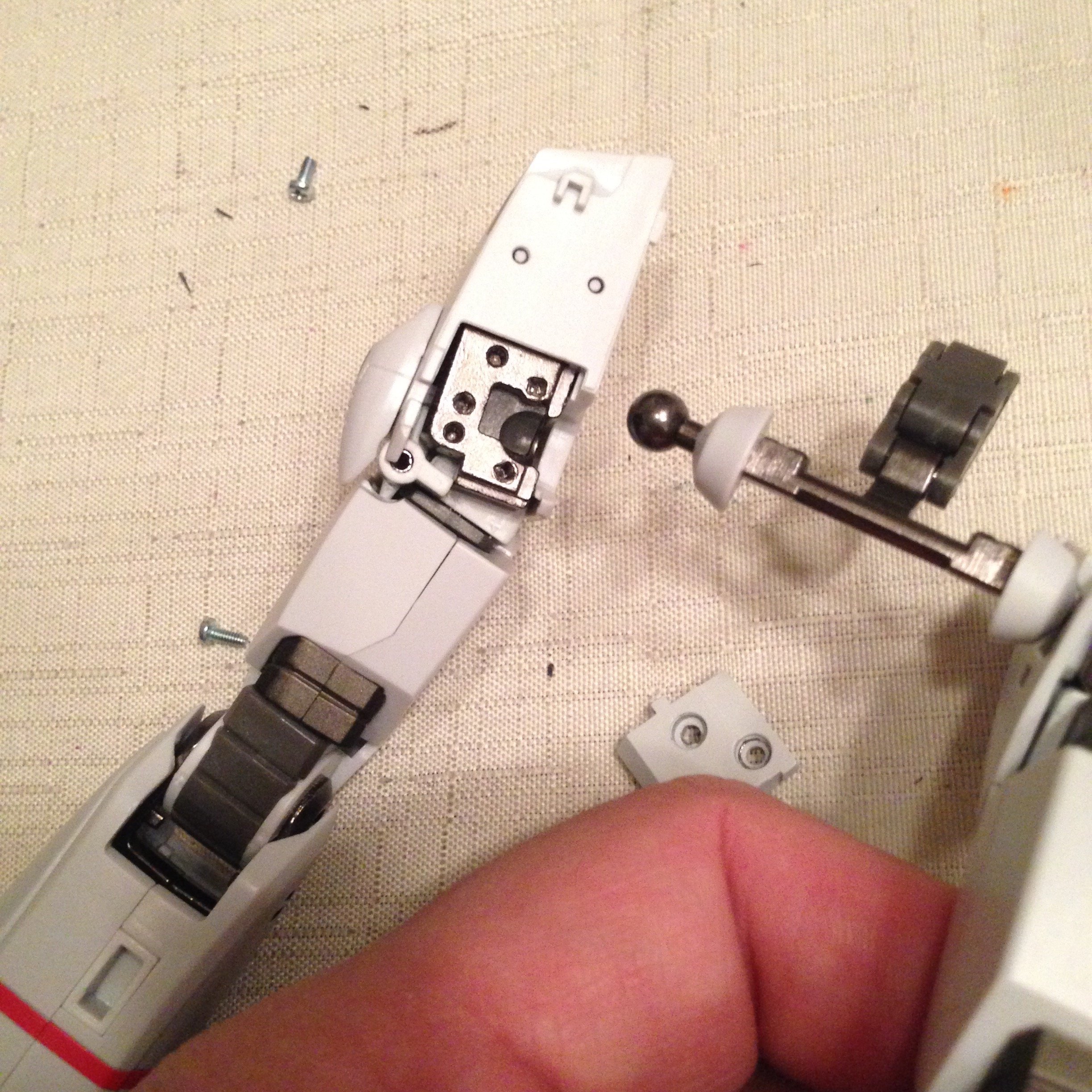

In the name of Onnasake, He Who Faced the Calamity, I offer this (kinda) tutorial.
Good news, the hips are only screwed together, no glue. The hip ball joint is like other Bandai DX Valkyries in that there’s a metal bit expanding out into a plastic ball. The leg itself is secured to the ball joint by a half-piece and two screws. Unscrew them and the leg comes off.
Now you’ll see the metal hip joint, which also comes in two metal halves secured with two screws, a plastic cap on the bottom which helps clip the halves together, and another plastic bit on the upper part. No need to completely unscrew these as these provide the tension to make the hip joint stiff. I removed mine completely because I was curious and it was a bit of a faff to get it all together again. I recommend you almost completely unscrew them, move the leg gently to help break up the tension, then gradually re-tighten them until the hip is stiff enough for your liking. Then re-attach the leg.

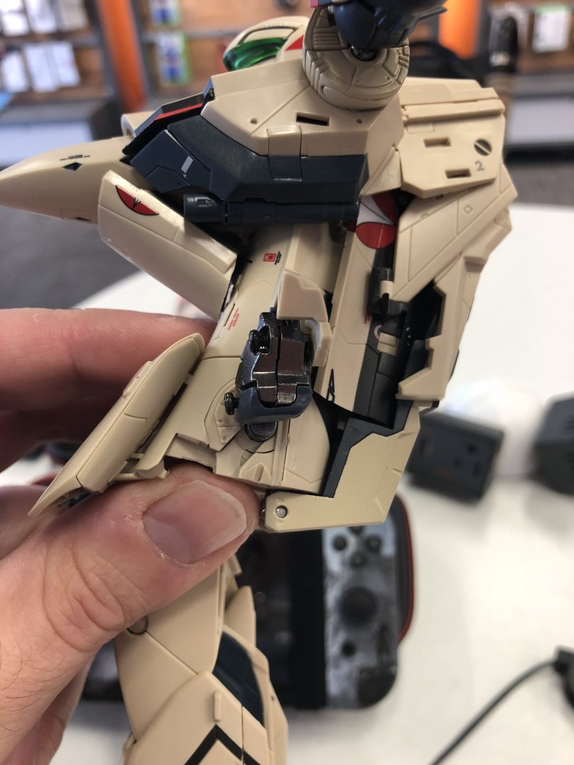

That said I need to start my repair on the broken YF-19 head laser
I was getting ready to fix the hips and shoulder of my VF-27; transformed, polish nail everything ready....
... then I noticed there was a screw. Gave it a micro twist and it's tight now XD
