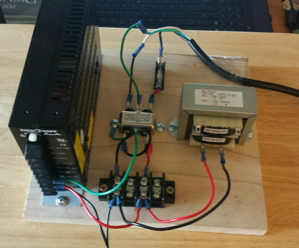

Jasonc Posted May 1, 2014 Posted May 1, 2014 OK, I figured I'd post this here. As my wife and I are getting ready to move into our new house (we'll be in by August), I had an opportunity to buy the Macross Plus Jamma board, as well as the Macross DYRL board, and am going to work on making these as two stand up, coin-op arcade games to put in our house. For anyone that knows, or has some experience working on coin-op arcade games, does anybody have a clear diagram of the wiring for power? I have the switching power soure already, JAMMA cable. I still need to buy the power cables, but is there anything else I need to consider for the power, like on/off switch, AC noise filter, or anything like that, or are these things unnecessary with the newer power supplies (referring to the AC filter). I'm also looking for some hi-res graphics to put on the side of the cabinet for both games, as well as something for the marquees in the front. I found the original one for the DYRL game, but not one for Macross Plus. Any help would be appreciated. working on this build will take awhile, but for now, I'm working on all he electrical parts to make this work. Thanks. Pics will be up eventually, once I start the wood work. Quote

Jasonc Posted May 19, 2014 Author Posted May 19, 2014 Power supply and all the wiring is almost done. Just waiting on a distribution transformer and some extra wiring connectors and it's all done. Just got the A/C noise filter connected to the main power wire and to a fuse. Also have the voltage distributor block and power switcher just about wired up. Definitely need to practice my soldering again. Quote
Jasonc Posted May 22, 2014 Author Posted May 22, 2014 Power supply setup 95% done. I'll be picking up a manual on/off single pole switch tomorrow at Home Depot that will eventually get routed to somewhere on the outside of the cabinet to power off the game when not in use, instead of having to go in the back and pull the plug out. Quote
