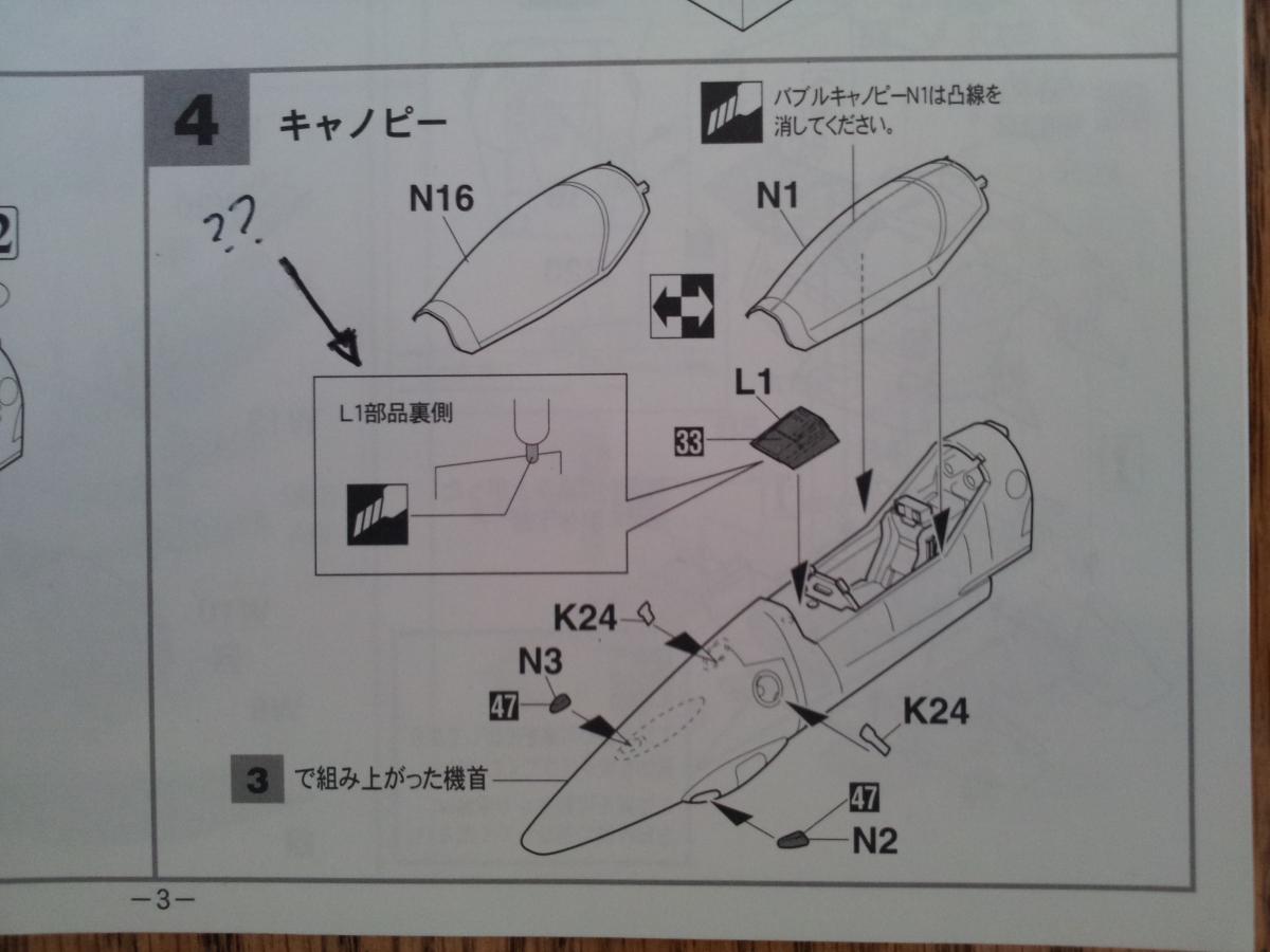

vincemoto7 Posted February 13, 2014 Posted February 13, 2014 To anyone who's started this kit, I'm confused with step 4 on the assembly guide, what is saying to do/ cut? Is this a step for the PE parts? Quote
MinoRem Posted February 13, 2014 Posted February 13, 2014 L1 has a little stick that goes in the hole and there's a tiny tiny tiny nub for you to cut off. If that little stick is rounded you know you've done it right. Quote
Jefuemon Posted February 15, 2014 Posted February 15, 2014 To anyone who's started this kit, I'm confused with step 4 on the assembly guide, what is saying to do/ cut? Is this a step for the PE parts? What they're warning you about is that for this particular part, you've got to remove the excess plastic that's under the part. It needs to sit flat, so just sand or cut away the little excess that's there. Quote
vincemoto7 Posted February 15, 2014 Posted February 15, 2014 L1 has a little stick that goes in the hole and there's a tiny tiny tiny nub for you to cut off. If that little stick is rounded you know you've done it right. What they're warning you about is that for this particular part, you've got to remove the excess plastic that's under the part. It needs to sit flat, so just sand or cut away the little excess that's there. Thanks for the clarification. I saw it from a different perpective, looking at the picture, I thought they were saying something had to be cut from the top of the part... I really need to learn japanese. Quote
CrazyDude Posted February 15, 2014 Posted February 15, 2014 That type of part/sprue attachment is called an "under gate" and is quiet common now. There should be a graphic instruction in the beginning of the guide about those. Quote
vincemoto7 Posted February 18, 2014 Posted February 18, 2014 There should be a graphic instruction in the beginning of the guide about those. I think there should be an english version of the assembly guide. Actually, hasegawa does a pretty good job, that step was the only part that got me. Quote
