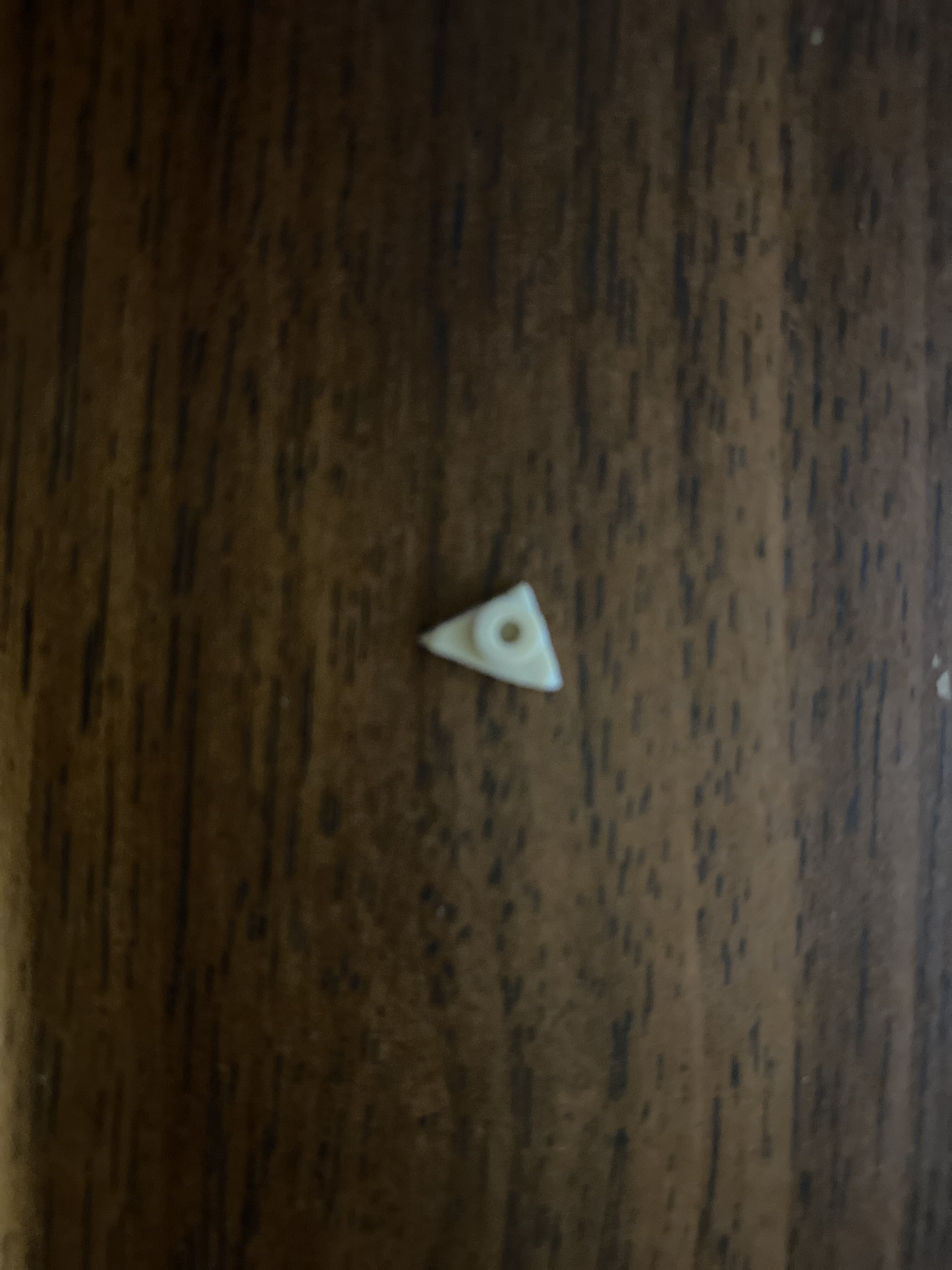

2 minutes ago, Sandman said:
So I was transforming my yf-19 the other day and this little triangle piece fell out from somewhere. I can’t figure out where it’s from. I hoping someone here knows.
Check the arms. Maybe it's the screw cover just popped out.
