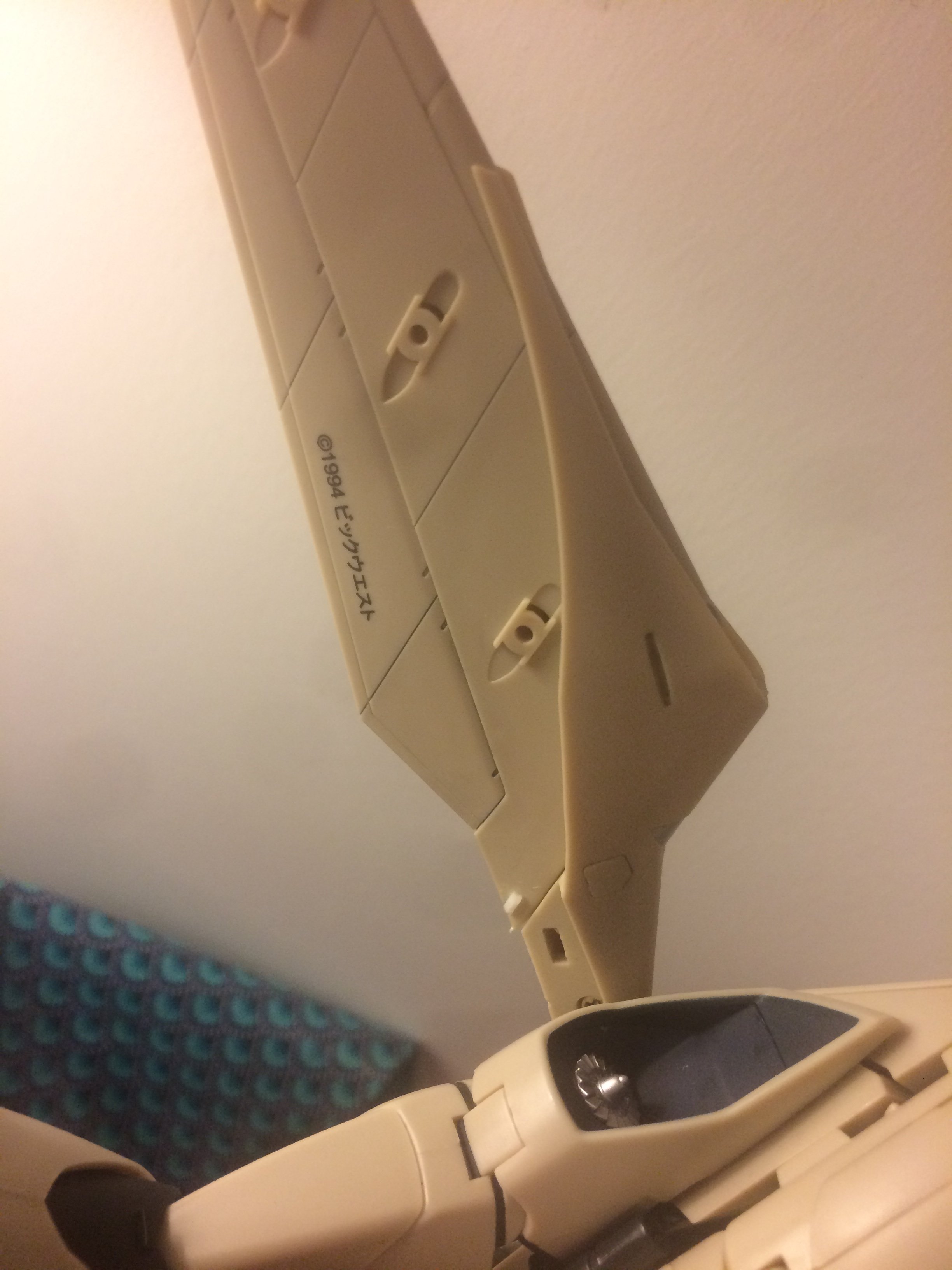

vlenhoff Posted January 1, 2017 Posted January 1, 2017 On 12/16/2016 at 2:48 PM, ArchieNov said: No, it's not that. I have the same issue as vlenhoff. I've disassembled the joint to see what's causing it and I think they just angled that last ratchet the wrong way or something. Sometimes I find myself taking that joint apart and putting it back together collapsed because I'm also fearful of breaking it with too much force. Thanks ArchiNov, I knew i could not be the only one. I will have to disassemble the joint then. I know something is wrong, i've never ever encountered such a tight joint. It is ridiculous. Quote

vlenhoff Posted January 1, 2017 Posted January 1, 2017 13 minutes ago, Scream Man said: Ive never been worried about breaking the joint, but mine are definitely stiff. Still ok on mine, and I transform my fighters a lot.... I totally understand Scream Man, but there is a difference between a very stiff joint, and a frozen one. I have broken pens and pencils with less force... Yes I am joking, but this thing is frighteningly stiff. I think the only way to resolve this is to disassemble the joint, and hopefully find out a way to make it work properly. My Yamato YF-19 is perfectly fine in that area. I may have to call James May to reassemble this. Quote

Scream Man Posted January 4, 2017 Posted January 4, 2017 On 1/1/2017 at 11:13 PM, vlenhoff said: I totally understand Scream Man, but there is a difference between a very stiff joint, and a frozen one. I have broken pens and pencils with less force... Yes I am joking, but this thing is frighteningly stiff. I think the only way to resolve this is to disassemble the joint, and hopefully find out a way to make it work properly. My Yamato YF-19 is perfectly fine in that area. I may have to call James May to reassemble this. Ok, so longer than 24 hours i have transformed it back and forth a couple of times,and i dunno what makes it stick, but i also didnt have a worry with it. I shifted the legs back and forth several times and no hint of damage. Quote

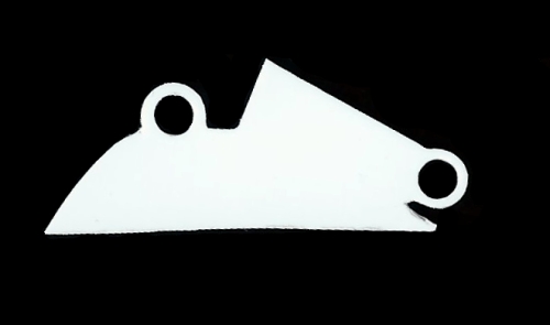

Chronocidal Posted January 11, 2017 Posted January 11, 2017 (edited) I got to cutting up some scrap plastic tonight, and might have a fairly viable solution for the wing hinges. Those are cut from roughly 1/16" sheet styrene, and very carefully filed to shape. The gray one was made first, before I realized I could strengthen the actual wing pivot by extending it to the rear, and it would still fit inside the wing when folded up. End result? It works great. I sandwiched both those brackets together inside the wing and closed up the wing glove, and it rotates nicely, just like the original Yamato YF-19's wing. However, you can see I've got two copies here, and I actually went through one other before realizing that this might need to be made of thin metal. The original wing brackets were very finely shaped, and fit very tightly around the wing pivot points, which means the pivots were also really thin. Those little rings are fragile, and probably won't hold up to many transformations. But they work, the bracket basically locks the wing pivot in the unextended pivot position, and lets the wing rotate back to fold in for battroid mode. The location may not be exact, but it's close enough for my taste. I'm going to get a master pattern drawn up with measurements via caliper, and see if anyone wants to give it a shot with something a little better than styrene. Edited January 11, 2017 by Chronocidal Quote

Xigfrid Posted January 11, 2017 Posted January 11, 2017 2 hours ago, Chronocidal said: I got to cutting up some scrap plastic tonight, and might have a fairly viable solution for the wing hinges. Those are cut from roughly 1/16" sheet styrene, and very carefully filed to shape. The gray one was made first, before I realized I could strengthen the actual wing pivot by extending it to the rear, and it would still fit inside the wing when folded up. End result? It works great. I sandwiched both those brackets together inside the wing and closed up the wing glove, and it rotates nicely, just like the original Yamato YF-19's wing. However, you can see I've got two copies here, and I actually went through one other before realizing that this might need to be made of thin metal. The original wing brackets were very finely shaped, and fit very tightly around the wing pivot points, which means the pivots were also really thin. Those little rings are fragile, and probably won't hold up to many transformations. But they work, the bracket basically locks the wing pivot in the unextended pivot position, and lets the wing rotate back to fold in for battroid mode. The location may not be exact, but it's close enough for my taste. I'm going to get a master pattern drawn up with measurements via caliper, and see if anyone wants to give it a shot with something a little better than styrene. Congratulations to this! So if I understand well, you loose the High-Speed mode with this modification ? If you want a great result and more importantly cheap, I would go with acrylic laser cut. A lot of company offer laser cut from PDF or dwg files. To make the drawings, the easiest way is to scan the part with a copier that can send a pdf file, then make it as a drawing and have a few dimensions checked manually with the caliper. Can you take a few pictures of the results with the wing rotating ? I am still interested in making a version with the high speed mode. Quote

Chronocidal Posted January 11, 2017 Posted January 11, 2017 (edited) I'm sure with a little work, you could add some dimples to the swing bars and add some tension to them so they snap into place. This is just a quick hack-job replacement that'll remove the feature. I'm really not sure how to search for anything on these forums though. The search function is useless 90% of the time, and can't seem to find the simplest things. Seriously, typing nothing but "YF-19" into the search box brought up 0 results, despite this topic sitting at the top of the list. I'd love to find a reliable way to lock the wings in all three positions, I'm just not sure how much modifying of the original wing I want to do. The nice thing about this mounting bracket is that it's just a straight swap out for the swing bar, with no changes to the original parts (damage to screw covers notwithstanding). What this doesn't fix is the fact that the wing still floats on its pivot, and doesn't rest against the leg at all. I do remember a mod that added a tab that fit into the wing's root and both locked into the outer leg panel to hold the wing steady, and also tabbed into a slot in the wing glove when the wing was folded, but the tab sat in the track for the swing bar, effectively eliminating the high speed mode. That tab would probably be an idea match to this mounting bracket, if you just want to be rid of the high speed mode entirely. Edited January 11, 2017 by Chronocidal Quote

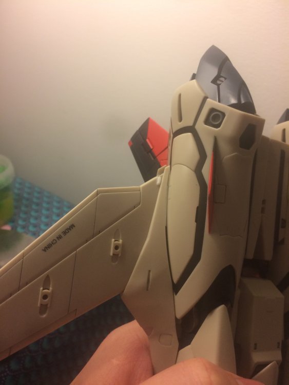

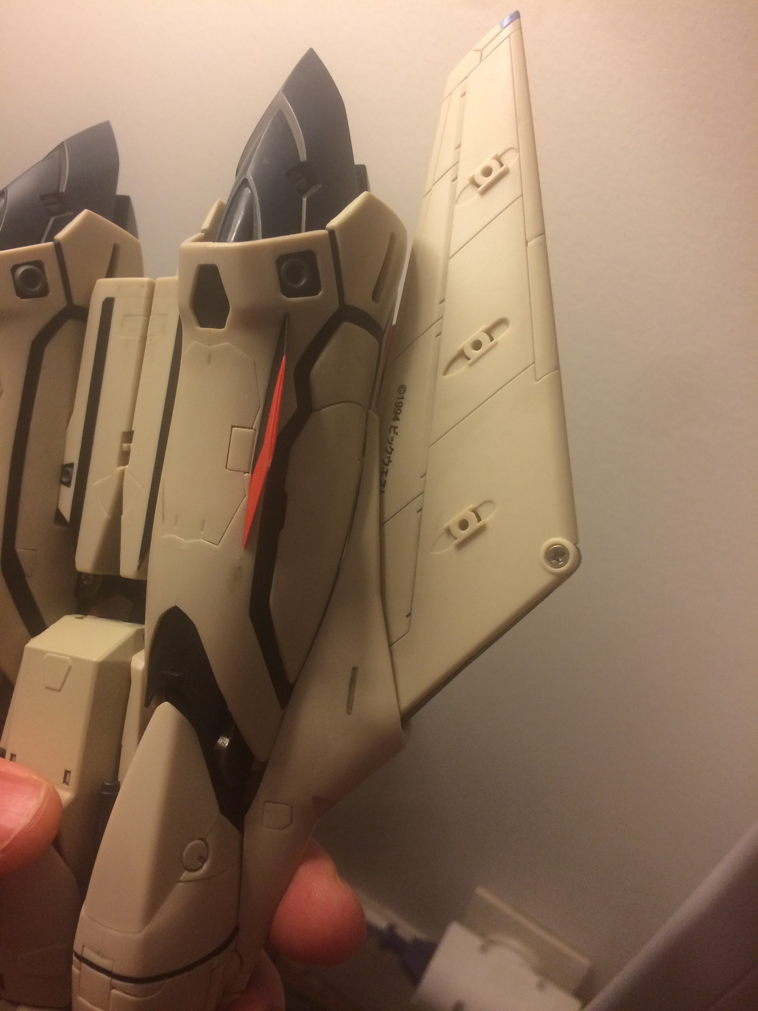

vlenhoff Posted January 12, 2017 Posted January 12, 2017 On 1/4/2017 at 0:45 AM, Scream Man said: Ok, so longer than 24 hours i have transformed it back and forth a couple of times,and i dunno what makes it stick, but i also didnt have a worry with it. I shifted the legs back and forth several times and no hint of damage. Thanks for the help Scream Man, I think this definitely means you got a good version of it. I totally can see my issue escaping QC control easily. Unless they transform all of them, i don't see how will they catch this issue. So sad, and this was my first Macross purchase in many years, lol. Anyway, it will be a while before i get to disassemble it. Arcadia! My Yamatos are intact and perfect in every way. crap happens, everyone makes mistakes. I'll forgive you this time Arcadia Quote
no3Ljm Posted January 12, 2017 Posted January 12, 2017 14 minutes ago, vlenhoff said: Thanks for the help Scream Man, I think this definitely means you got a good version of it. I totally can see my issue escaping QC control easily. Unless they transform all of them, i don't see how will they catch this issue. So sad, and this was my first Macross purchase in many years, lol. Anyway, it will be a while before i get to disassemble it. Arcadia! My Yamatos are intact and perfect in every way. crap happens, everyone makes mistakes. I'll forgive you this time Arcadia Wrong color. Loose joints. QC errors. Others. Yup, we always forgive Arcadia. Quote

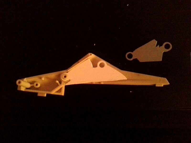

Chronocidal Posted January 15, 2017 Posted January 15, 2017 Got a pattern pretty much finalized for that simple wing mount. I made two copies by hand from ~1mm thickness styrene, sandwiched them in the wing, and mounted them in one wing glove, and they work great. No collisions with the legs or arms, and the wing rotates smoothly on it. I think my measurement (read: eyeballing it) was a little off, and the wing might have shifted inward a little, but this actually had a beneficial effect. With the wing mounted and swept forward, there was actually very little play in the wingsweep, and the wing would only tip backwards a small amount before colliding with the leg. I'm going to load up some CAD software and get a properly dimensioned file built up for sending out to get a few manufactured, but here's a scan of the final pattern. The original swingbars are a little under 2 mm thick, and this piece came out at 2.04 mm, so depending on the material, 2 mm thickness sounds like the way to go. Quote
David Hingtgen Posted January 15, 2017 Posted January 15, 2017 Does the wing split apart readily to install this? Quote
Chronocidal Posted January 15, 2017 Posted January 15, 2017 That's probably the most tricky and risky part, it'll depend on if they're glued well. There's about an inch and a half on the leading edge of both my wings that isn't glued down, and it was enough to spread them to remove the swing bars. Sadly, not much of a way to get around this. I've actually considered trying to pop mine apart entirely, since they look slightly misaligned where they were glued, and it seems to cause the tips to warp downwards some. I wound up remembering how some folks got cracked and broken wings at release, and decided not to risk pulling them all the way apart. I'm currently trying to figure out how to get a file exported to that Sculpteo laser cutting site, but their plugin for google sketchup isn't working. If anyone has the equipment to try making a copy of the part, I can upload a DXF/DWG/3DS/whatever here to give it a try. Quote

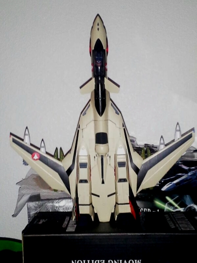

Slave IV Posted January 20, 2017 Posted January 20, 2017 (edited) Finally got this guy after eying it and hearing/seeing/reading so much about it: It's pretty finicky in Fighter mode, ugly in Gerwalk mode but Robot mode is beautiful and super solid (other than the leg Fast Packs). Really nice figure that will be spending most of its time in Bot mode and probably donating the arsenal that came with it to some other, less armed Valks. Edited January 20, 2017 by Slave IV Quote
Chronocidal Posted January 20, 2017 Posted January 20, 2017 I personally prefer fighter mode for pretty much everything, but this one really does shine in battroid. I do wish they'd opted to make the lower legs slightly longer to lessen the gap around the knee joint, but it's part of what makes battroid so stocky and close to the lineart. I think fighter mode was done a bit better by the Bandai VF-19 Advanced, but it still made a few compromises for certain details, and while a bit more sturdy, their version of the high speed mode mechanism has the same sloppy alignment issues as this one. One thing I didn't think about earlier, the diagrams for sticker placement in the instructions are straight-up CAD renders. I might scan those in and see about designing an entirely new wing mechanism. Quote
aaajin Posted January 21, 2017 Posted January 21, 2017 10 hours ago, Slave IV said: Finally got this guy after eying it and hearing/seeing/reading so much about it: It's pretty finicky in Fighter mode, ugly in Gerwalk mode but Robot mode is beautiful and super solid (other than the leg Fast Packs). Really nice figure that will be spending most of its time in Bot mode and probably donating the arsenal that came with it to some other, less armed Valks. Transformation's a breeze, plus battroid & fighter look perfect, well at least compared to the old Yamato. Bought mine before Bandai's Advanced came out, so at that time it was the best representative of the 19 in toy form. Gerwalk is definitely better than Yamato's. IIRC the old version does not lock together well & was a floppy mess especially in the chest area. Well, any fond memories handling Yamato's 19 probably have been erased from my memories anyways. Quote
no3Ljm Posted January 23, 2017 Posted January 23, 2017 On 1/20/2017 at 10:23 AM, Slave IV said: Finally got this guy after eying it and hearing/seeing/reading so much about it: It's pretty finicky in Fighter mode, ugly in Gerwalk mode but Robot mode is beautiful and super solid (other than the leg Fast Packs). Really nice figure that will be spending most of its time in Bot mode and probably donating the arsenal that came with it to some other, less armed Valks. I just remembered that for whatever reason, the shoulder pivot joint uses a different shade of tan. Have to go back and check if those are diecast metal rather than plastic since it's not the same shade as the shoulder armor. Quote
