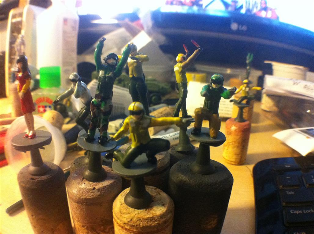

EXO Posted June 13, 2013 Posted June 13, 2013 My favorite and it's easy to get: http://www.krylon.com/products/indooroutdoor-primer/ I build 1/200 and 1/350th scale models and none of the TINY details are lost. This stuff is easy to get, lays down smooth, and the special nozzle (note the picture on the can) puts out a fine mist and can be slightly adjusted too. - MT It's all about Duplicolor biatch! West SAAIIIYDE!!! Here' some figures I started off with duplicolor sandable primer. These are resin figures about the size of WH figs maybe smaller. Quote
