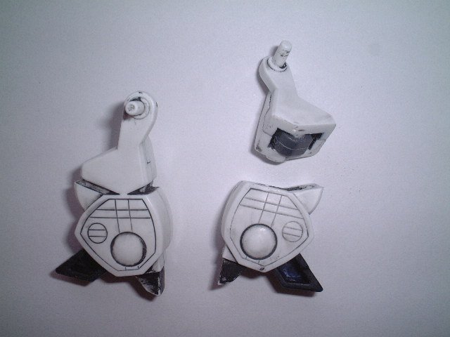

dyowelb Posted December 15, 2003 Author Posted December 15, 2003 (edited) yeah..i think i have no choice but to remove the polycap and make the legs static. as for the styrene solution i don't have enought room. i guess i'll have to build a 'knee' out of styrene... here's the pix of the legs to give you more idea Edited December 15, 2003 by dyowelb Quote

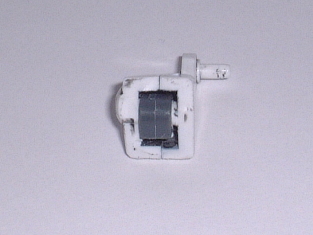

dyowelb Posted December 15, 2003 Author Posted December 15, 2003 and here's the close up pix of the thigh w/ polycap Quote

tetsujin Posted December 17, 2003 Posted December 17, 2003 A Hasegawa Battroid head is about 2cm long, about as tall, and maybe around 12-14mm wide. I don't quite understand how you're going to get mobility from this joint. It seems like, hinged or not, there'll be no place for it to move. But here's what you need to know to mount a polycap: First off, you can not glue polycaps to anything. They're too flexible. If you super glue them to something, and then they flex a bit, the super glue will pop right off. What you need to do is encase them such that they can't go anywhere. There are two simple and effective ways of doing this: the first is to mount the polycap using Bondo (a polyester putty used for auto body work - it's cheap and very useful). Bondo is great for all kinds of custom-fitting work, too. The second is to mix up super glue with talcum powder to make a putty. This super glue/talc mixture (SGT) bonds as well as super glue but is more resilient and workable - it won't hold a bond to a polycap, either, but it will create a solid, durable grip around it. I'm still trying to figure out just what you're trying to do. It looks like what you've got is a polycap that's already installed in the top part of the leg, and you want to hook it up to the lower part of the leg. Really, the best way to do that is to mount a peg in the lower leg and have it go through the polycap. I don't know if that's possible with the way you've got it set up, though. Probably the simplest solution is an off-the-shelf type of thing. Somebody suggested Wave L-Joint: I think thos would be too large for this application. Wave T-Shaft or Kotobukiya Mecha Joint might be a better choice: http://www.hlj.com/scripts/hljpage.cgi?WAVOP-291 http://www.hlj.com/scripts/hljpage.cgi?KBYD-109G The Wave part is also available domestically from Gundamshop.com if you're in the US. Both are basically the same thing, though the Kotobukiya one is a bit larger and stronger: the middle is a box with two hinge joints, and there's a long peg coming out from each end. Bury the pegs in Bondo and it's installed. You might also want to check out Peter Savin's work on his Hi-Zack. He does a lot with Bondo - most of the stuff he shows is cosmetic stuff but there's some real nice work with aftermarket polycaps, too. He really knows his stuff. http://models4you.whoadude.com/ He seems to be a big fan of the Kotobukiya T Joint: http://www.hlj.com/scripts/hljpage.cgi?KBYD-103B It's a nice general-purpose joint which could be very useful for the installation you're doing (where the top part of the leg appears to have some kind of horizontal peg going through the polycap, and the bottom of the leg has nothing) - you could trim a T joint to the right length and mount it in the upper leg as-is, and then you'd have a long peg extending down from that joint which you could then Bondo into the lower leg. If the peg in the upper leg is the right size, that is. (Check the measurements. Kotobukiya's site, linked from the HLJ pages, has great technical drawings of their parts with measurements.) For this particular installation it could be the easiest way to go, if the fit is right. In general the T joints are a bit more work to use than things like the Mecha Joint, but they're incredibly versatile. Quote
dyowelb Posted December 17, 2003 Author Posted December 17, 2003 tetsujin, thanks for the infos... I don't quite understand how you're going to get mobility from this joint. It seems like, hinged or not, there'll be no place for it to move. i'm trying to improve the kit and get rid of the stiff looking robot. if everything fails i will mod it to be in static position and reposition everything that i can. I'm still trying to figure out just what you're trying to do. It looks like what you've got is a polycap that's already installed in the top part of the leg, and you want to hook it up to the lower part of the leg. the pieces are not yet glued together so i can still removed the polycap. i'm in the process on test fitting everything and trying to find ways to approach this problem. can anyone post a bigger pix of these L and T joints?? thansk, dyowelb Quote
