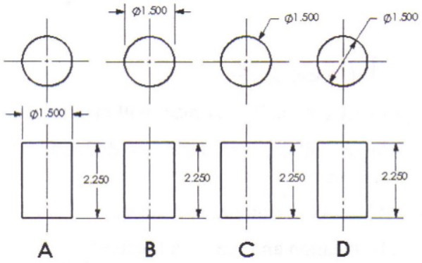

GU-11 Posted June 6, 2013 Posted June 6, 2013 Okay, super stupid question, and I admit I totally flunked my math and geometry tests back at school...does the 5mm measurement for TF weapons refer to the diameter of the cylindrical peg, or the width of it when measured across? More importantly, how do I render a peg that's accurate to the measurements in Sketchup? If I knew I was going to need geometry skills in 3d printing, I'd have paid more attention during math classes.
mechaninac Posted June 6, 2013 Posted June 6, 2013 (edited) A cylinder has two measurements: diameter or radius (D = 2*R) and height/length. If you're not referring to how tall or long the cylinder is, then you're talking about the diameter/radius. In drafting, when you dimension a cylinder's top/plan view (all you see is a circle) you represent it with a standard diameter dimension: single arrow pointing to the center of the circle and a leader line with the measurement number having a Ø before it for diameter or a R for radius, double arrows pointing outwards from the center with the number (with a preceding Ø) between the arrows or outside the circle with a leader line; when dimensioning from a front/side (elevation) view, you show dimension lines on what looks like a rectangle measuring from parallel lines to denote height and diameter (see images bellow). Therefore, if I understood your question, the diameter and the width are the same thing. As for Sketchup... no idea. Edited June 6, 2013 by mechaninac
GU-11 Posted June 6, 2013 Posted June 6, 2013 Many thanks for the explanation, Mechaninac! I guess the 5mm measurement does indeed refer to the width of the cylinder. I dug up FOC Jazz's weapon and measured the peg, and it's almost exactly 5mm. If it were the circumference, it would have been more than 5mm. Stupid of me not to have thought of that in the first place. Downloaded that diagram, too; I'm sure it'll come in handy in the future.

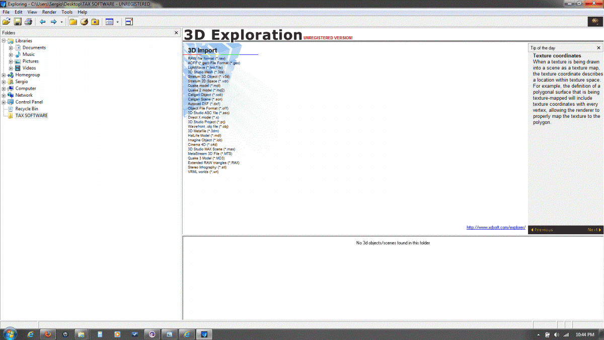

mechaninac Posted June 7, 2013 Posted June 7, 2013 (edited) There is also a little program, from the defunct X Dimension Software, called 3D Exploration 1.11 BETA that can import and convert from-to many different mesh file formats, including MD3, and it exports to STL directly. This little gem from 1999 works great and will save the frustration of going through Blender; it must be noted that depending on the source file, some triangles may end up being omitted or get their normals flipped, but nothing that can't be easily healed in the prep software. Edit: For anyone who may be interested, the installation file is called 3DEXPLOR.EXE, and it's only 1196 KB... the whole installed application is only 2.03 KB and runs flawlessly in Win7 64 bit. If the mods permit it, and only if the mods permit it, I can upload it here. Edited June 7, 2013 by mechaninac
GU-11 Posted June 7, 2013 Posted June 7, 2013 (edited) The workable solutions I came up with are: flat surface: 1. make circle in the location and the diameter of the hole you want. 2. pushpull the circle through the surface until the far end is flush with the far surface. 3. erase the plane inside the circle. curved surface (or all the way through complex, multifaceted object): 1. put rod through curved surface in the location and in the diameter of the hole you want. 2. merge (or whatever the term is) - in effect, the overlapping parts disappear. So any parts of the surface that are penetrated by the rod are removed, and a new series of facets and surfaces are formed around the rod. 3. delete rod Remember to pay attention (or better yet, directly input) the diameter of the hole in the measurement indicator in the lower right corner. I can't thank you enough for the help! Stupid-question time: After reading the steps, does this mean I won't need any Boolean tools for this? Also, I don't recall any merge or equivalent options in Sketchup. IIRC, it automatically "fuses" two components or groups together when you intersect them. I'll try and simply intersect the rod and head, and then delete the rod to see if it does make a hole. One more thing: for a ball socket, is it necessary for the hole to be bowl-shaped, like what you see on the ball sockets of certain TF and Gunpla heads? So, I had to facepalm a bit when I thought of this. That old MD3 format is a really popular format for polygon models, because it's so simple. I went to look up whether you can import them into Blender. Lo and behold, I do a google search, and yep. People have written import scripts for Blender that read MD3s. So, problem solved. There's a direct route from Gmax to Blender, if you want to use it. While it'll take some work to learn, the library of online tutorials for using it is absolutely massive, especially in the aircraft realm, where it was the go-to program for the MS Flight Sim series. That's good to know! I just downloaded Gmax, and I'll be tinkering around with it when I can find some time. There is also a little program, from the defunct X Dimension Software, called 3D Exploration 1.11 BETA that can import and convert from-to many different mesh file formats, including MD3, and it exports to STL directly. This little gem from 1999 works great and will save the frustration of going through Blender; it must be noted that depending on the source file, some triangles may end up being omitted or get their normals flipped, but nothing that can't be easily healed in the prep software. Edit: For anyone who may be interested, the installation file is called 3DEXPLOR.EXE, and it's only 1196 KB... the whole installed application is only 2.03 KB and runs flawlessly in Win7 64 bit. If the mods permit it, and only if the mods permit it, I can upload it here. I found a file called UNKLAB 3D Explorer.exe. Is that the right one? Edited June 7, 2013 by GU-11
Chronocidal Posted June 7, 2013 Posted June 7, 2013 (edited) Hah, I used 3D Exploration for years. Actually, it was extremely useful for a particular reason.. See, when I started doing CAD, I downloaded an early demo of Rhino.. I think 2.0. Well, back then, the demo wasn't limited by days, or uses. It was limited by save operations. You could save 25 times before the demo expired. At first, I just would save the clipboard data from copy/paste operations with windows's clipboad viewer (Rhino being the only CAD program I know of that uses Ctrl+C/Ctrl+V). But one day, I found out that trying to render an image at 9 million by 9 million pixels will crash the program (no kidding). In the process of doing so, it activated an "Emergency Save" feature... which didn't use the limited save operations. Coupled with 3D Exploration's ability to import Rhino models, I went on to happily develop dozens of mods for various games, all without using up that Rhino demo. If I ever find that demo, I could send it along to experiment with, but I'm not sure I still have the file. Edited June 7, 2013 by Chronocidal
sketchley Posted June 7, 2013 Posted June 7, 2013 Stupid-question time: After reading the steps, does this mean I won't need any Boolean tools for this? Also, I don't recall any merge or equivalent options in Sketchup. IIRC, it automatically "fuses" two components or groups together when you intersect them. I'll try and simply intersect the rod and head, and then delete the rod to see if it does make a hole.I'm not sure if Sketchup uses Boolean tools (it may be by another name). "Intersect" is the name of the function (one can tell that it's been a while since I've used Sketchup, eh?). http://support.google.com/sketchup/bin/answer.py?hl=en&answer=94856 One more thing: for a ball socket, is it necessary for the hole to be bowl-shaped, like what you see on the ball sockets of certain TF and Gunpla heads?I don't think it matters what the interior of the socket looks like. All it needs is a smaller hole than the ball that goes in the socket (so it doesn't pop out easily), and a couple of points of contact inside the socket. Like the old-style ball-using computer mice. I've built some Gunpla kits (or similar) where the back side of the head ball socket was a flat piece...
mechaninac Posted June 7, 2013 Posted June 7, 2013 (edited) .... I found a file called UNKLAB 3D Explorer.exe. Is that the right one? Doesn't seem like it. Does it look like the image below when you install it? Edit: If you'd like, send me a PM with your email address and I'll send you the install exe. Edited June 7, 2013 by mechaninac
