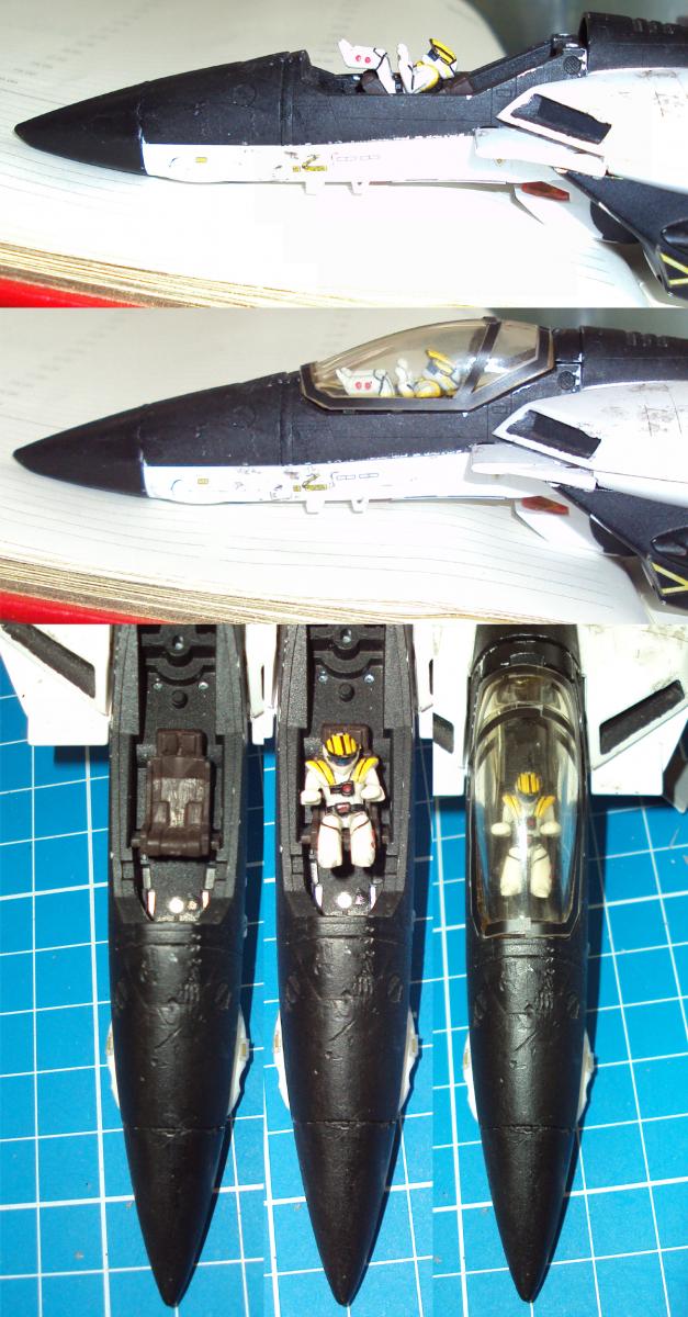

kyekye Posted June 26, 2013 Author Posted June 26, 2013 Another slow week thanks to some family events.. Original plan was to use 'Hobby Base' Hands, but I realized that VF-1s have 2 joint fingers... So I tried to make 2 Joint fingers version... FAILED!! Just too small for hand-made parts. It worked, but didn't look nice. So.. I gave up and went back to 'Hobby Base' Hands. I'll just paint the middle joint black and pretend it's 2 jointed.. Also, extended the lower arm parts for better proportion in Battroid mode. Quick Assembly test of lower arm (WIP) and comparison shot with the original (with broken shoulder hinge..) Made 1 more shoulder hinge set to repair other one (pictured above...) And made a quick and dirty coating test subject with old Hasegawa parts and tried Duracoat. This is 2 layer thin coat, and it looks like it will hold up pretty well. Went through Scratch test, Parts friction test..etc. All seems pretty good. Even decals were holding up well under the coat. I still would not use this over large decal area. Only thing didn't pass was bend test. After all, it's a thin layer of clear resin. It didn't fall apart, but I heard some cracking noise. I think it's much much better than Acrylic coat (such as Mr. Hobby or Tamiya coat) I will do more testing as I go. Quote

Vi-RS Posted June 26, 2013 Posted June 26, 2013 Do you plan to make the rotating seat for Battroid mode? Quote
Valkyrie addict Posted June 26, 2013 Posted June 26, 2013 (edited) WOW! the chubby forearm looks great now but how will you solve the clearing of it for fighter mode? the gunpod will hang very low. Too bad the hands didn't work, brilliant what you did. Are those 1/100 hobby base hands? From previews experience, the parts that will get the most friction during transformation that chip clear coat or paint are, the outer shoulders, medial forearms (they rub when you tuck them into fighter mode), the inner shoulders with the outer shoulder, the forward swivel point between the intake and thigh for gerwalk, the inner canopy shields rubs with the canopy, and elbow with the forearm clearance. Edited June 26, 2013 by Valkyrie addict Quote
kyekye Posted June 26, 2013 Author Posted June 26, 2013 I really like the way you recasted the arms, it looks more like "Macross-of-my-childhood", I just hope that their being bigger won't interfere with transformation especially in fighter mode when the gun is locked between them and the landing gears are outside. The overall is heading to a masterpiece that one could stare at for hours, inspecting every detail I checked the clearance before making the modification, so it's safe I'm also gonna add magnets for Gun-pod attachment - both on Arms and Hands so that I can just attach/detach it in Fighter mode. i'm still on on the "holy crap! metal parts!?" thing. Are those laser sintered or are they shapeways 3d printed? Laser!!?? 3D printed!!!??? What age are you living in!!! Such nonsense!!! They are all hand-cut/screwed!! Seriously, I'm planning to get a Formlabs 3D printer soon (after my moving). Things will be very different once I get it. Amazing...you are creating a truly masterpiece!!! Amazing...you are creating a truly masterpiece!!! Thank you. Trying my best. Do you plan to make the rotating seat for Battroid mode? . ...you are joking..right..? That cockpit then needs whole different control HUD!!! WOW! the chubby forearm looks great now but how will you solve the clearing of it for fighter mode? the gunpod will hang very low. Too bad the hands didn't work, brilliant what you did. Are those 1/100 hobby base hands? From previews experience, the parts that will get the most friction during transformation that chip clear coat or paint are, the outer shoulders, medial forearms (they rub when you tuck them into fighter mode), the inner shoulders with the outer shoulder, the forward swivel point between the intake and thigh for gerwalk, the inner canopy shields rubs with the canopy, and elbow with the forearm clearance. Clearance is good for landing gear/gun-pod. No worries. Yeah. I spent half day working on the 2 joint fingers.. Now I have 1/6 Freddy krueger Hands Yup. That's a modified 1/100 hobby base (hard-edge version) Thanks for the tip. I saw a couple of different thread about it as well. I'll be extra careful with those areas. I'll apply extra layers resin coating, or sand it down to lessen the friction, or use metal sheets. It seems like clear resin coating will do the job for the most parts. Quote

valhary Posted June 26, 2013 Posted June 26, 2013 I achieved put the seat vertical in the 1/60 but without articulation removing parts Quote

kyekye Posted June 29, 2013 Author Posted June 29, 2013 speechless! Thanks! Te lo escribo en castellano por que es alucinante!!!! simplemente asombroso, a mi no me daria la vida para hacer algo asi te envidio. I'll write in spanish that is amazing!! simply amazing, I would give my life to do something so I envy you. Thank you for nice comments! Guys, we're losing him! Oh not just yet! I achieved put the seat vertical in the 1/60 but without articulation removing parts I see... removing parts....That's not 'perfect' transformation then!! It's nice idea, but you won't see it when it's covered by heat-shield.. For the cockpit area, only thing left for me is adding some PE parts and finishing the canopy. Oh, By the way.. no update this weekend. I'll be on a family trip.. Quote
