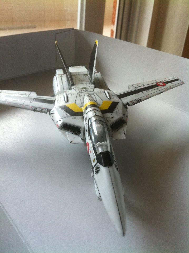

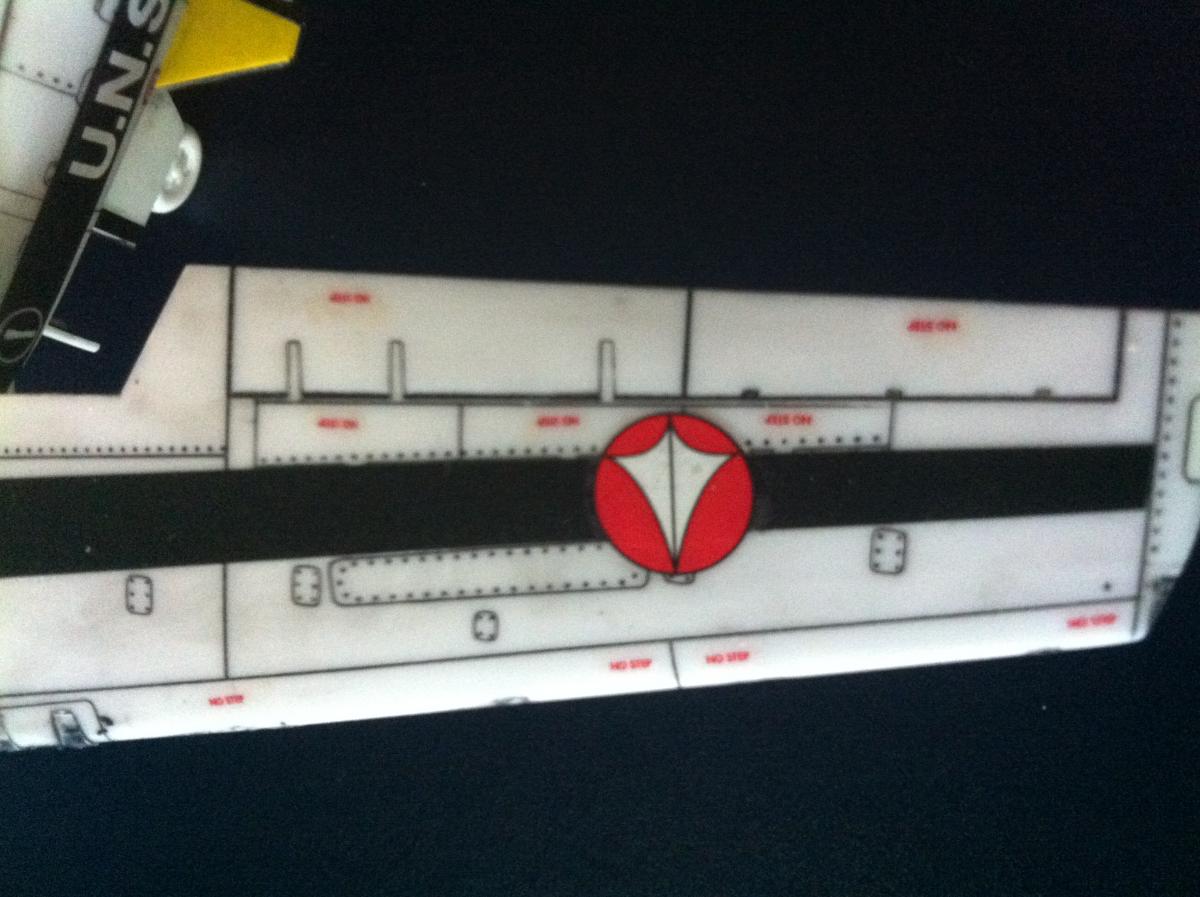

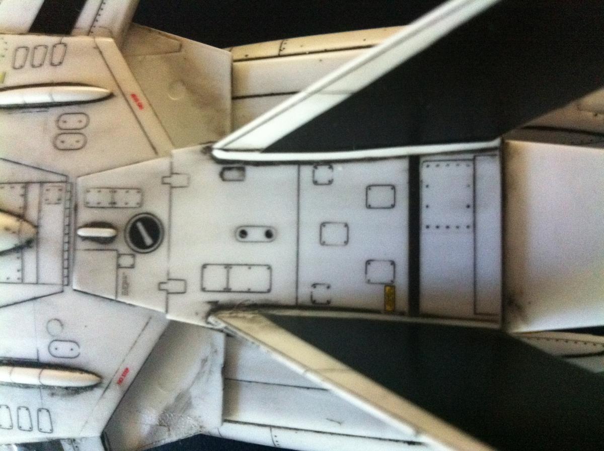

MinoRem Posted June 6, 2013 Posted June 6, 2013 (edited) Here is the end result, some part looks smudgey and I think the wing is best done. Some body lining are a bit faded but over all I'm okay with the result as a first run with enamel + thinner. Found it easy to just brush everything with the enamel, bit of thinner to wash over initially (since you can't clean it all at once with the one tissue) then clean again. Hope that makes sense. Just added two pic to show the details of my work, the body isn't as well done as the wings. Edited June 7, 2013 by MinoRem Quote
Jefuemon Posted June 8, 2013 Posted June 8, 2013 OK, I think you've got the panel line washing down pretty well for a beginning effort. Now, let's talk about puttying, and seam-line filling. Quote
MinoRem Posted June 8, 2013 Posted June 8, 2013 OK, I think you've got the panel line washing down pretty well for a beginning effort. Now, let's talk about puttying, and seam-line filling. That's to remove the line that joins the pieces together? I kinda got lazy with doing it on the canopy (is that what they're called? The clear screen where the pilot sits) Quote
Jefuemon Posted June 8, 2013 Posted June 8, 2013 That's to remove the line that joins the pieces together? I kinda got lazy with doing it on the canopy (is that what they're called? The clear screen where the pilot sits) Yes, that's where you remove the gap/unevenness between where 2 parts fit together. It's a very good skill to learn and use. Basically, what you need is some modeling putty (I recommend Tamiya Basic Grey), some type of putty knife (I use something like #15131), and some 300 grit sandpaper. Run a line of putty down the seam, smooth and shape it (and remove excess) with the putty knife, sand it smooth once it's dried, usually 24 hours. You should see a big improvement in your builds once you get the technique down. Quote
Noyhauser Posted June 8, 2013 Posted June 8, 2013 Yes, that's where you remove the gap/unevenness between where 2 parts fit together. It's a very good skill to learn and use. Basically, what you need is some modeling putty (I recommend Tamiya Basic Grey), some type of putty knife (I use something like #15131), and some 300 grit sandpaper. Run a line of putty down the seam, smooth and shape it (and remove excess) with the putty knife, sand it smooth once it's dried, usually 24 hours. You should see a big improvement in your builds once you get the technique down. He's talking about the canopy... I don't think you want to use tamiya putty on that The way I do it is this; I get two grits of sandpaper, 600 and maybe something above 1200. I sand it down so its flat with the 600 and then sand it really fine down to nothing with the 1200. Now I get some polishing agent.... tamiya makes one but you can use any one... I've seen people use toothpaste before. and really really get it smooth. It should have a milky or distorted texture once you're done and washed the part thoroughly (this is important). Next, get future and dip the canopy (or just pour it over like I do and let it set. You should have a clear canopy as a result. In general you should always dip canopies in future: it protects the plastic and gives off a really nice sheen that makes the canopy look realistic. Hope that helps. Quote
Jefuemon Posted June 9, 2013 Posted June 9, 2013 He's talking about the canopy... I don't think you want to use tamiya putty on that Yes, clear parts are a whole different animal. Don't use putty on them! Quote
MinoRem Posted June 9, 2013 Posted June 9, 2013 AH thanks for the tips, maybe for the new model coming this month I'll try making it even better. Quote

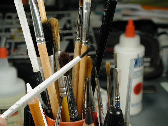

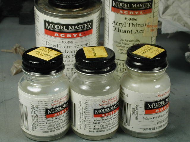

moss Posted November 26, 2013 Posted November 26, 2013 I´ve found one old backup with some photos that may belong to master wm cheng (the backup contains images of some of his macross models posted in the forum) I think that the reason of the photos is some sort of tips for modellers. Would be nice to add the missing text to them. Here they are: Regards Quote
David Hingtgen Posted November 26, 2013 Posted November 26, 2013 I believe the first pic is his fave clear-coats. Testors Model Master acrylic gloss, semi-gloss, and flat. Quote
derex3592 Posted November 26, 2013 Posted November 26, 2013 That's what I've started using. Airbrushing those is super easy and gives me good results. Quote
Noyhauser Posted November 27, 2013 Posted November 27, 2013 Have you tried the new alclad range Derex? I moved over to them about a year ago after basically going through about 7 different brands, and found they were the best. Quote
