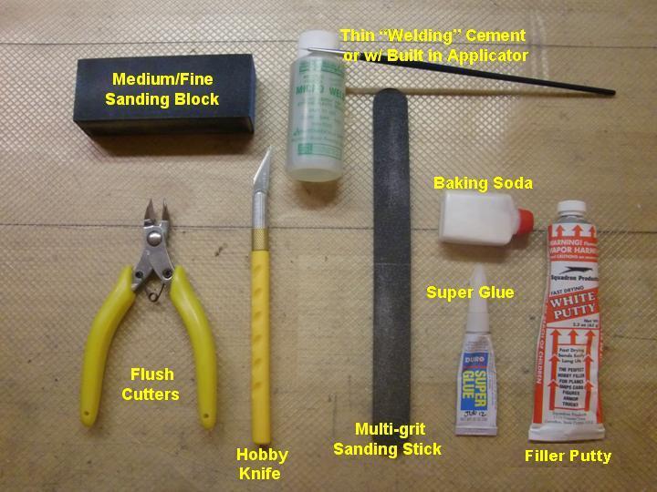

The BASIC Shopping List
This is the “budget” version of the list and should cost around $25 (USD) on average.
1)Flush Cutters – These are not diagonal wire cutters, but have a completely flat side on one end of the blades to cut the sprue flat - “flush” with the side of the part. You can get these at hobby shops or electronics suppliers. Don’t cut metal with them after purchase. It will put a gap in the blades affecting your clean cut.
2)Hobby Knife – This has a ton of uses, but for now, will be used to clean spare sprue off of the part you just cut off or remove molding flash. Don’t cut too close, use the sanding stick to go to the face of the part.
3)Multi-grit Sanding Stick – This will clean up and smooth over whatever is left on the part. It will also be used to clean up the seam of your assemblies. NOTE: small “Swiss” files can be used too, but will leave undesired gouges if you’re not used to using them on styrene.
4)Thin “Welding” Cement – This cement literally melts or welds the soft styrene together! Some have filler agents, but generally, the melting action is what makes the parts stick. This is the strongest bond for styrene next to molding a whole piece - when done right. This can be used two ways. The first is to clamp, tape or rubber band your parts together. Then use a brush/applicator to flow the cement into the seams. Capillary action draws the cement in. The second way is to wet both halves of the parts in coats, let it set a few seconds and repeat as needed to cement together. Use this for rough seams. The excess glue will mix with the styrene and form a putty of sorts and fill the seam – allow a couple of days for this to dry. Bad seams will need putty or super glue and baking soda. When taping or using rubber bands remember the cement will get in under these and mar the plastic finish. Use cardboard or other materials to space these clamping devices away from the styrene and watch where the glue flows – it’s thinner than water! Your fingers can become applicators too and get glue where you don’t want it – watch where you put those fingers!
5)Super Glue – Super glue sets faster, can fill seams when cured and is also the main glue of choice for gluing resin kits together. Cured super glue is stronger and tougher than the styrene, remember this when sanding or filling gaps as listed below. Think how you will attack your problem before making it worse.
6)Baking Soda – Not mandatory, but will accelerate super glue’s curing time and can be “piled on” to fill-in nasty seams or bad goof ups in assembly with super glue coats in between layers.
7)Filler Putty – This is the other way to fill bad seams in or cover up goofs you gouged into your kit. Let it dry thoroughly and ensure the area is clean of oils that will inhibit adhesion.
8)Sanding Block – When your parts are together, the sanding stick has sanded the seam over, use this to bring a near glossy finish back to the plastic. Rubbing an old clean and SOFT rag can buff it to gloss.
Making It “Seam Easy”
The most frustrating part of model assembly is when you glue two pieces together and you can see the seam. The seam of the parts can simply need mild sanding and it’s gone. In other cases though, the parts will have a bad gap. Here’s some pointers to help out.
1)Test fit the parts together; yeah, the instructions say it for a reason. Parts that don’t fit right may only need a little rough sanding and they’re good to go. A lot of earlier models have machine marks in the mold making the seam potted and not smooth. Sometime the fit pins don’t line up and have to be removed. A sanded seam also has better adhesion.
2)If there’s a small gap, the method above under “Welding Cement” will help. A few applied/semi-dried layers of weld cement will fill it in as the cement becomes like putty. Allow at least two days for seams like this to dry though. Maybe more if there’s a lot of it on the kit.
3)If your scale model has a mini Grand Canyon in it, super glue, super glue and filler (like baking soda) or filler putty can fill it in. If strength is an issue, super glue on its own is the way to go and will give the best strength. It also dries clear after sanding.

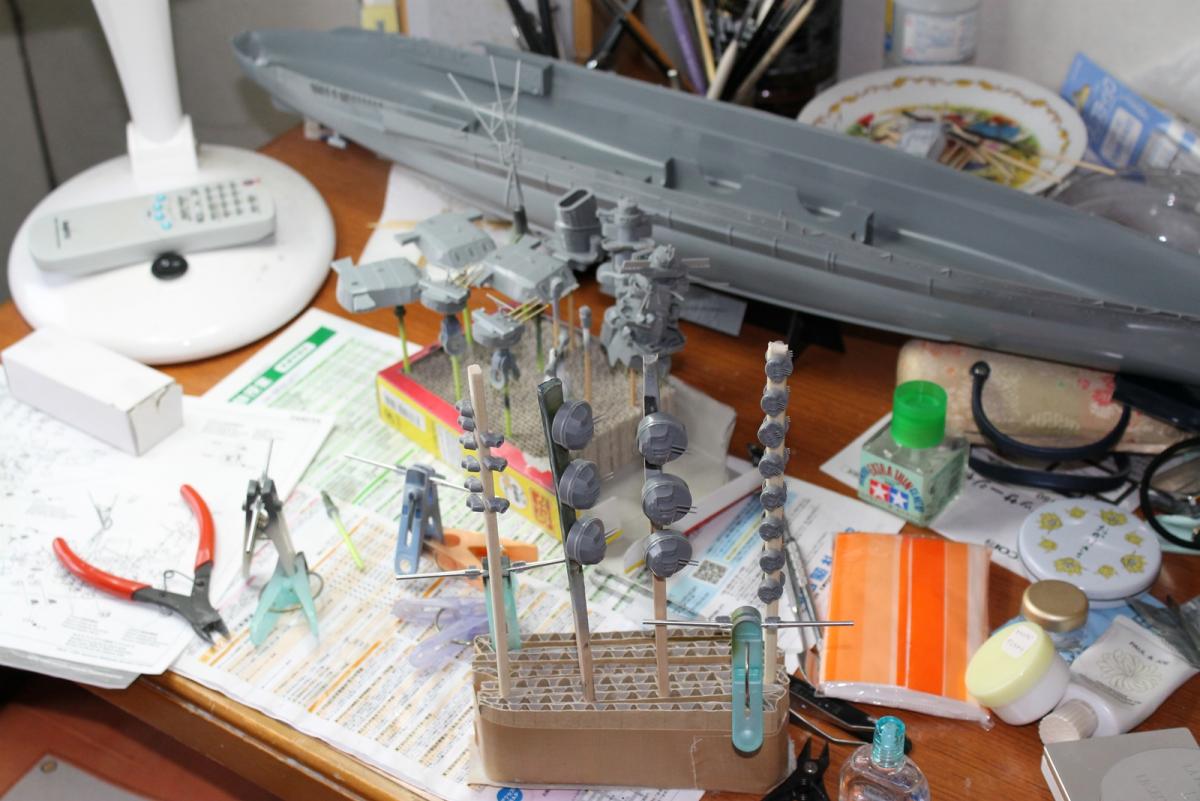

Painting tip- If you've got access to those disposable bamboo chopsticks, slap a piece of double-sided tape at the thick end, and you've got yourself a neat way to hold small parts while you're painting.
also, as you can see in the pictures, if you take a cardboard box, cut it into strips, then tape the strips together, you get a place to put your stick while it dries.
