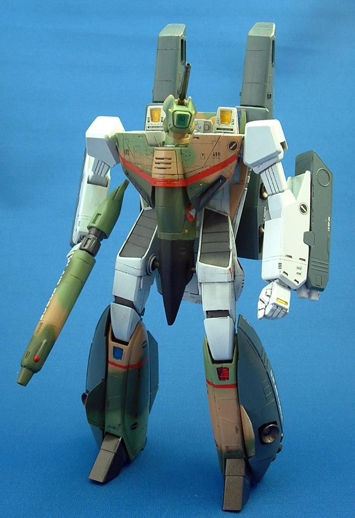

Jefuemon Posted March 13, 2013 Posted March 13, 2013 I've always wanted to build some fighter jets and attack helicopters, but the builds look very complex, especially when painting cammo patterns. Not sure if I'm up to the task just yet. Cammo patterns aren't all that tricky, as long as you're not trying to do digital cammo. They're kind of fun to do, too! Start with your lightest color, then lay down the darker colors on top of that. examples done with my Tamiya set-up. Quote
GU-11 Posted March 13, 2013 Author Posted March 13, 2013 Those look awesome! Did you do any masking? I've seen some people use blu-tack to mask the parts, creating more "faded" edges. Quote

Jefuemon Posted March 14, 2013 Posted March 14, 2013 Those look awesome! Did you do any masking? I've seen some people use blu-tack to mask the parts, creating more "faded" edges. Nope, I did no masking on the cammo work. Actually, masking gives you a clearly defined edge, which is what you really don't want (in my opinion) for a cammo pattern. Quote
GU-11 Posted March 15, 2013 Author Posted March 15, 2013 Nope, I did no masking on the cammo work. Actually, masking gives you a clearly defined edge, which is what you really don't want (in my opinion) for a cammo pattern. Very true. The only cammo patterns I've ever seen with distinct lines are the blue cammo patterns on the Sukhoi SU-35 Flankers. I should try testing out cammo patterns using my basic AB next. Not sure it it's precise enough for that, but there's only one way to find out, I guess. Quote
