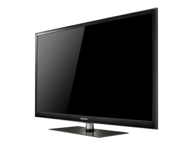

ErikElvis Posted March 6, 2013 Share Posted March 6, 2013 Extremely annoyed. Just bought this.. http://www.samsung.com/us/video/tvs/PN64E550D1FXZA I hung it to the wall and hooked everything up then decided to try to finish dead space 2. started playing and had this weird lag. I thought the area i was in was a space environment slowing me up. but kept going and never got better. I tried game mode. Anybody ever run into an issue like this? Quote Link to comment Share on other sites More sharing options...
Benson13 Posted March 6, 2013 Share Posted March 6, 2013 Never heard of that before. I'll see what I can dig up. Quote Link to comment Share on other sites More sharing options...
ErikElvis Posted March 6, 2013 Author Share Posted March 6, 2013 I was running through a panasonic receiver too. All HDMI. I tried to connect the xbox directly to the TV and did the same thing. Swapped wires around as well. I was disgusted last night. I might mess around with it today. Quote Link to comment Share on other sites More sharing options...
Hoptimus Posted March 6, 2013 Share Posted March 6, 2013 Turn game mode off. Any extra processing in the TV makes for weird lag. My friend has a Samsung 43" Plasma and it works great. Quote Link to comment Share on other sites More sharing options...
David Hingtgen Posted March 6, 2013 Share Posted March 6, 2013 True for all TV's---ANYTHING they attempt to tweak/fiddle/enhance will slow things down. You want the raw unfiltered signal going straight from the console to the screen. Motion interpolation, "smoothing"---all bad! If something can be turned off in the menu, do so. Turn off everything you can. You may have to set the TV to "movie" or "cinema" mode first to be able to turn some things off-----movie/cinema mode is usually the "purest" mode on a TV, with few "enhancements" active. Sadly, "game mode" is often among the worst possible things to do. Quote Link to comment Share on other sites More sharing options...
