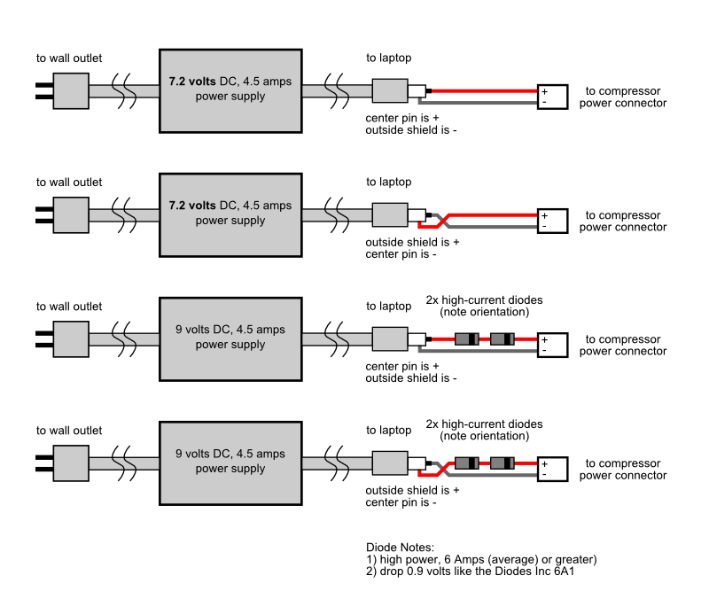

grapetang Posted March 6, 2013 Posted March 6, 2013 (edited) I like Kylwell's find the best. You could always get an expensive voltage converter. If you go the laptop power supply route: get one with at least 4A(amps) or 4.5A, preferrably higher. make sure it supports your country's power settings; just about all of them do. check the output polarity before you connect; the center pin is typically red/positive(+) but not always. mate the output to a plug like the one on the battery pack (get or scavenge) so you can disconnect; or find a connector that mates to the power supply. You can also cut the output plug off (UNPLUG first!!!) and solder directly to the wires. check & double-check the polarity!!! everything I said earlier still applies, including the disclaimers. If you were local, it would be straight-forward to measure the actual power requirements of the compressor. Ack. Good luck! Edited March 6, 2013 by grapetang
GU-11 Posted March 6, 2013 Author Posted March 6, 2013 Many thanks for the detailed explanation, Grapetang! Yeah, I've been looking everywhere for a power converter. I've been told these were sold in electronics stores, but so far I haven't seen one. I hope I won't have to buy one online--I'm not crazy about paying extra for shipping and stuff. I think I can directly plug an Acer laptop charger's connector straight into the compressor --it fit using my laptop's charger, at least, although the voltage is too high (9v)...and I still need it for my laptop. About the diodes, they look like components you'd solder to a electronic board. How do I use them on the connector? As much as I hate to admit it, I know next to nothing about electronics.
MechTech Posted March 6, 2013 Posted March 6, 2013 Grapetang's illustration is great! The diodes will help with the voltage and regualate the flow. Also keep in mind that a DC motor like that is not as sensitive to the voltage. You can go down a little, and up a little. If the motor is the same as in Tamiya's R/C cars, it should take another "cell" like the cars do. That would put it at 8.4VDC. Just watch the temperature (if you can access the motor). Hopefully you have a voltmeter to check the polarity like Grapetang mentioned. - MT
grapetang Posted March 6, 2013 Posted March 6, 2013 Thanks, MechTech! Does anyone actually have the AC adapter for this compressor that could provide the output specs (voltage, current, polarity) as printed on the side? Or is it printed on the side of the compressor? I overlooked the fact that the compressor has a power input jack separate from the battery connection. All the 7.2v stuff we've been guessing about applies to the BATTERY INPUT, not the power adapter input and they could be different. Re: diodes: yes, they are electronic components that you (or someone) would have to solder to wires (14 gauge or thicker). To connect to the power supply side, you would have to: get a mating input jack and solder to that, or UNPLUG first and try soldering directly onto the output plug, or UNPLUG first and cut off the output plug to expose the wires and solder directly to those. Sounds like it would be easier to find the correct adapter or a voltage converter and plug straight in. This one is close (7.5VDC, 4A) but pricey: http://www.ebay.com/itm/7-5V-4A-HIGH-POWER-AC-Adapter-For-Stontronics-SB-074A0F-11-Charger-Supply-Cord-/370743230592 These looks pretty good except the current rating is too low: http://www.ebay.com/itm/New-POTRANS-UP01811070-DC-7V-2-5A-AC-Power-Adapter-/110961150451 http://www.ebay.com/itm/VSK-0615-AC-Power-Adapter-for-Panasonic-DP44-7-2V-2A-/320734006457 Wow. Talk about frustrating. Can anyone help with the AC adapter specs?

grapetang Posted March 8, 2013 Posted March 8, 2013 (edited) @grapetang: About the adapter you mentioned, is it "ready to use," as in I can just plug it straight into the compressor? Only the [ power converter ] --> [ SWA-3 ] --> [ compressor power adapter input jack ] is "ready to use". The laptop power supplies need work to connect to the input jack (different plug, voltage? polarity) or to the battery connector, so the rechargeable batteries may be the way to go in the short term. Good luck! PS - found the compressor manual here: http://www.tamiya.com/japan/download/pdf/tools/74520.pdf Edited March 8, 2013 by grapetang
