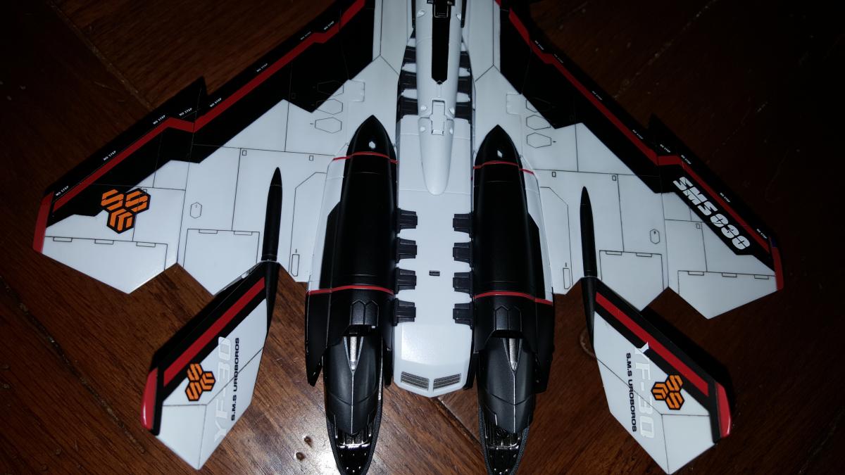

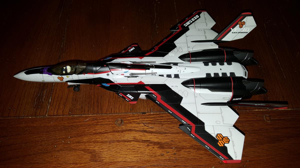

derex3592 Posted July 19, 2015 Posted July 19, 2015 Finally got around to panel lining my 30. Came out good. ProModellers Dark Dirt clay based wash was applied with a small paint brush and excess was wiped off with a barely moist finger/cloth. Quote

derex3592 Posted July 19, 2015 Posted July 19, 2015 looks great Derex! very nicely done! I wish I had the courage to do this to one of my Valks! sadly I don't.. im just too scared to try it! You really shouldn't be Spanner. It's super easy and 100% reversible if you're not happy. I recommend trying it on a Bandai 25 first as they are super glossy and that is the best place to start for a first try. I always start on the underside of one wing to see how the wash is going to flow over the surface. The glossier the easier. The older Yamato stuff is a little harder because of the matte finishes. Quote

derex3592 Posted July 19, 2015 Posted July 19, 2015 How easy is it to remove the color from the panel lines if you stuff it up or change your mind? Easy. The wash is clay based, even after its dry, get a toothbrush, a small cup of water, and remove from the panel lines. I use a Qtip to clean up any areas that look a little "dirty" from pure white areas after t get the lines crisp. Experiment around with it. It will stain matte pure white valks.....if you leave it on long enough. Which is cool if you're going for a weathered look. However, with the Bandai glossy stuff, you're safe from that. Quote
spanner Posted July 20, 2015 Posted July 20, 2015 Easy. The wash is clay based, even after its dry, get a toothbrush, a small cup of water, and remove from the panel lines. I use a Qtip to clean up any areas that look a little "dirty" from pure white areas after t get the lines crisp. Experiment around with it. It will stain matte pure white valks.....if you leave it on long enough. Which is cool if you're going for a weathered look. However, with the Bandai glossy stuff, you're safe from that. I'd definitely like to give it a go but maybe on something that won't matter if I stuff it up.. I do have a spare DYRL VF-1A Hikaru with damaged shoulders that I could use I guess.. Quote
