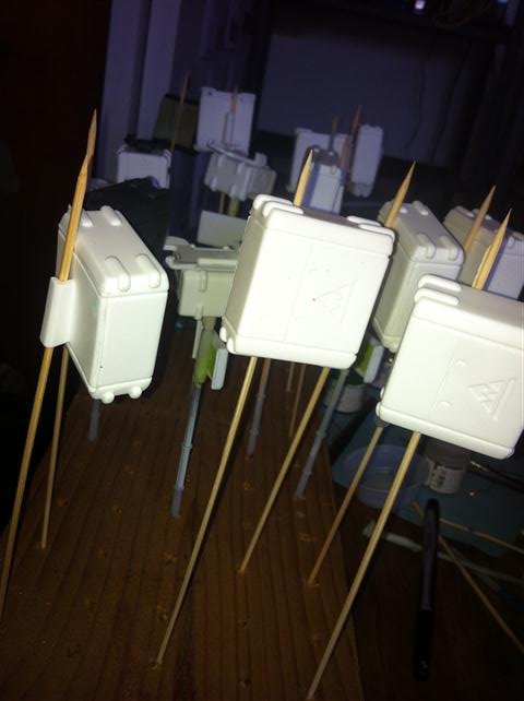

EXO Posted November 29, 2012 Posted November 29, 2012 Try buffing it with a lint free cloth. Put tape on the other colors if it's not the only color. Sounds like you're doing everything else right though. Also try mounting the piece on a stick or something and try to hit every surface as head on as you can. Here's what one of my set ups look like. It looks like a warning to all other saddle bags not to come near. what's the temperature in the room? if it's too cold you might want to heat up the paint a little. When I spray with a can I eat it up slowly with a blow dryer or put it in hot water. Air brush I just keep it next to a portable heater. And always wear a mask. I work where there's a whole room is a giant paint booth and I never go in there without a mask. Quote

GU-11 Posted November 30, 2012 Author Posted November 30, 2012 Many thanks on the pointers, EXO! LOL! That saddlebag setup is equal parts awesome and gruesome! I do something similar, except I stick the plastic parts with blutack onto chopsticks, and I use a cardboard egg carton. I'll have to either use something heavier than the egg carton or weigh it down, now that I'm using an airbrush. The air pressure is very concentrated and toppled the whole thing when I brought the nozzle near one of the scrap plastic parts. It was around 25-28 degrees Celcius that morning--not sure if that's considered cold. I know that you should heat spray cans in a bowl of hot water, but what about acrylic paint jars? Do you heat it up after thinning or before? I think I might not have mixed the paint up sufficiently. I gently stirred it until the alcohol and pigments mixed together, but apparently you have to stir it up really well, or the "binders" might remain separated from the paint, and not give a gloss finish. That's probably the only part I didn't do right. As for my mask, it's no good for filtering fumes, but I still wear it to keep paint dust and larger paint particles from getting in my lungs. Hopefully the fan will sufficiently suck in all the fumes. It sounds like you're getting there! - MT Yes, thanks to all the helpful advice from you guys! I'm still a ways from even being remotely efficient with my AB, but I'm starting to get used to how it works and behaves. My quest for modeling excellence has just begun. Quote
