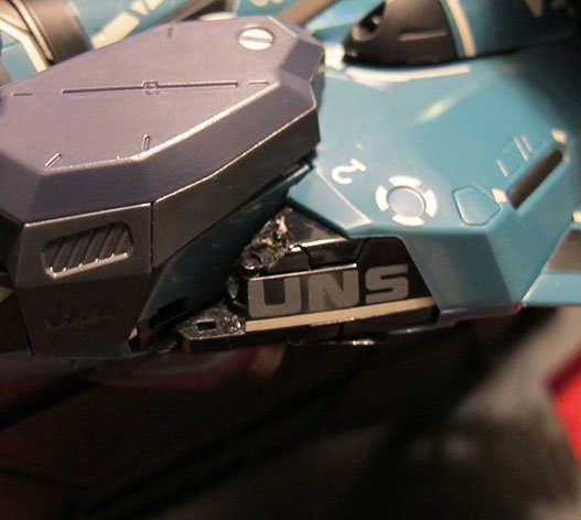

Rabidweezil Posted April 19, 2015 Posted April 19, 2015 While I was rearranging my display case I moved my VF-171 and a piece of one of the triangles just fell off of one side. And the other side is about to do the same thing. I have NEVER transformed this Valkyrie. So for those of you thinking that staying in fighter mode will help keep this from happening, it won't. Thanks Bandai. Quote
Mommar Posted April 19, 2015 Posted April 19, 2015 While I was rearranging my display case I moved my VF-171 and a piece of one of the triangles just fell off of one side. And the other side is about to do the same thing. I have NEVER transformed this Valkyrie. So for those of you thinking that staying in fighter mode will help keep this from happening, it won't. Thanks Bandai. 171.jpg My theory is that due to the angle of the arms/attachment in fighter mode it's actually the most likely to break/crumble if you keep it in fighter. Quote
Valk-1S Posted April 20, 2015 Posted April 20, 2015 While I was rearranging my display case I moved my VF-171 and a piece of one of the triangles just fell off of one side. And the other side is about to do the same thing. I have NEVER transformed this Valkyrie. So for those of you thinking that staying in fighter mode will help keep this from happening, it won't. Thanks Bandai. Yup, it will crack without doing anything. I had 7 of them, opened all 7 of them to check when new. Only one with crack NUNs and crack smaller triangle, and one with broken knee joint. Thought all good, left in box. Few months later decided to sell some of them, opened up the boxes and another 3 of them showed cracks on the NUNs and/or smaller triangle. It's just really bad plastic used by Bandai which crumbles easily. Quote
Chronocidal Posted April 20, 2015 Posted April 20, 2015 There definitely are some plastic issues going on with the 171s, but I also think they severely over-tightened the screws holding the shoulder triangles together. I've loosened all of mine as a precaution, and haven't had any of mine disintegrate so far. Quote

Chronocidal Posted April 20, 2015 Posted April 20, 2015 Not that I've seen, but it's just the single screw holding the triangles together. One of mine had that screw tightened so tight, it was visibly warping the lower half of the triangle by pinching it in the center. The damage on that one might be done in fact, but it's still holding for now. Quote
