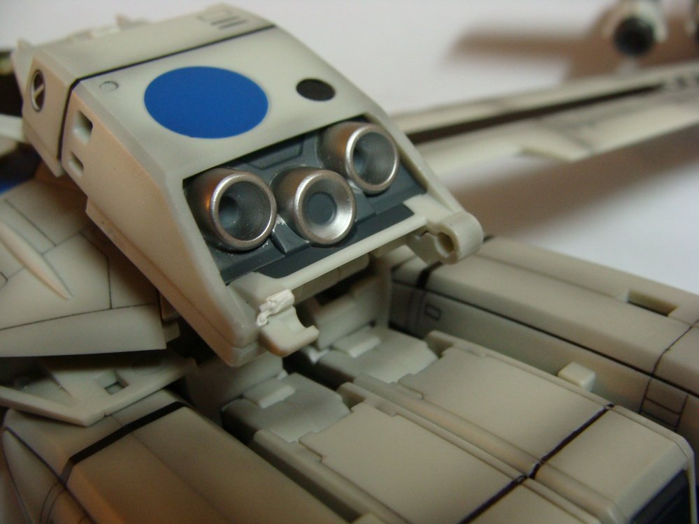

Vi-RS Posted August 18, 2012 Posted August 18, 2012 I've had that experience before, straight from the box but the flap was not even there. Luckily the seller manage to find me a back pack for replacement. This is the 2nd weak joint after the shoulders on V2. Make sure your back pack hinge is still there, mine was snapped off so the flap fell some where. Quote

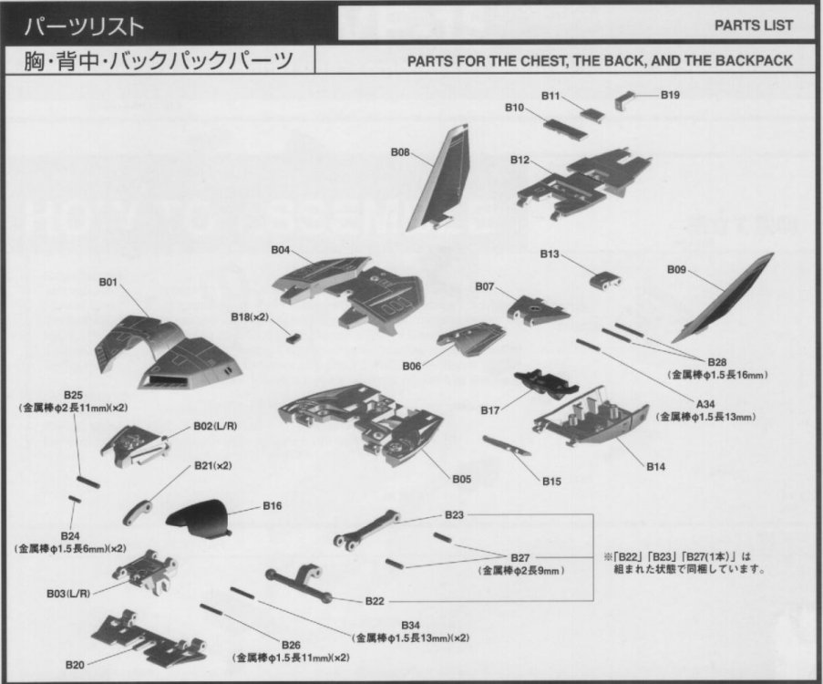

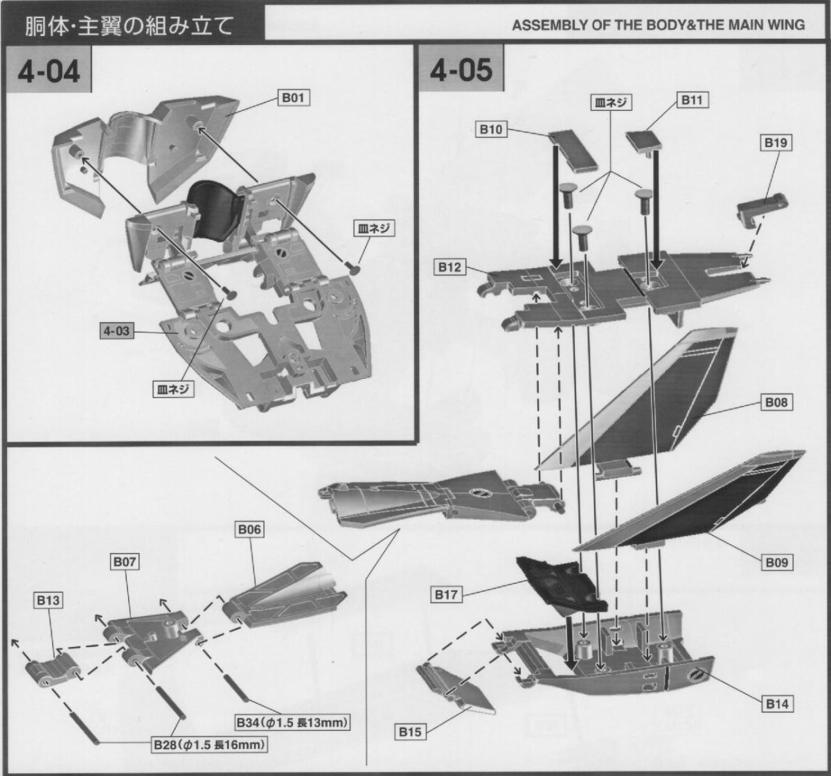

valkfighter Posted August 19, 2012 Posted August 19, 2012 (edited) Thanks ValHary, how much do you want for the part? Also, does anyone know how to disassemble the backpack on these VF-1 toys? Hi MacrossJoe, my english is not so good to explain you how to disassemble the backpack but i can show you the parts involved in it. the images are from the assenbly kit version, one is the assenbly procedure the other is the parts list. one thing to be careful with are the parts B10 and B11 which cover (hide) the screws these may be factory glued. Edited August 19, 2012 by valkfighter Quote
MacrossJoe Posted August 20, 2012 Author Posted August 20, 2012 valkfighter, thanks for the diagrams, very useful information. The two pieces you mentioned, B10 and B11, those are exactly the two pieces I'm having difficulty with. I can't figure out a good way to get those pieces off without damaging them. Anyone know a good way to remove those pieces? I think I might just use a flat blade tool to very carefully pry the two main pieces of the backpack slightly open and just wedge the flap in. Quote
EXO Posted August 20, 2012 Posted August 20, 2012 That's pretty much what you have to do to get those to open. Just do it little by little. You might be able to get away with just taking off just B10 and pry it carefully enough to slip the B15 part in there. But if the gap isn't wide enough, you'll have to take out all the screws. Careful is the word, you don't want a valk that looks like Vi-RS's images. Quote
MacrossJoe Posted August 23, 2012 Author Posted August 23, 2012 Thanks EXO. I'll give it a shot when I get the part from valhary. (I'll need to paint it to match the VF-1D color of course) Thanks for all your help guys. Quote
MikeRoz Posted August 23, 2012 Posted August 23, 2012 This piece wasn't missing or broken out of the box but it broke on my 2nd transformation. My hinge looks exactly like the one posted by Vi-RS. I saved the flap and the chunk of the hinge. Some day when I have time I might try re-attaching it... Quote
