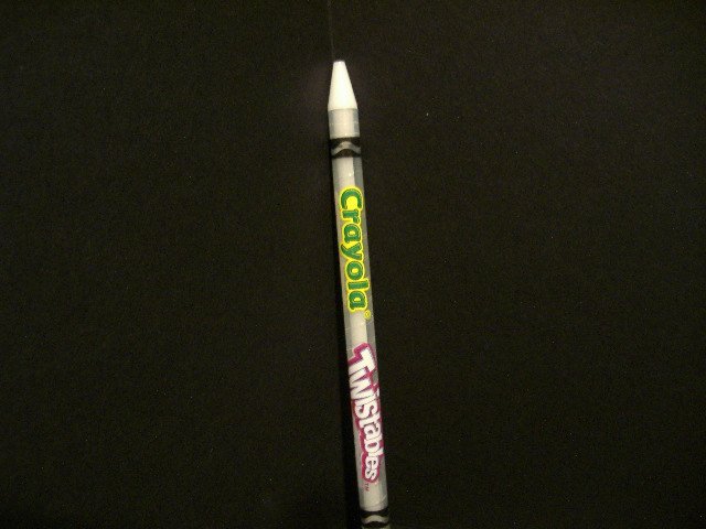

Wicked Ace Posted January 7, 2007 Posted January 7, 2007 Another option is the Crayola twistable colored pencils. Comes out chalky but subtle -- no drawn-in anime look. Once you get the consistency you desire, you can spray a top coat on, however my project in the picture is not top coated (still a work in progress). Quote

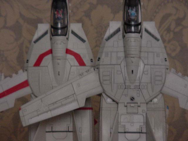

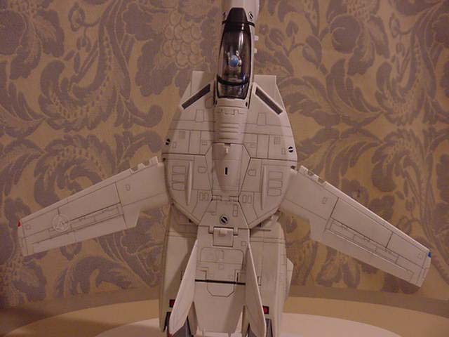

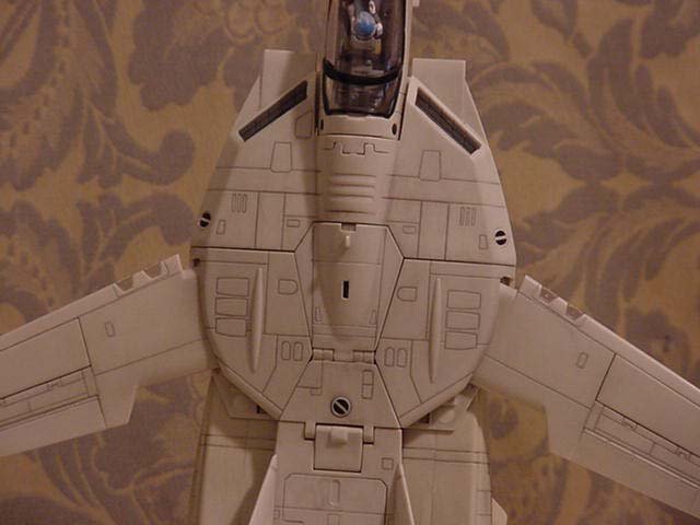

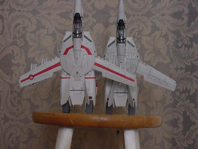

do not disturb Posted January 8, 2007 Posted January 8, 2007 a little late to the party but i recently panel lined one of my valks using a mechanical pencil and did what could be considered "weathering". first i filled in every panel line using my trusty pencil, then used a soft toothbrush and brushed over the entire valk. basically the toothbrush lightened all the panel lines and spread the excess graphite all over the valk creating a dirty weathered look using a minimal amount of effort. the great thing i like about it is the weathering is totally random, giving the valk a more used looked as opposed to the painted model look. i'll post a pic tomorrow. Quote
do not disturb Posted January 9, 2007 Posted January 9, 2007 pics! [attachmentid=39476] [attachmentid=39477] comp pics [attachmentid=39478] [attachmentid=39479] the weathering comes out dirty and random giving it a more used look. Quote
tom64ss Posted January 9, 2007 Posted January 9, 2007 pics! [attachmentid=39476] [attachmentid=39477] comp pics [attachmentid=39478] [attachmentid=39479] the weathering comes out dirty and random giving it a more used look. How did you strip the original paint? Quote

Lonely Soldier Boy Posted January 23, 2007 Posted January 23, 2007 a little late to the party but i recently panel lined one of my valks using a mechanical pencil and did what could be considered "weathering". first i filled in every panel line using my trusty pencil, then used a soft toothbrush and brushed over the entire valk. basically the toothbrush lightened all the panel lines and spread the excess graphite all over the valk creating a dirty weathered look using a minimal amount of effort. the great thing i like about it is the weathering is totally random, giving the valk a more used looked as opposed to the painted model look. i'll post a pic tomorrow. Hey, Do Not Disturb: Doesn't the graphite leaves a metallized finish to it? I feel tempted to use that technique myself, but I'm not sure about the results. From the pictures it looks great. Quote
David Hingtgen Posted January 23, 2007 Posted January 23, 2007 Well, since weathering on real planes often is "paint peeling to reveal the metal beneath", a metallic effect is usually seen as good. Also, most of the darker streaks you see on a plane? It's dark because of all the graphite used for lubricating the hinges. Nothing makes a plane look like it's got graphite streaks than real graphite. Hydraulic fluid is red, but the streaking is dark because of the graphite. Quote
Skull-1 Posted January 23, 2007 Posted January 23, 2007 (edited) Well, since weathering on real planes often is "paint peeling to reveal the metal beneath", a metallic effect is usually seen as good. Not always David. There are lots of surfaces and parts that are composites nowadays so there is no metal color beneath. Just a note. Also, most of the darker streaks you see on a plane? It's dark because of all the graphite used for lubricating the hinges. Nothing makes a plane look like it's got graphite streaks than real graphite. Hydraulic fluid is red, but the streaking is dark because of the graphite. Gap filler is also a cause of obvious panel lines. Most panel joints are sealed then painted making them nearly invisible from even a short distance. Model panel lines are 99% overdone. Edited January 23, 2007 by Skull-1 Quote
do not disturb Posted January 29, 2007 Posted January 29, 2007 Hey, Do Not Disturb: Doesn't the graphite leaves a metallized finish to it? I feel tempted to use that technique myself, but I'm not sure about the results. From the pictures it looks great. not really, it actually just make the valk look dirty/dusty as hell. i can't really describe it because it comes out so random and my pic taking skills suck to boot. if anything, try it on the underside of the wing and see if you like the results. if you don't like it, just take the wing off and wash it with soap and water, the graphite comes right off. Quote
