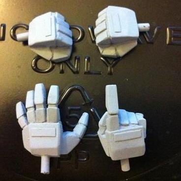

OK... After my sad foray into trying to make 1/48 articulated hands. I know a lot of people were waiting to replace their chicken hands. While looking thru my parts that I need to clean up for recasting. I found the masters for Etern'l D's custom hands he used to sell that he gave to me. I called him to see if I can offer these and he gave me the green light.
I'm just wondering if there's enough people that may want these. I know Old Man wanted some a while back.
If we can get the whole run done, which is 25 sets we can go $15. But if we can get at least 15 sets and if people still want it it'll be $20. I'm actually gonna put myself down for 5 sets...

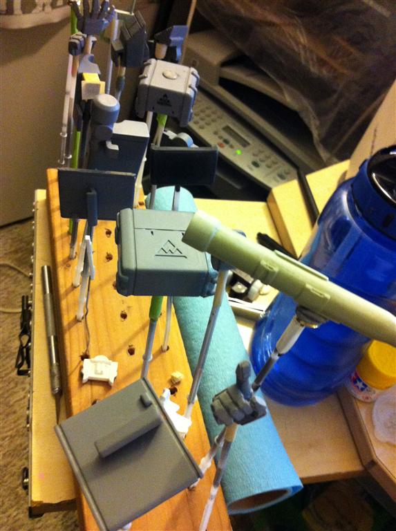

I took th picture earlier when I was thinking, what did I get myself into? The parts look clean but there's pinholes and old mold release residue. I washed the parts and filled in the holes and yeah they look good enough to cast, but tomorrow I'll be laying on some primer to make sure it's supersmooth. Then on Thursday I deliver it to the recaster.
When the parts that will be painted come back to me, I'm going to wash those, fill in the pinholes and sand down any imperfections. Prime. Sand again, prime and then paint them. And then a ton of clear coat. It's a lot of work but I feel better when I hear back from people when they get their parts.
The rocket launcher tube is green because the master was damaged. That's an extra that I had that I've cleaned up.
