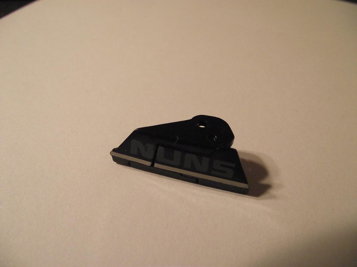

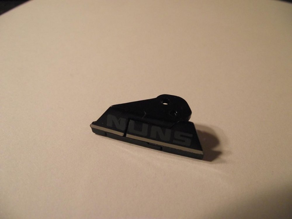

Can someone take a clear photo of the breakage? I've heard so much about it - but I dont think I've seen it.
Not the best pics in the world, but hopefully something to give you an idea. Luckily I still had the pics from when I had to send mine back to HLJ. I'm sure someone else can post better pics.
post-4919-0-01914600-1380210941_thumb.jpgpost-4919-0-76530200-1380210964_thumb.jpgpost-4919-0-41151500-1380210991_thumb.jpgpost-4919-0-76790100-1380211022_thumb.jpg

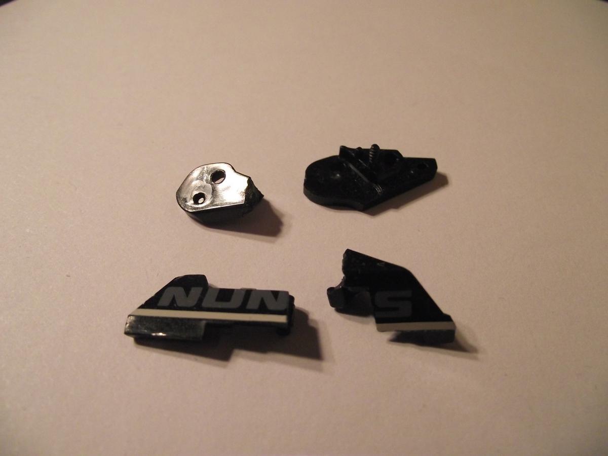

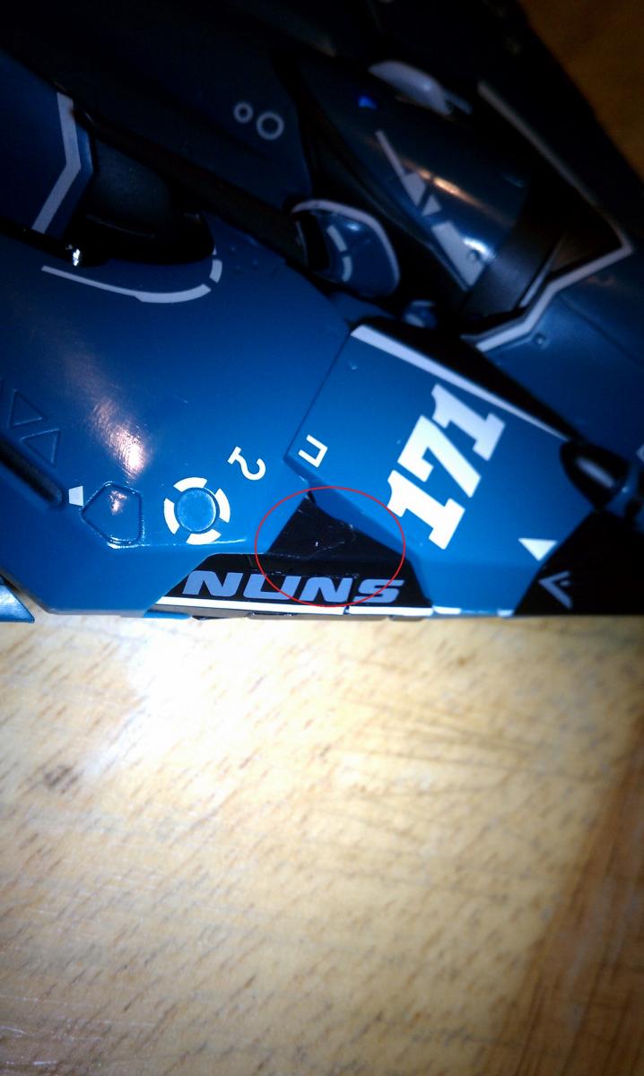

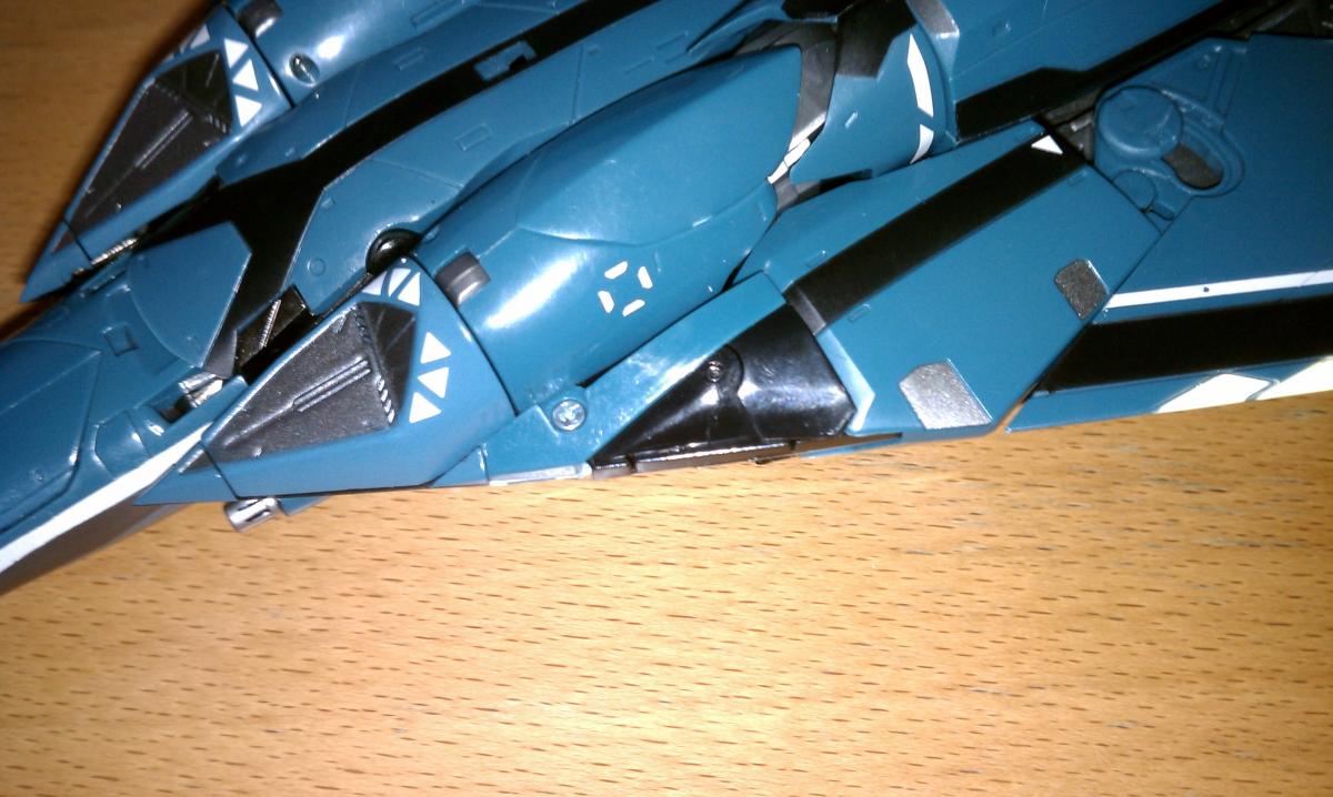

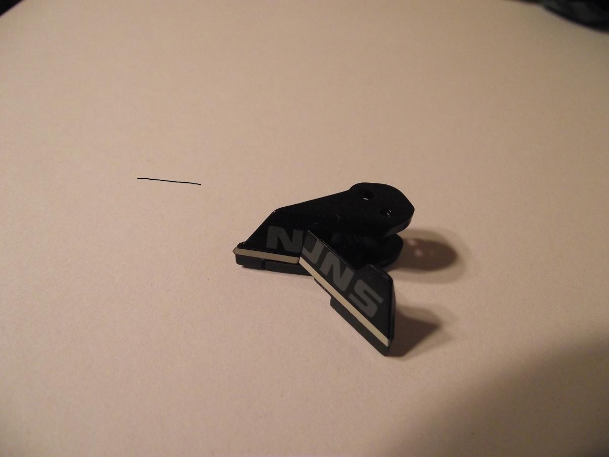

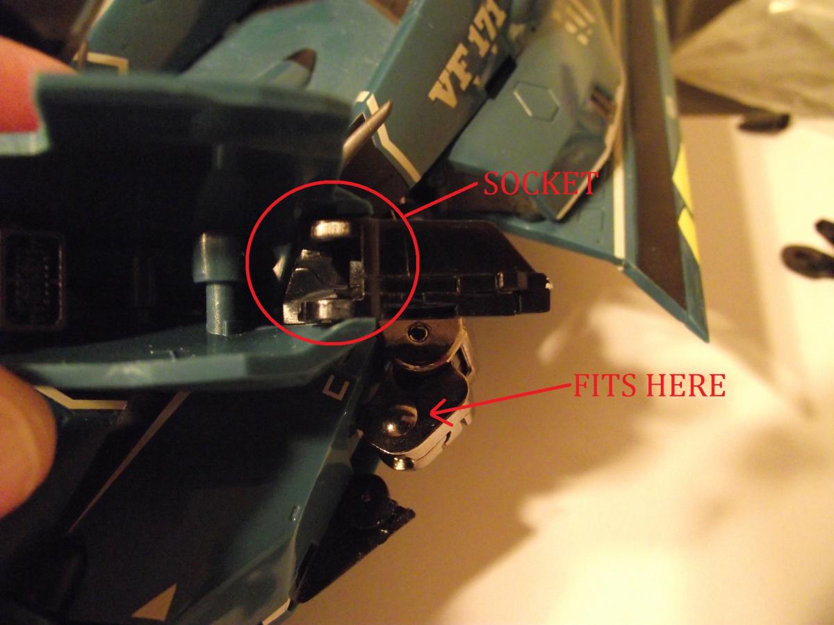

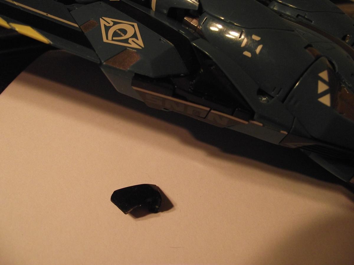

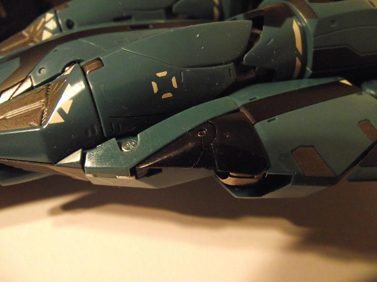

I don't know if these will help, but here's some photos I took of the problem parts.
Intact NUNS part, forms the hinge/socket for the shoulder pads
Broken NUNS part
Detailing how NUNS part works
Bottom filler part intact (though heavily cracked)
Bottom filler part broken
Damn, doing a study of the parts... I see now why no one has stepped forward to tackle this - tricky, tricky.
The part with 'NUNS' printed on it seems the most straight-forward to craft. Fiddly, but do-able.
The lower, thin 2-part is going to be skirting the tolerances (read; possibility) of the material type with the strongest properties... Going to fiddle with it and see if it absolutely needs to be able to swing to transform.
I have some thinking to do...
To bad they couldn't use a softer material that had more flex. I would sacrifice some visual accuracy for durability. I don't even know if it's possible 'cuz they would've done it already.
But Bandai did do it already, use a more resilient plastic for the parts breaking on the 171 CF, that is. Alto's VF-171EX has the exact same design/engineering/molding and has had no such breakage issues reported; the problem with the CF is undoubtedly due to the use of either a lower quality/lower grade, cheaper plastic formulation, or some other change in their molding process (faster cycling time, change in molding temperature, something...) that results in ridiculously more brittle parts that can't handle the stresses present... stresses that were adequately addressed by the same parts on the EX model.
Edit: I hope I'm wrong, but I have a feeling that one or more of the parts that need replication are too thin to be accepted by Shapeways.
Edited by mechaninac
I hope that was the problem. My Alto has a broken small triangle so I thought it was for both models.
New parts for the top would still be great even if its not possible to do the bottom triangles on Shapeways. Whatever you do or don't do, thanks for at least looking into this Kurisama! B))
What if it's designed thick enough for shapeways and then we sand it to what we need?
That could work. Design the parts so their internal geometry matches that of the ones being replicated so that fit to the toy is guaranteed, and make the outward facing surfaces as thick as they need to be in order to meet shapeways minimal requirements; the buyer then has to file/sand down to the final thickness.

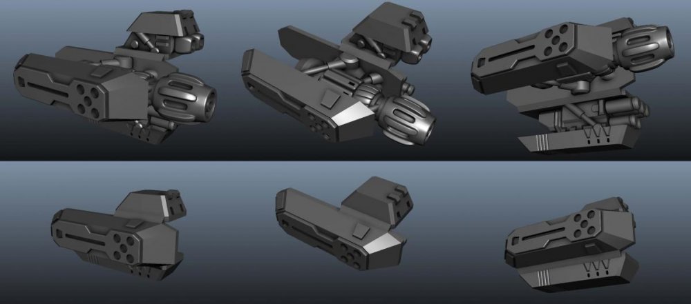

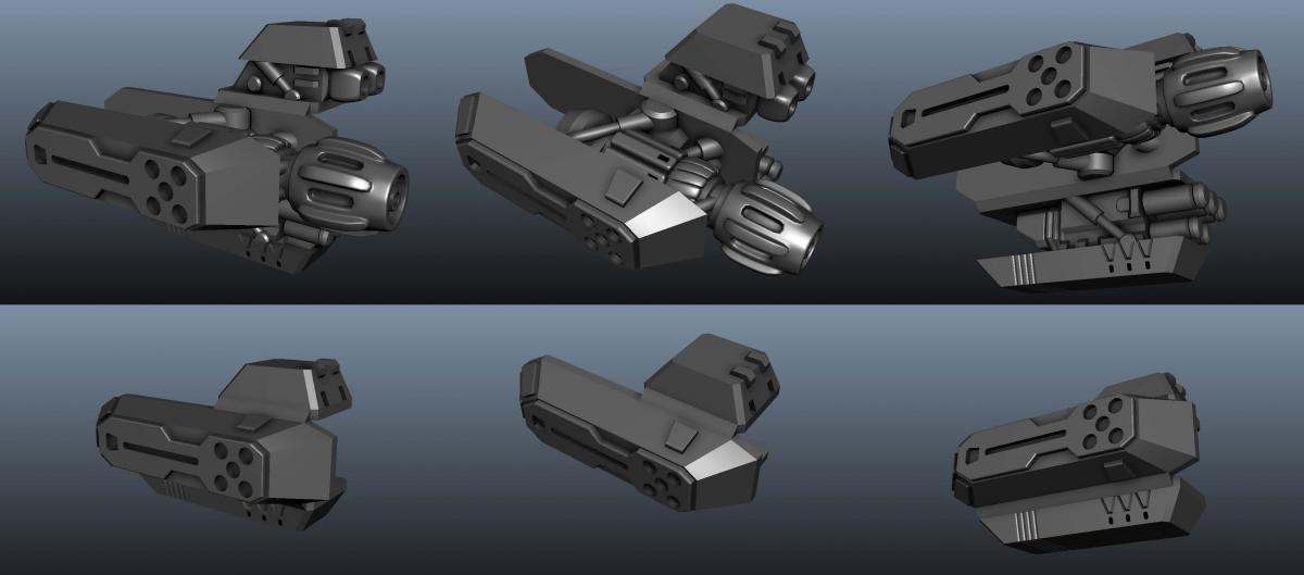

Still umming and aaring about the VF-171 parts... But inspired by forum member - MaidenJapan's work, I dusted off an old file and have finished this today;
Wasn't sure if I should post it here or in the Workshop! forum, but since I haven't got it in hand, thought I'd place it here. Going to upload it tonight and make it available at a discount for a limited amount of time, so peeps can get it and have a play around - I simply can't afford to pay $20 shipping plus I'm terribly poor at the moment...
Let me know if ya'll want a left-arm version too - or both left and right in the same order.
OH YES - I should mention this is designed to fit the NEW 1/60 VF-19 series, so the S, F, P and Kai - and assuming the new YF-19 from Arcadia uses the same mould for the forearm, this should fit that too.
Still a few details to tweak before the upload. Stay tuned.
Sexeh... As for the 171, I'll reiterate that I don't think replacements for the lower triangles should fold. The damn things are fiddly enough when they're in good shape. I'd say, if they're broken, dealing with a removable replacement just makes everything easier.
Wow, you and Maiden had pretty much the same idea for implementation.
