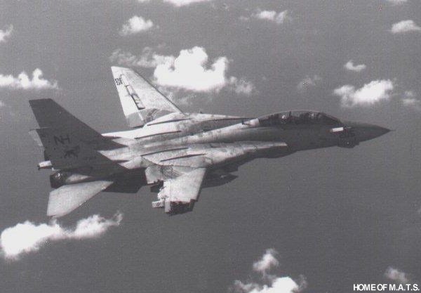

Holy crap! I've read about the Israeli F-15 that landed missing a wing, but I never saw a Tomcat flying with that kind of damage!
Chris
Edit: apparently it too landed safely!
The first photo depicts the F-14A BuNo 159832 side number 205 which on Jun. 29, 1991 experienced a mid-air collision over South Chinese Sea with another Tomcat, the BuNo 161597 side number 201. Both aircraft were from Black Lions of the VF-213, at the time embarked on the USS Abraham Lincoln (CVN-72) and while the 201 crashed into the sea where the crew was rescued, the 205 was able to land to Singapore after loosing part of its right wing.
Edited by Dobber
I read somewhere that around 40% of the F-14's lift capacity came from the pancake fuselage itself..
I can see that. Other than the cockpit and engines the space between the engines is flat
If you slice an F-14 right down the middle, nose to tail----you'll get almost a perfect classic airfoil shape. The "trailing edge" is achieved by having the beaver-tail so thin that there is almost no structure, purely the external skin itself----you can see right through that area when the airbrakes open.
