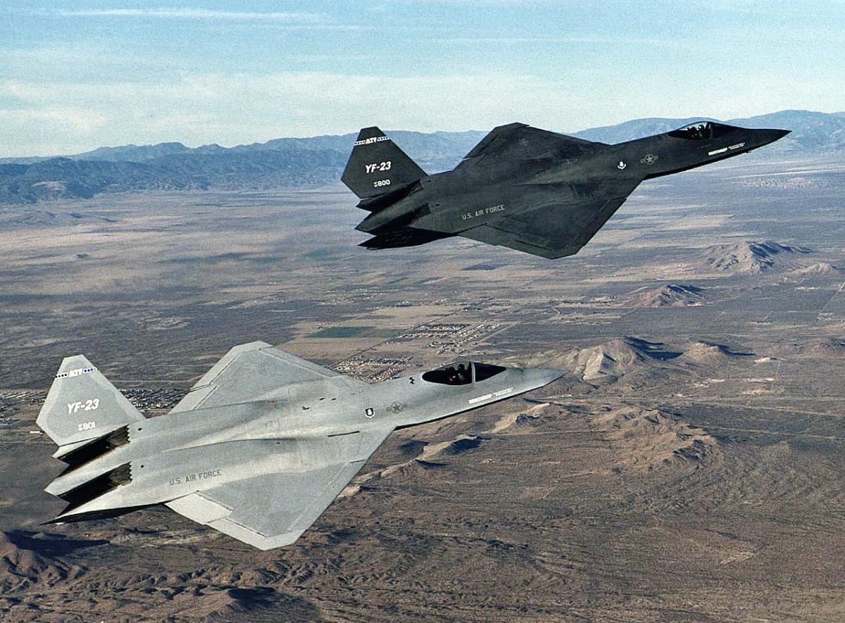

Could be various lighting in pictures perhaps. I will say one thing, what a frakking shame that plane is just wasting away outdoors, should be properly displayed in a museum. All that time, money & effort it deserves better than that.
The grey YF-23 is the exact same colors (and similar pattern) as your standard Ghost Grey 1980's F-15. FS36320 blotches over a FS36375 base.
The Northrop-McDonnell YF-23 used F-15 cockpit, F-15 nose gear, F-18 main gear, and most of the basic internals (hydraulics, pneumatics) etc were fairly standard F-15/F-18 parts. It was basically a McDonnell plane in a Northrop shell. And also painted in the standard F-15/F-18 colors at the time. :)
