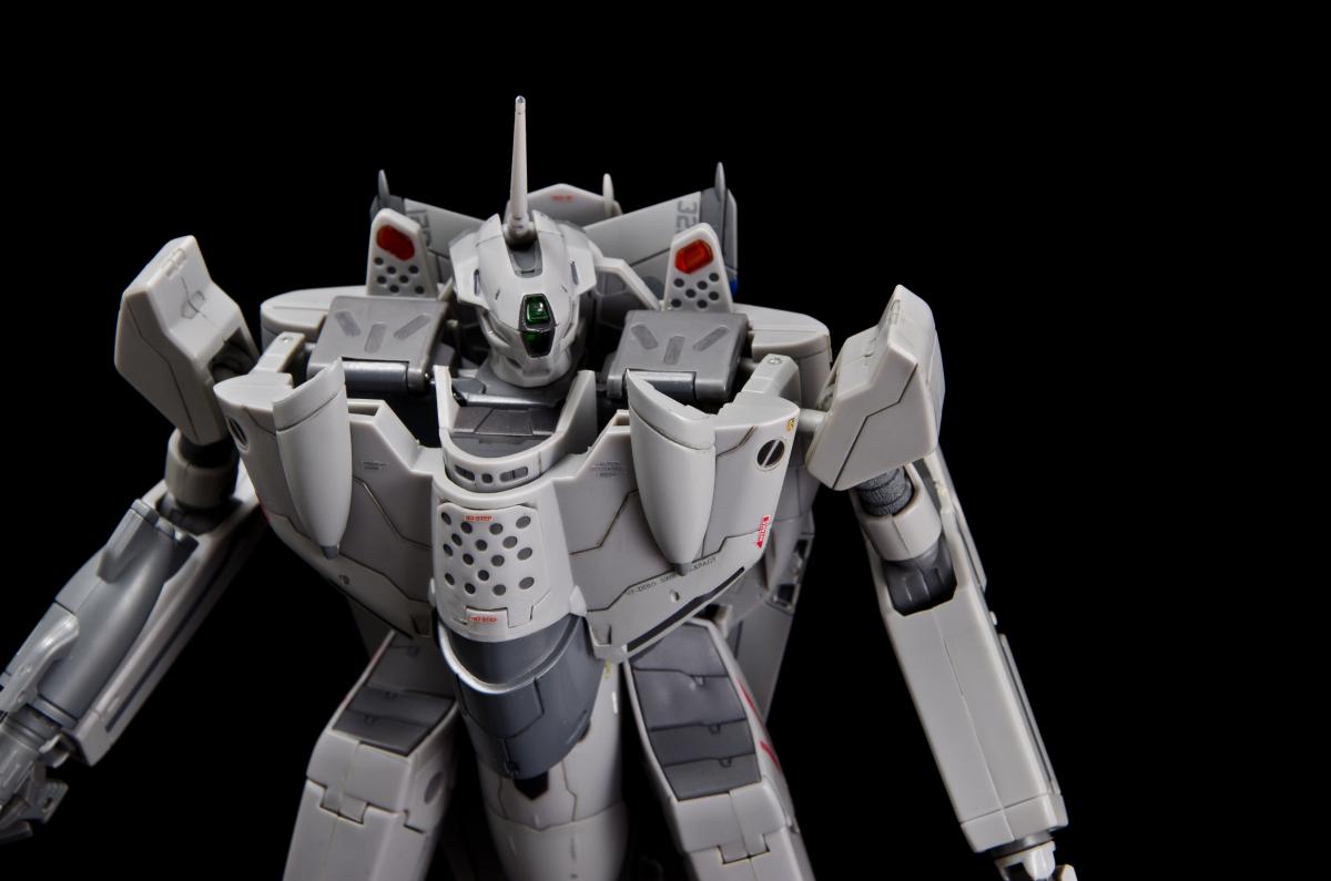

Anavel Posted May 9, 2012 Posted May 9, 2012 I was going to do a video but no time today. Also shapeways also seems to be having some trouble uploading parts at the moment. I have contacted them and will hopefully hear back tomorrow. The plan is to offer a complete set of parts for the left arm as one bundle and the same for the right. The upper or lower replacement parts can be used with the stock Yamato parts if desired. The accuracy Shapeways is claiming seems to be a bit conservative. This has made some aspects of the design more difficult. -On 4 sets I have ordered the shoulder varies from tight to very tight, it can be adjusted by the tightness of the two screws that hold the shoulder together. If for some reason the shoulder is loose you should be able to re-use the rubber pad from the yamato arms to add tension to the joint. -The elbow swivel seems sufficient and can hold the weight of the gunpod. I would have liked to make it a bit tighter but could not do so and guarantee the parts to fit. This was the main revision that I had to make after receiving the first set of parts. The rubber part from the Yamato arms should be be reused. Quote

Razerwire Posted May 20, 2012 Posted May 20, 2012 Got my order in yesterday which I inked with a dark gray Sharpie which didn't seem to have any adverse effects on the plastic. The parts are holding up well and went through transformation without any hiccups. Glad to see my 0A having fully functional shoulders now. Many thanks for taking up this job! Quote
