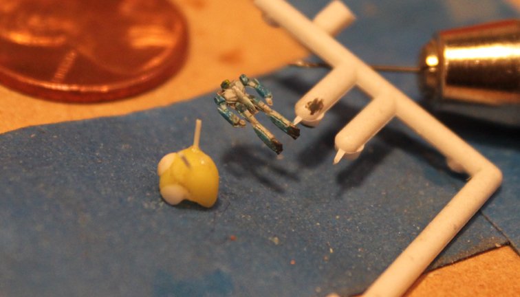

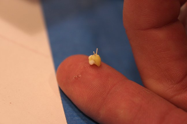

If painting in 1/2000 scale wasn't tedious enough...

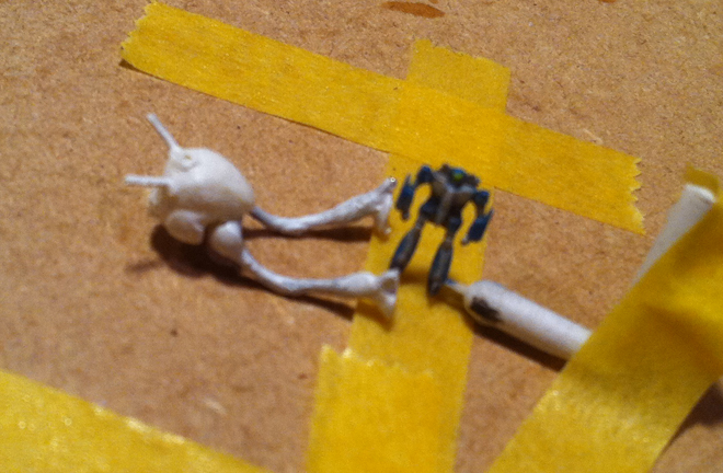

I thought I'd challenge myself tonight and take on sculpting a regult. I'll finish up the legs tomorrow, eyes permitting!
The scale paint jobs on the VFs turned out very nice. The scratch built Regult is looking way cool so far.. Can't wait to see the full version painted up. Will you be using the SDF Macross paint scheme or the Green tinted DYRL scheme? Might think about making a small RTV mold using automotive RTV sealer and cast you a few more of those.
Can't wait to see the progress of this build up.
Edited by Mark Warlock
wow, man a regult, you crazy. Looking pretty good so far,,, but you have to make thousands of em for the diorama
anyone remember those shrinky dinks things you heated in the oven and they shrunk,,,,, possibilities here
Edited by pfunk
Thanks for the encouraging words!
Mark Warlock, I"ll definitely be making molds of the regult...my eyes can't take much more of this!
Pfunk, you might have something there..

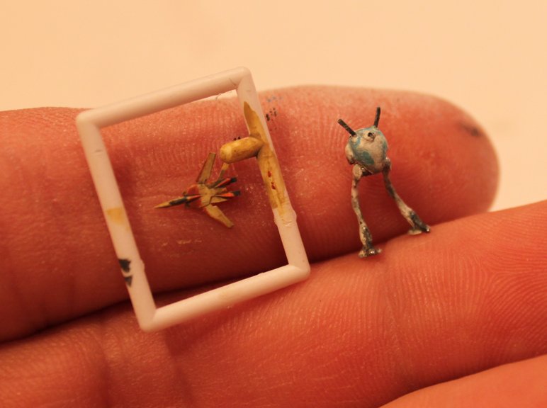

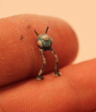

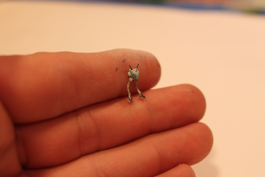

Hey Shipmates!

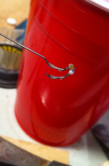

Finished the legs and the paint for the regult tonight, and I'm pretty happy with the results. After assembly, I did noticed the regult's "eye" was too high on the pod, so I'll need to cheat that down a taste before committing it to silicone.
The legs were constructed of steel rod, brass and applied CA. The glue was used to build up the contours. The dome shapes for the feet, hips and thrusters were created by dripping (white) casting resin on wax paper(this is a great technique for creating rivets and carriage bolt heads, as well). The gun barrels come from sprues that were heated, stretched and cut to size.
Ahab
Edited by Ahab
Ahab, this is awesome. I'd never be able to do this considering how much my hands shake. I'm really impressed.
To keep things in scale - WOW! :lol: Those look great! I'm sculpting some 1/350 stuff now so I can relate. Magnifyers are great ;) Keep up the great work! So what's next? - MT
Thanks for all the kind words, it definitely helps to keep me on track!

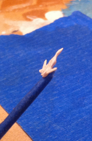

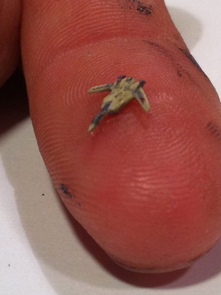

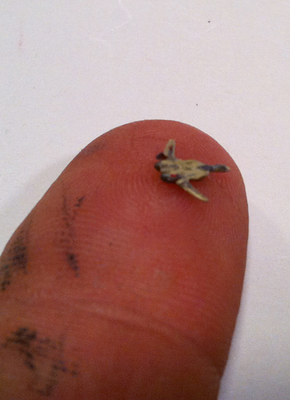

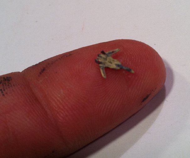

I decided to hold off on the mini monster, for now, and tackle one of two YF-19s for the attacker mode SDF display.
I arrived at the decision soon after I bought the kit that I would need to build different enviroments for the Ship. A Mars base drydock will be home for the cruiser mode, while a cityscape with the SDF overhead will showcase Attacker mode.
This little guy was a beast. I have a few touch ups to address here and there, but I happy with it. I sculpted a little fold
booster and gun pod, too (not pictured)..
Pardon the not-so-sharp images. I'll use a better camera when I post the booster pics.
Next up: SDF feet.
Edited by Ahab
Oh man....ain't that the truth!
You should've seen me attaching the verticle stablizers....I think my lung capacity has doubled over the last few days, and my eye sight cut in half! :blink:
Shaweet! Uh make that a diet sweet to keep it light :p That looks great! I believe your on par with the Yamato micro sculpts! I was hoping you'd say mini monster! That will take MUCH longer than the 19 did! Thanks for sharing. - MT
