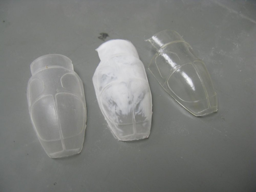

tundrayeti Posted July 16, 2012 Author Posted July 16, 2012 Hey everyone, Another Update. As promised here are the pics of the canopies. The one on the left is the alumalite clear I have been trying, If you spray a layer of clear gloss on it it's not too bad, but still I wasn't happy with it. The middle part is what I have been getting recently with the alumalite clear. It's been really humid around here, and that's tghe only thing i think could have gone wrong with this. The result on the right is the slow setting clear resin. It looks much better. it just takes forever to cure. Well one of the folks who purchased one of these, has offered a solution. I would like to give a shout out to TERR-OR who has graciously offered to vacuform the canopies. I am going to let him work his majic and lets see what he comes up with. In the meantime, I will still continue to cast in the slow clear. This may take a bit guys, Sorry for the delay, but I do want to put the best kit I can out there. Quote
PetarB Posted July 17, 2012 Posted July 17, 2012 Unless your master is perfecty polished - and I mean 'perfect' - you're going to have a hard time getting a proper clear cast, even with good clear cast resin. I think a vacform canopy is a good alternative. Quote
tundrayeti Posted July 17, 2012 Author Posted July 17, 2012 Thanks for the advice PetarB, The part was printed in clear material and I threw it in my vibration polisher till it was crystal clear. I think the problem was with the resin. Alumalite doesn't like Moisture and it as it was my first time using it, I could have possibly done something wrong. At any rate I agree vacforming will be the way to go, so lets see how it turns out. This shouldnt be too much of a delay, but I'm sure that everyone will prefer the vacform canopy. Quote

MechTech Posted July 25, 2012 Posted July 25, 2012 I think you are having moisture problems; it's why I can't finish poainting the Daedlaus. Too bad you can't cast them and throw them in a food dehydrator like with paints. The moisture gets in the resin before pouring. The humidity was only 90% today - MT Quote
tundrayeti Posted July 25, 2012 Author Posted July 25, 2012 I think you are having moisture problems; it's why I can't finish poainting the Daedlaus. Too bad you can't cast them and throw them in a food dehydrator like with paints. The moisture gets in the resin before pouring. The humidity was only 90% today - MT I agree. The humidity has been horrible! these problems started showing up when Summer came early and the humidity shot through the roof!. The slower curing stuff came out okay. Just Okay.. At any rate I don't think folks will object to waiting a little longer to get a better product. Quote

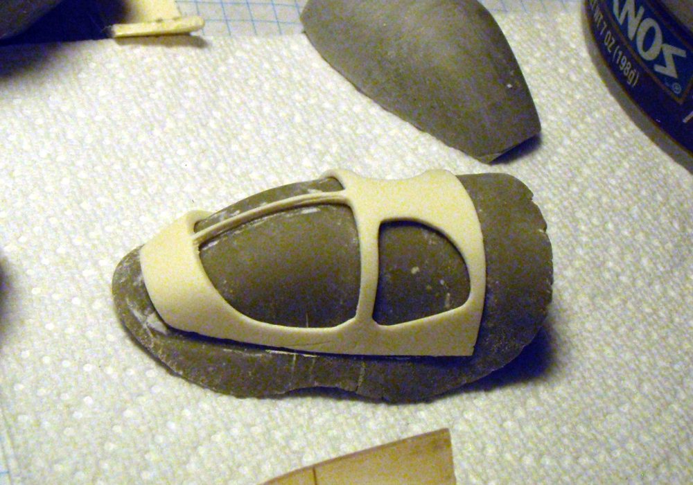

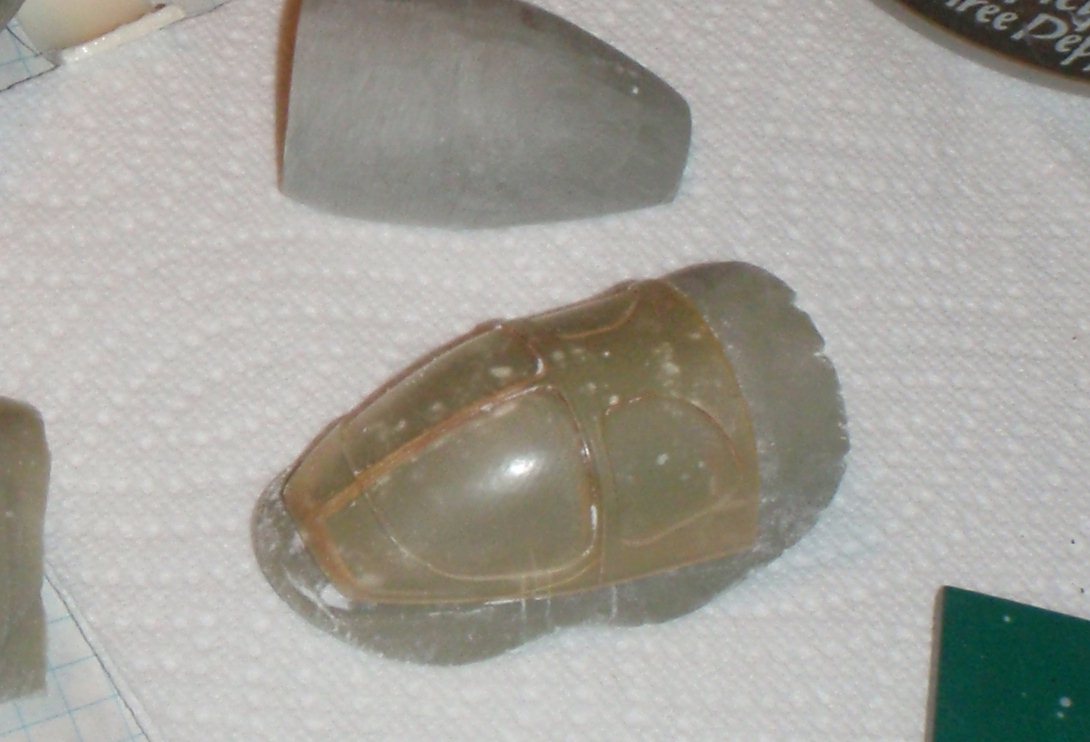

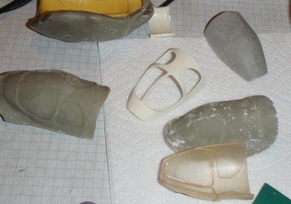

tundrayeti Posted August 27, 2012 Author Posted August 27, 2012 Okay latest update on the vac-formed canopy. TERR-OR has sent me these pics. The mold is almost done, and they should be getting done here soon. So thanks for all your patience everyone, it's about to pay off. I was out of town all last week so I'm trying to catch up on everyone's PM's Quote
MechTech Posted August 29, 2012 Posted August 29, 2012 Those frames look great! I just did some casting the other day with brown pigmented resin and it STILL creamed up and did not cure right. Come on cooler weather!!! - MT Quote
