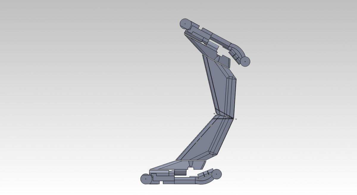

Jasonc Posted December 21, 2011 Posted December 21, 2011 OK, this is probably going to be my most ambitious project I've ever done. But I'm going to attempt to make a tranformable 1/60 VA-3 Invader. Some of you know that I have the S.H.E transformable kit of the VA-3, and know that it is in 1/100 scale. With a list of parts, good caliper, calculator, protractor, and all the other design and drafting materieals, I've begun drafting this in SolidWorks. With a total of 6 parts done so far, I obviously have a lot to go. I thought I'd start this thread to post updates as they are made, and get the community of CAD designers to help in areas I may have questions about. Ambitious, hell yes, but I plan to move at a slow, steady pace to get this done. Comments always welcome. So with that, I present my first screenshot of some leg pieces. P.S. I have no info, nor any intentions of creating this kit,,,,,yet. My goal now, is to get it to look aesthetically pleasing once designed, be able to transform, and improve on the points of articulation from the original kit. But, since I'm sure you guys really want to know a price range, the amount of printed parts and the size is probably going to make this kit somewhere in the range of AT LEAST $400, probably more though. Anyways, off to the design! These are the horizontal tail fins and part of the interior of the legs. Quote

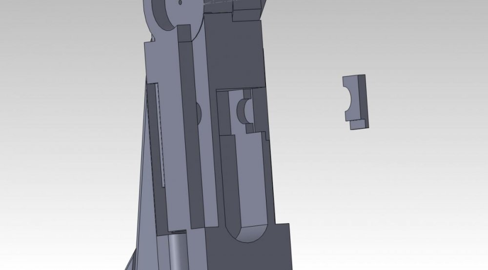

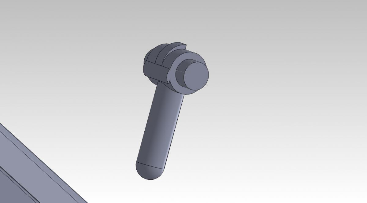

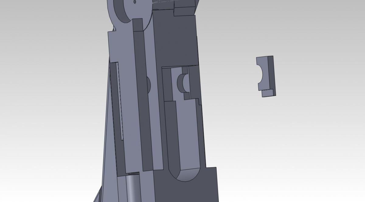

Jasonc Posted December 25, 2011 Author Posted December 25, 2011 Just wanted to say Merry Christmas to all my Macross brethren. I was working on this a bit today, and today's update is the leg locking mechanism. For those that have the S.H.E. kit, it's not made nearly as well as this, and is prone to getting loose over time. This redesign fixes the issue, and makes it to where it will hold its position in fighter mode. The first two show the way in which the connector piece is fitted into the slots. The third picture shows the connector piece itself, I added a stopper on the back of it, that will make guiding the pin into the other leg, and a small lid to give it some ease when lifting it up. Anyways. Enjoy, and while I'll be on for the next few days, I probably won't have an update till probably Tuesday. Thanks for viewing. Quote

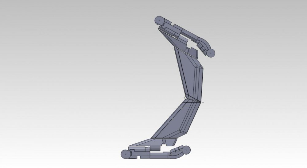

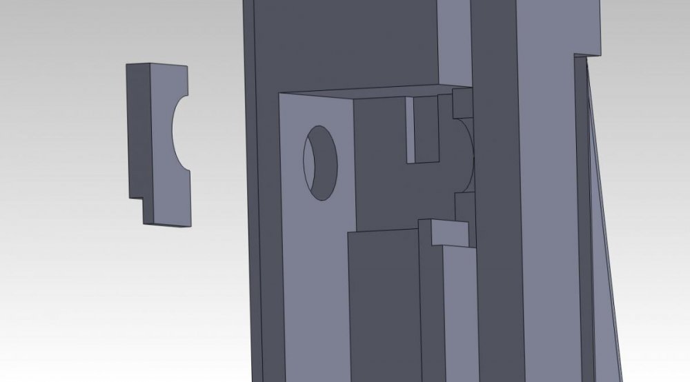

Jasonc Posted December 31, 2011 Author Posted December 31, 2011 Back of the knee outside plate done. This part connects the upper and lower leg together, and sandwiches together in fighter. I will (again) probably redesign the joint pieces to either be made in metal, but I am most likely going to make them into ratcheted joints. For that, I am thinking of the old jetfire ratcheded joints that were in the legs and arms of those toys. They locked in place very well, and were designed for younger kids to play the hell out of them. That said, this kit most likely is going to be made of TASC resin, which is much stronger than the basic resin, metal for the pieces that have high friction and/or need the support, lots of screws to hold in place, springs for friction adding, and the same type of steel pins that are used in the Yamato Valks. The pins will probably be used for things like the cockpit to open and close, as well as smaller moving parts that need a straight guide, such as the tail fins perhaps. Also, I'm going to look into the Wave joints, and see if I can use those in the construction of the feet, for some posable issues that would benefit from them. Anyone's ideas and suggestions are welcome, if you have an idea that would work well. My goal is to make this like the Yamato unassembled Valkyrie kits, except having the majority molded in correct color. Anyways, I just have a couple pieces left of the upper leg that make the inner part, then it's feet and cosmetic parts. Quote

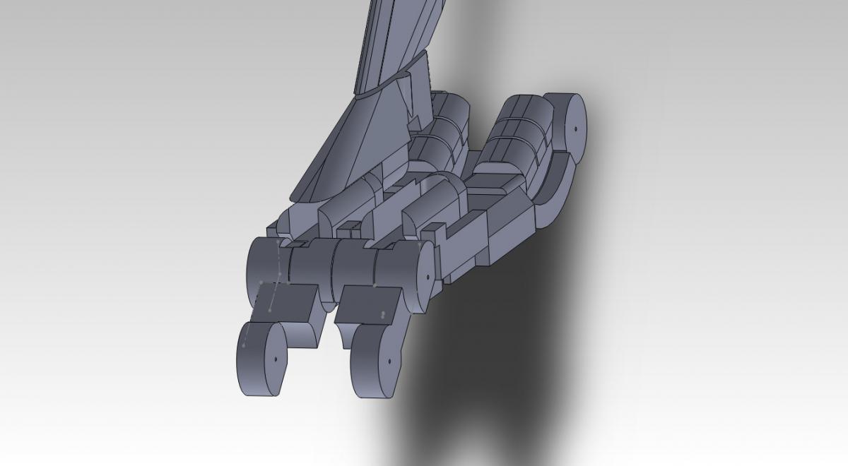

Jasonc Posted January 9, 2012 Author Posted January 9, 2012 Got a little stuck on this one part still, as there are a lot of curves that lead to sharp angles, unsteady grades, etc. It's definitely taking time to get this part right, and since it's a piece that needs to connect almost flawlessly to the lower outside portions, well, there's a lot more going on with it than just a simple design. Tommorow, I'll take a pic of the S.H.E. kit piece, and the step I'm at with said piece. I wish I had more time over the weekend to work on it, but it was party time for most of the weekend (can't complain about that). Quote
