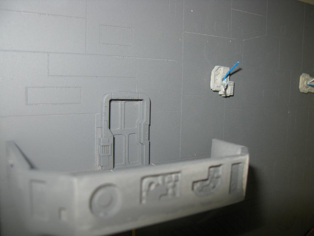

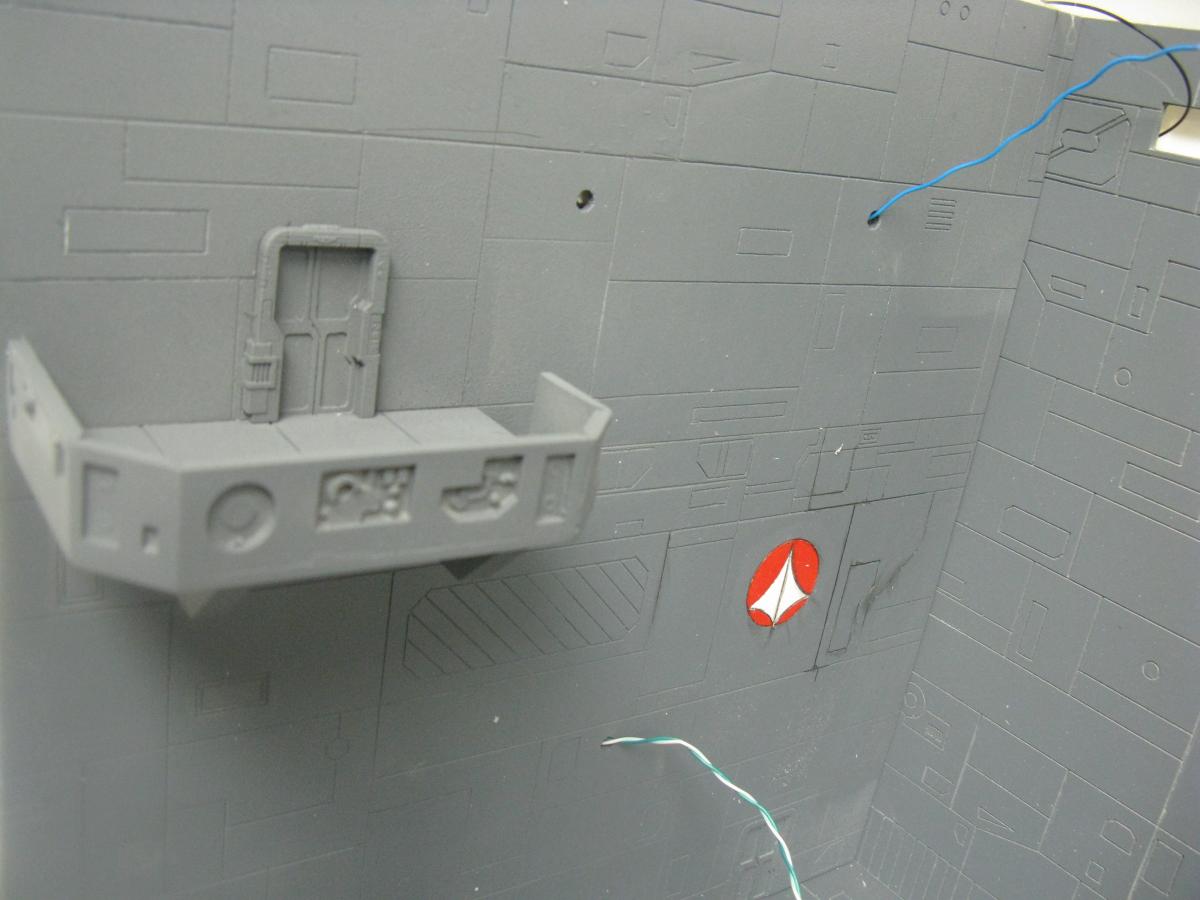

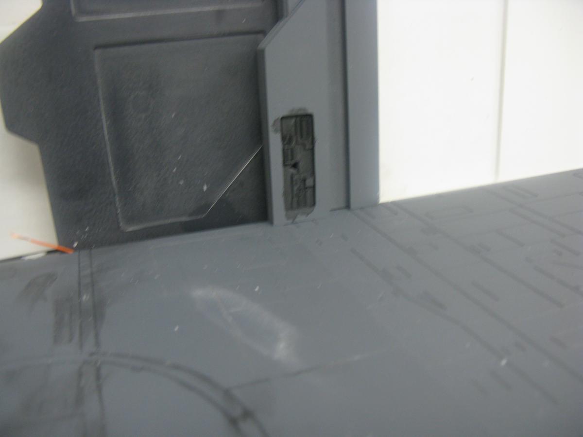

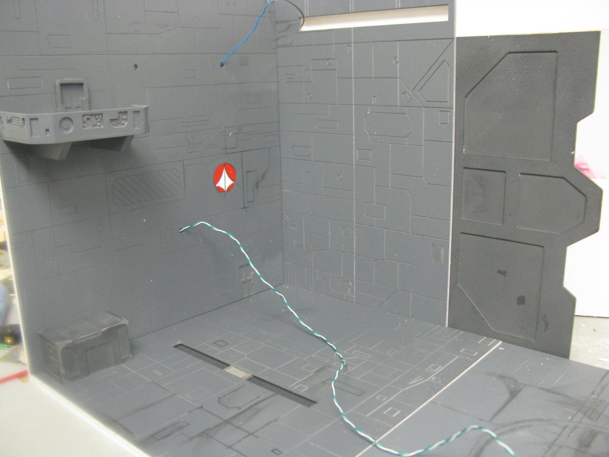

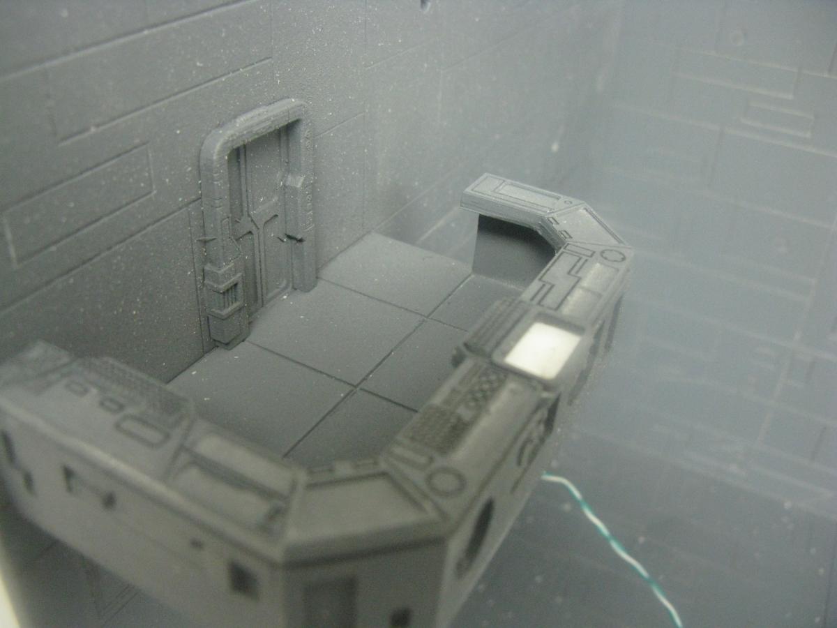

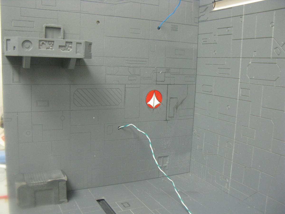

tundrayeti Posted July 8, 2012 Author Posted July 8, 2012 Okay here is a long overdue update. Started on some of the details, added some greebles, started getting wires run. Big thing is the addition of the door details and the control area. Enjoy! Quote
miriya Posted July 8, 2012 Posted July 8, 2012 Yeti, I want a set of the door and control room. Quote
tundrayeti Posted July 9, 2012 Author Posted July 9, 2012 (edited) I'll try to cast the doorways up before i attach the last one. As for the control room, there has been a lot of interest is this so maybe I'll have some 3d printed and cast those up as well. Dorge, if you want the doors though, i did have to machine those during the machining process. Pm me and we will discuss options. So folks Looks like the doors will be added to the list of options/goodies for my custom hangars. The greebles are also avaliable Edited July 9, 2012 by tundrayeti Quote

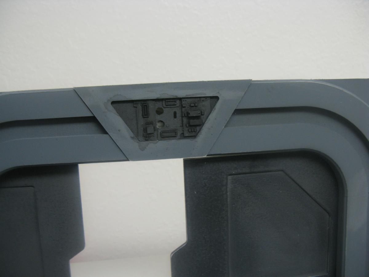

tundrayeti Posted July 9, 2012 Author Posted July 9, 2012 Always ready to do casting. As this was a custom job, I had some of the details 3d printed specifically for this customer. All of the greebles, the light fixtures etc are already casted. The rest of the hangar is CNC machined. I use PVC sheeting for all of my hangar bays. It works out pretty well. The control room/outcropping was also CNC machined. I was going to cnc machine the controls and displays but I'm thinking of printing them out for more detail. This will also allow me to cast them in resin to make them avaliable for everyone. Quote

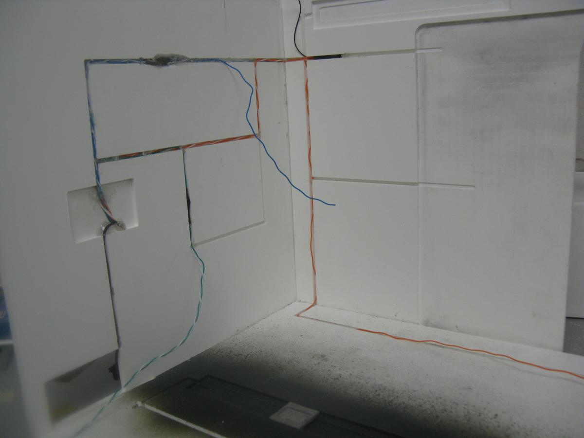

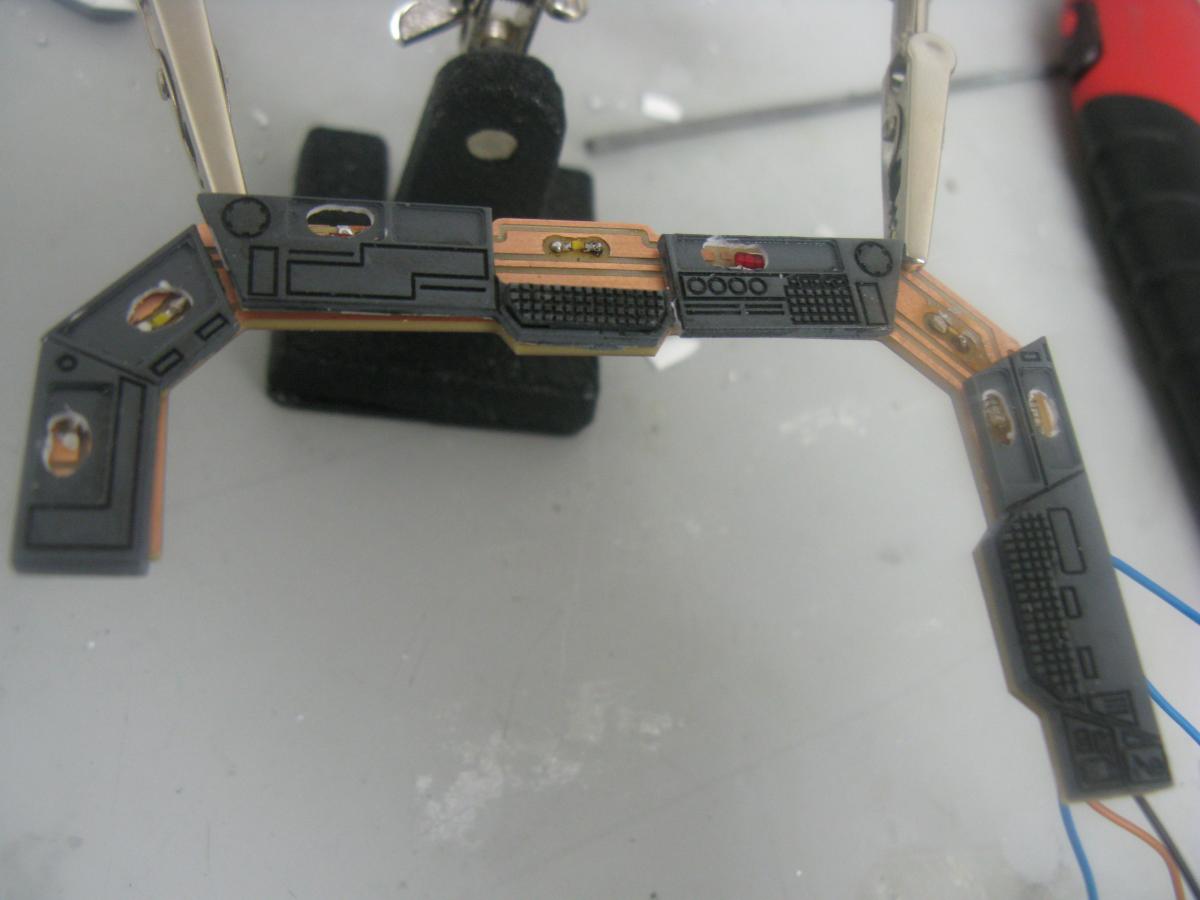

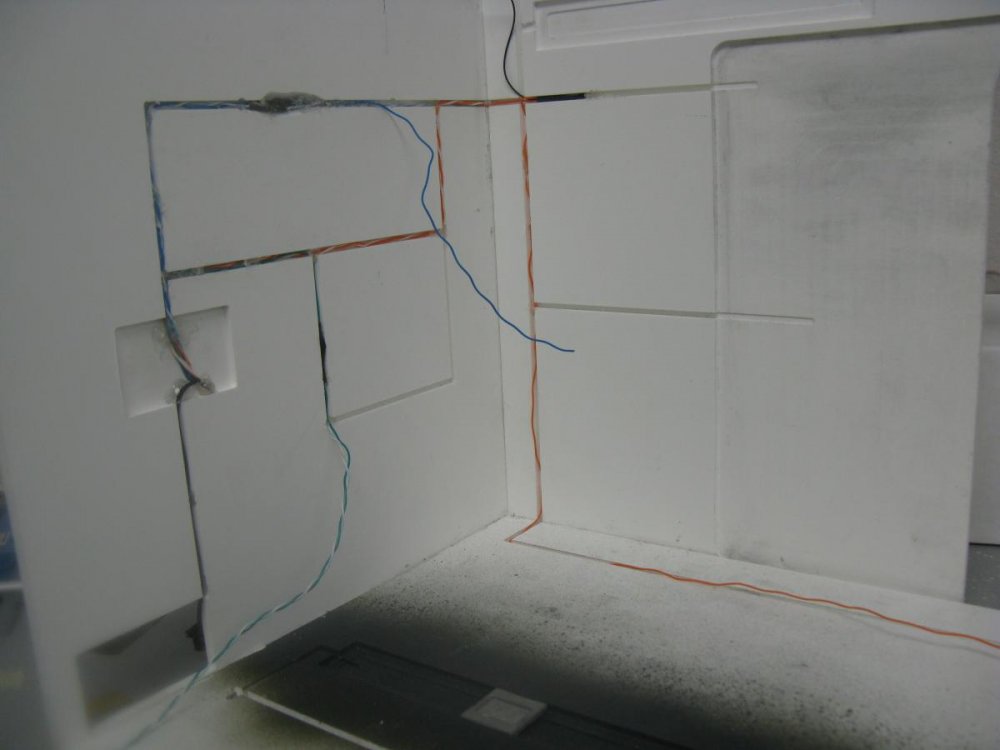

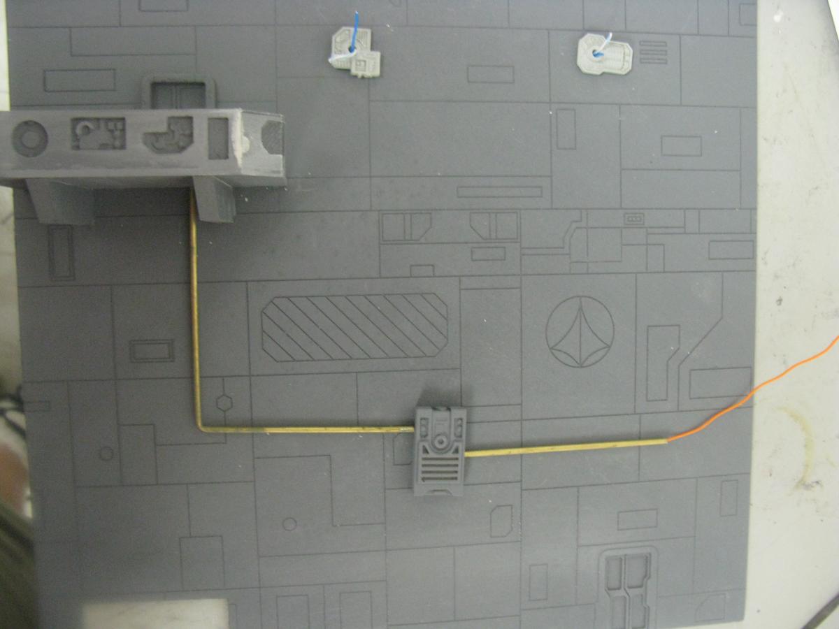

tundrayeti Posted August 13, 2012 Author Posted August 13, 2012 Okay everyone, here is a long overdue update. The owner of this hangar decided to go with a wall plug option vs the battery method. I think that it will work out better in the end. At any rate I had to find a suitable power supply and recalculate some of the resistors and other elecronics to accomidate the new voltage of the power supply. So I got the new design done up, and since there is some extra juice with the wall plug, I decided to add some more effects. Not too much just some lights to the control panel. I have spent the majority of time running wires and adding new electronics. As you can see in the picture, I cut channels in the support boards so that I could run wires in them and glue the wires in place. I have show a pic so you guys can see what I mean. This takes a lot of careful time and planning, hence the lack of updates. Now that the main wires have been run to each of the section they will power, I can start putting some of the finishing touches on this bad boy. I glued the floor lighting and wires in place. also got the UN SPACY kite done. Did a little bit of panel lining as well, I'll clean it up later, or maybe leave it to give that dirty look. Anyway I included some beauty shots. The wires hanging out of the sides will be run through aluminum hobby tubing to add detail, and to power the LED's that will be in the greebles. I'm sure you guys will like the end result. Some of the details are quite small so I had to use 1/32 tubing that I will attach the LED to directly. To prevent any electrical hazard, I am coating these small tubes with the greatest invention ever, Spray on electrical tape. I would say that this baby is at about the 83% complete point. Now that the electronics are close to being done, It will go faster now providing My job keeps me home. Thanks! Quote

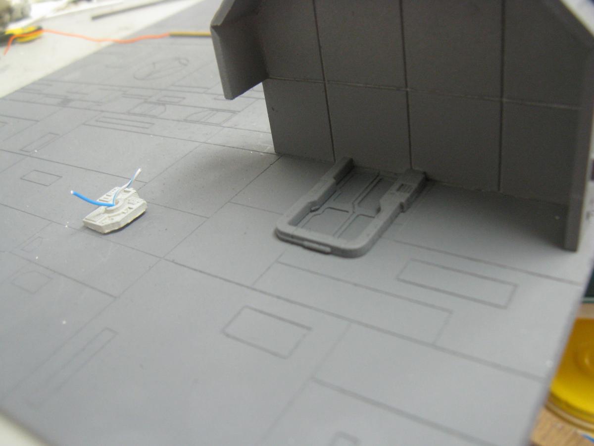

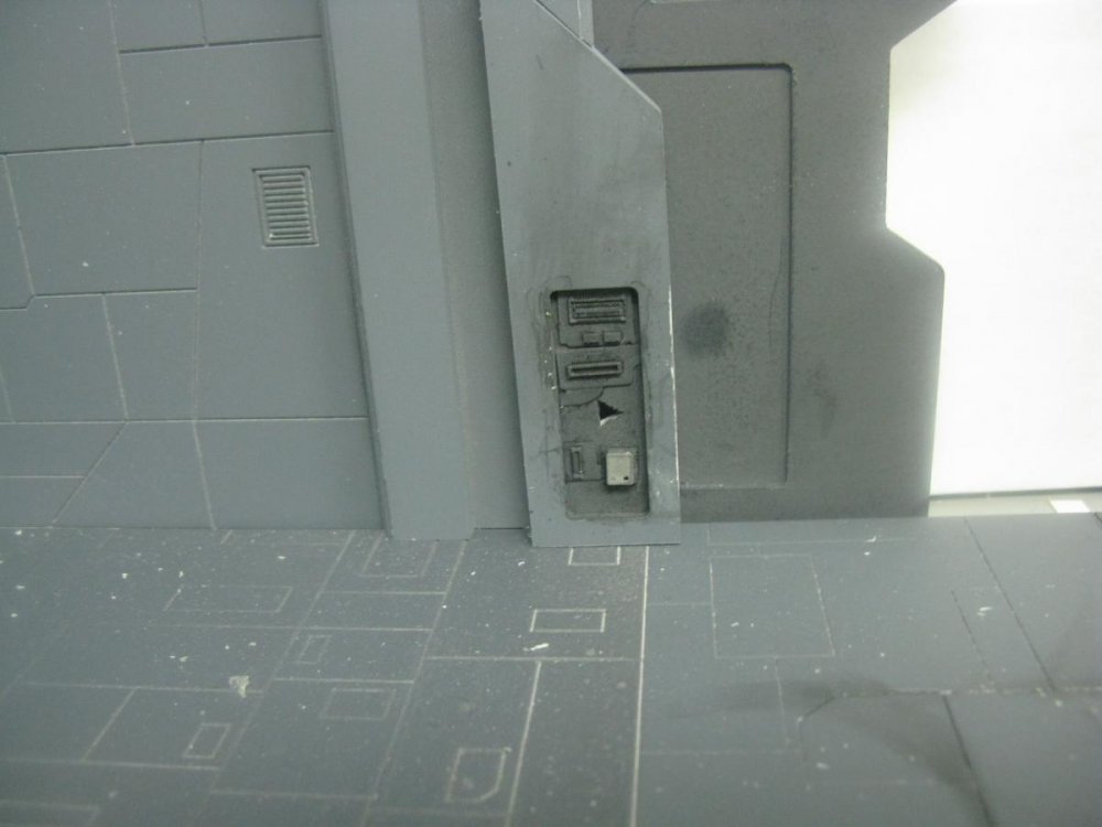

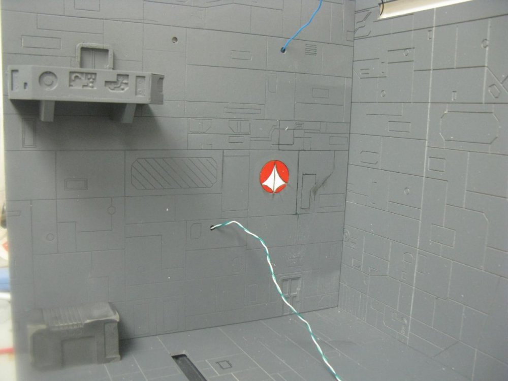

tundrayeti Posted September 17, 2012 Author Posted September 17, 2012 Okay, here is a long overdue update. I have been working on some of the smaller details on this hangar. Lots of small greeblies and piping work. I couldn't get pics of everything, but I have started the control console for the work stations, and also detail work on the doorway. Enjoy! Quote

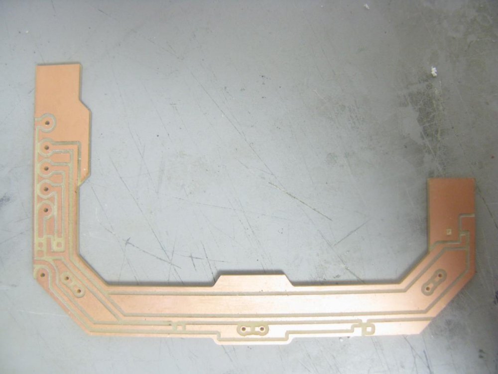

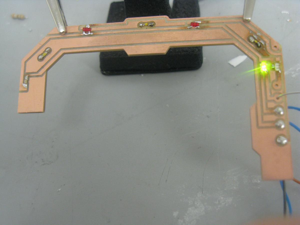

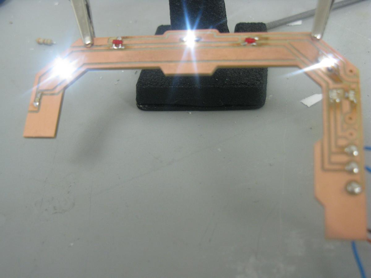

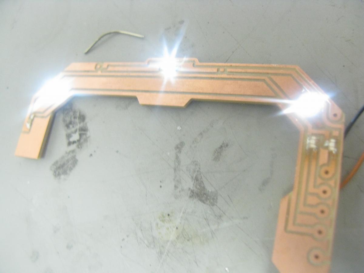

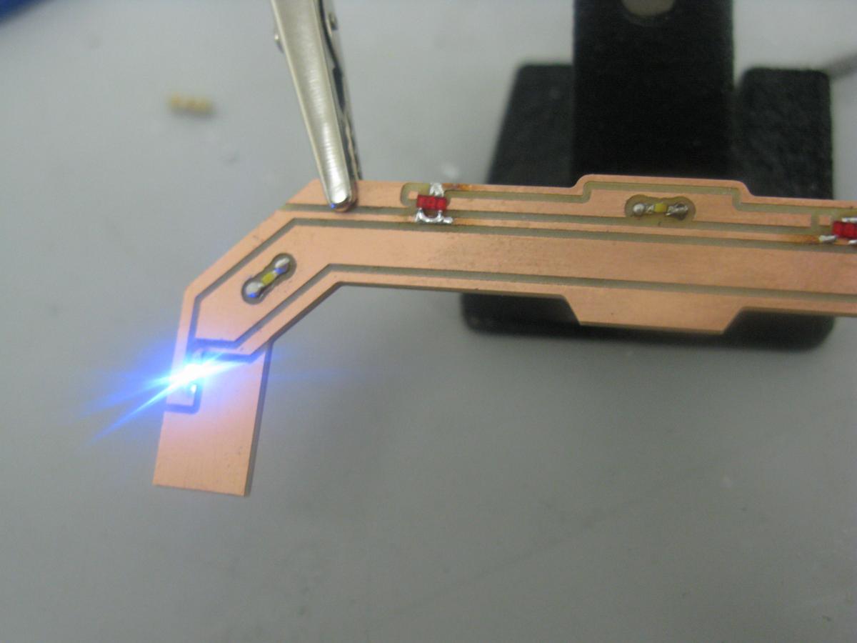

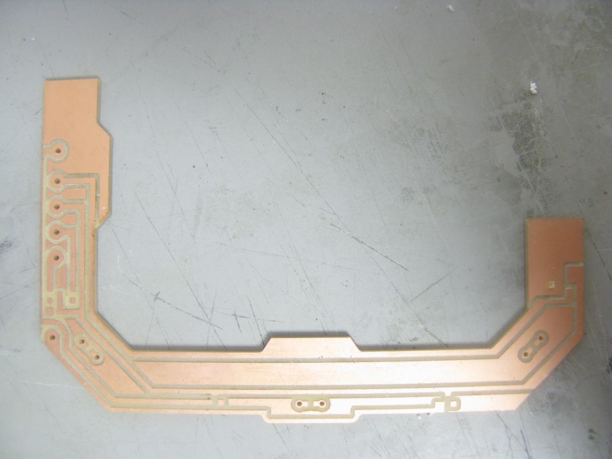

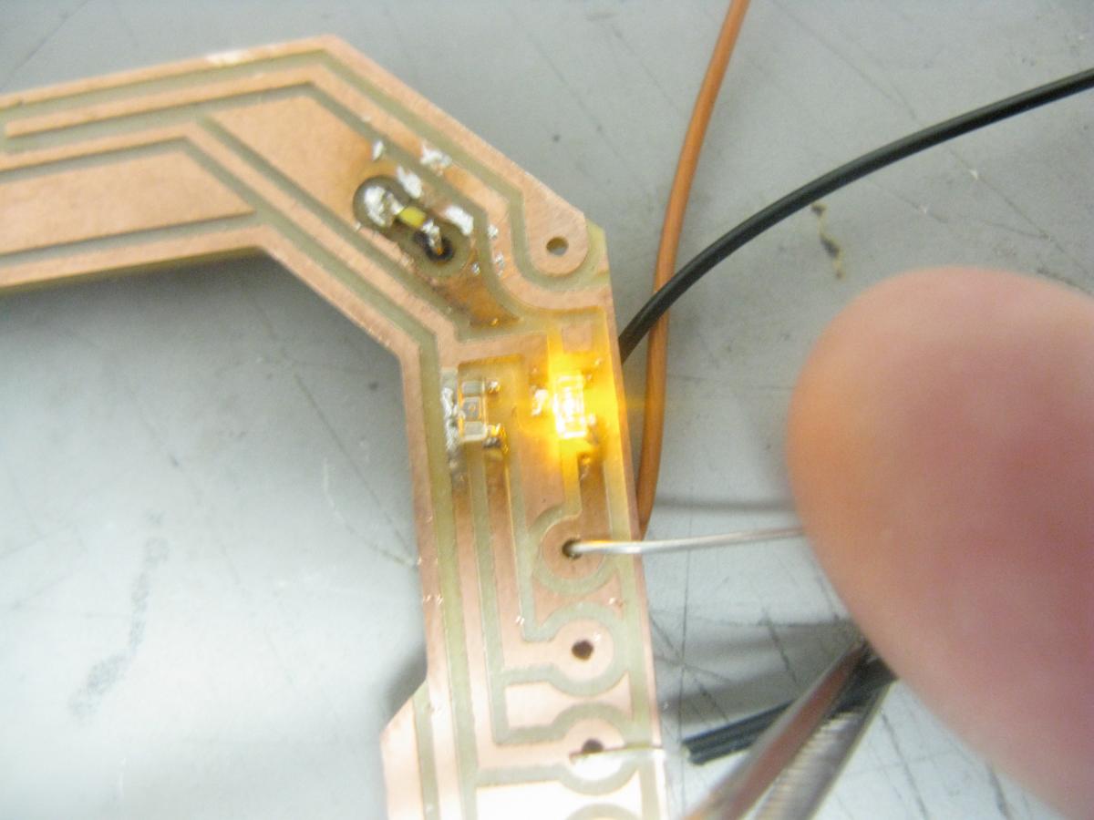

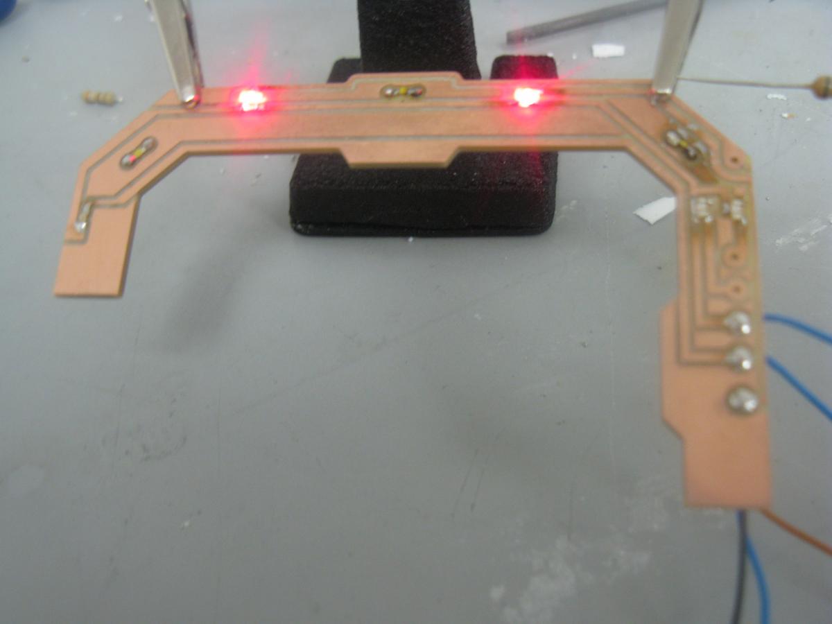

tundrayeti Posted October 1, 2012 Author Posted October 1, 2012 I am always trying to come up with ways to take things up to the next level. Well I have been mulling over this idea of actually making the control panels light up and do some cool effects. Well Here is what I have come up with. I have never done this before, but Using my CNC machine, I fabricated a circuit board using double copper coated plain circuit board you can buy at any radio shack. I made the connections using a very tiny .032 inch endmill. The results came out looking pretty good. Here is what it looked like: Then I soldered SMD LED's to the board and tested them. I will have the tiny flasher chip installed later this week, but as you can see they all work as they should. some will stay lit and some will pulse and flash intermittently. I used the parts from the old control panel to test and see if this will work and it looks good. Once i get a new part made, i will cover the LED's with some tiny graphics that will make this come to life. Quote

EXO Posted October 1, 2012 Posted October 1, 2012 So these are solid copper on a circuit board and you used your CNC to cut the channels for the current? Smart! Quote
tundrayeti Posted October 1, 2012 Author Posted October 1, 2012 So these are solid copper on a circuit board and you used your CNC to cut the channels for the current? Smart! Quote

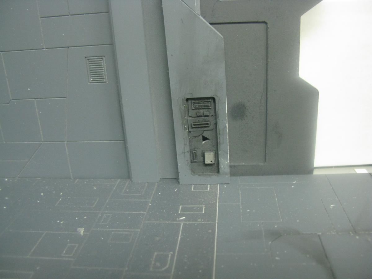

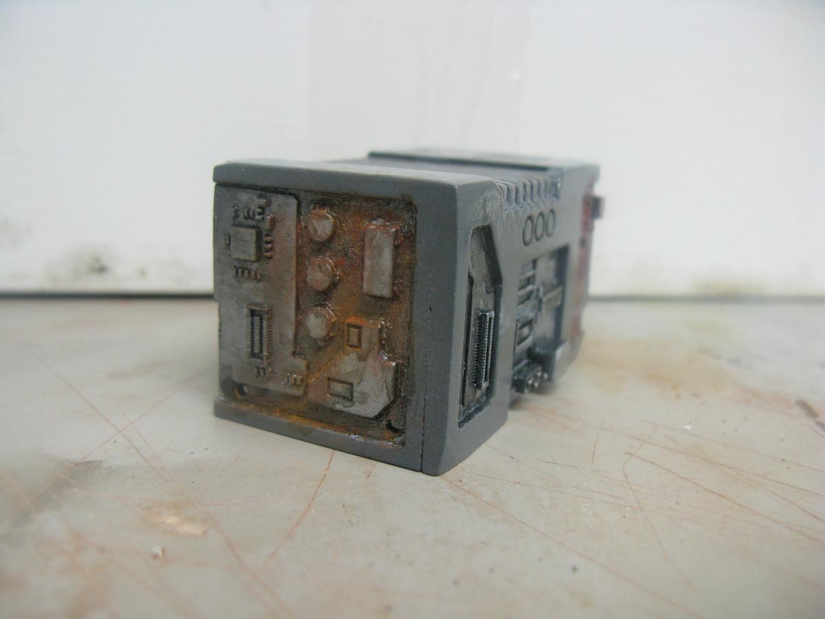

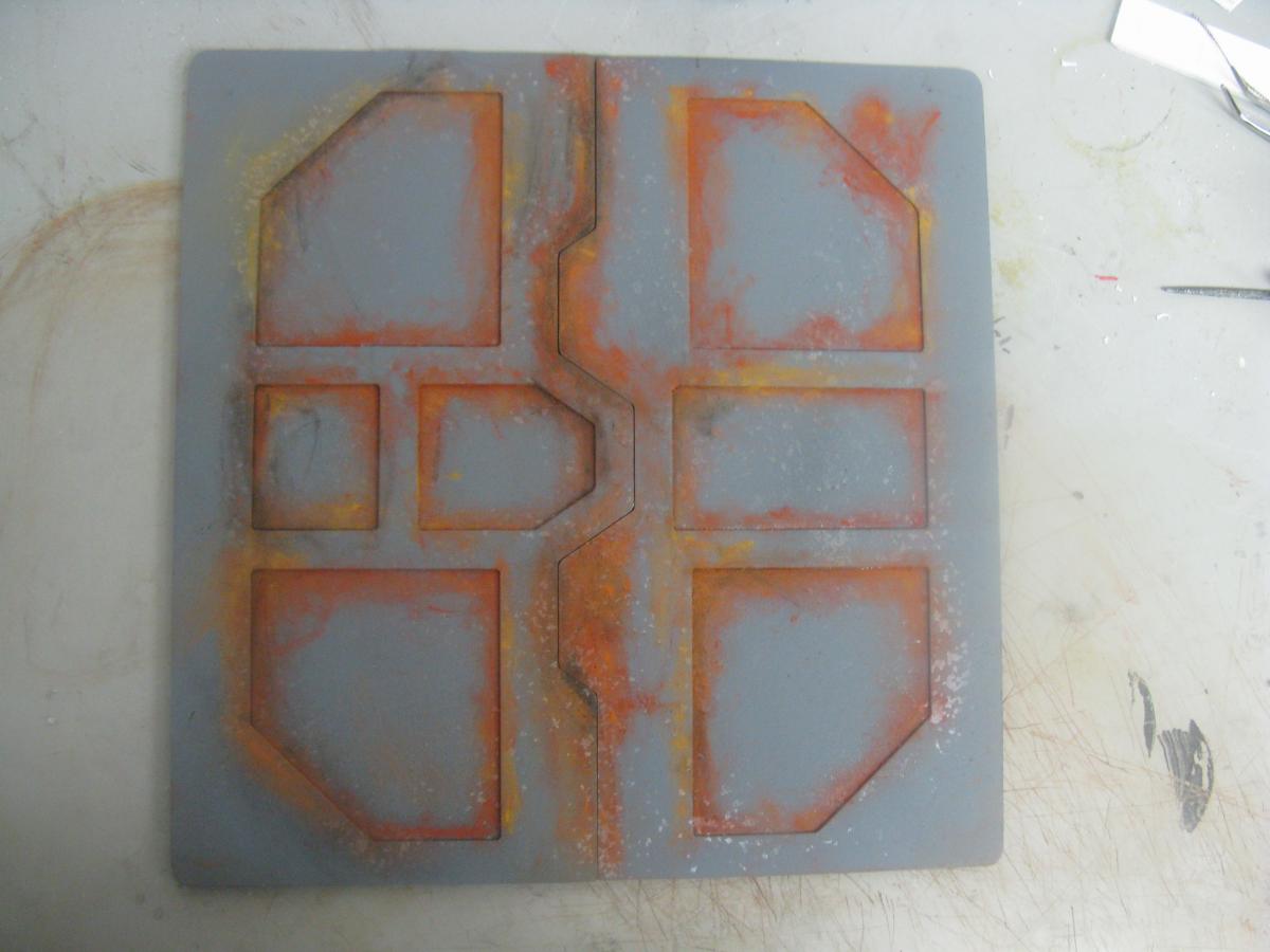

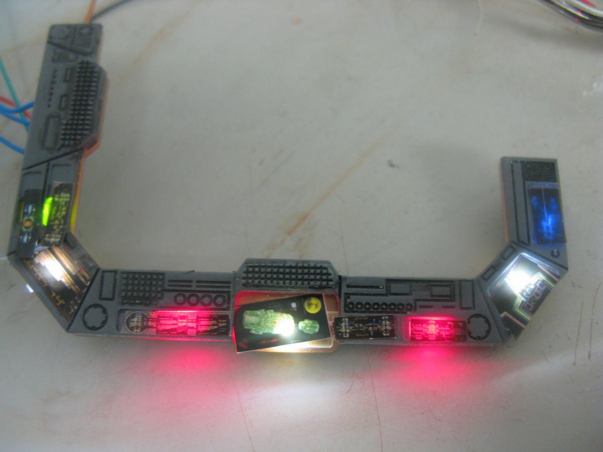

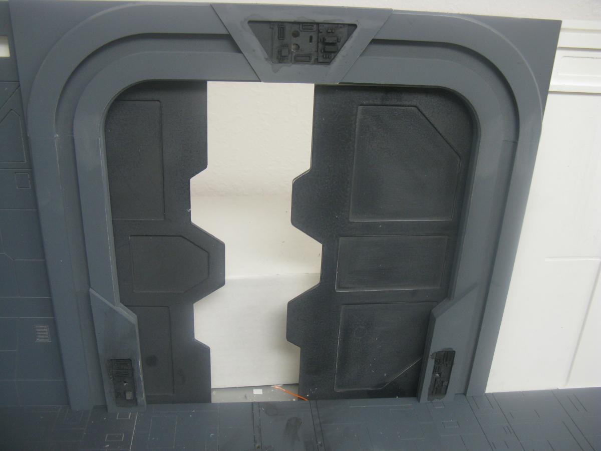

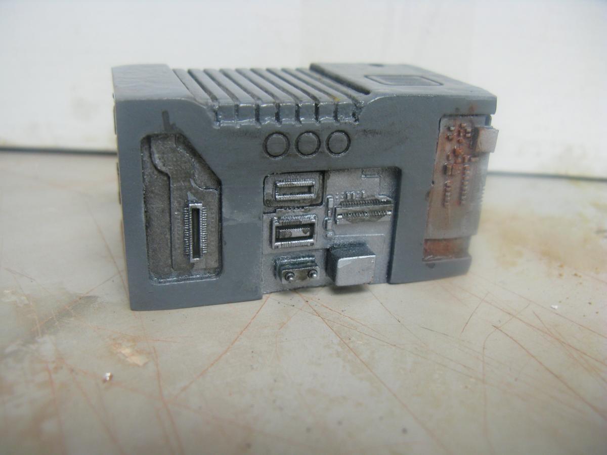

tundrayeti Posted October 11, 2012 Author Posted October 11, 2012 (edited) Latest update. added a microcontroller to the control panel so that it will simulate some activity. I also have some pics of the generator, and the weathered doors. Last pic is of the graphic overlays that will go on top of the LED's to make the screens on the control panel. Let me know what you guys think and enjoy the video. Edited October 11, 2012 by tundrayeti Quote
caslon Posted October 11, 2012 Posted October 11, 2012 I love your weathering job, some rusty effect make it looks real. Please show us the final piece then! Anyway, well done Yeti! Quote
DarrinG Posted October 11, 2012 Posted October 11, 2012 Looking SWEET. Anything that goes in that hanger will have to be weathered now! A super white TV valk would look so out of place. Unless there are a few 1/60 guys painting, buffing and polishing it ( ! ) The movie was a great teaser - anxious to see it all together - nice work. Didn't William Shatner have a great "lights - they're blinking and flashing" quote in Airplane 2 I think? Someone find that clip! Quote
tundrayeti Posted October 11, 2012 Author Posted October 11, 2012 Thanks guys the door will be toned down a bit, The weathering is just the underlay, Now I have to do the salt technique and then a little touch up. Who doesn't love some blinking lights? Quote
