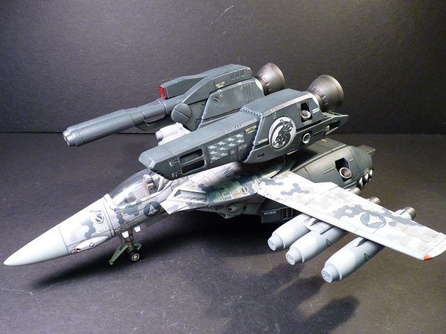

miriya Posted September 4, 2011 Posted September 4, 2011 Let me know what you think. Thanks. Absolutely stunning Kurt! Quote
Old Man Posted September 4, 2011 Posted September 4, 2011 (edited) OMG!!! Blue Roses, here I come! By the way, beautiful job, Kurt. You've outdone yourself once again. Edited September 5, 2011 by Old Man Quote

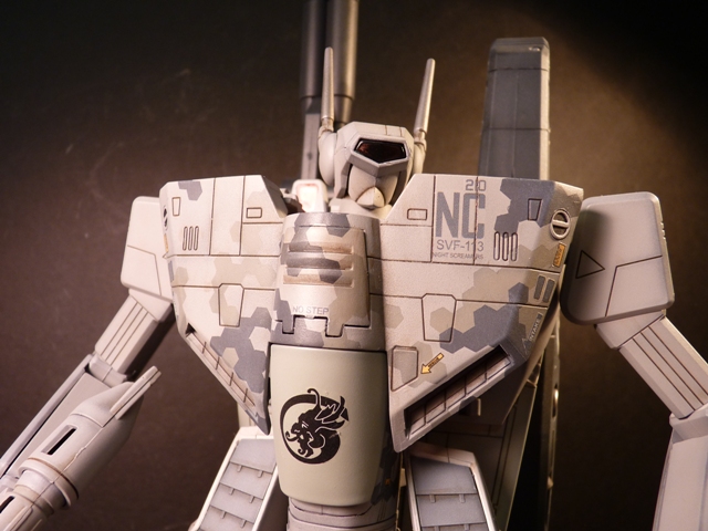

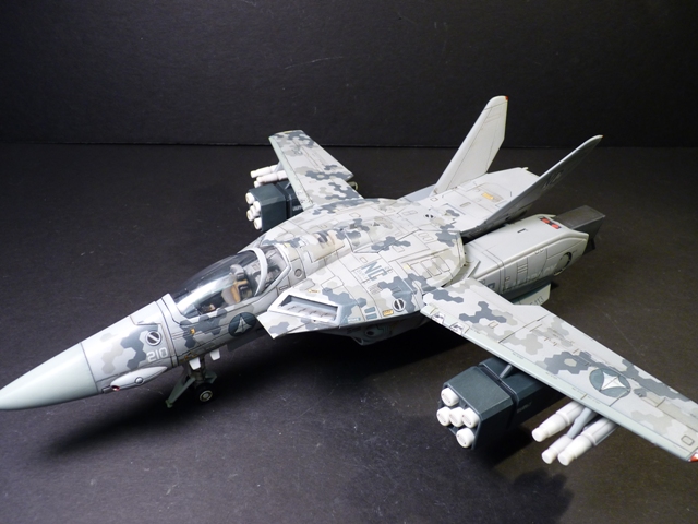

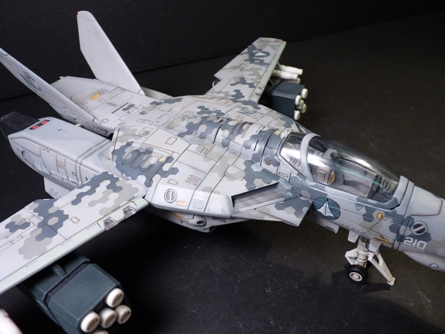

PetarB Posted September 7, 2011 Posted September 7, 2011 That's fantastic! How did you do the hex pattern? Quote
Ignacio Ocamica Posted September 7, 2011 Posted September 7, 2011 That's fantastic! How did you do the hex pattern? Always wanted to ask the same. By the way, jaw dropping custom!!! Quote
Kurt Posted September 7, 2011 Author Posted September 7, 2011 That's fantastic! How did you do the hex pattern? Well I struggled a bit to come up with a good way to do it. Way back when Jung had shared that he modified a hole punch with a piece from an allen wrench. Played around with that but could not get a nice clean cut. I searched high and low praying someone made a hex shaped hole punch. No such luck, in this size anyway. So what I finally settled on was taking a section of brass hex shaped tubing. You can find this size at any hobby shop. I then ground the sides to make it as sharp as I could without thinning it too much. I then layered some tape on a wood cutting board and proceeded to punch the hex tubing into the tape. You can only do 3-4 layers at a time to get a clean cut. Then you have to peel each hex shaped piece of tape off the board and place on the valk. Not difficult, just tedious. There may be a better way, but that is what I came up with without spending too much time on a solution. Quote
