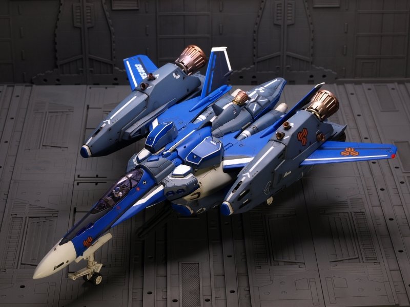

I remember there was another amazingly skilled builder from Japan who made an Armored S, a Super G, and what not. His models were fully painted, with subtle weathering and fully transformable. He took photos quite professionally too, with lighting that accentuated contours, with a backdrop of Gundam walls and floors. I also seem to remember it was on Yahoo.jp.
unfortunately I only have the one picture and I don't remember where it came form other than seeing it in one of the older VF-25 model kit threads.
