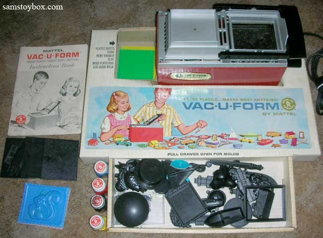

Model-Junkie Posted October 2, 2015 Posted October 2, 2015 Mattel released a Vac-U-Form machine and I actually acquired one a couple of years ago. Its a neat machine and has certainly held up well over the last few decades. There are even companies out there who make replacement parts for it. I used it as a starting step and moved onto custom made vacuum-form tables for larger pieces. Quote
MechTech Posted October 2, 2015 Posted October 2, 2015 (edited) That video was groovy baby (background blues music :^) Yeah, like that machine. That's cool Model Junkie! I like what they said, "would probably not be sold today due to safety regulations." I would have LOVED that as a toy! It's going down a rabbit trail, but I had a similar one that heated up to make rubber monsters and then re-cube them up again http://www.snowcrest.net/fox/str.html - MT Edited October 2, 2015 by MechTech Quote

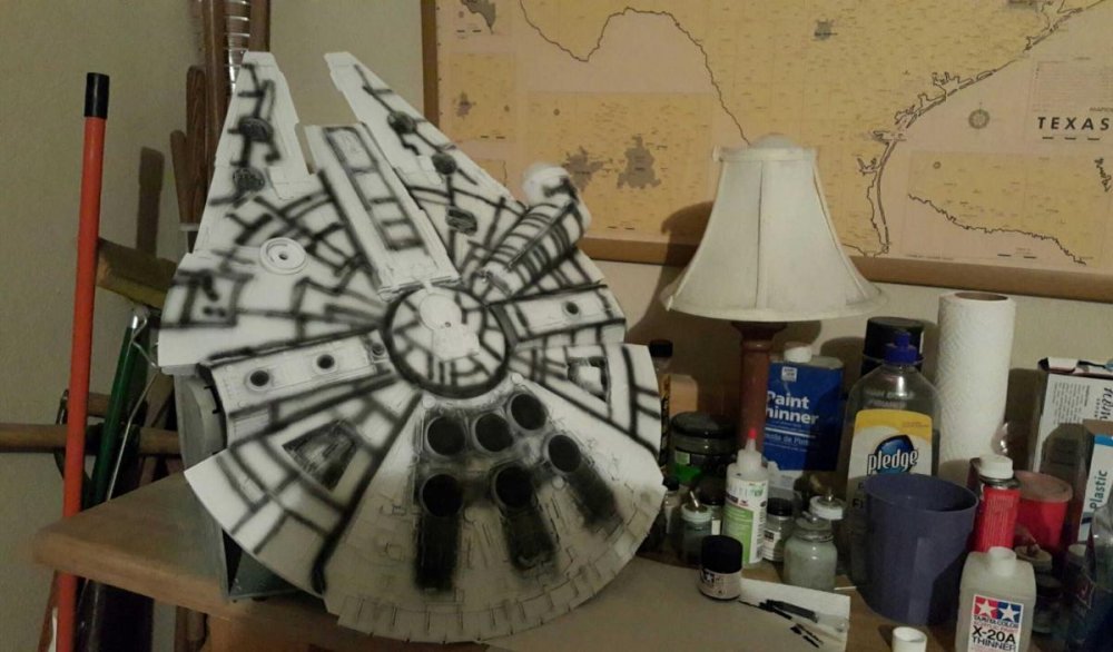

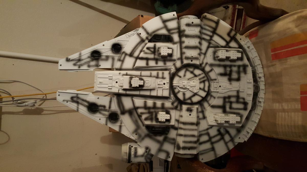

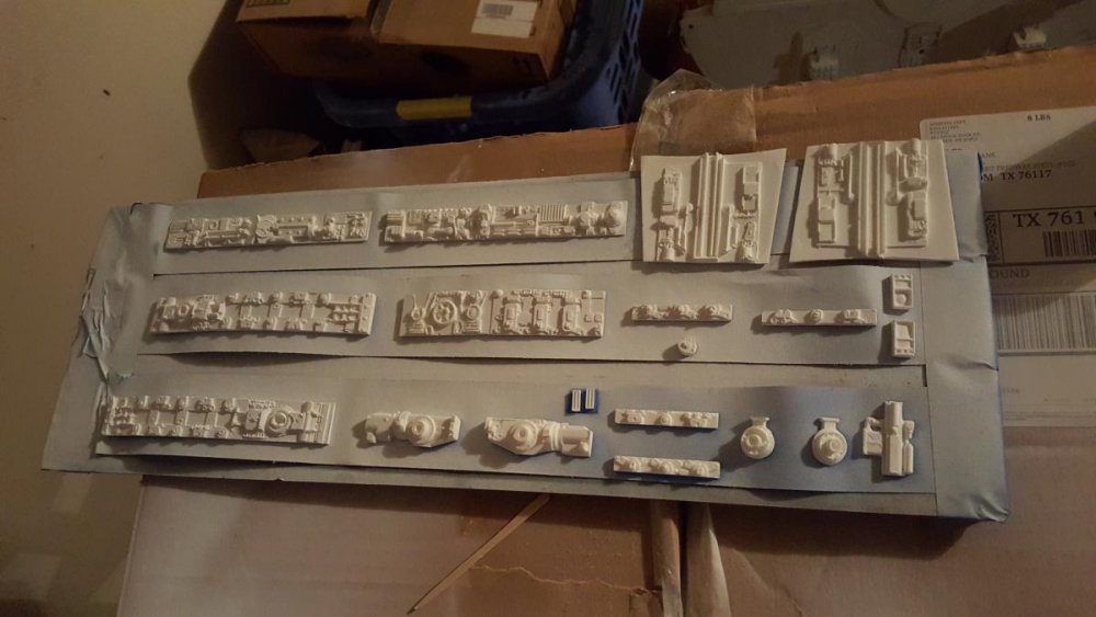

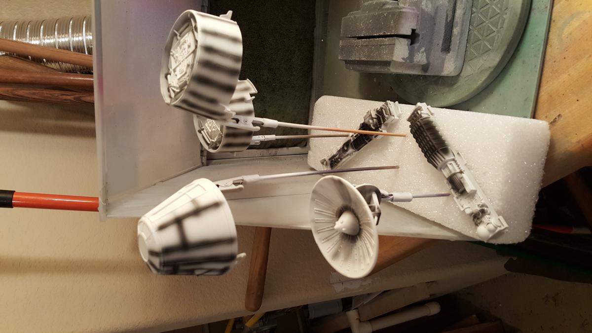

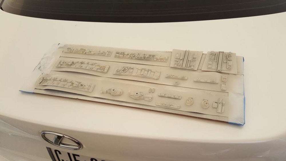

derex3592 Posted October 3, 2015 Posted October 3, 2015 (edited) Resin sidewalls from a great guy over at the RPF came in this week, and since the weather is freakin gorgeous this evening for the first time in like ever....it's a Friday night party at the pre shading paint bench! It doesn't quite fit in my spray booth....but anyways!!! Edited October 3, 2015 by derex3592 Quote
spanner Posted October 3, 2015 Posted October 3, 2015 hey Derex, so how does that pre shading process or technique actually work? You then paint over it and those pre colored areas show up darker? Is that like a form of panel lining? Pardon my ignorance! Quote
derex3592 Posted October 3, 2015 Posted October 3, 2015 That's basically it yeh, just gives a darker, dirtier look to the areas after a base coat goes down. Which hopefully will happen tomorrow. Quote

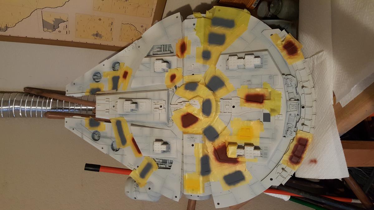

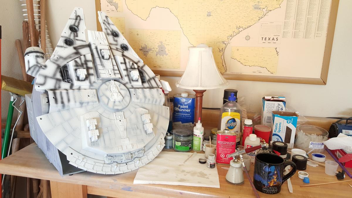

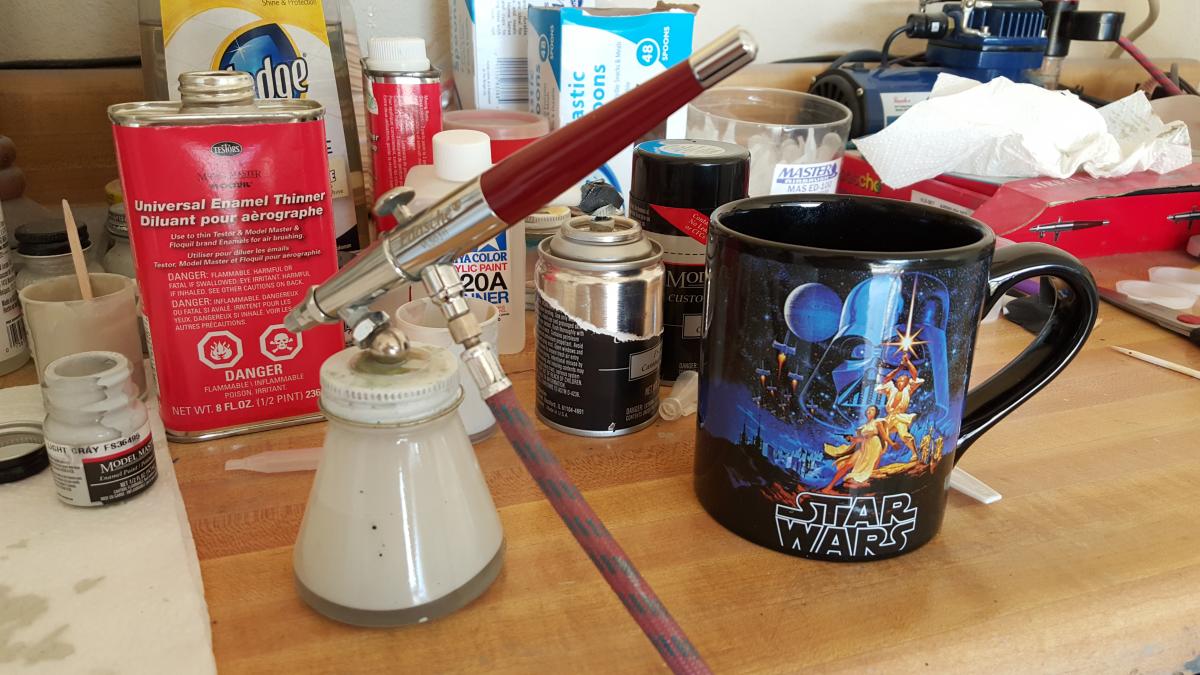

derex3592 Posted October 4, 2015 Posted October 4, 2015 and so you shall.....right now! 2 hours of decanting Camouflage Grey because it is NOWHERE in bottles anymore, mixing with Light Grey in bottles and had to break out the old Paasche with the BIG bottle and the BIG needle #5 for this bad boy! I think it came out pretty darn good. God this things...big...LOL. Hindsight being 20/20 I should have just used all spray paint and decanted, then I wouldn't have had to mix at all. Oh well. I didn't cover up as much of the pre-shading as I did on my Finemolds so this go around I think it will show through better in the end..hopefully. Onwaaaards! (can you tell I just wanna knock this out quick, get paid, and get back to my stuff?) Quote

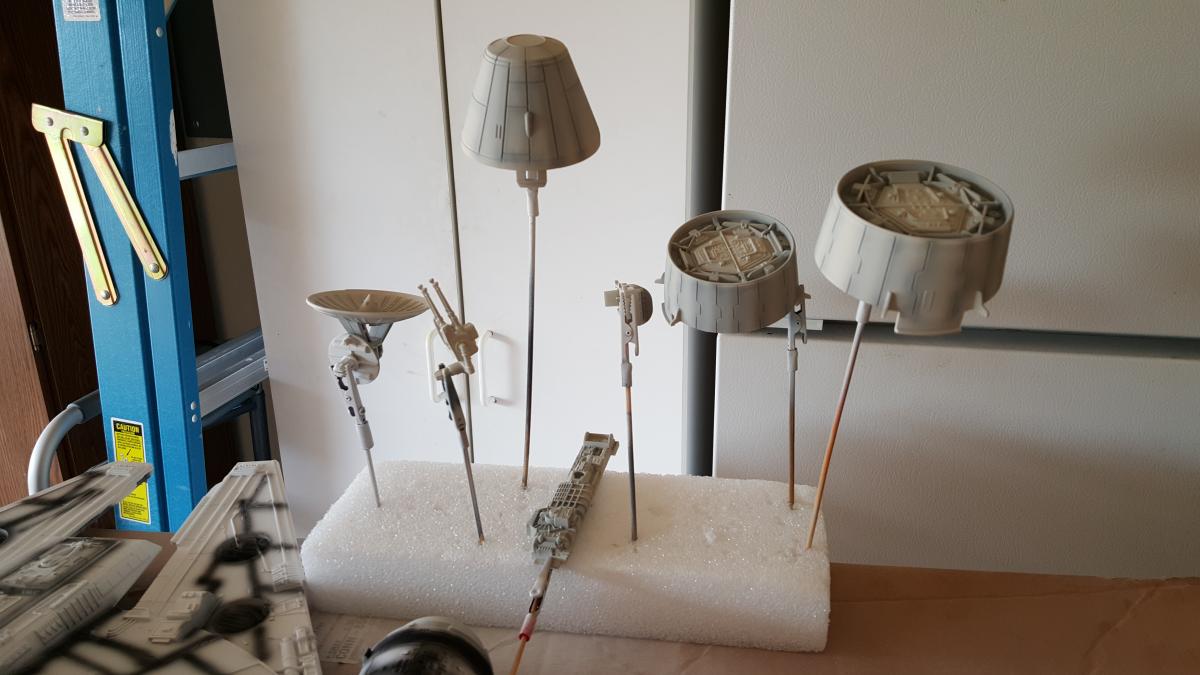

derex3592 Posted October 5, 2015 Posted October 5, 2015 We'll see how it ends up! I'm nervous to work on other people's stuff, I know if I screw mine up, I'm the only one who has to look at it! In other news, I built a head today! I know I've said this before, but I'll say it again, these Bandai SW kits are just the business! So well designed, all snap fit and I'm not even gonna bother painting the figure ones I don't think! They look fine straight out of the box. The attention to detail is also present, for example, the eyes are not just black, you can't tell, but that peice was clear dark green. Very impressive. Quote
Thom Posted October 5, 2015 Posted October 5, 2015 Great work on that MilFalcon! The preshading shows through nicely. Quote

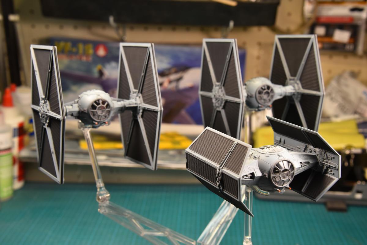

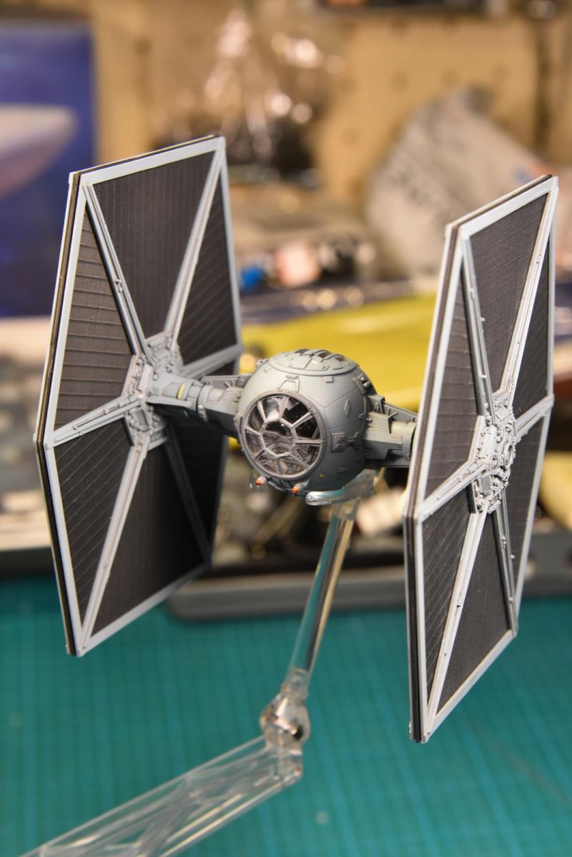

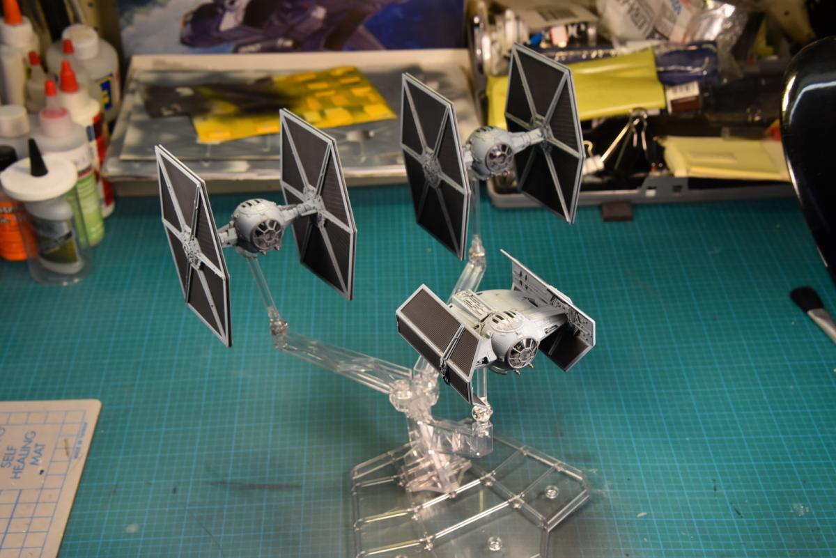

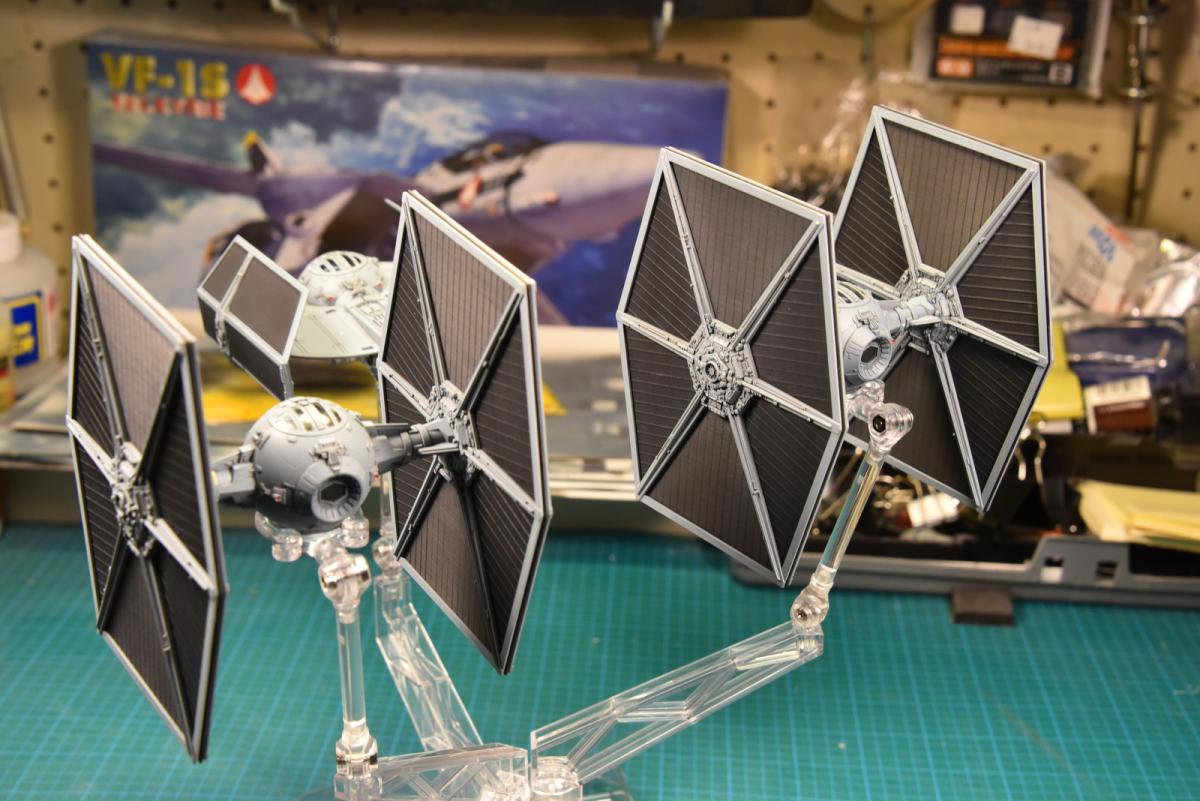

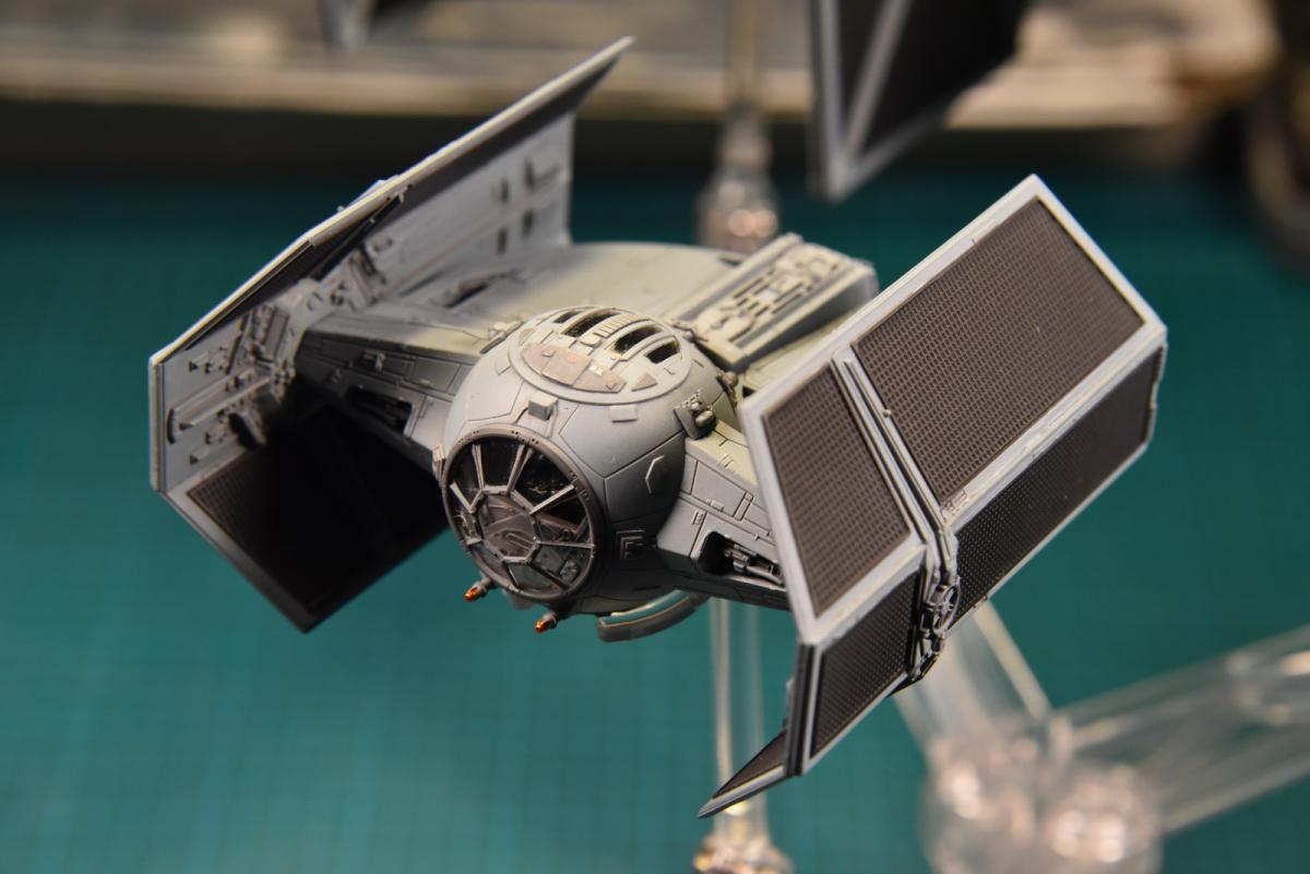

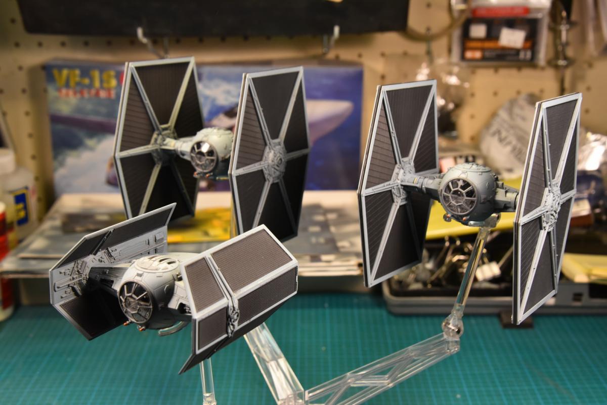

wm cheng Posted October 8, 2015 Posted October 8, 2015 (edited) Jumping on the Star Wars bandwagon! This is what I've done with my last few weeks off. They are the FineMolds 1/72 Tie Fighters - this is what I had envisioned when I first saw the Bandai Trident stand, so I kind of got the stand first, then bought the models to go with the stand (ass backwards!) a few years ago. After getting the amazing Bandai Y-Wing fighter recently, I thought I'd build these first to get myself back into the hang of building models. I've been out of the game for a while, just weathering and detailing toys for the last few years. It was a sobering experience. They are pretty incredibly detailed models for such a small scale (my last Star Wars model was the 70s MPC/AMT X-Wing which had to modify extensively which turned me off Star Wars models for a while). I highly recommend them, don't know what they're like compared to the new crop of Bandai Tie Fighters though. The Tie Fighters are by far the best kits I've built in a while (beautifully detailed, great hiding of seams and easy paint masking), while the Advanced Tie (Darth Vader's tie fighter) wasn't as well engineered as the original tie fighters - masking the black panels on the solar wings was indeed a pain! p.s. Oh, a bit of advice, you can hardly see any cockpit details after you're finished (I spent so much time detailing and carefully painting the cockpit) Edited October 8, 2015 by wm cheng Quote
