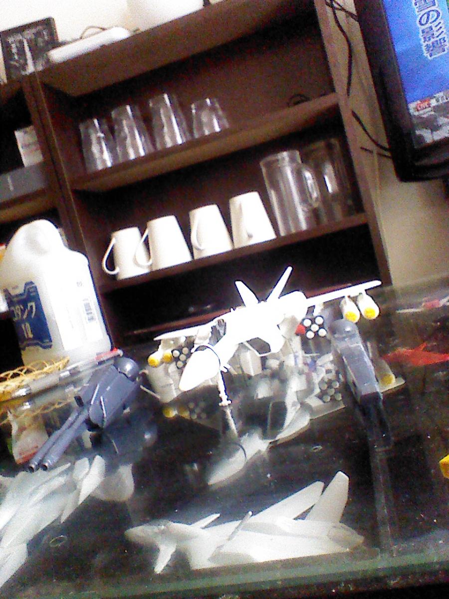

CrazyDude Posted February 15, 2014 Posted February 15, 2014 Snow day today, 2nd heavy snow day in one week. Had to shovel in front of my apartment. Decided it is a Macross day, will pull my Bandai 1/72 VF1-A/S Strike and take apart and fix/glue it into Fighter mode. Will share a base with the EggPlane Strike Valkyrie in same colours. Kinda fetish for me to add a super-deformed version. I can do small detail hand painting at the table showen but mostly assembly, putty and cleanup. Quote

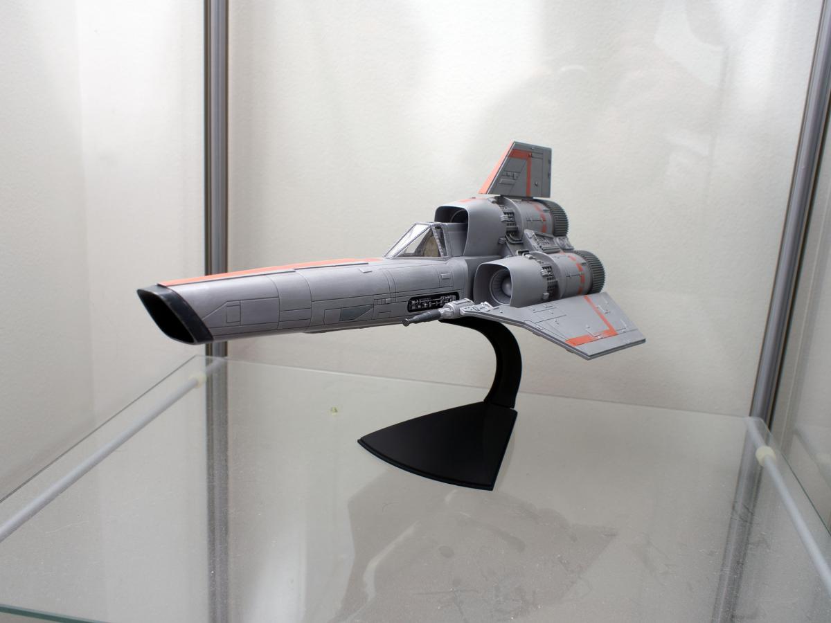

VF-19 Posted February 18, 2014 Posted February 18, 2014 Just finished the Mk 1 Viper from Battlestar Galactica. It's a great kit, and it went together fairly easily. Two complaints, the wings should be a separate construction, like the vertical tail. This is easily fixed by modifying the tabs that hold the wings to the engines. The other has to do with the engine cans. It should be 4 pieces. The 3 tailpipes, and the central piece. This would make painting and detailing much, much easier. Otherwise, I had fun building this! Quote

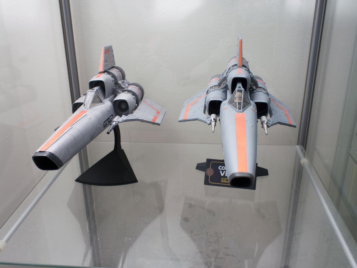

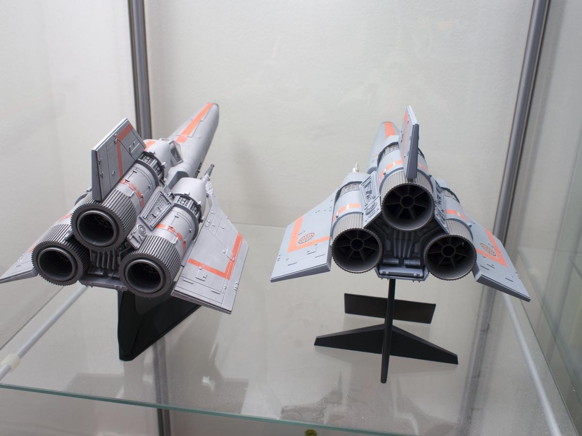

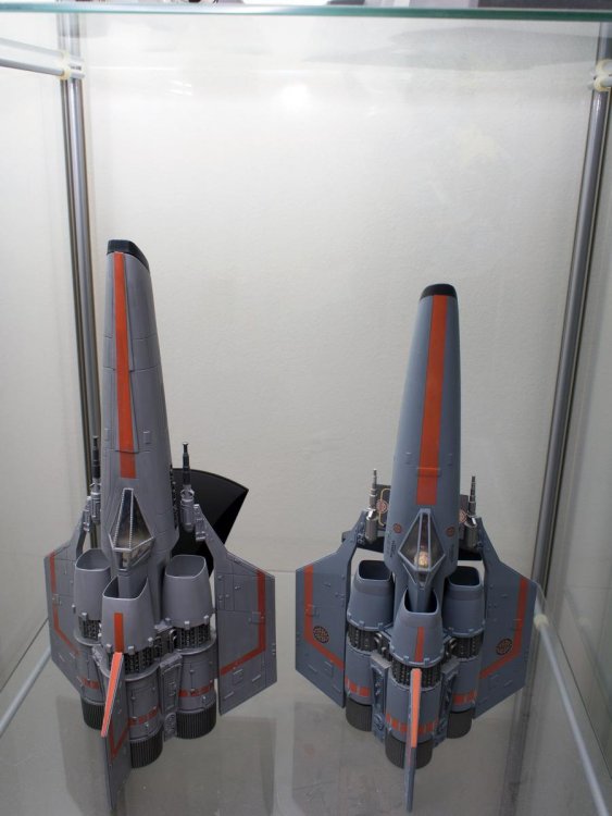

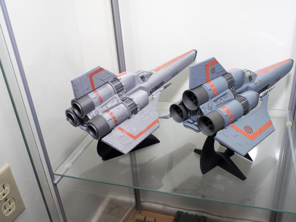

VF-19 Posted February 19, 2014 Posted February 19, 2014 Good to know, I might have to get one! Post some more pics of it if you have time. I can do one better! Side by side comparison of the original viper kit that was re-released with a clear canopy and a pilot (who I did build into it). I did paint the original kit in a much too dark shade of grey, this time I went with Tamiya's Sky Grey, which works out nicely. The new one is significantly larger than the original kit, and looks much better out of the box. I did, however, not install the grey striping on the engine intakes as they broke on me. I was totally expecting the thin orange markings to tear on me, which to my surprise, didn't. I really should finish my Mk 2 and Mk 7 Vipers, along with my classic raider and new raider. Quote

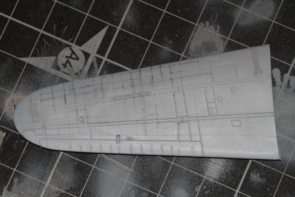

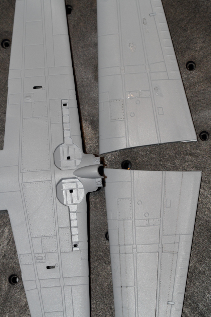

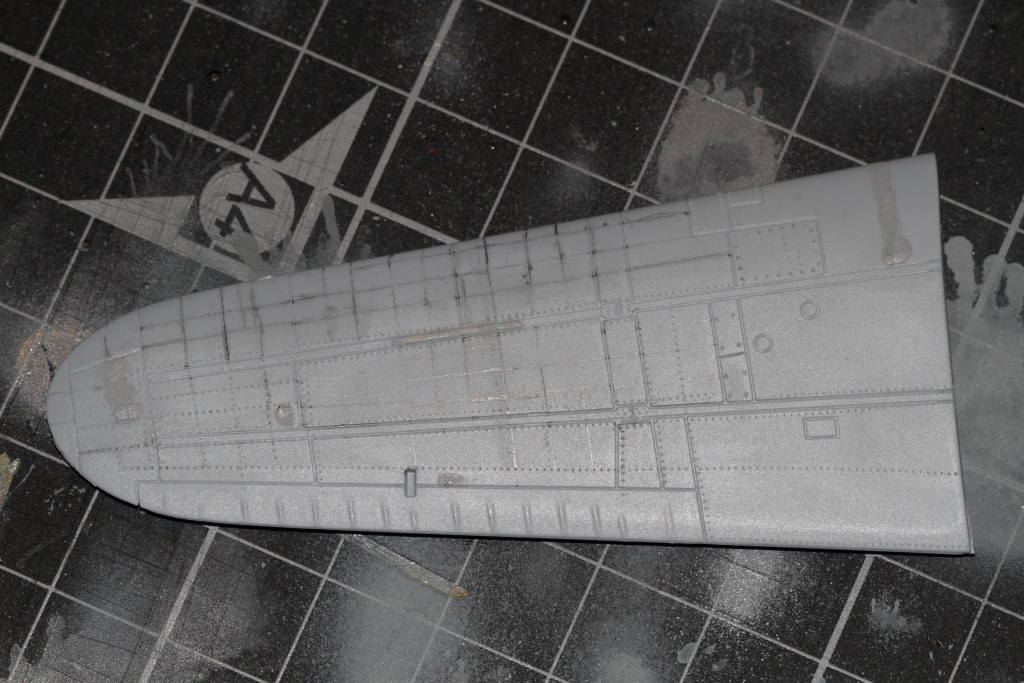

mickyg Posted February 19, 2014 Posted February 19, 2014 I'm a riveting fool: The first one is how I started this little "detailing" project. The second is the madness that I'm currently up to as of last night. By last count, it's going to take something like 6 hours for me to do all the fastener details. I'm a sick, sick individual... Quote

Dobber Posted February 19, 2014 Posted February 19, 2014 That fantastic Micky! Did you use a rivet wheel tool? Chris Quote
mickyg Posted February 19, 2014 Posted February 19, 2014 I've been learning to use the el cheapo trumpeter riveting tool, to be exact. It doesn't roll well if you apply too much pressure (tends to slip, hence the "corrections" you may notice in the pics) and the holes are a bit square. But I think it's far better than nothing at all and I'm certainly getting the hang of it the more I use it. It's worth noting that the fasteners on the real thing are a lot closer together and much finer as well. But like I said, to me, some that aren't accurate, is better than nothing at all. Quote
505thAirborne Posted February 19, 2014 Posted February 19, 2014 The detail on Moebius VIPER is amazing IMO, I think you nailed it with the shade of Gray and orange. Its the one downside I've had too with these kits and thats the decals, some are really good and others just fall apart. Get cracking on those MKII's & VII's!! @mickyg, that is some serious detail you're putting into that kit, and your not sick, sick individual. Demented maybe but not sick! Quote
VF-19 Posted February 20, 2014 Posted February 20, 2014 Thanks! One other thing I don't really care for is the stand. It's a bit wobbly, and I cared even less for the landing gear... So wobbly stand it was! I liked the re-issue stand a whole lot more, especially since it came with a decal to identify what it was. Quote

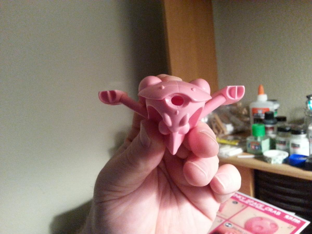

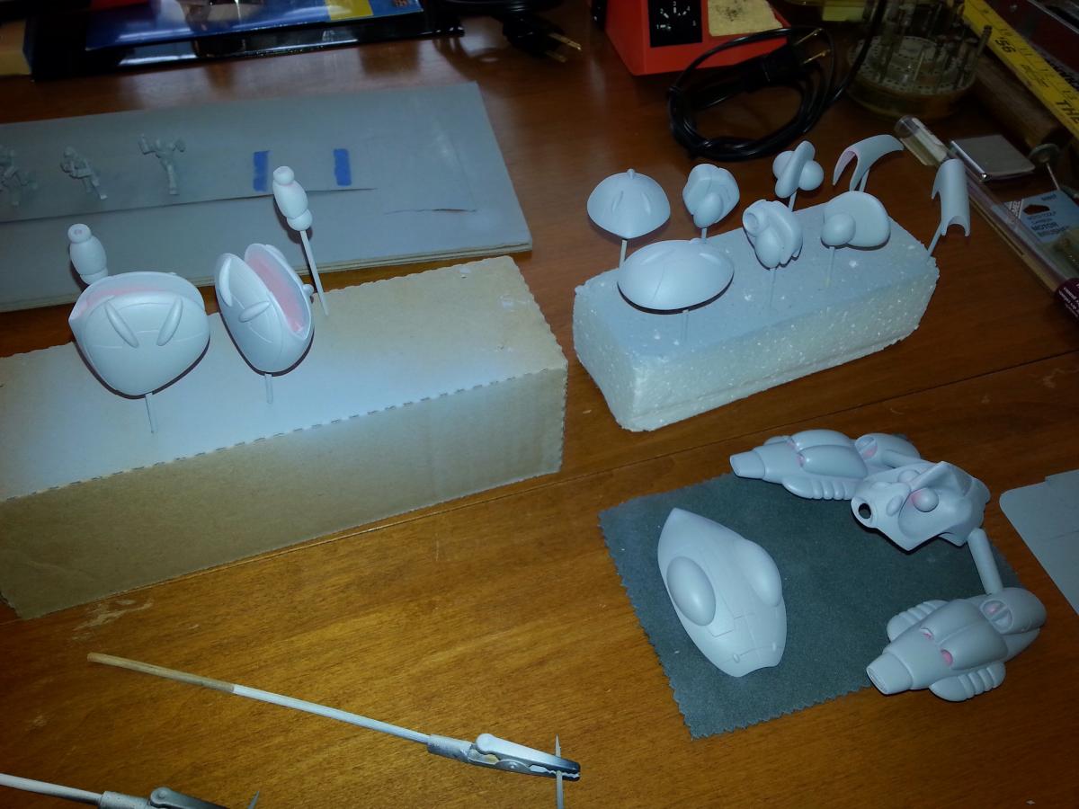

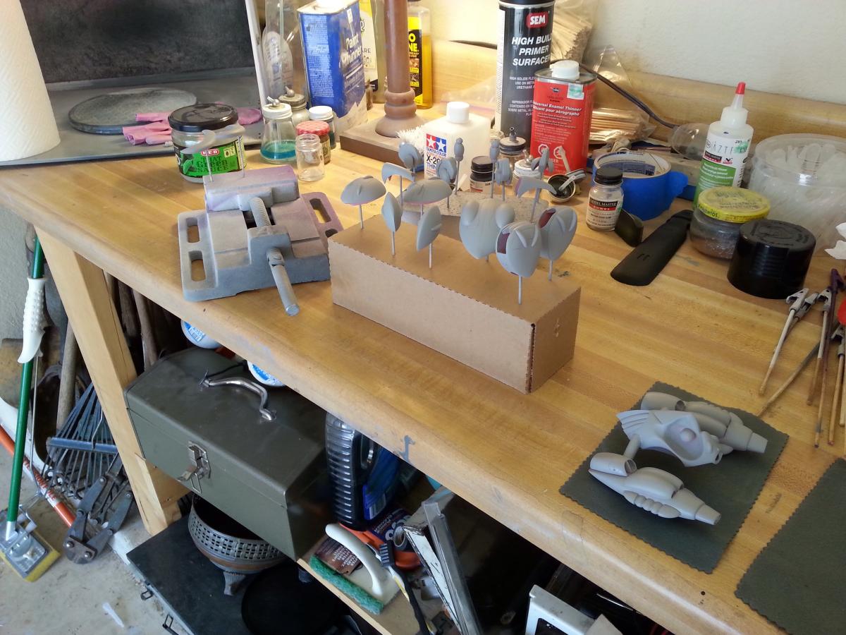

derex3592 Posted February 22, 2014 Posted February 22, 2014 I'm moving my in progress updates to here from the original thread. Weather and work schedule finally cooperated today and I got my Pinky Space Crab #1 primered! Quote

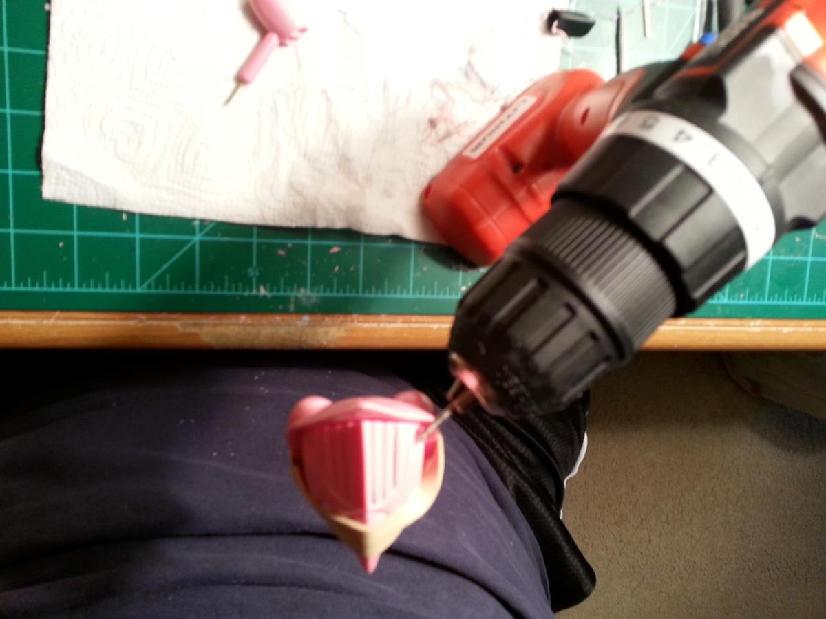

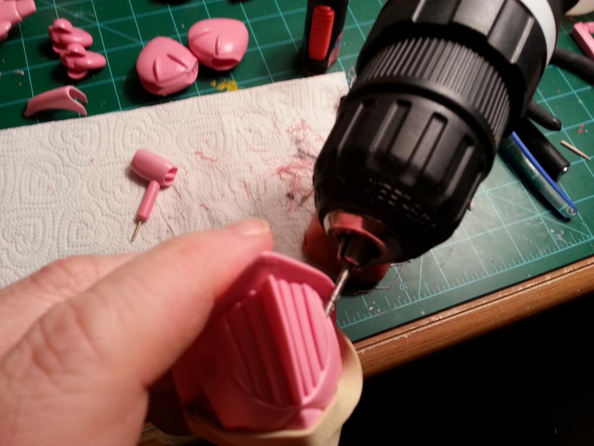

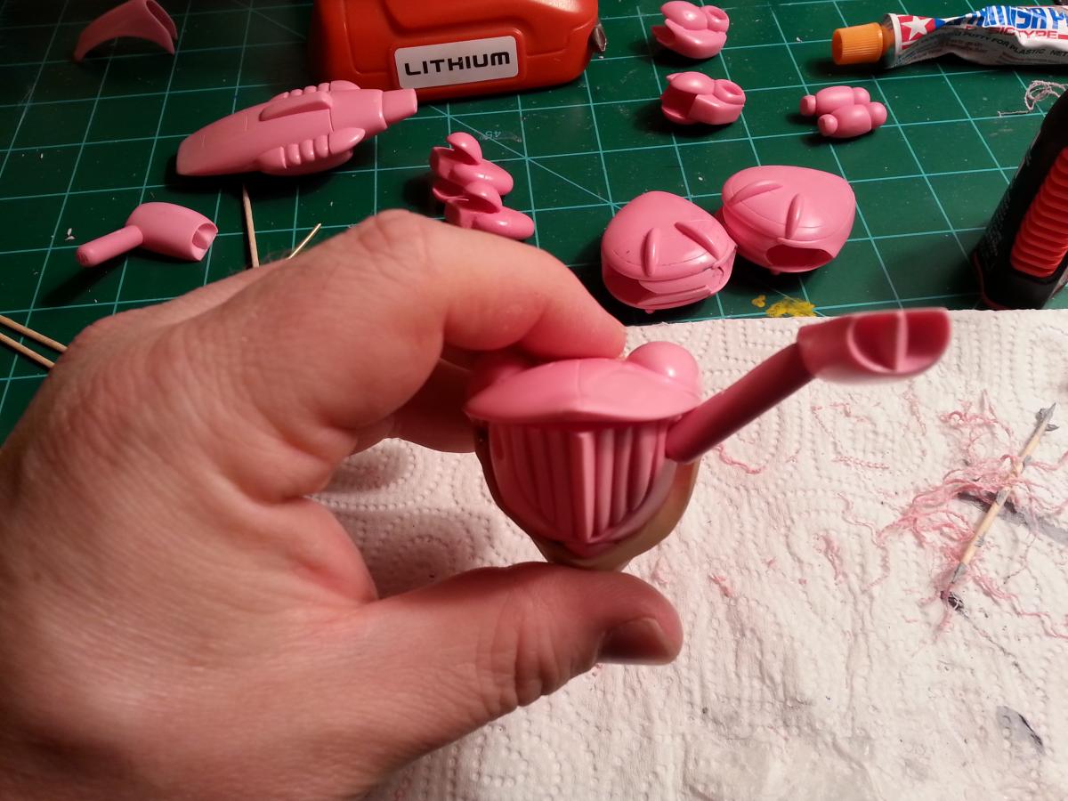

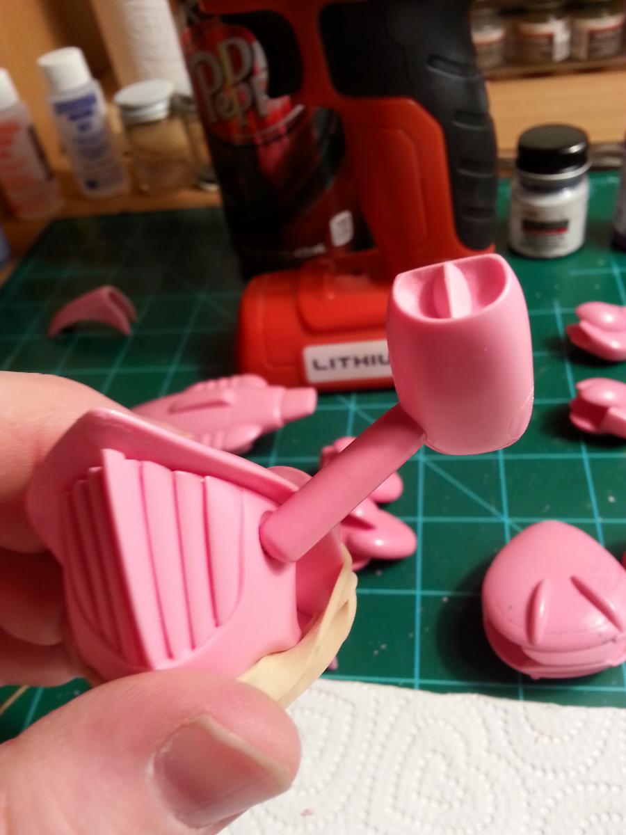

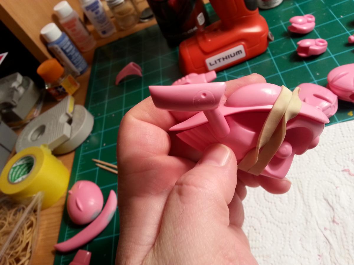

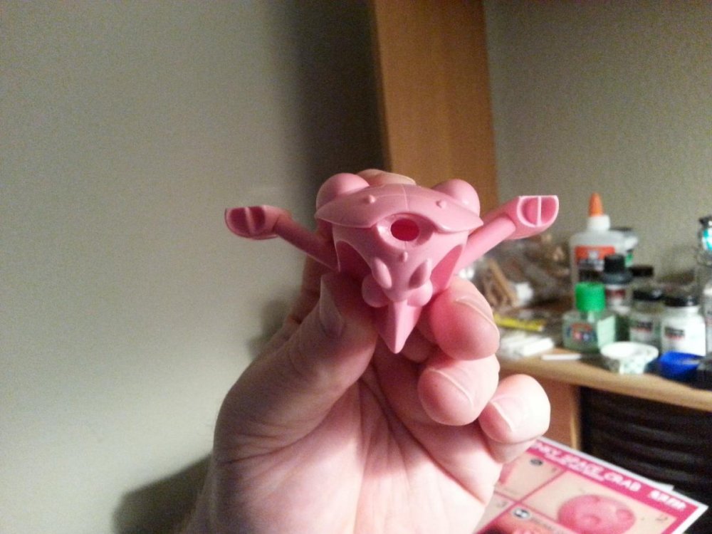

derex3592 Posted February 23, 2014 Posted February 23, 2014 Ok...this is for anyone building Captain Americas Pinky Space Crabs..My first crabs cannons did not end up level because I took the wrong approach to mounting them...I suggest trying this method, which I thought of for Crab number 2 -- which will have straight-er cannons! If anyone has any questions, please feel free to PM me about the method but I think the pics are pretty self explanatory. Quote

coronadlux Posted February 23, 2014 Posted February 23, 2014 Me either. I gotta stay on top of things. Great work on the pinky space crab derex. I can't wait to see it all finished. Quote

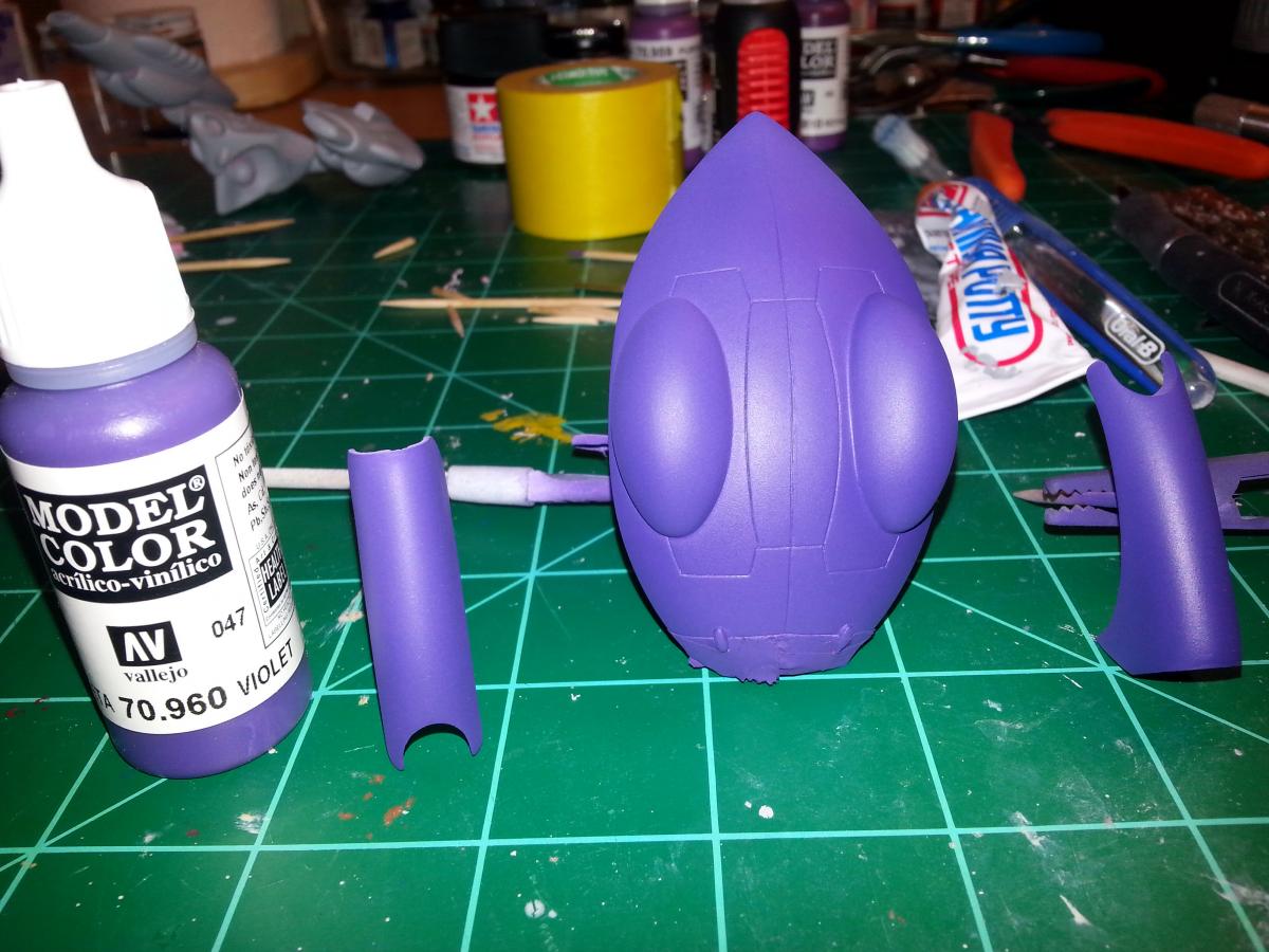

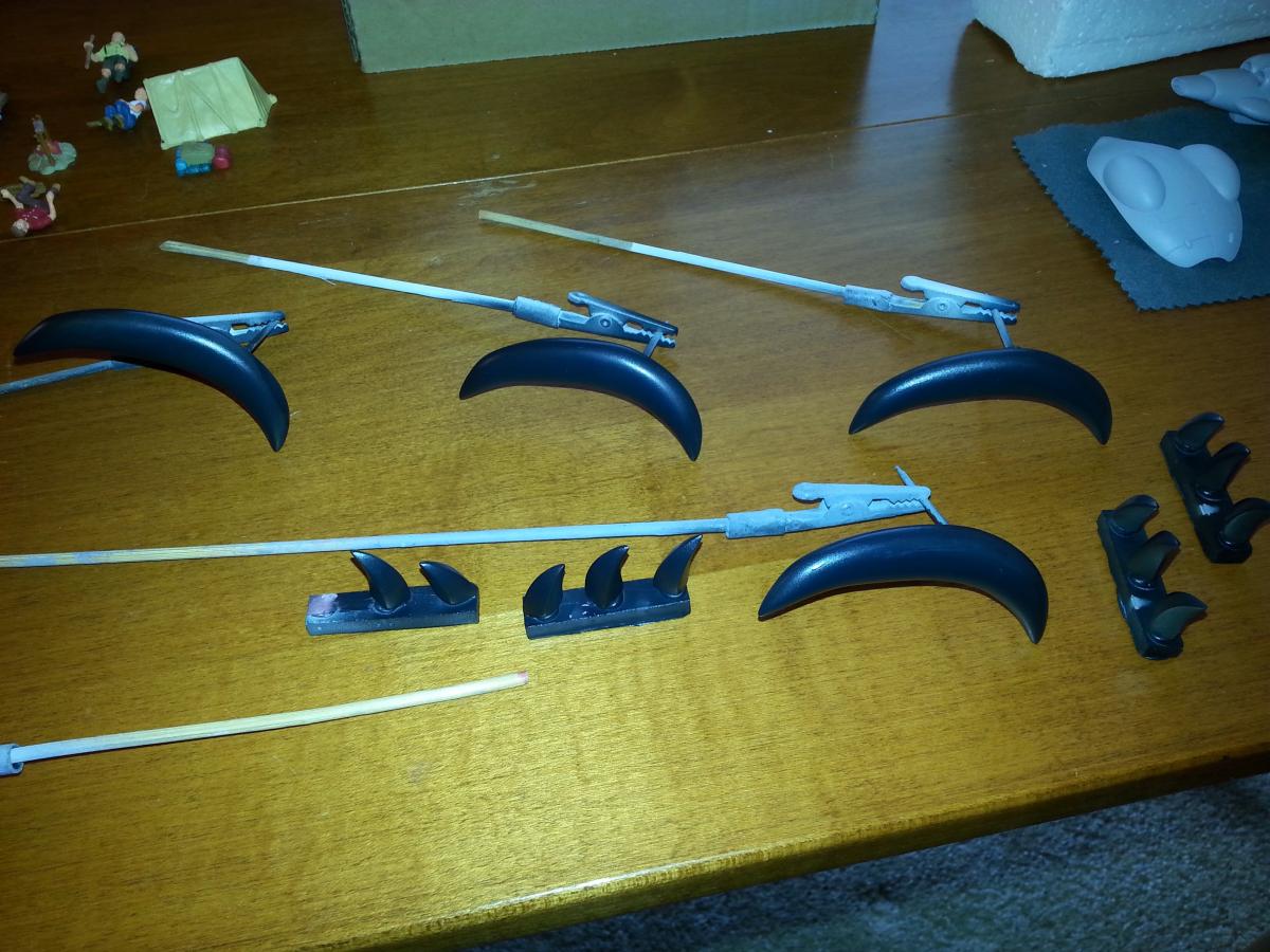

derex3592 Posted February 24, 2014 Posted February 24, 2014 (edited) Good progress today! Crab #2 primered and feet/claws for both painted with Model Master Gun Metal and finally....some Vallejo Violet has been layed down! Edited February 24, 2014 by derex3592 Quote
MechTech Posted February 24, 2014 Posted February 24, 2014 Some AWESOME stuff on the bench guys! The Ghost scribing and Crab paint do look great! - MT Quote
