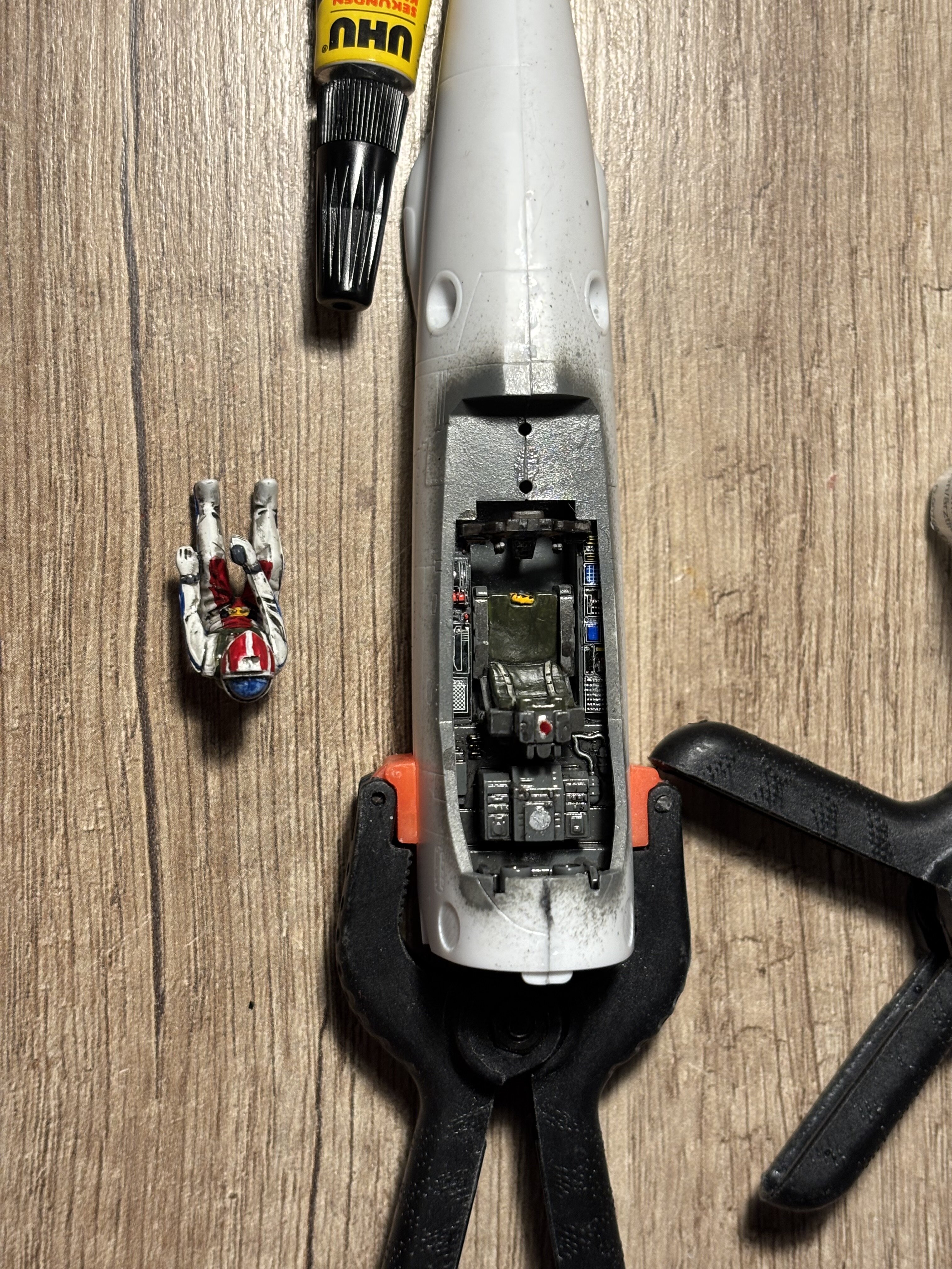

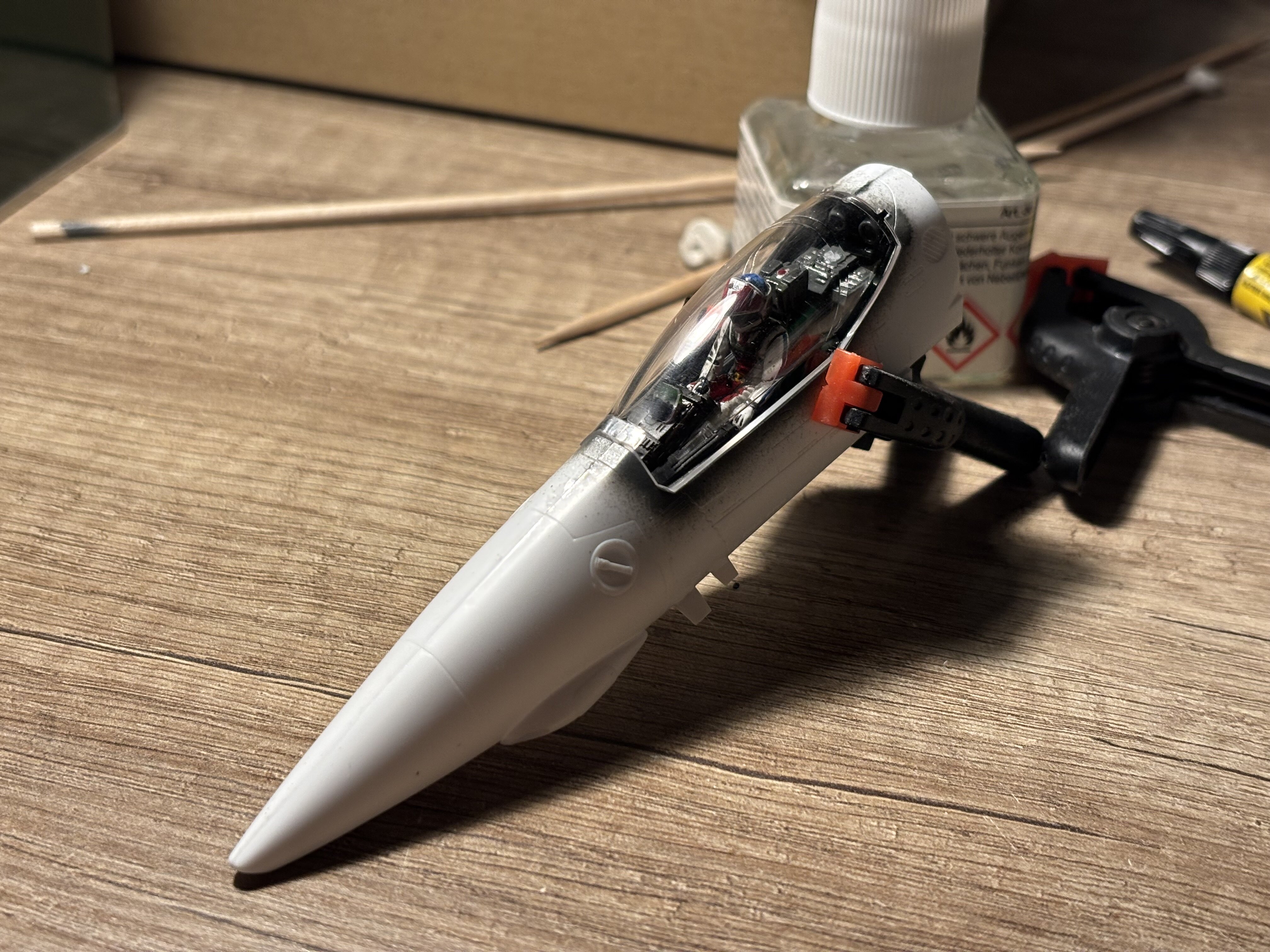

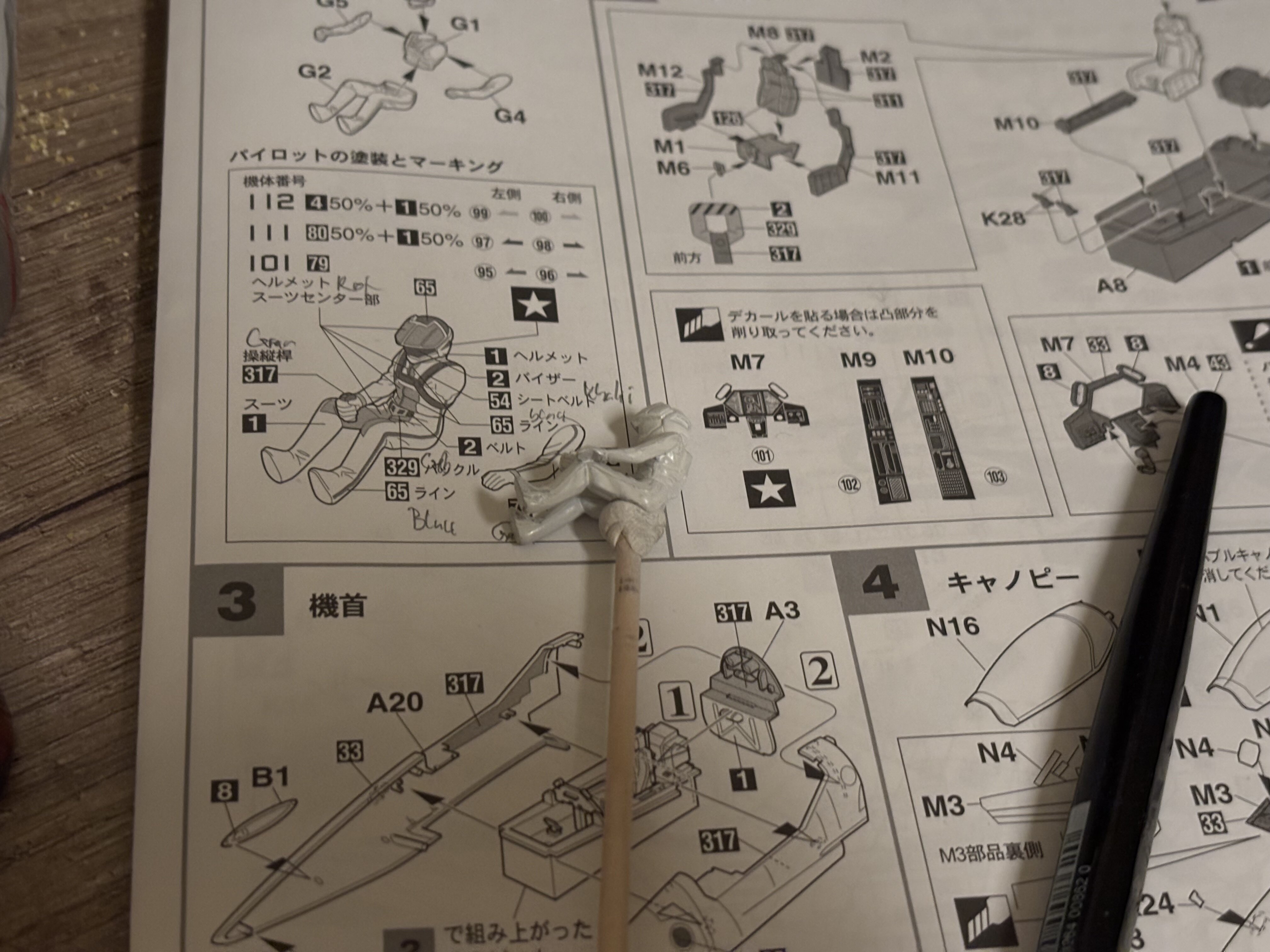

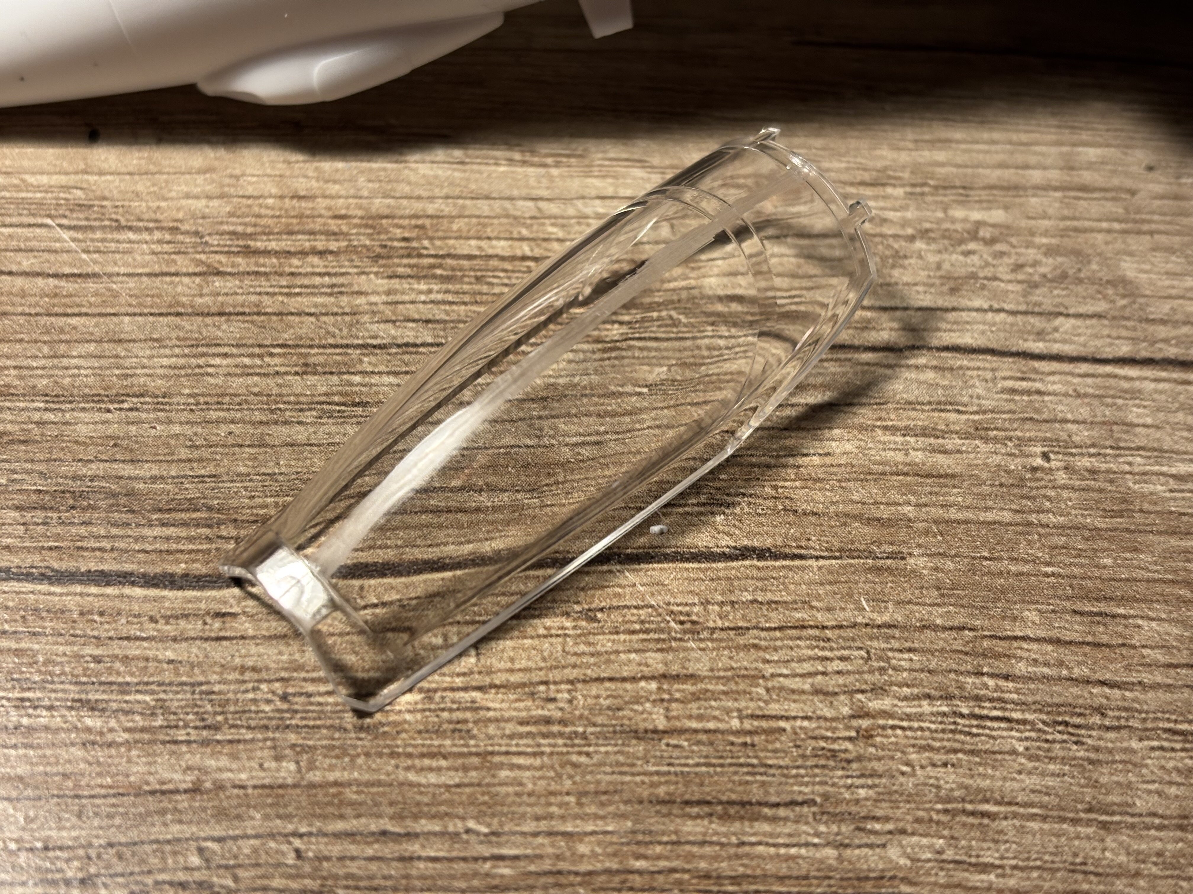

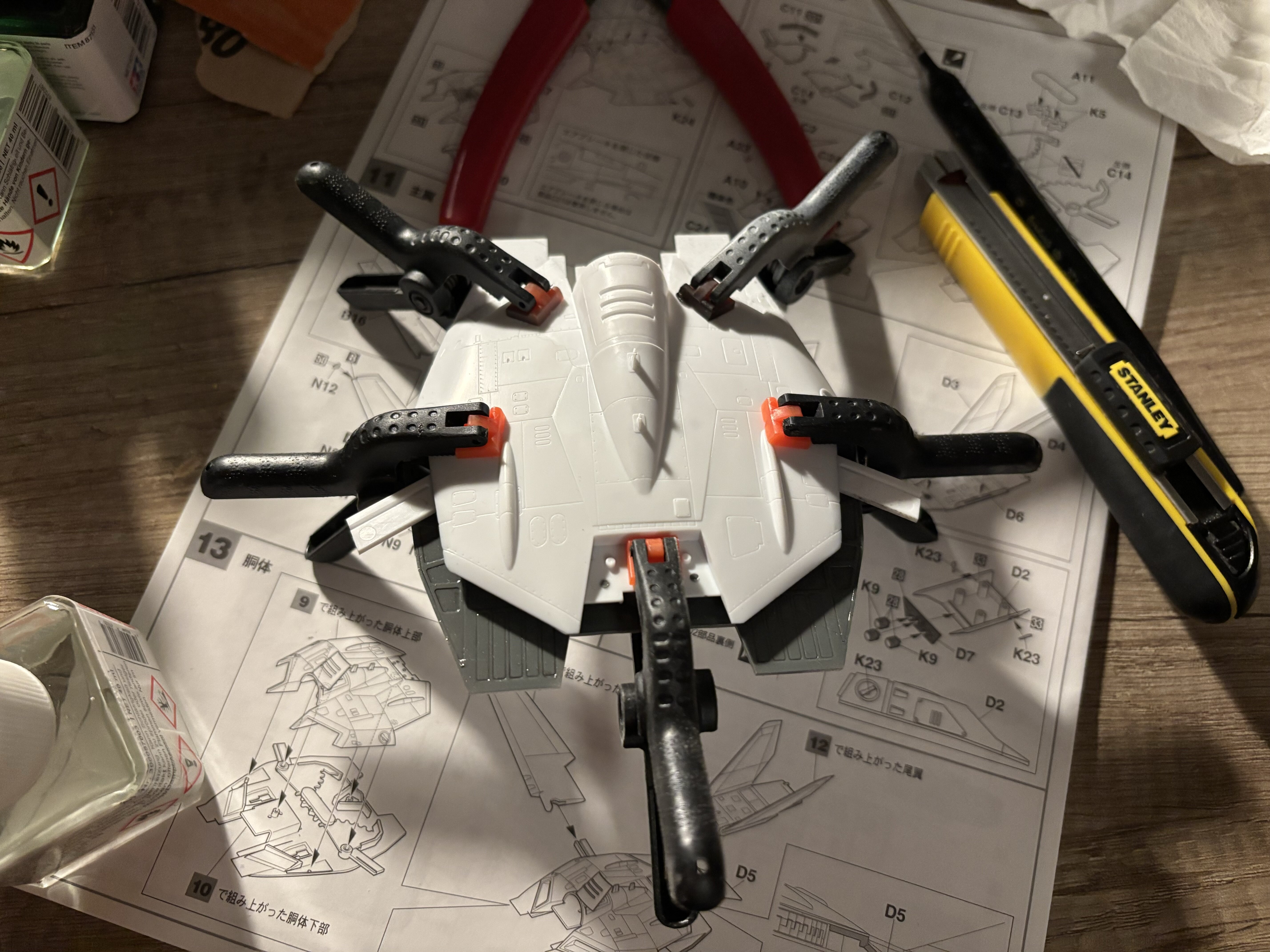

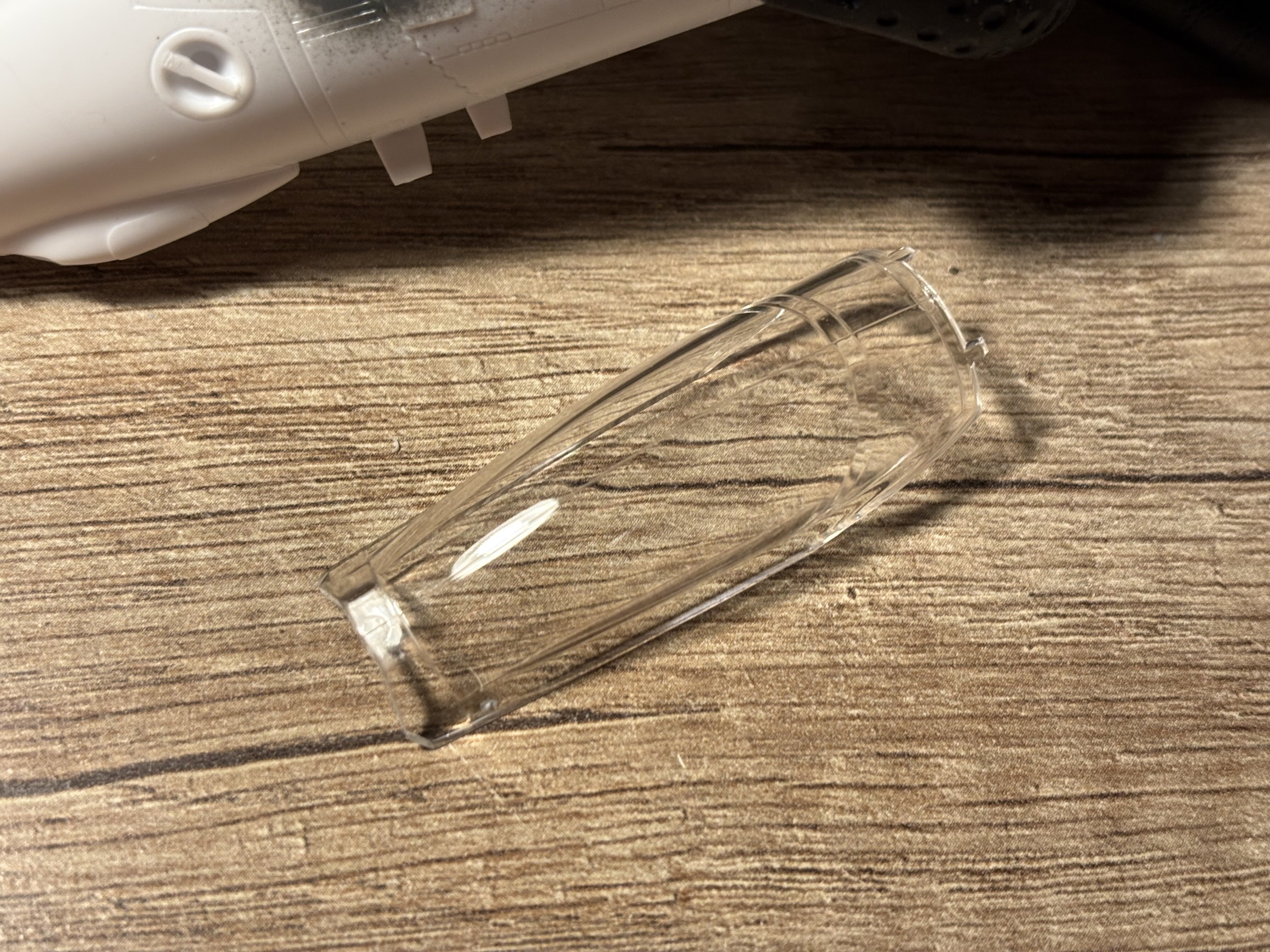

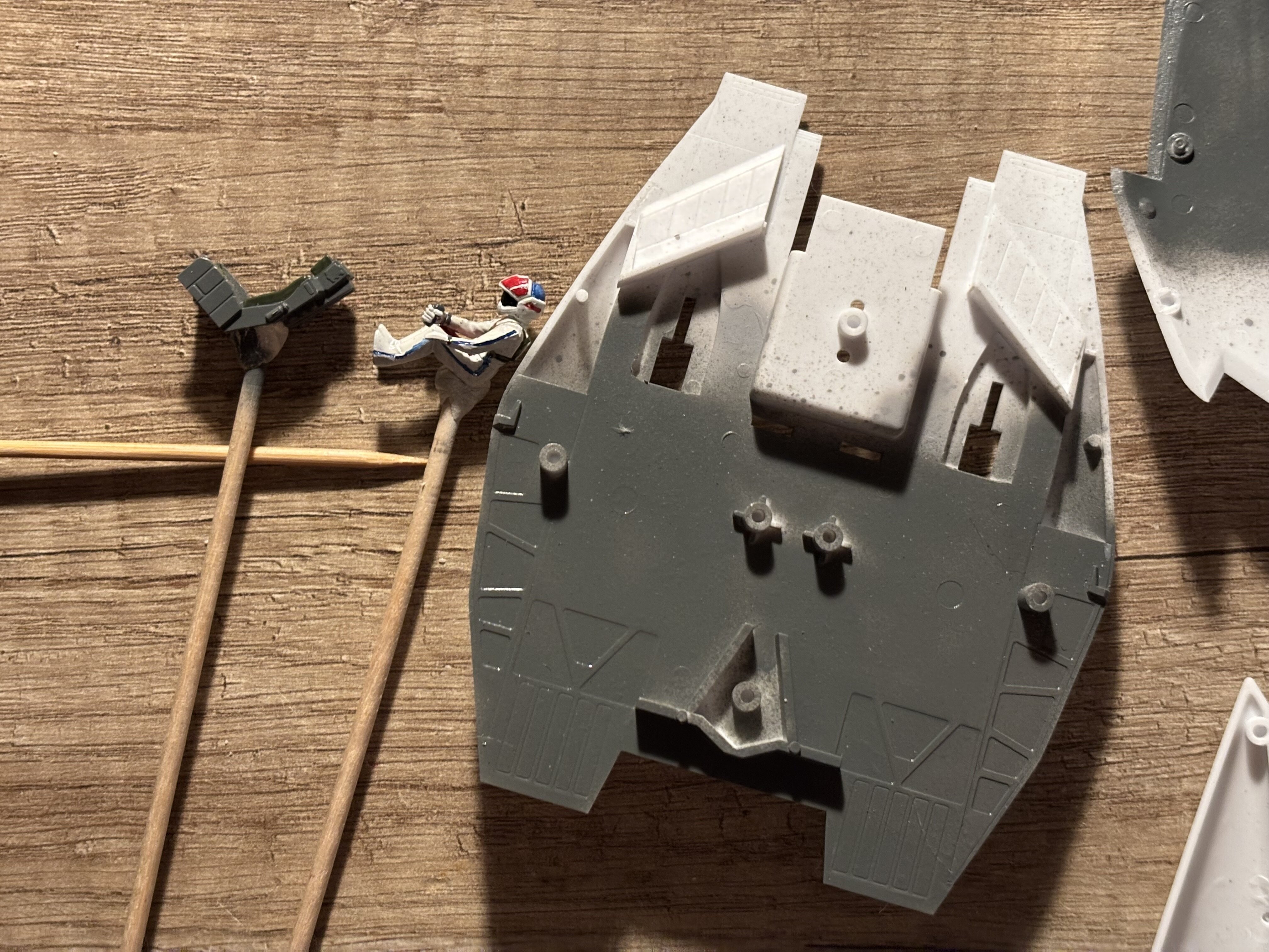

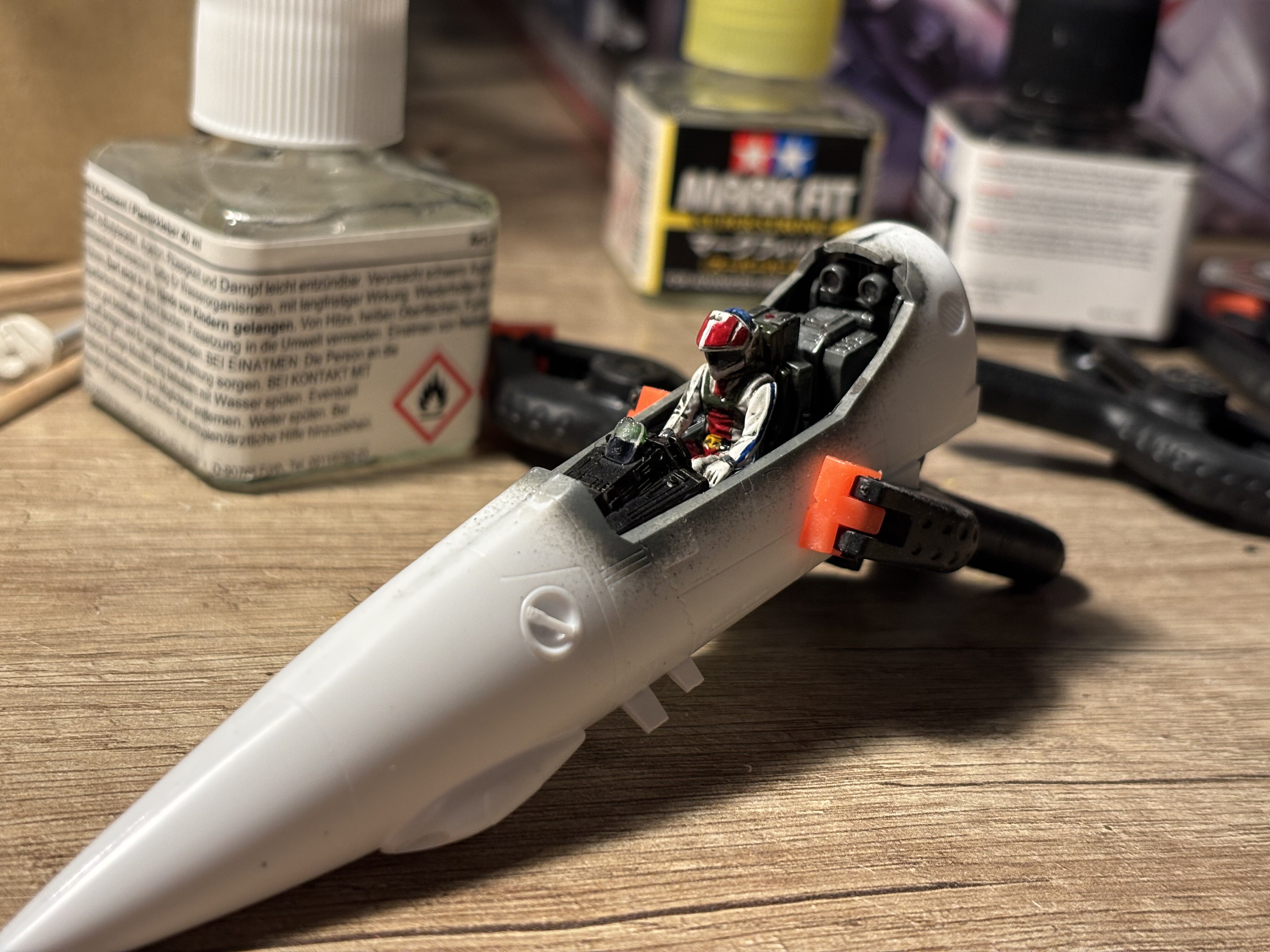

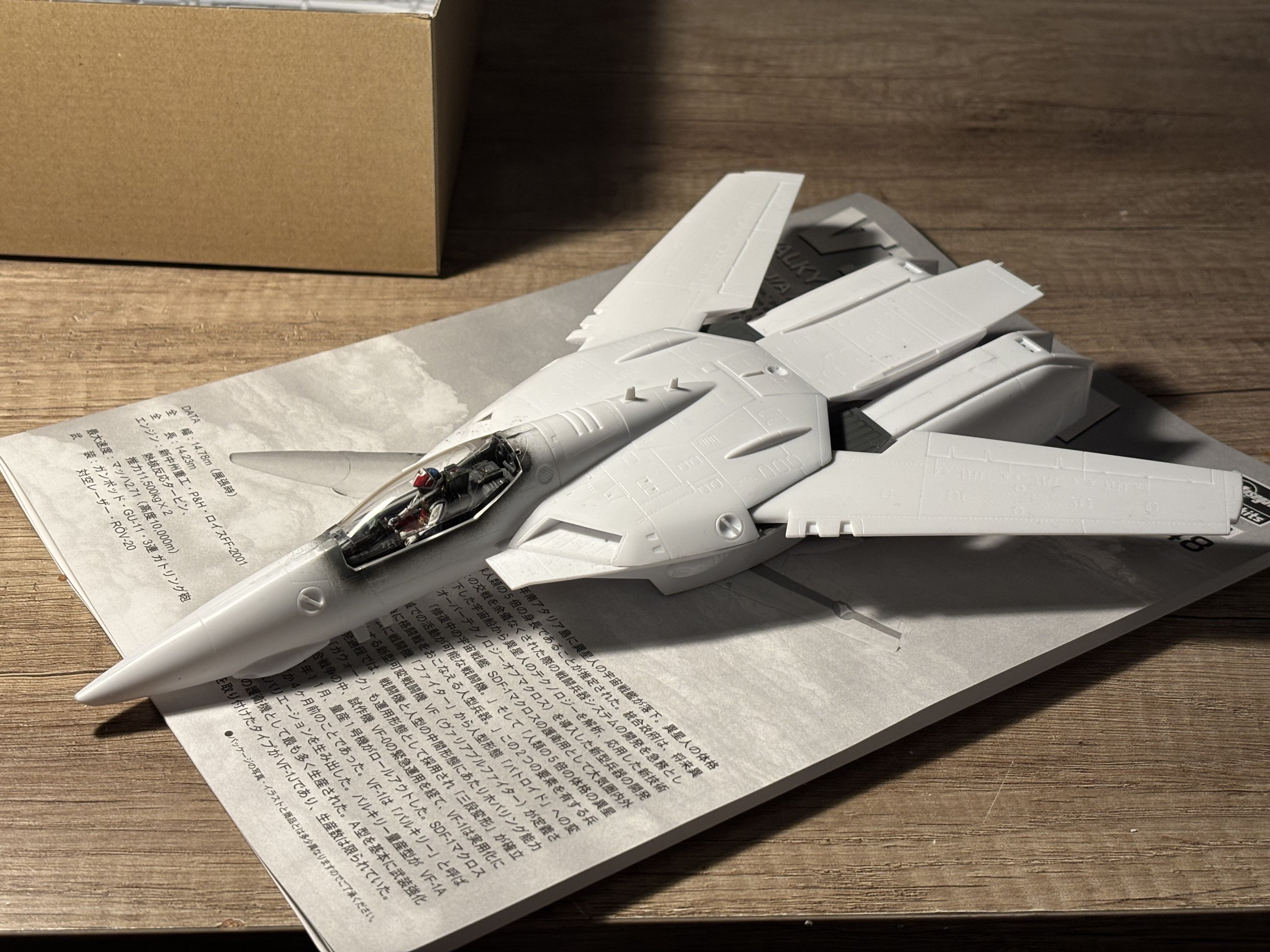

Urashiman Posted December 16, 2024 Author Posted December 16, 2024 1/48 VF-1 build updates. Hand painting Hikaru and his seat here. Clear coated these parts with Tamiya XF-22 for washing. CLAMPS! Cockpit details + built nose with cockpit and Hikaru. I am going for the bubbly canopy, but it has that ugly seam line. I find that weird, because they managed to do the flat canopy without a seam line in the middle. scratching off the seam line. (Ugly ugly…) Then sanding and buffing and putting it on the nose. As good as new. Little snap together just to show off the VF-1 Need to add some putty here and there as well as sanding. After that, masking and priming Quote
Thom Posted December 16, 2024 Posted December 16, 2024 @sketchley Very nice with popping the deets! Looks twice as big. @Urashiman Those seams line on the canopy bug the heck out of me! Nice work getting rid of it. Quote
Big s Posted December 16, 2024 Posted December 16, 2024 6 hours ago, Urashiman said: 1/48 VF-1 build updates. Hand painting Hikaru and his seat here. Clear coated these parts with Tamiya XF-22 for washing. CLAMPS! Cockpit details + built nose with cockpit and Hikaru. I am going for the bubbly canopy, but it has that ugly seam line. I find that weird, because they managed to do the flat canopy without a seam line in the middle. scratching off the seam line. (Ugly ugly…) Then sanding and buffing and putting it on the nose. As good as new. Little snap together just to show off the VF-1 Need to add some putty here and there as well as sanding. After that, masking and priming Nice job on little Hikaru. I never understood why they had to put that mold line there on the canopy. Quote
electric indigo Posted December 16, 2024 Posted December 16, 2024 3 hours ago, Big s said: I never understood why they had to put that mold line there on the canopy. You can't get the inner part of the mold in an undivided outer mold (unless you divide the inner part...). Quote
sketchley Posted December 16, 2024 Posted December 16, 2024 11 hours ago, Urashiman said: scratching off the seam line. (Ugly ugly…) Then sanding and buffing and putting it on the nose. As good as new. That seam line sucks! But you did an awesome job eliminating it. Mad skills! Quote
MechTech Posted December 16, 2024 Posted December 16, 2024 @sketchley Those Death Star details are a vast improvement over the stock version. The red looks weird at first in assembly, but complete really pops for the right reasons. @Urashiman Great clean-up on the canopy and paint on the pilot! That's going to be a beautiful build! - MT Quote

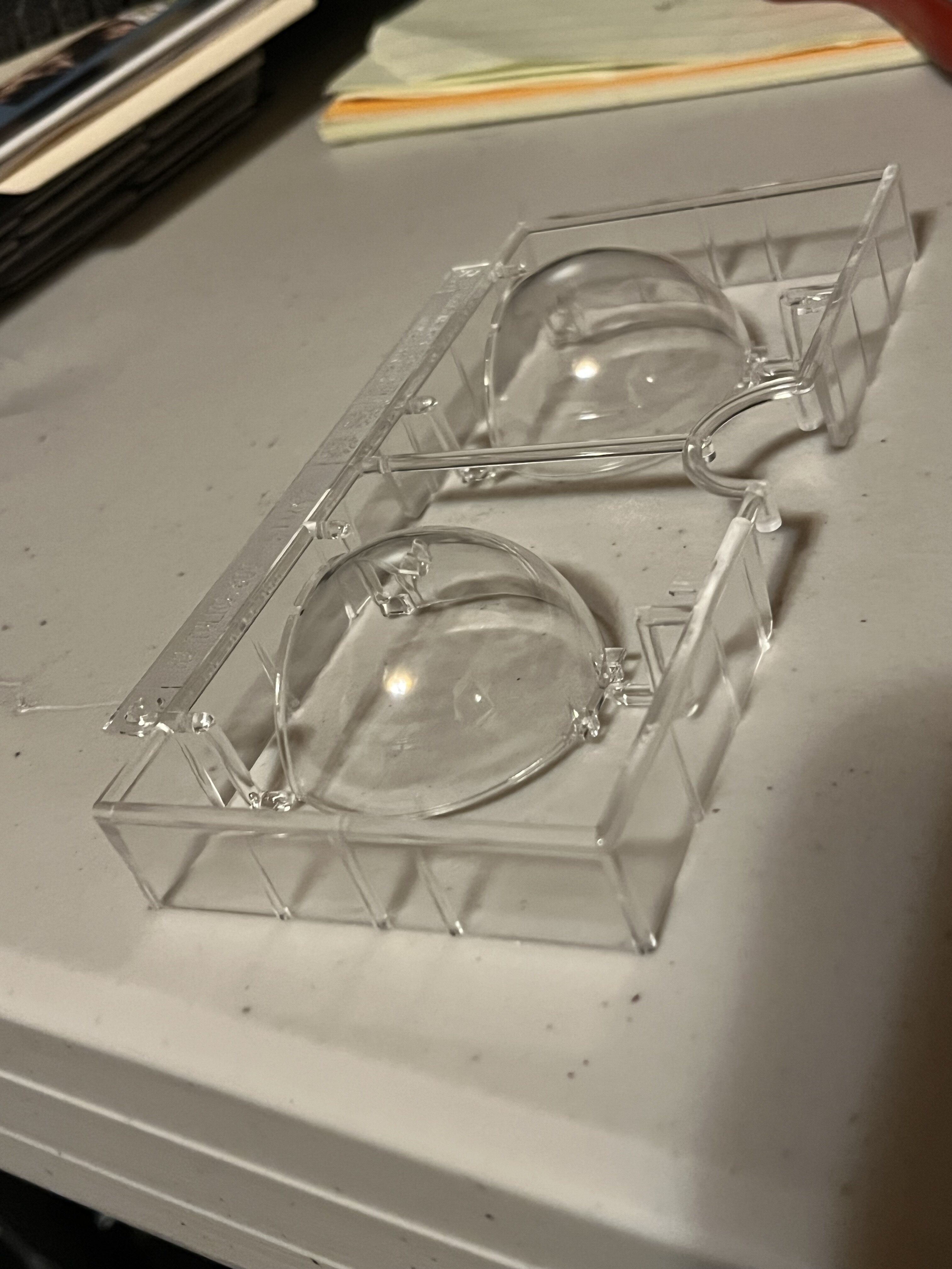

Big s Posted December 17, 2024 Posted December 17, 2024 So I just got the Hg Torohachi in the mail today and noticed that the clear bubble is two parts. It’s supposed to be one solid piece, but due to the shape, Bandai cut it down the middle. I looked online to see how other people handled the build and didn’t see anything that addressed the issue. I could probably take a piece of plastic and curve it to make a frame as a simple solution, but was wondering if anyone has had a similar issue with something like a clear canopy. I’d rather have a solid clear piece, and was wondering if anyone here has ever had to glue two pieces of clear plastic together and remove a seam line made from joining the parts and maybe see if anyone had any tips on that process. My worries are if it would just end up highly noticeable like discoloration or air bubbles and maybe solutions for those issues. here’s a pic of how it’s supposed to lookand below is how all the builds end up looking where they just stuck the two parts together and it kinda leaves a noticeable seam in the bubble that looks awkward to me. Quote
Big s Posted December 17, 2024 Posted December 17, 2024 1 hour ago, pengbuzz said: You could buy a clear plastic ball ornament (Hobby Lobby, Michaels and other places sell them) and use that to replace the clear ball on the kit. I think that’s more of a last ditch effort in case I screw up the included bubble. But it is a good idea, because my preferred method is kind of untested and I’m not really sure what I’d be getting myself into. There’s actually a pretty good chance of disaster Quote
Big s Posted December 18, 2024 Posted December 18, 2024 4 hours ago, pengbuzz said: Well, at least you have a backup then if things go south with the included bubble. Personally, I kinda hate working with clear plastics. It’s definitely not something I’ve tried before, and the more I run the idea through my head, the more thoughts of more ways things could go wrong Quote
sketchley Posted December 18, 2024 Posted December 18, 2024 2 hours ago, Big s said: It’s definitely not something I’ve tried before, and the more I run the idea through my head, the more thoughts of more ways things could go wrong Is there any way you can try out the preferred method on something first? The first thing that comes to mind are pieces of the sprues for the bubble canopy. However, they may be too small to replicate the end goal... Quote
Chas Posted December 18, 2024 Posted December 18, 2024 If they are two separate pieces that get glued together, there is no way to make that join invisible - it is not a seam line - the separation goes right through from one end to the other. A seamline in a clear piece, like that on a canopy, does not run through the entire piece from one side to the other (inside to outside). It is more like an indentation ( like a scratch on the surface) and is removed by scraping away the surface to a point below (deeper) than the indentation (scratch) thus 'removing' it and then sanding/buffing the surface smooth. With two pieces joined together there is no way to scrape away material deeper than the join because it runs through from one side to the other. On non-clear pieces we can eliminate the line between the two joined pieces by covering the join with putty, sanding until the added material and the existing material from both pieces are even and smooth, and the painting over that area such that the line between the two parts is invisible. This cannot be done if the two parts are transparent. Quote
Big s Posted December 18, 2024 Posted December 18, 2024 1 hour ago, sketchley said: Is there any way you can try out the preferred method on something first? The first thing that comes to mind are pieces of the sprues for the bubble canopy. However, they may be too small to replicate the end goal... Actually the sprue does have a bunch of extra plastic creating a safety box around the clear parts for protection 26 minutes ago, Chas said: If they are two separate pieces that get glued together, there is no way to make that join invisible - it is not a seam line - the separation goes right through from one end to the other. A seamline in a clear piece, like that on a canopy, does not run through the entire piece from one side to the other (inside to outside). It is more like an indentation ( like a scratch on the surface) and is removed by scraping away the surface to a point below (deeper) than the indentation (scratch) thus 'removing' it and then sanding/buffing the surface smooth. With two pieces joined together there is no way to scrape away material deeper than the join because it runs through from one side to the other. On non-clear pieces we can eliminate the line between the two joined pieces by covering the join with putty, sanding until the added material and the existing material from both pieces are even and smooth, and the painting over that area such that the line between the two parts is invisible. This cannot be done if the two parts are transparent. That’s definitely a worry that I have, but I think I’ll experiment a little with the clear plastic and clear cement to see if it kinda melts the pieces together. I’ve never done it and can’t find an example of it, but I figured it’s worth a try before ruining the actual bubble. I personally wouldn’t try basic putties, but maybe melted sprue for the imperfections if they’re wide and maybe some clear gloss into smaller holes and of course doing some sanding as polishing. If none of that works in practice, then I’ll go with plan B, which would be making a frame to go around it to at least make things look better and if that all goes to hell, then as Pengbuzz mentioned, there’s always cheap clear ornaments Quote
sketchley Posted December 18, 2024 Posted December 18, 2024 In one of the Japanese hobby magazines I remember reading a tip about how to glue pieces together in a way that gets rid of the seam line, without having to resort to putty and other fillers. If memory serves: 1) Put the solvent glue on the parts of both pieces that are being fused together. 2) wait until the plastic is suitable melted. 3) squish the pieces together until there isn't any gap, and some of the melted plastic is being pushed out. 4) when dry, sand off the excess plastic that was pushed out of the seam. However, I'm not sure how viable that is on a clear plastic piece - as the off gassing will probably cause fogging... Quote
Big s Posted December 18, 2024 Posted December 18, 2024 2 minutes ago, sketchley said: In one of the Japanese hobby magazines I remember reading a tip about how to glue pieces together in a way that gets rid of the seam line, without having to resort to putty and other fillers. If memory serves: 1) Put the solvent glue on the parts of both pieces that are being fused together. 2) wait until the plastic is suitable melted. 3) squish the pieces together until there isn't any gap, and some of the melted plastic is being pushed out. 4) when dry, sand off the excess plastic that was pushed out of the seam. However, I'm not sure how viable that is on a clear plastic piece - as the off gassing will probably cause fogging... That’s basically what I was thinking of doing, but with the extra thin, it worries me. I’m actually thinking of trying it with thicker glue as well since I have some spare plastic to work with and see if that makes a difference. Luckily there’s enough extra plastic here to try a few different methods as experiments Quote
sketchley Posted December 18, 2024 Posted December 18, 2024 That's good that you have some material on hand to try things out first. Hopefully there won't be too much fogging! 🤞 Quote

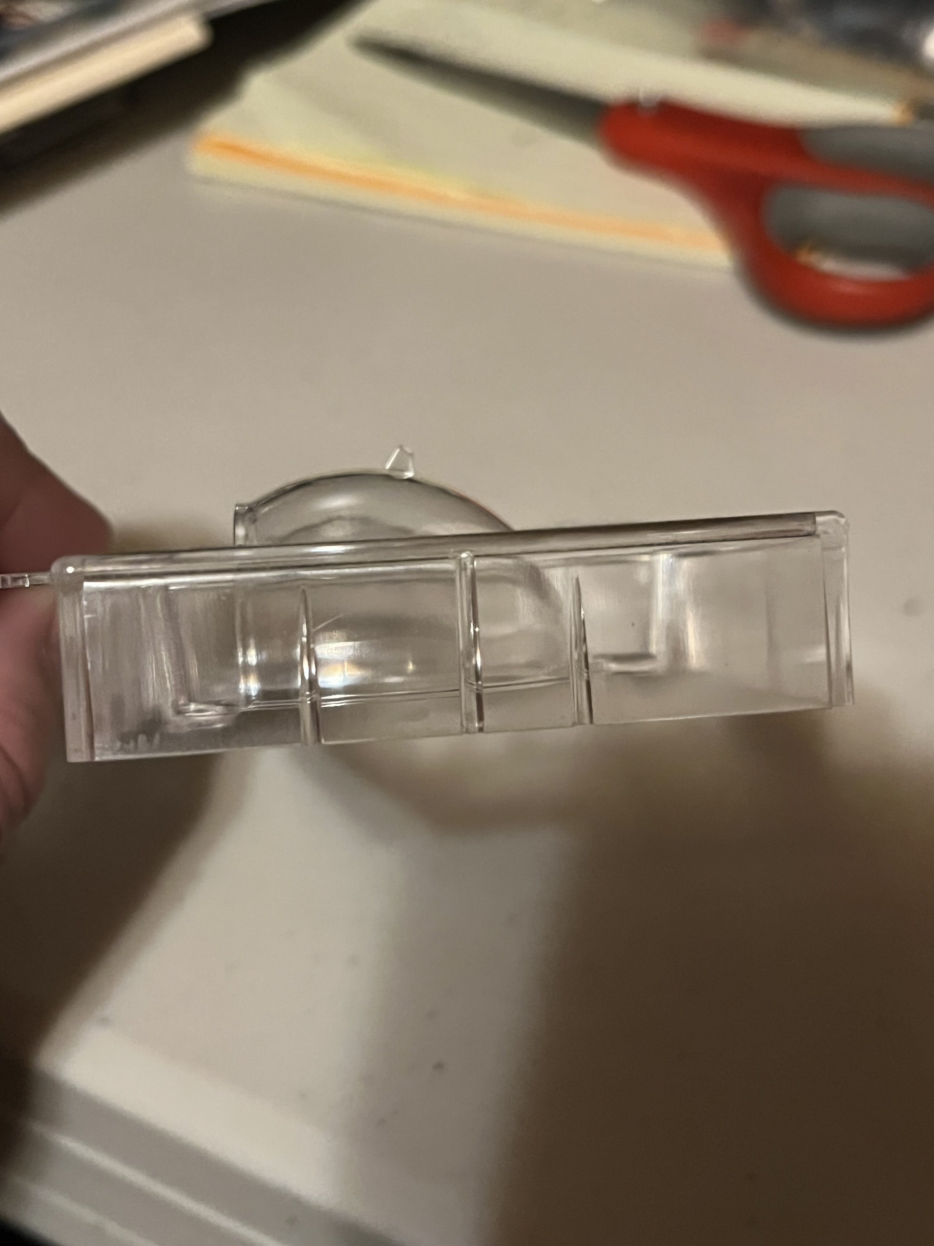

Big s Posted December 19, 2024 Posted December 19, 2024 8 hours ago, sketchley said: That's good that you have some material on hand to try things out first. Hopefully there won't be too much fogging! 🤞 Definitely plenty of plastic to give things a try It’s almost like a box around the parts, so there’s plenty of clear plastic to try things like a bit with solvent glue straight out of the bottle or turn some into sprue goo or even a mix of the two or just some thick old school testers squeeze tube. Quote
sketchley Posted December 19, 2024 Posted December 19, 2024 (edited) Looks like there's plenty of material to try the quicker/easier two techniques! (making sprue goo seems like a rather involved process) Seeing the box-like parts, I'm wondering what the best approach is for welding two chunks together. Thinking out loud: scoring and snapping a section apart to be glued back together will probably introduce stress marks... Perhaps gluing the undamaged bottom edges of two parts of that 'box' together will closest approximate the actual dome? It's a shame that the box isn't quite as clear as the dome. Maybe put a bit of something like masking tape on the clear plastic close to where you're gluing, and once everything is dry, remove it to see if there is any fogging (and how bad it gets) near the glued seam? Edited December 19, 2024 by sketchley Quote
Big s Posted December 19, 2024 Posted December 19, 2024 3 hours ago, sketchley said: Looks like there's plenty of material to try the quicker/easier two techniques! (making sprue goo seems like a rather involved process) Seeing the box-like parts, I'm wondering what the best approach is for welding two chunks together. Thinking out loud: scoring and snapping a section apart to be glued back together will probably introduce stress marks... Perhaps gluing the undamaged bottom edges of two parts of that 'box' together will closest approximate the actual dome? It's a shame that the box isn't quite as clear as the dome. Maybe put a bit of something like masking tape on the clear plastic close to where you're gluing, and once everything is dry, remove it to see if there is any fogging (and how bad it gets) near the glued seam? The box is actually just as clear, it’s more of a thing with my camera and the texture of the cheap table making things look fuzzy. But either way it’s a lot of extra bits to try out some things with. Quote

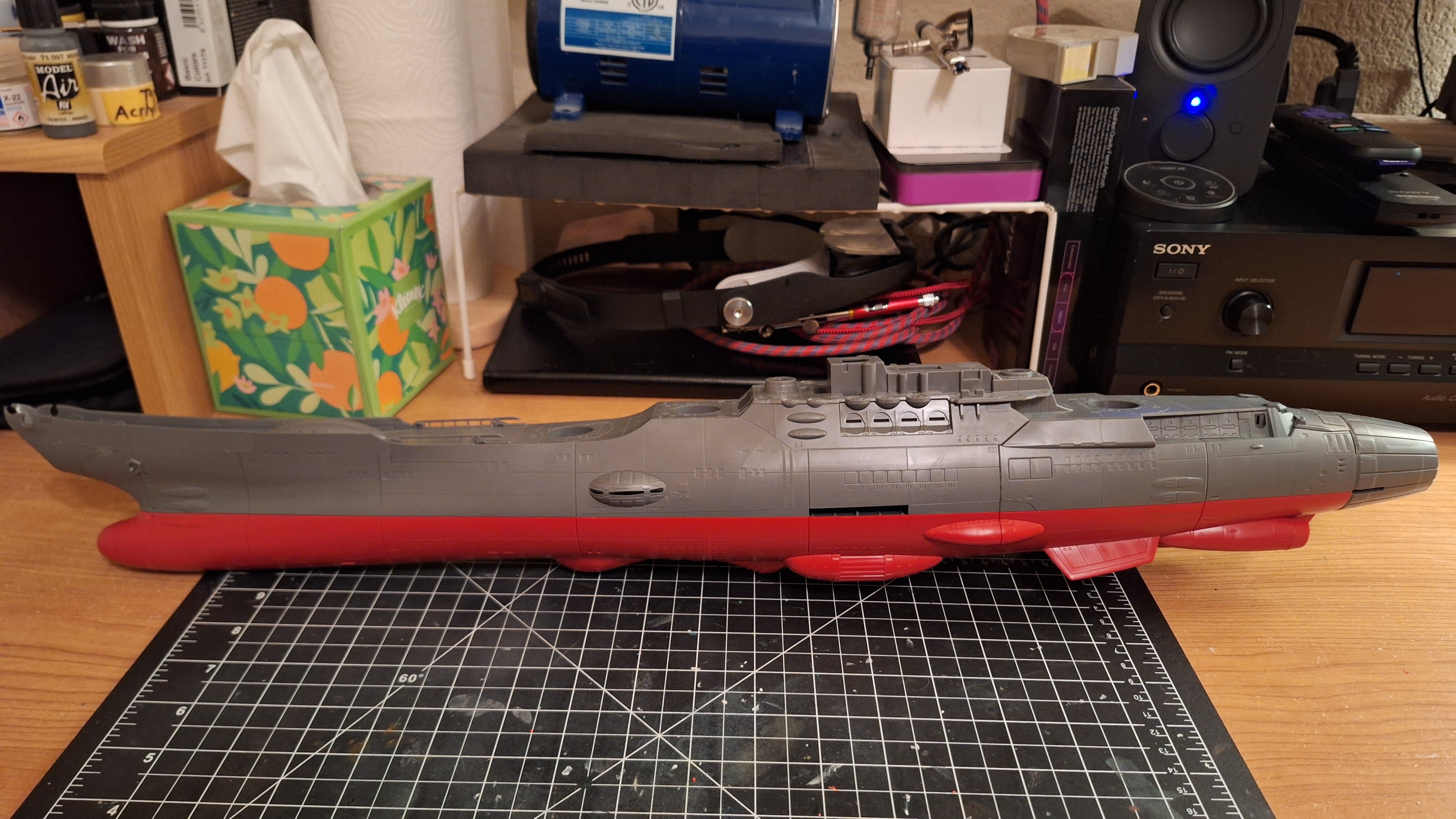

derex3592 Posted December 22, 2024 Posted December 22, 2024 (edited) Needed a quick break from 1/72 airplanes, so I spent today on the 1/500 Yamato, man this kit is just massive! I love it. Two tiny drops of Tamiya quick setting cement so far to this point. No putty. Bandai was on their game back then! Edited December 22, 2024 by derex3592 Quote

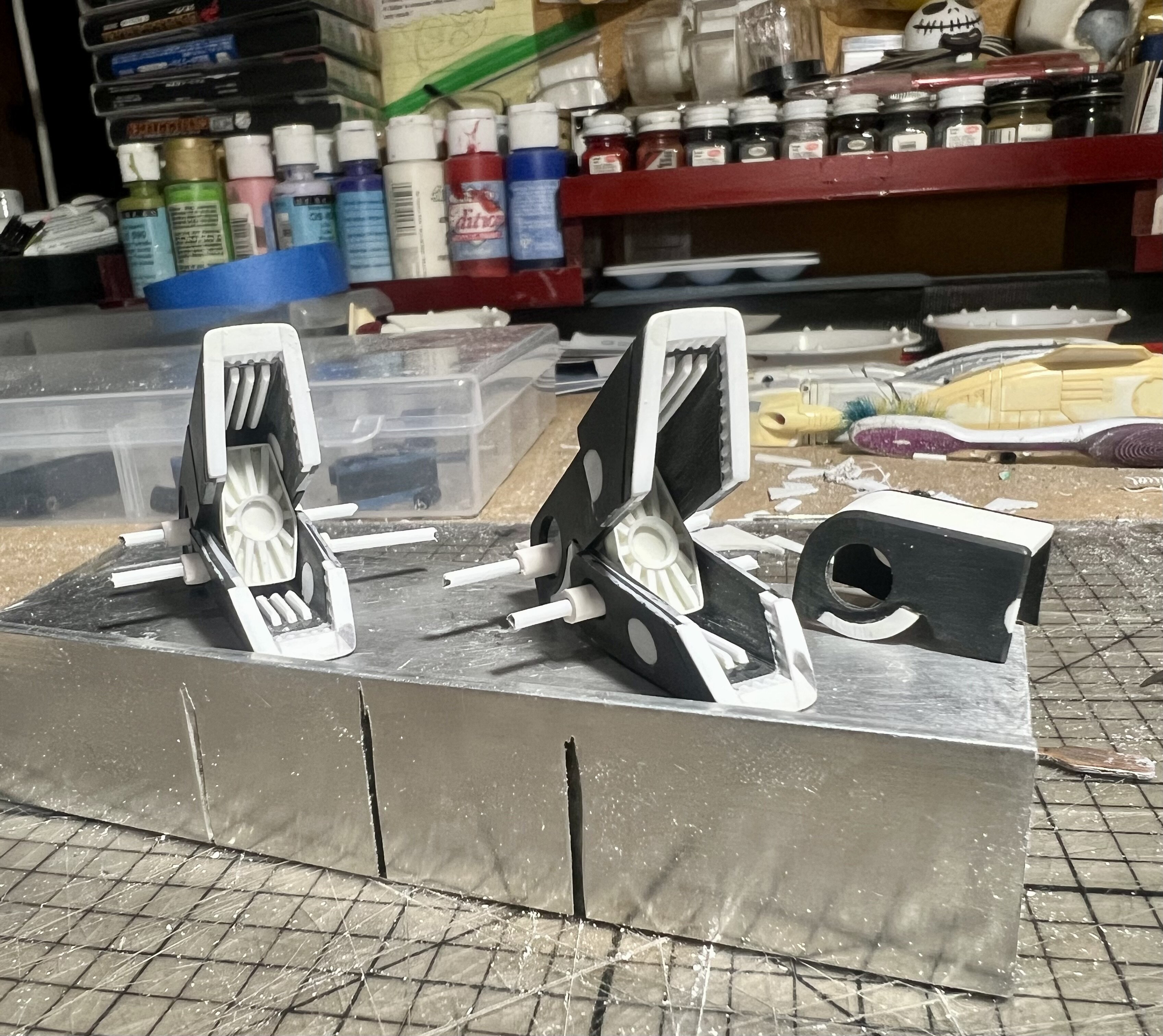

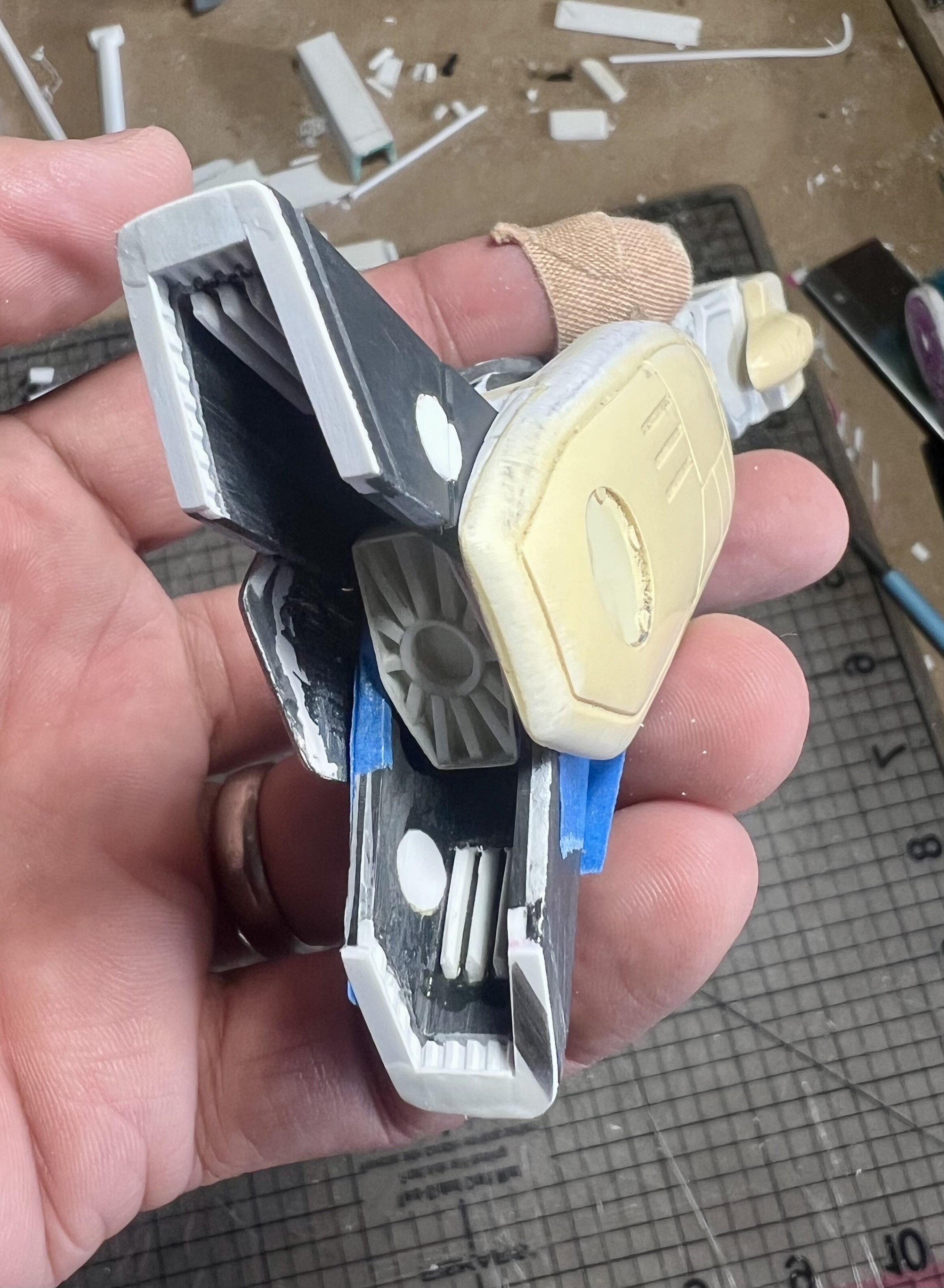

nightmareB4macross Posted December 22, 2024 Posted December 22, 2024 Took a bit of a break away from my 1/55 custom. In the last couple of days feet and thrusters were created with extensive detailing. This sure is a fun project. Quote

Urashiman Posted December 23, 2024 Author Posted December 23, 2024 @electric indigo 30 years old? What kit maker is that? The panel lines look so crisp ... @nightmareB4macross so much evergreen. looks like it is coming along well. @SteveTheFish looks nice @pengbuzz aah ... good old cannon fodder. Haha Quote
