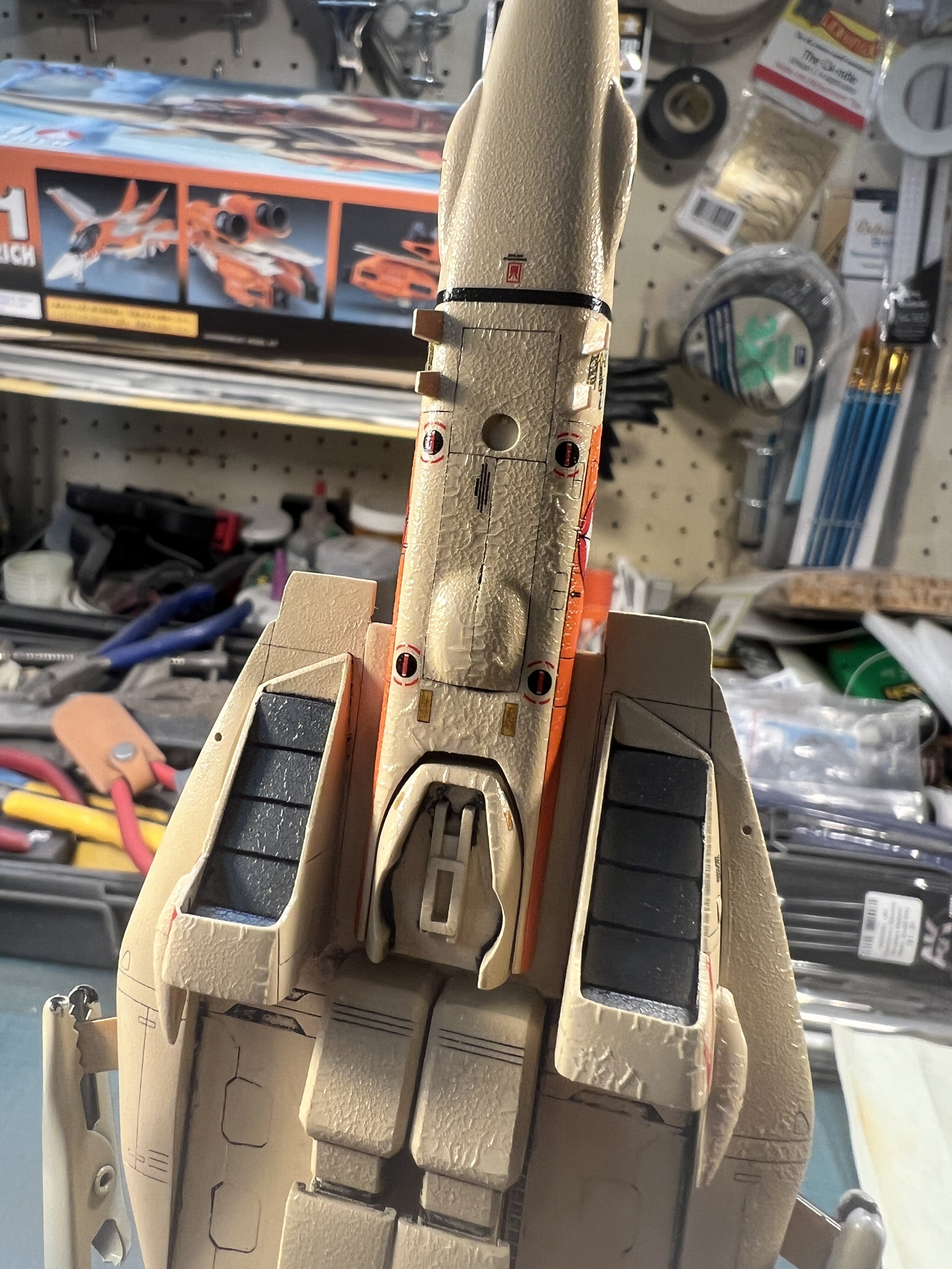

Chas Posted September 12, 2024 Posted September 12, 2024 Looks great so far. One question, are the lights all going to be the same colour? Quote
pengbuzz Posted September 12, 2024 Posted September 12, 2024 2 hours ago, Spacecore said: Well, I suppose these go here. Last few months, got really into Macross. This seems to happen every summer, I dedicate myself to a new older sci-fi anime franchise (last year was Legend of the Galactic Heroes, year before was Space Battleship Yamato, both resulted in a lot of spaceships being built). But, I ended up with a 1/4000 Hasegawa SDF-1, DYRL version. That opening shot of it emerging from the shadow of Jupiter, with all the blinking lights, was just so iconic, that I've spent the last few weeks painstakingly drilling hundreds of tiny holes and feeding .25mm fiberoptics through them. It's been an interesting project so far, still not even sure how it'll come together, but the pieces I have right now are pretty good looking at least. I've lost count of how many I've installed already, but I'm breaking them up into 3 groups, so I can later install LEDs that blink in sequence, with the help of a pi nano. The general idea is for 2/3 to be on at all times, so the sequence goes 1/2 on, 2/3 on, then 3/1 on. This way, some will always be lit, and it looks more active than not. The engines are going to be on a separate circuit, running into 12 LEDs that all flicker slightly, so the engines look active and humming. Honestly, the biggest roadblocks I've encountered are what steps to do in what order, and lack of space in the ship/stand for wiring and batteries. The latter can be easily fixed with a 3d printed addition to the stand, but the former is more of an issue. Because of how I plan to install the LEDs and fiberoptics, combined with how the legs are built, there's not a lot of room to work with, meaning I'll need to paint stuff in sub-assemblies before finishing the wiring and assembling, before finishing the painting. It's a more complex assembly process than any of my builds in the past, so I've just been struggling to wrap my head around it, hahaha. Hope I didn't screw up the formatting, I'm not really used to forums. IMG_6040.mov Looks fantastic so far!! And don't worry: your "format" is fine here; we don't grade on that!! And while we're at it: Welcome to Macross World Forums!! 😍 Quote
Spacecore Posted September 13, 2024 Posted September 13, 2024 1 hour ago, pengbuzz said: And while we're at it: Welcome to Macross World Forums!! 😍 Thank you for the warm welcome! also, as for what Chas asked, I am going to use some clear paint to make some of them red. I'll also be using glow in the dark and florescent paints to add a lot more small light pinpricks, which won't be lit, but will give it a good sense of scale and help keep it looking alive when the LEDs aren't on. Also, a lot of DYRL shots of it look like it has red and white markings, and not lights, so those should help keep it from being pure grey. Quote

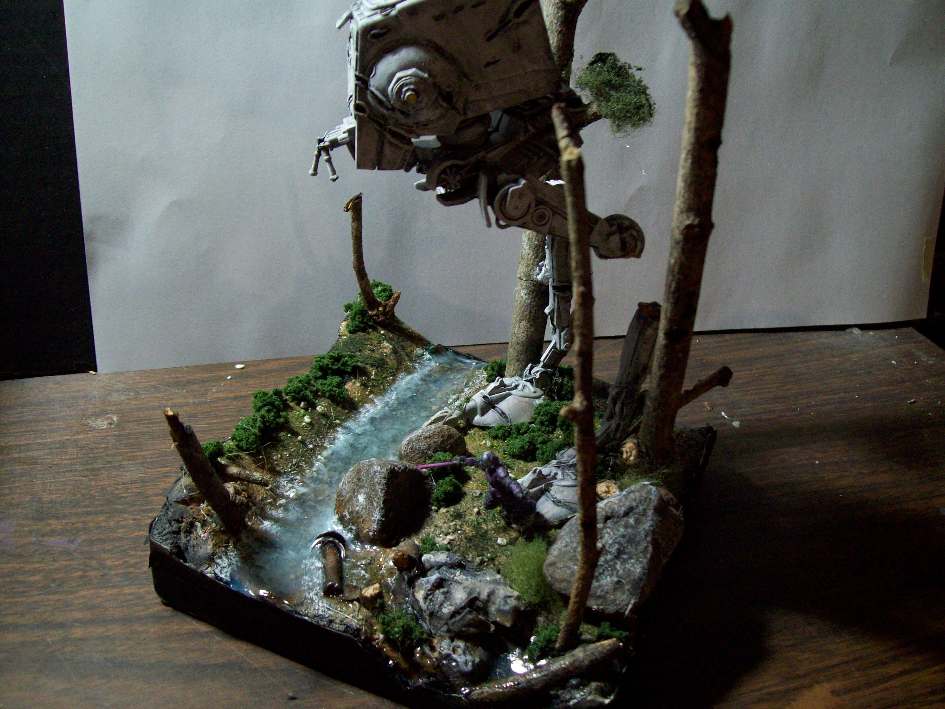

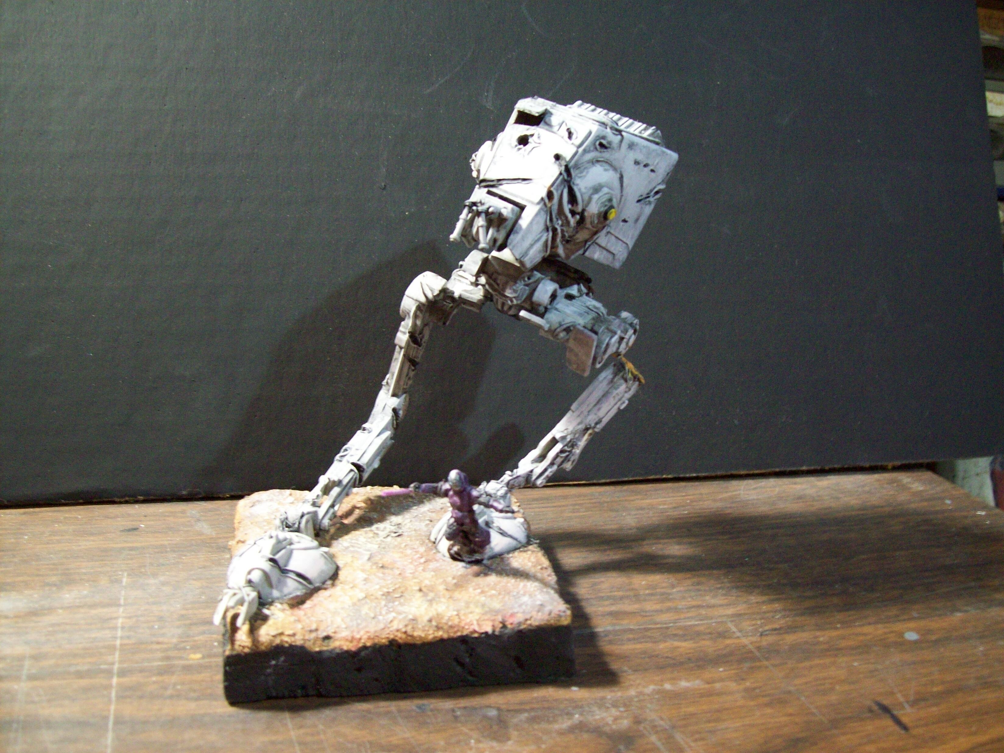

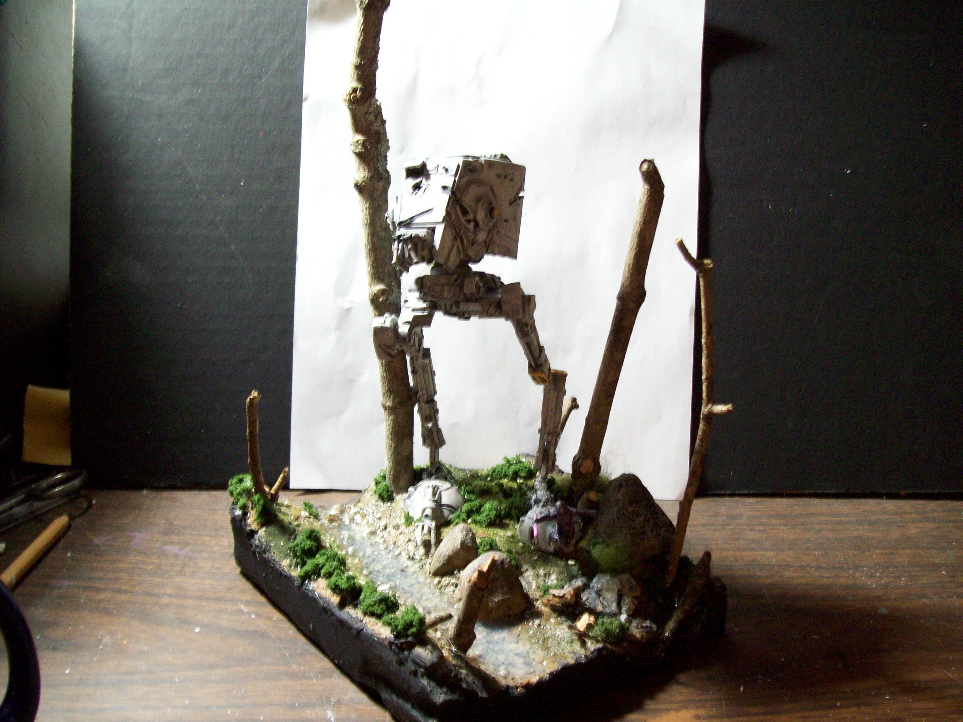

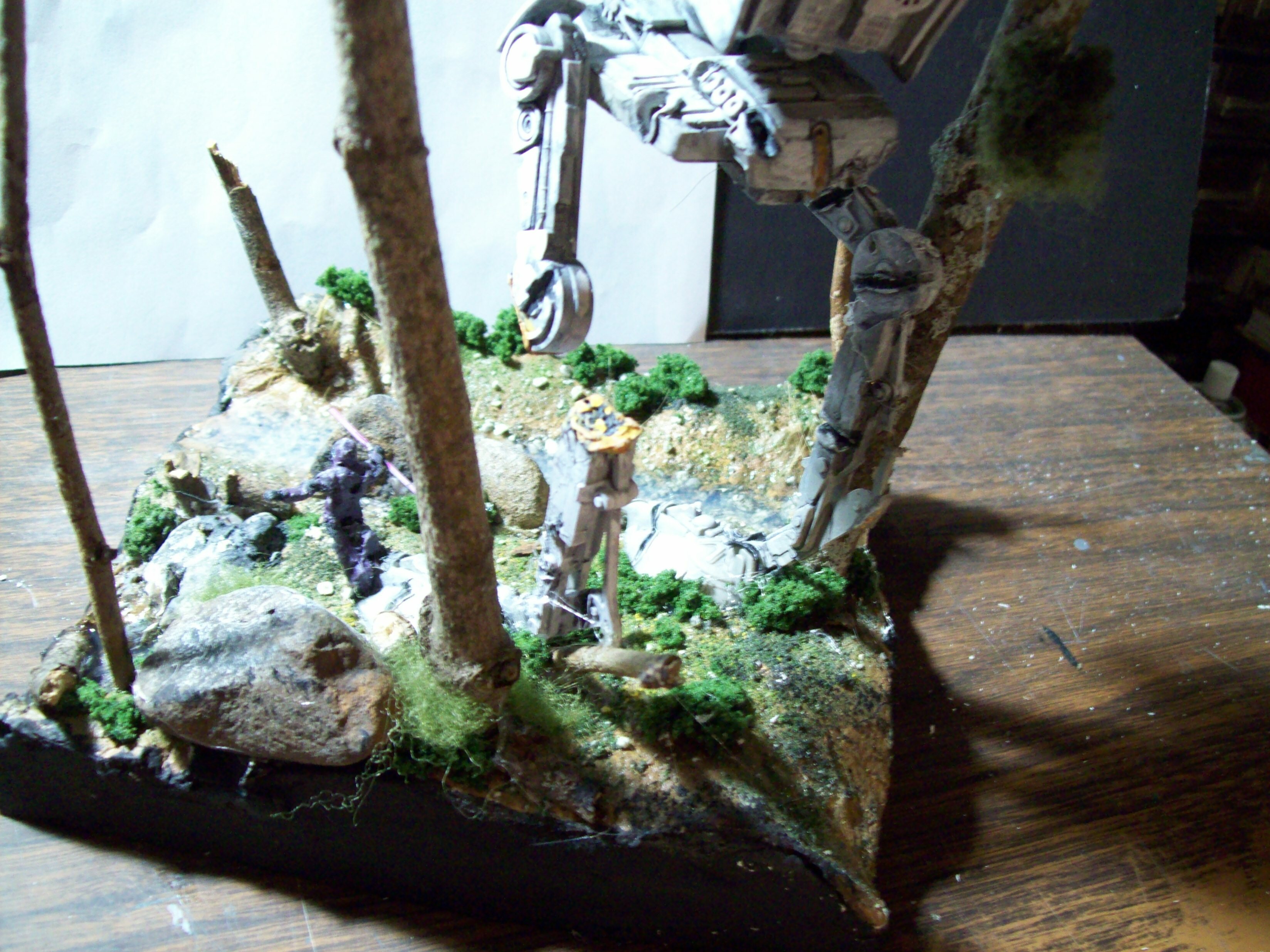

pengbuzz Posted September 15, 2024 Posted September 15, 2024 (edited) UPDATE: My diorama fell off the shelf it was on (I knocked it over by accident), and the walker separated from the base. That's the bad news... The good news: it landed on top of something I had been trying to find, but was missing- (it had fallen between my shelf and the bookcase next to it, to where you couldn't see it unless you were right on top of it!) Anyways, seeing as the model was separated from it's base now (and rather cleanly, I have to confess!), I decided that the base was too small anyways and... ...well... See for yourselves: Just waiting for the "water" to cure (it takes 24 hours and I just did this last night, so it'll look a little cloudy until then). If it doesn't, I'll paint it with a bit of transparent blue, watered down. Stay tuned... Edited September 15, 2024 by pengbuzz Quote
Big s Posted September 16, 2024 Posted September 16, 2024 2 hours ago, pengbuzz said: UPDATE: My diorama fell off the shelf it was on (I knocked it over by accident), and the walker separated from the base. That's the bad news... The good news: it landed on top of something I had been trying to find, but was missing- (it had fallen between my shelf and the bookcase next to it, to where you couldn't see it unless you were right on top of it!) Anyways, seeing as the model was separated from it's base now (and rather cleanly, I have to confess!), I decided that the base was too small anyways and... ...well... See for yourselves: Just waiting for the "water" to cure (it takes 24 hours and I just did this last night, so it'll look a little cloudy until then). If it doesn't, I'll paint it with a bit of transparent blue, watered down. Stay tuned... I think it was meant to be. The diorama has much more to look at now Quote

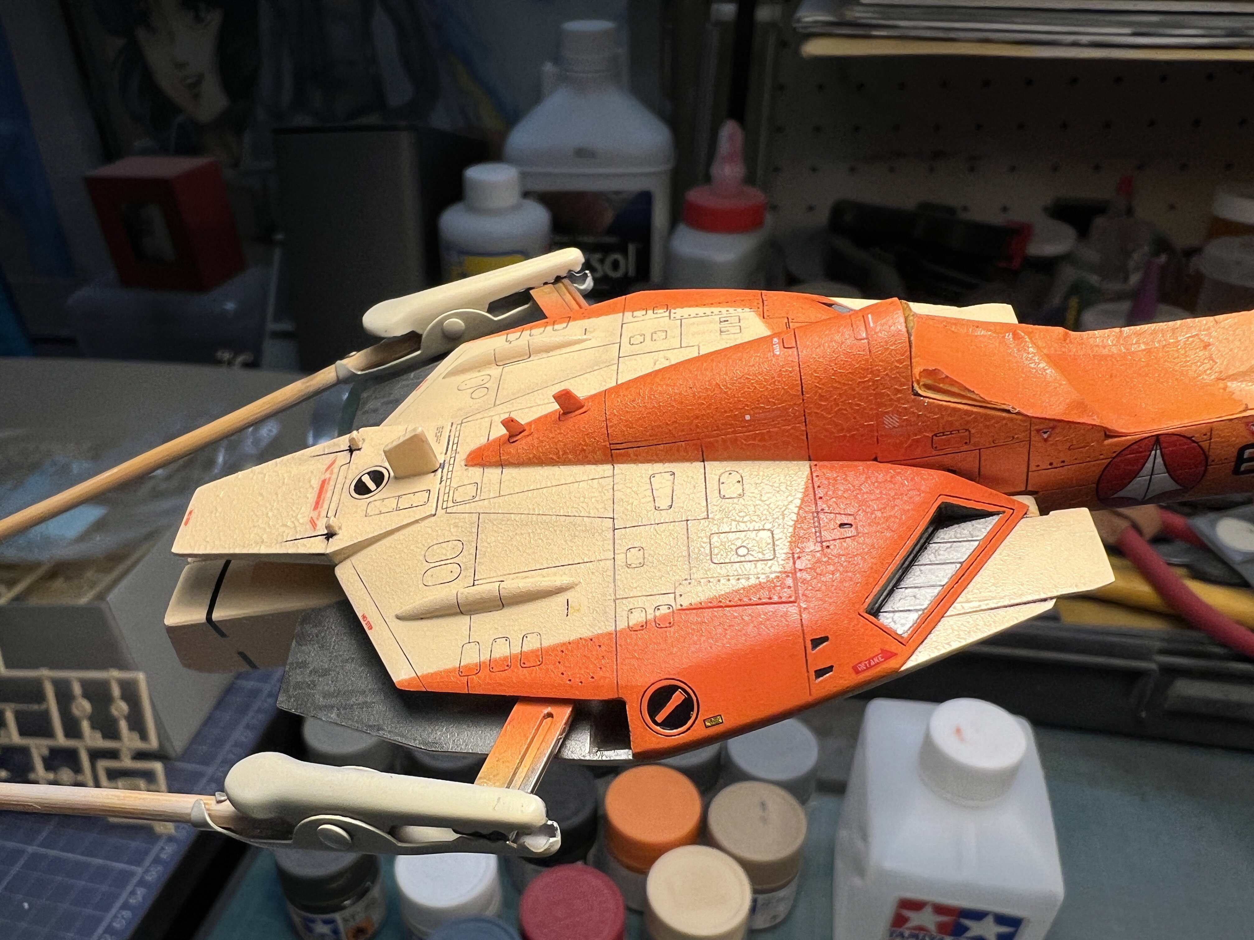

wm cheng Posted September 16, 2024 Posted September 16, 2024 Argh DISASTER!!! I guess you can't put Mr. Hobby clear coats over top of Alclad Aqua Gloss. First time using Alclad Aqua Gloss (as everyone told me I was a dinosaur for still using Future) to create a glossy base for the decals then I sealed in the decals. I wanted to try that weathering technique using acrylic inks, but it needed Tamiya X-20A thinner as a base to thin the inks - unfortunately, the X-20A ate past the Aclad Aqua Gloss. So I thought I'd protect it with Mr. Hobby Super Clear - but that's a lacquer and it reacted badly with the Aqua Gloss underneath and ruined the smooth finish. I'm walking away from it for a few days to let the reaction cure and stop, I might try to sand it down with 6000 to 10000 grit sanding sponge to see if I can salvage it. If I can't then its trash as its not worth stripping it back to bare plastic as I can't save the decals. I hate frakking up at such a late stage. Now I know that Alclad Aqua Gloss is useless - being a water based clear coat, it can only be used if its a final coat with nothing to go on top. I guess newer isn't better. Quote

Big s Posted September 16, 2024 Posted September 16, 2024 2 hours ago, pengbuzz said: I've had something similar happen to a kit before, WM! Try wiping it down carefully with 91 alcohol; it seems the two coats wrinkled due to interaction, but if they could be removed safely, you may have a shot at saving this one. Try it on a small area, and you might want to start with 70 first in case 91 might be too strong. If that doesn't work, I can always see what I can do with it (if you're willing) and if I can, send it back to you so you can pick up where you left off. I find that the 91 is pretty harsh, but great for removing paint. I’d definitely go lighter with the 70 Quote
pengbuzz Posted September 16, 2024 Posted September 16, 2024 1 hour ago, Big s said: I find that the 91 is pretty harsh, but great for removing paint. I’d definitely go lighter with the 70 Right; I'm hoping the 70 can remove the top coats for wm chang without doing the decals or paint any harm. That's why I recommended starting with the 70 and testing it on a small area. Quote

Thom Posted September 16, 2024 Posted September 16, 2024 11 hours ago, wm cheng said: Argh DISASTER!!! I guess you can't put Mr. Hobby clear coats over top of Alclad Aqua Gloss. First time using Alclad Aqua Gloss (as everyone told me I was a dinosaur for still using Future) to create a glossy base for the decals then I sealed in the decals. I wanted to try that weathering technique using acrylic inks, but it needed Tamiya X-20A thinner as a base to thin the inks - unfortunately, the X-20A ate past the Aclad Aqua Gloss. So I thought I'd protect it with Mr. Hobby Super Clear - but that's a lacquer and it reacted badly with the Aqua Gloss underneath and ruined the smooth finish. I'm walking away from it for a few days to let the reaction cure and stop, I might try to sand it down with 6000 to 10000 grit sanding sponge to see if I can salvage it. If I can't then its trash as its not worth stripping it back to bare plastic as I can't save the decals. I hate frakking up at such a late stage. Now I know that Alclad Aqua Gloss is useless - being a water based clear coat, it can only be used if its a final coat with nothing to go on top. I guess newer isn't better. Ouch!! I saw the first pic and I felt that in my gut! I hope the corrective measures work, but even if not, you know there is still good plastic underneath all of that. Good luck! Quote
wm cheng Posted September 16, 2024 Posted September 16, 2024 Unfortunately its somehow damaged the orange sections underneath the clear coat (the orange areas were Tamiya Acrylic) and gave it a very light crackling crazing. I think I can sand down carefully the raised folds/cracks but I don't know if I can do anything about the orange sections that have this fine lighter colour cracking that's below the clear coat surface and I can't strip it back without loosing the decals (which I already had a lot of problems with breaking up and definitely do not have enough spares to redo - or want to). I will see how carefully I can sand down the texture and re-coat, maybe if I can get it smooth again and try to recover and protect, the ink weathering can hide some of the sins? Don't know if I'll have enough patience for that. Quote
pengbuzz Posted September 16, 2024 Posted September 16, 2024 5 hours ago, wm cheng said: Unfortunately its somehow damaged the orange sections underneath the clear coat (the orange areas were Tamiya Acrylic) and gave it a very light crackling crazing. I think I can sand down carefully the raised folds/cracks but I don't know if I can do anything about the orange sections that have this fine lighter colour cracking that's below the clear coat surface and I can't strip it back without loosing the decals (which I already had a lot of problems with breaking up and definitely do not have enough spares to redo - or want to). I will see how carefully I can sand down the texture and re-coat, maybe if I can get it smooth again and try to recover and protect, the ink weathering can hide some of the sins? Don't know if I'll have enough patience for that. Whatever you do, take it in small sections a bit at a time WM. Quote
Chas Posted September 16, 2024 Posted September 16, 2024 6 hours ago, wm cheng said: Unfortunately its somehow damaged the orange sections underneath the clear coat (the orange areas were Tamiya Acrylic) and gave it a very light crackling crazing. I think I can sand down carefully the raised folds/cracks but I don't know if I can do anything about the orange sections that have this fine lighter colour cracking that's below the clear coat surface and I can't strip it back without loosing the decals (which I already had a lot of problems with breaking up and definitely do not have enough spares to redo - or want to). I will see how carefully I can sand down the texture and re-coat, maybe if I can get it smooth again and try to recover and protect, the ink weathering can hide some of the sins? Don't know if I'll have enough patience for that. Sent you a PM Quote

Urashiman Posted September 17, 2024 Author Posted September 17, 2024 On 9/16/2024 at 5:50 PM, wm cheng said: Unfortunately its somehow damaged the orange sections underneath the clear coat (the orange areas were Tamiya Acrylic) and gave it a very light crackling crazing. I think I can sand down carefully the raised folds/cracks but I don't know if I can do anything about the orange sections that have this fine lighter colour cracking that's below the clear coat surface and I can't strip it back without loosing the decals (which I already had a lot of problems with breaking up and definitely do not have enough spares to redo - or want to). I will see how carefully I can sand down the texture and re-coat, maybe if I can get it smooth again and try to recover and protect, the ink weathering can hide some of the sins? Don't know if I'll have enough patience for that. Best of luck man! Quote
MechTech Posted September 17, 2024 Posted September 17, 2024 @pengbuzz Sorry to say this, but I'm GLAD it fell off the shelf. You're improvements have made it look much more realistic and COOL! @wm cheng Holy orange peels Batman! Wow, sorry your finish came out like that! That is agrovating! If you have it in Canada, "LA's Totally Awesome" is a cheap, general purpose cleaner that will safely strip styrene models. I've used it several times now with now harm to the plastic in any way. @SteveTheFish Your Y-wing looks great! I don't know about the gear though, I'm not that into the Force.😁 - MT Quote
Chas Posted September 17, 2024 Posted September 17, 2024 (edited) 2 hours ago, MechTech said: If you have it in Canada, "LA's Totally Awesome" is a cheap, general purpose cleaner that will safely strip styrene models. I've used it several times now with now harm to the plastic in any way. Is this the stuff you're talking about? I'm gonna look around for it. Do you use it straight up, or diluted? Edited September 17, 2024 by Chas Quote
pengbuzz Posted September 17, 2024 Posted September 17, 2024 57 minutes ago, Chas said: Is this the stuff you're talking about? I'm gonna look around for it. Do you use it straight up, or diluted? I use it straight, and it works wonders!! I like it better than easy-off oven cleaner; it smells a lot better, will strip chrome off chromed model parts, and is super-cheap at Dollar Tree! 3 hours ago, MechTech said: @pengbuzz Sorry to say this, but I'm GLAD it fell off the shelf. You're improvements have made it look much more realistic and COOL! @wm cheng Holy orange peels Batman! Wow, sorry your finish came out like that! That is agrovating! If you have it in Canada, "LA's Totally Awesome" is a cheap, general purpose cleaner that will safely strip styrene models. I've used it several times now with now harm to the plastic in any way. @SteveTheFish Your Y-wing looks great! I don't know about the gear though, I'm not that into the Force.😁 - MT Thanks; I wonder if this was "meant to be" as Big s said? Quote
MechTech Posted September 18, 2024 Posted September 18, 2024 @Chas @wm cheng That's the stuff! Clears acrylics off in a short soak. Enamels may take longer, even a day or too. It only requires a cleaning with soap and water afterwards. I've used it on many things, even saved an old 80's kit I got that was already painted. No harm done in any way and its CHEAP! - MT Quote

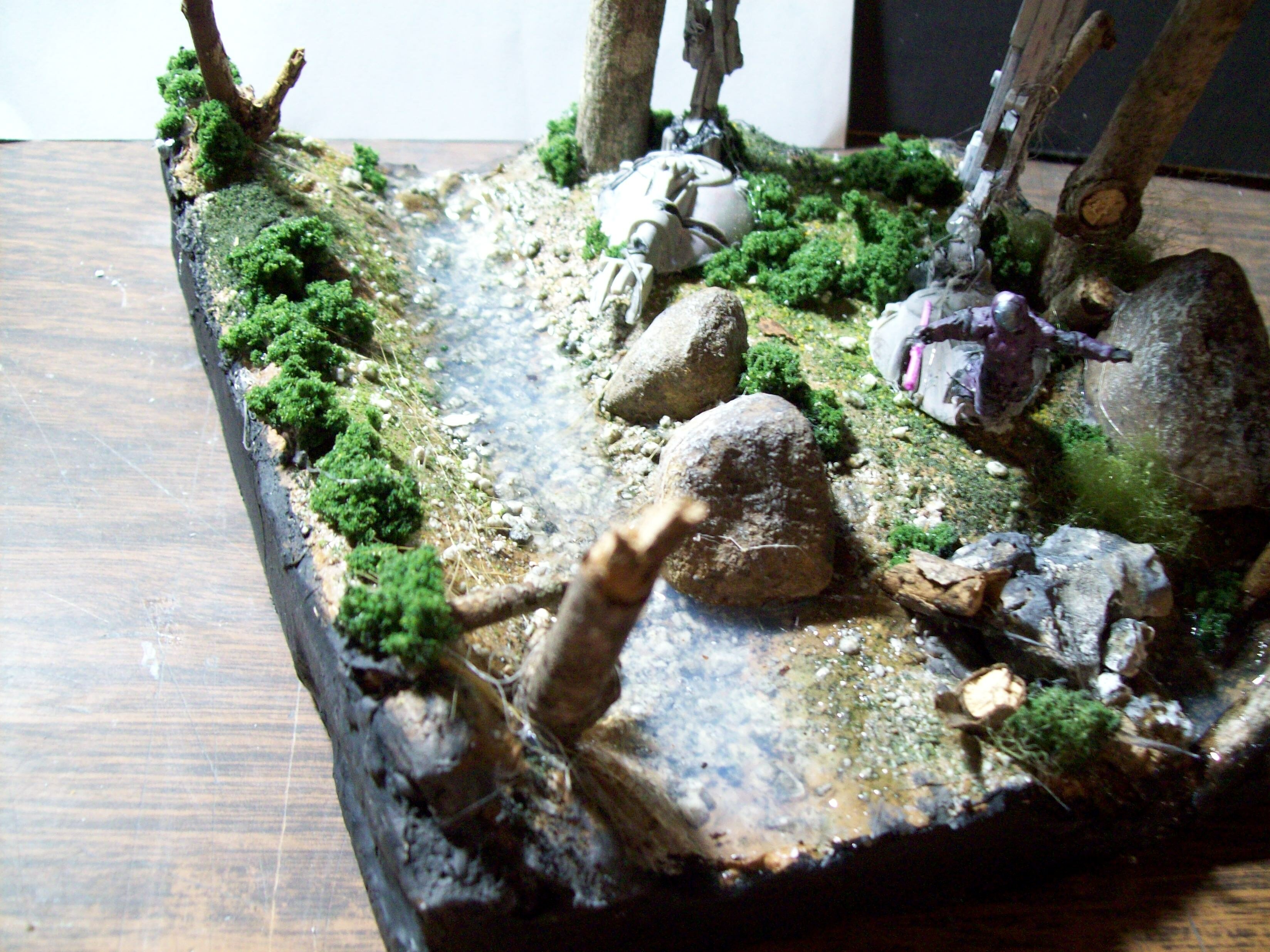

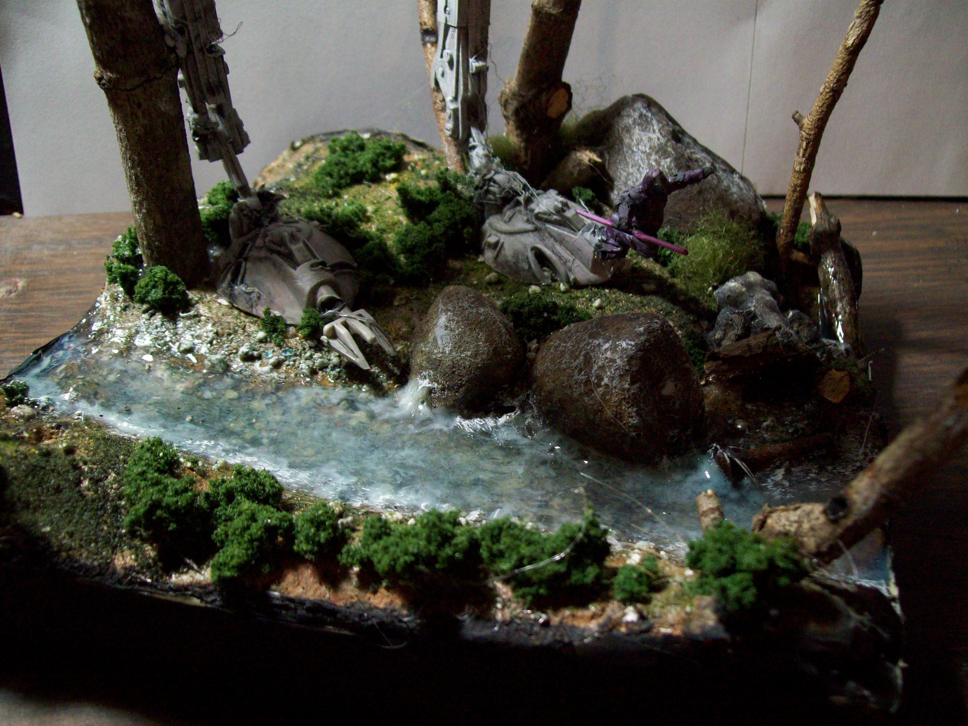

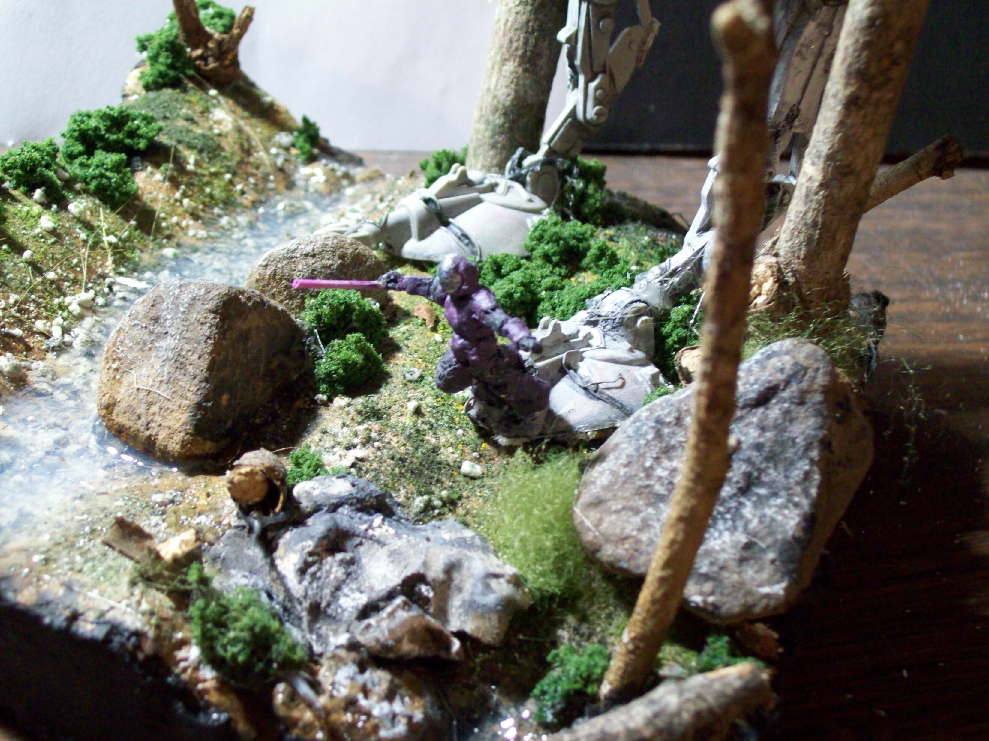

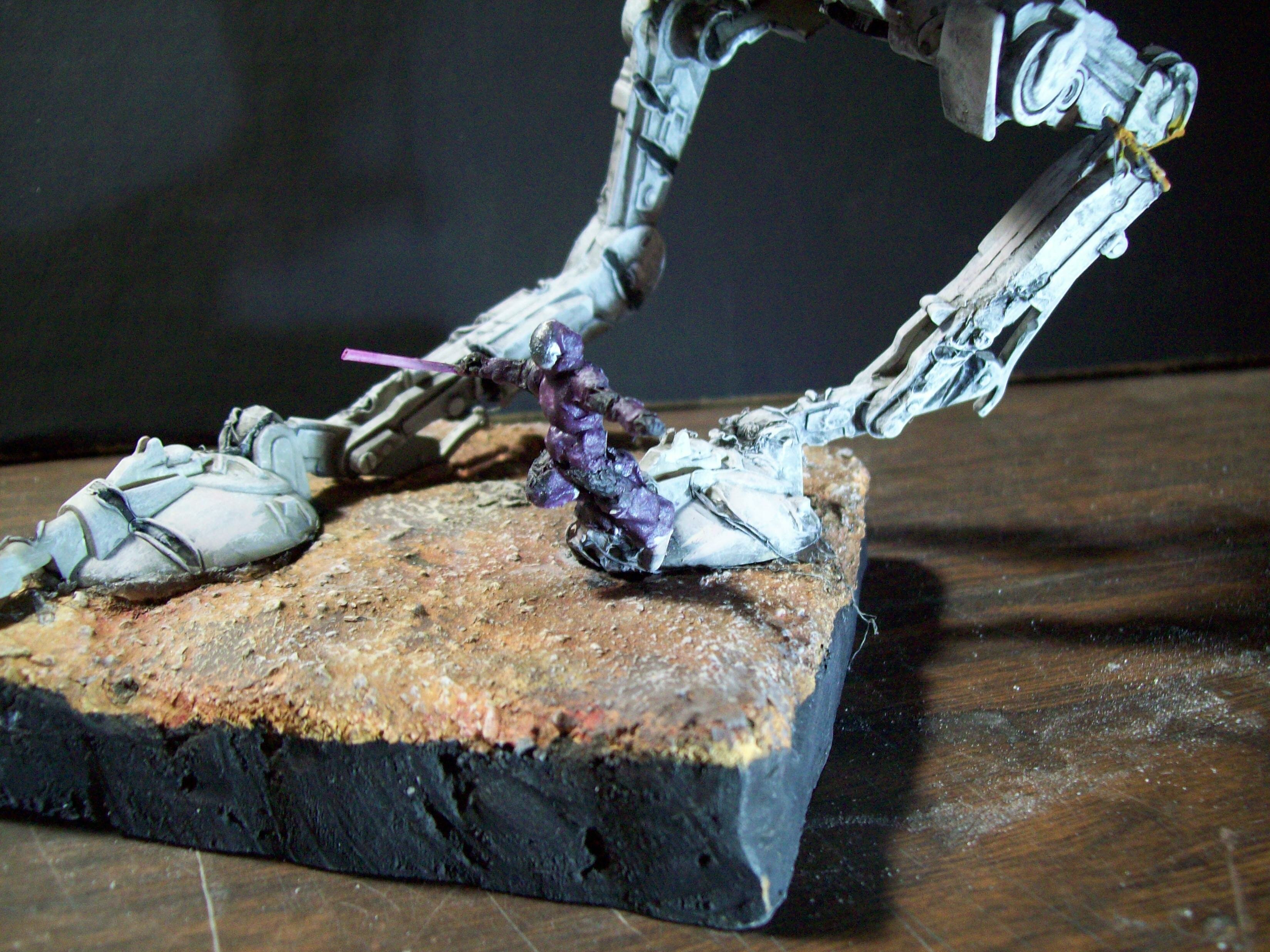

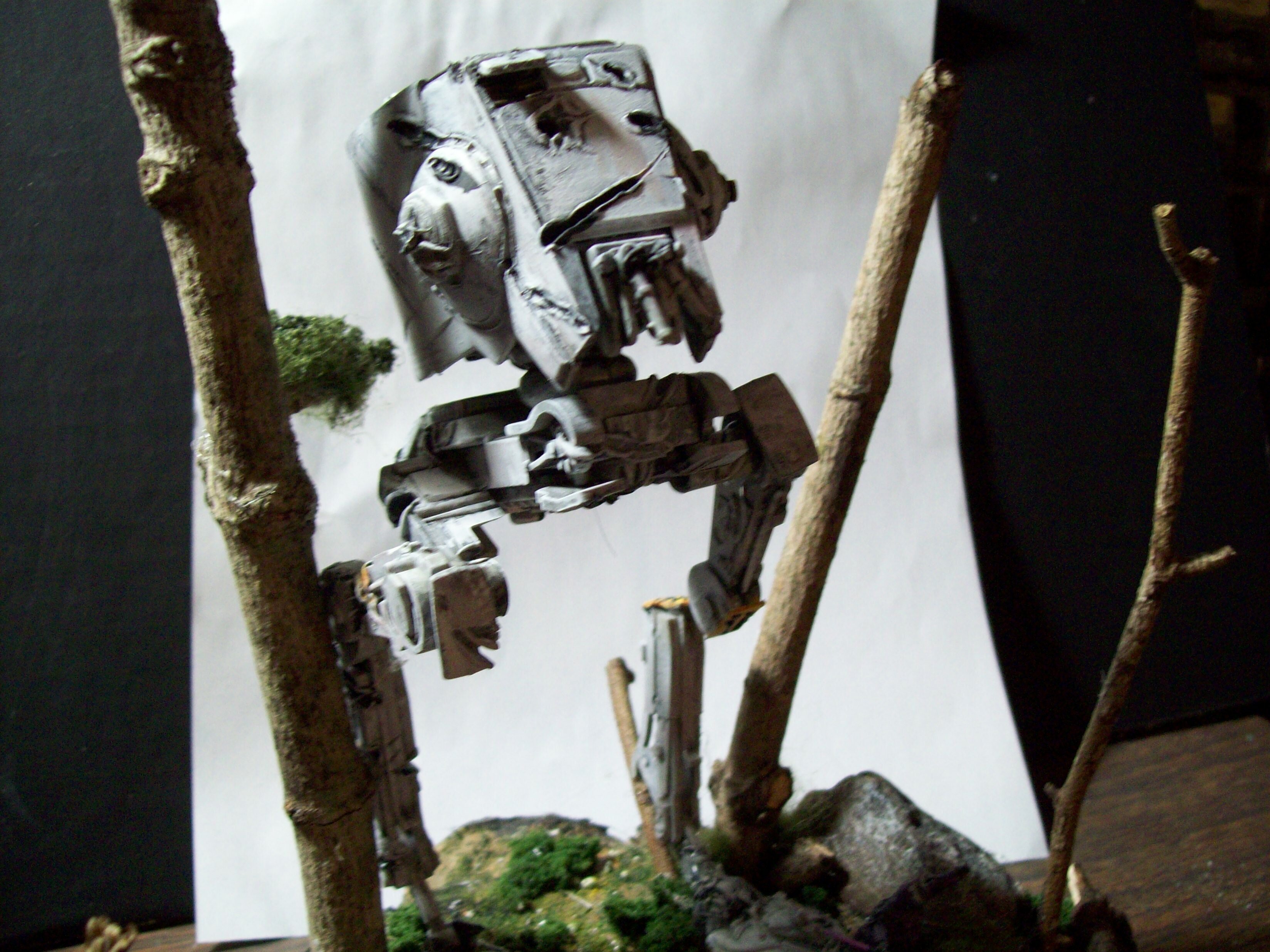

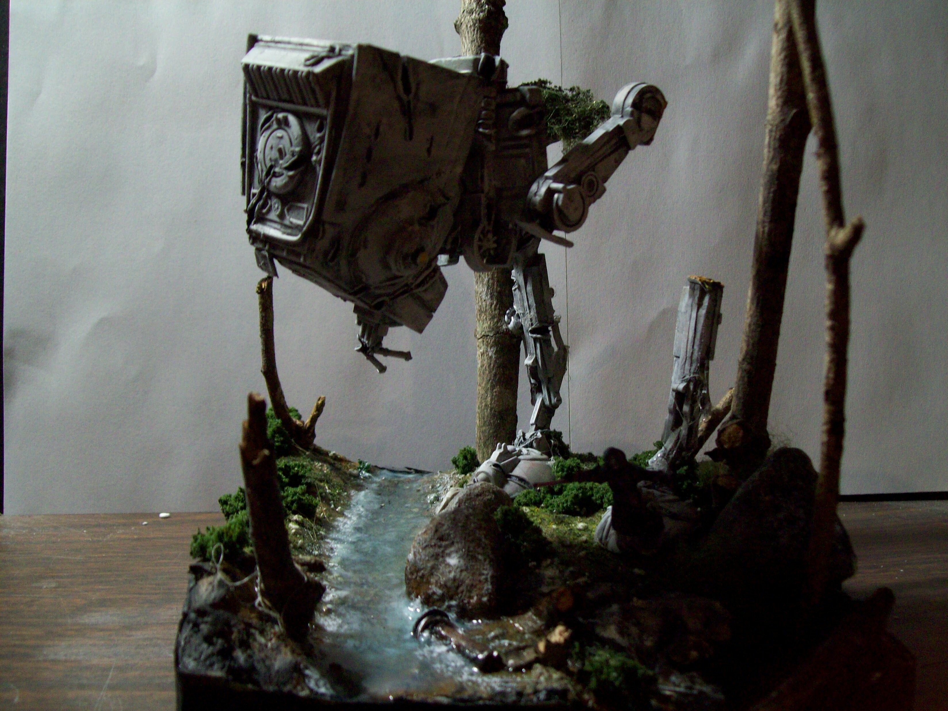

pengbuzz Posted September 20, 2024 Posted September 20, 2024 UPDATE: Final on my diorama- Finally got the water right, even if it is a slight bit murky! Still can't make my mind up on the cockpit /"head" position though: Oh well. Thanks for watching! Quote
sketchley Posted September 20, 2024 Posted September 20, 2024 13 minutes ago, pengbuzz said: Still can't make my mind up on the cockpit /"head" position though: The one with it pitching backwards feels the most appropriate—defeated in a way that keeps the Jedi safe. For comparison: the one with it pitching forward doesn't feel "Jedi" enough—it looks like it might fall on top of the Jedi! Quote
pengbuzz Posted September 20, 2024 Posted September 20, 2024 10 minutes ago, sketchley said: The one with it pitching backwards feels the most appropriate—defeated in a way that keeps the Jedi safe. For comparison: the one with it pitching forward doesn't feel "Jedi" enough—it looks like it might fall on top of the Jedi! Well, the Jedi is running so I'm not sure it would fall on top of him, but that's an interesting point. I just want to make sure the physics are on point! Quote

Thom Posted September 20, 2024 Posted September 20, 2024 @pengbuzz I'd go with it pitching backward. Quote
Big s Posted September 20, 2024 Posted September 20, 2024 I think it looks great either way. When it’s pitching forward, it looks like it will just fall on the other side of the river Quote
